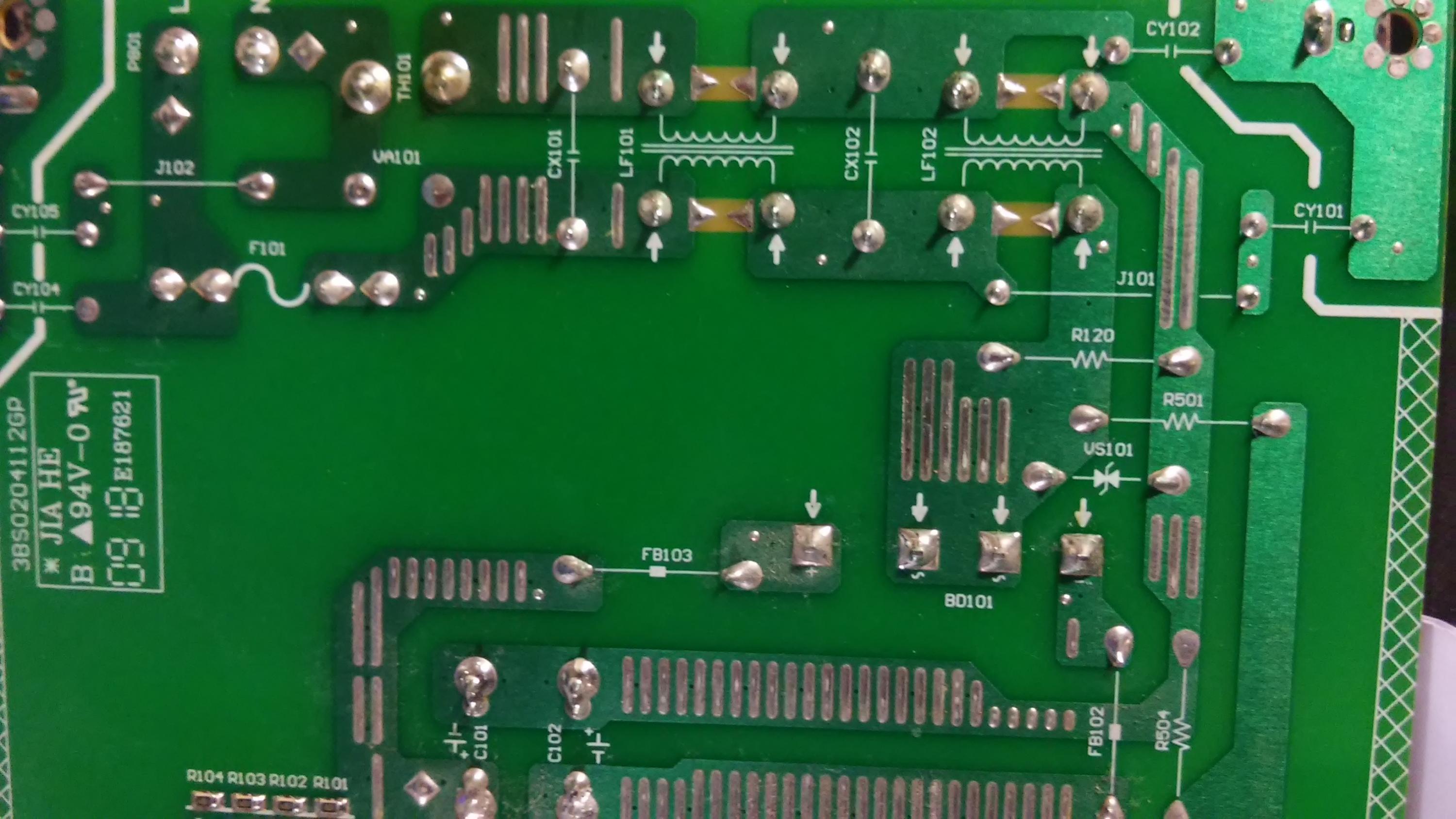

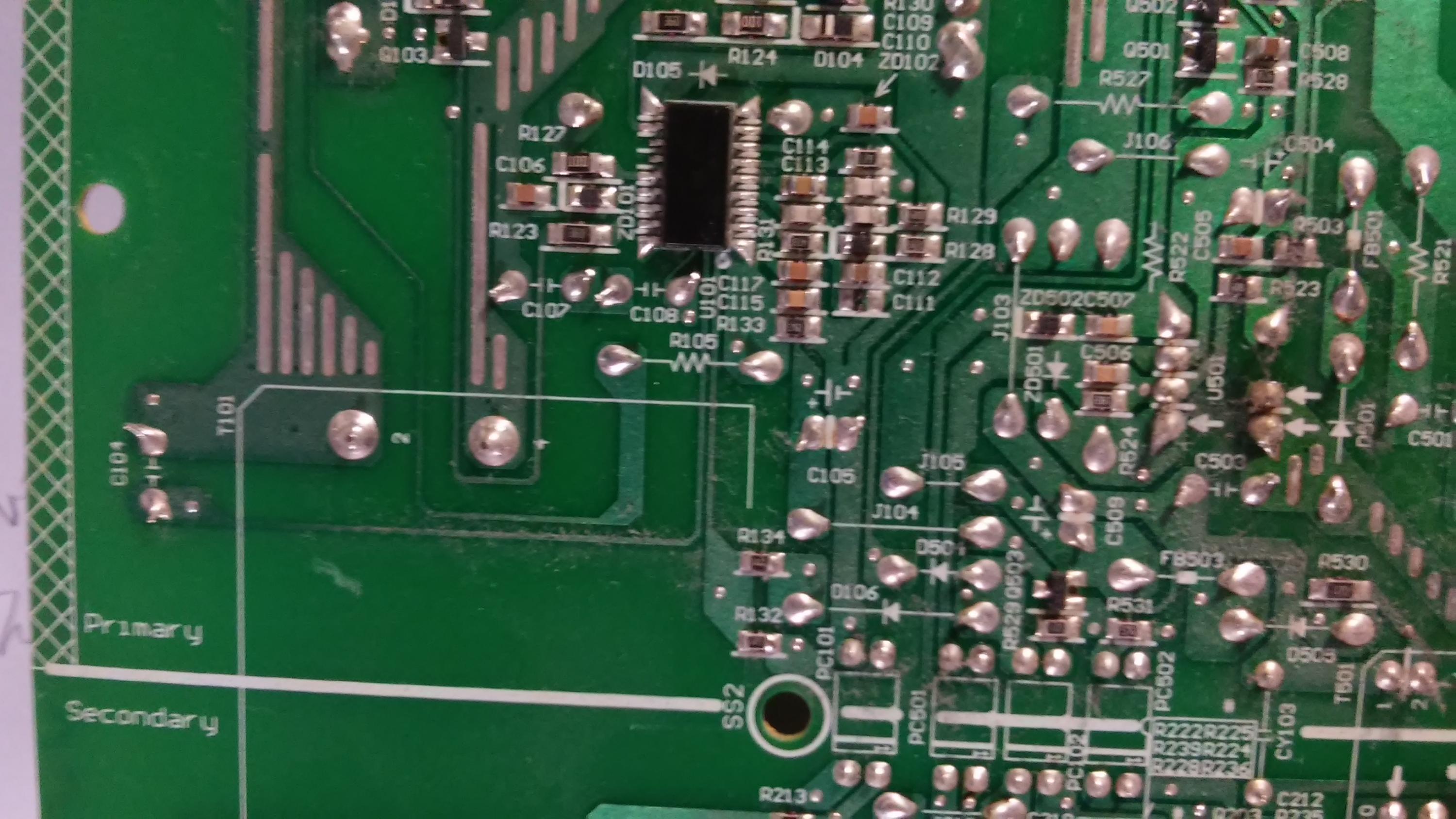

          Need good clear high res straight shot pictures of the bottom side of the board.

            Re: Toshiba 40RV525R repair (schematics?)
            U101 Pin readouts

                        Those resistance appear to be OK. Without a schematic for this power supply I'm stuck.
                        The supply voltage to the IC appears to be within spec at 11.5V but I am surprised that the high voltage supply to Pin 14 is only 131V and I would have thought it would be 332V as per post #16
