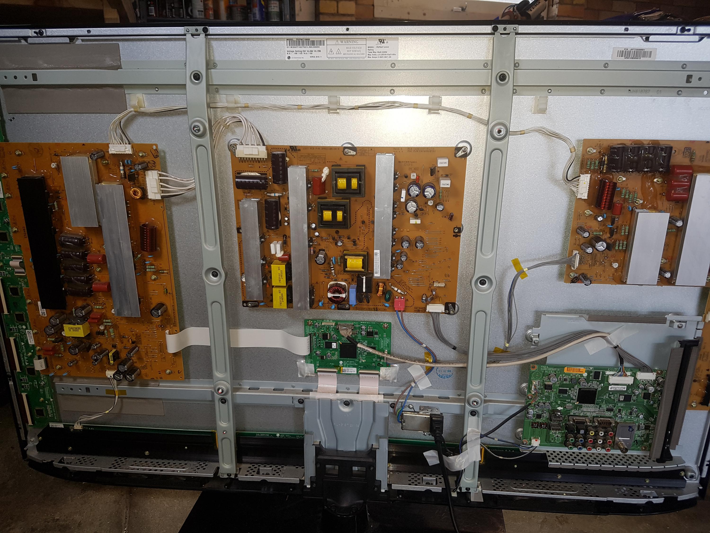

    Posting pictures of the back of your tv showing the boards with clear pictures may help you more with fixing your problem

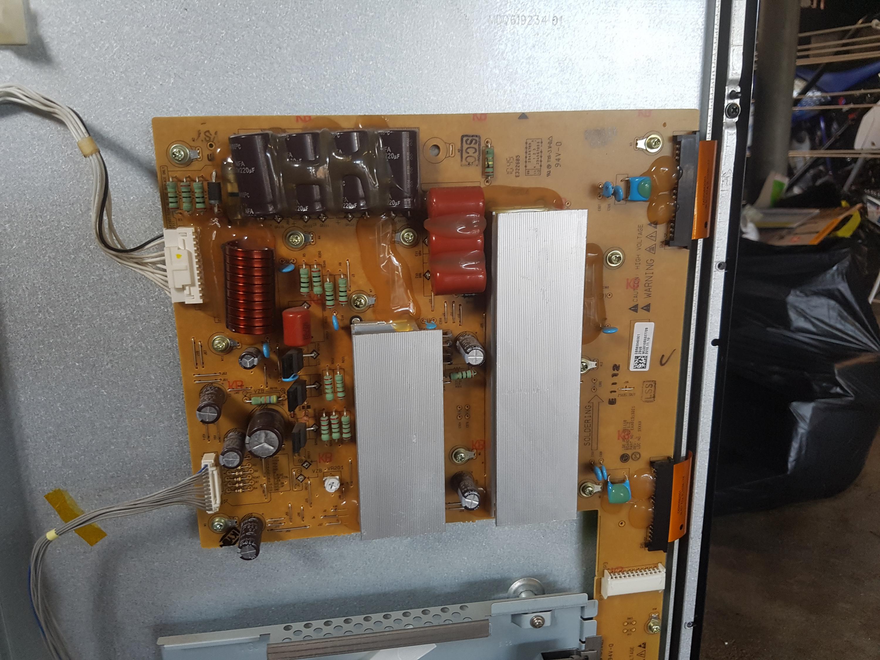

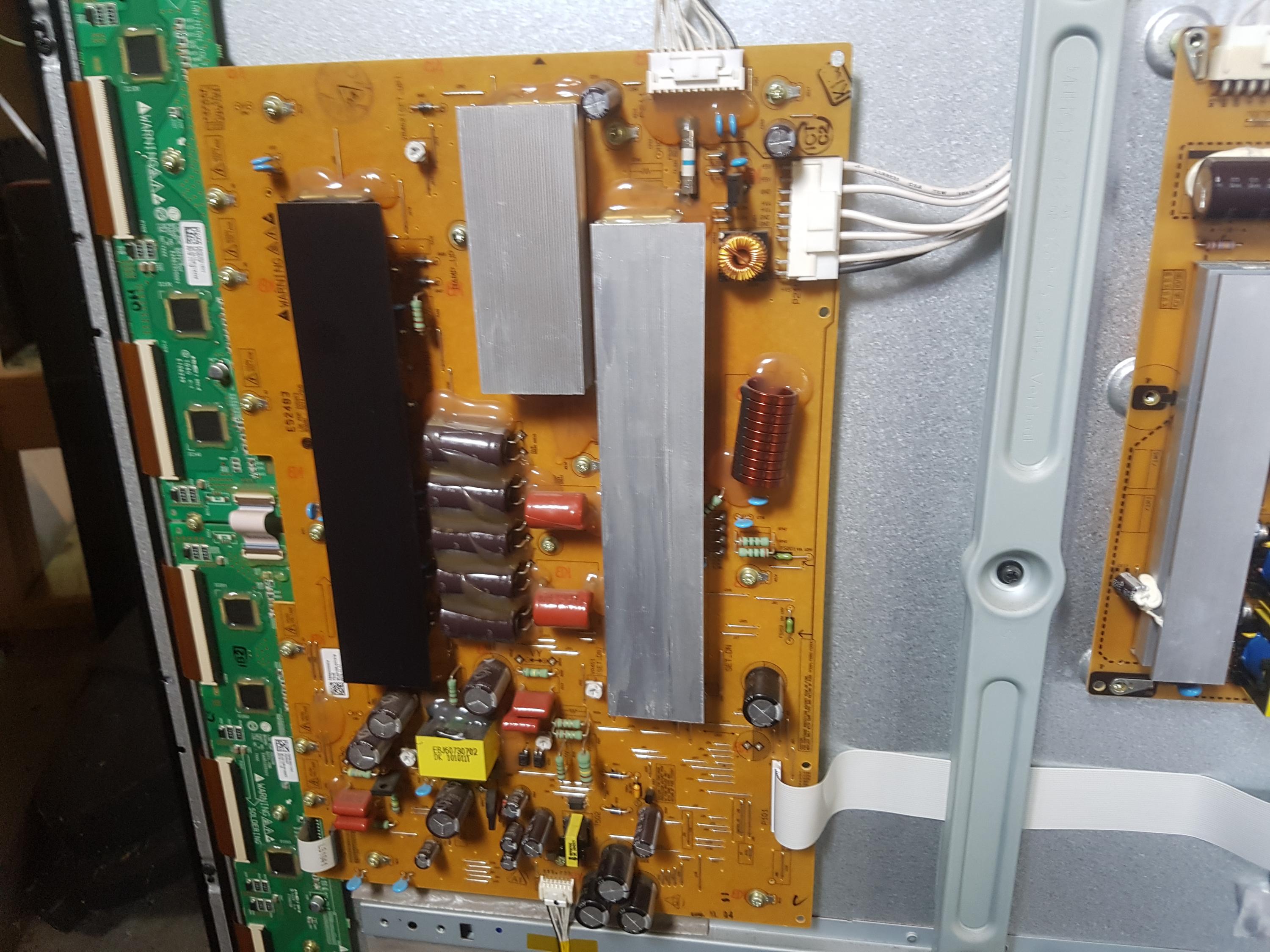

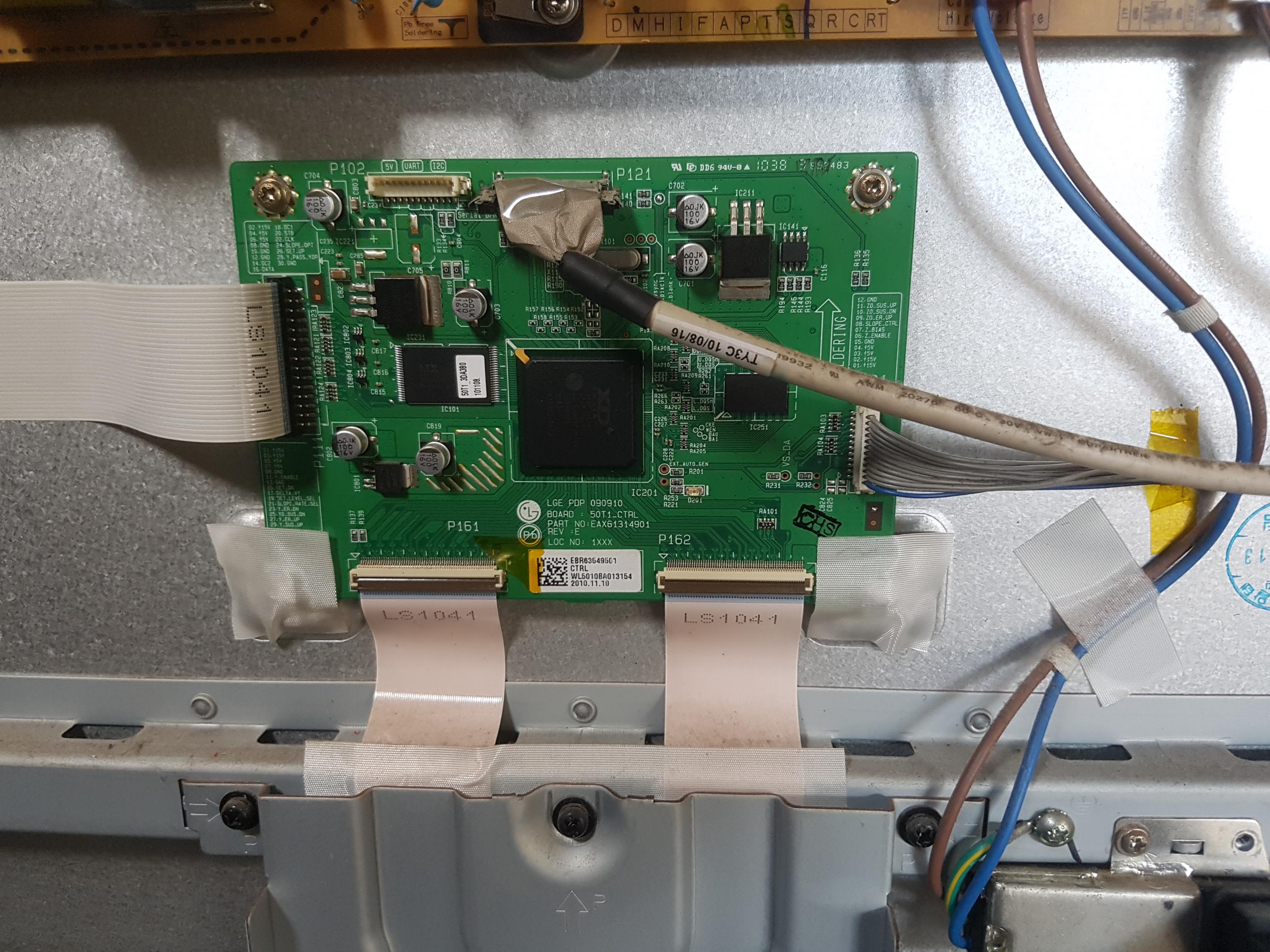

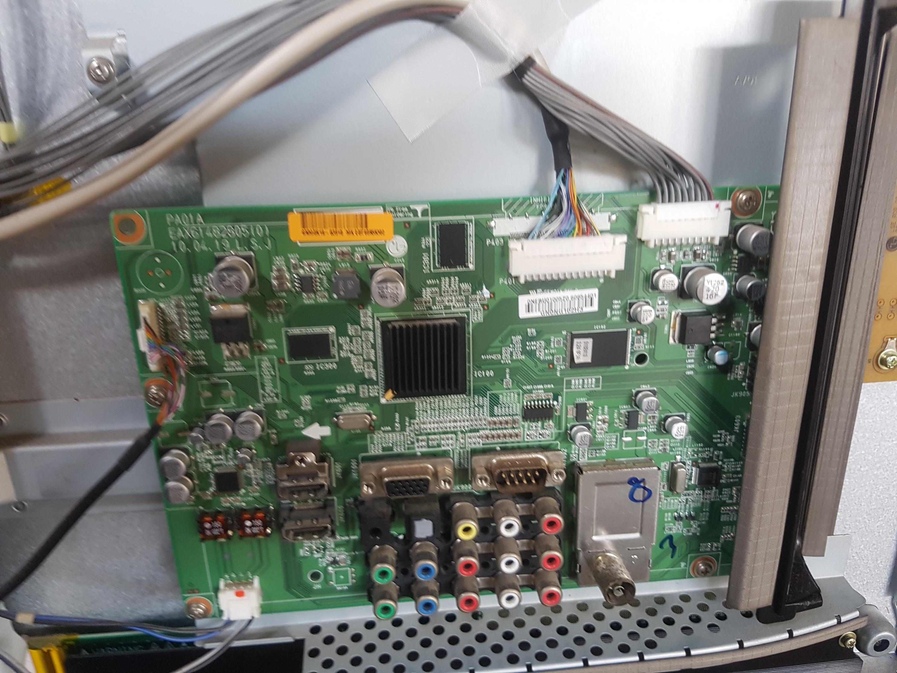

        Hi guys, here's the images of the back of the tv and boards.

          There's two chains of high-value resistors,connected in series,which forms part of the start-up circuit,you will see these (smd resistors) towards the lower centre of the psu,(rear),simply resolder all of the resistors in the two chains,which should bring some success..
          (I don't have the location numbers currently,as i'm not at home)
          Good luck!
