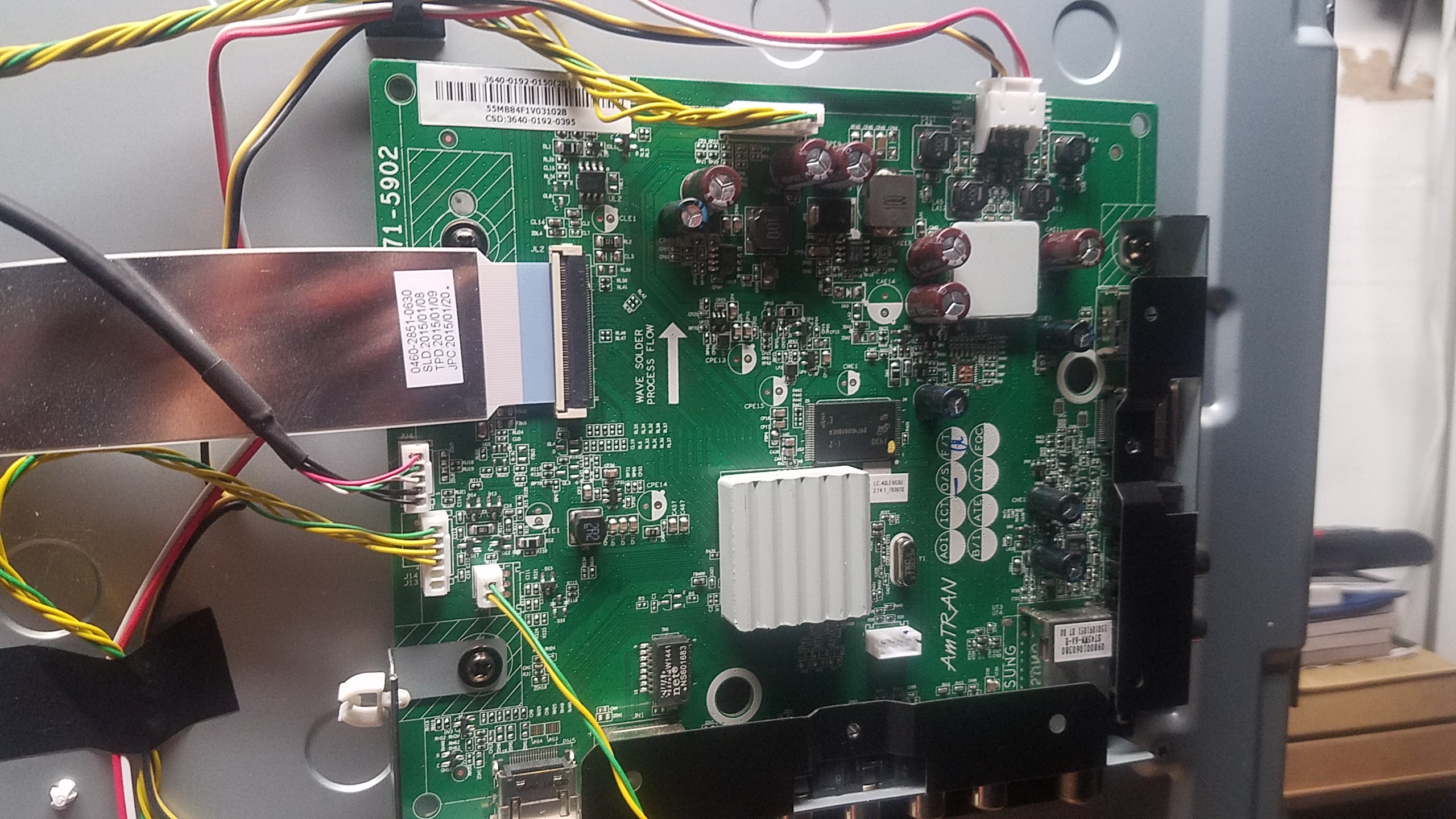

I have a tv from a friend that fall to ground and now doesn't turn on.

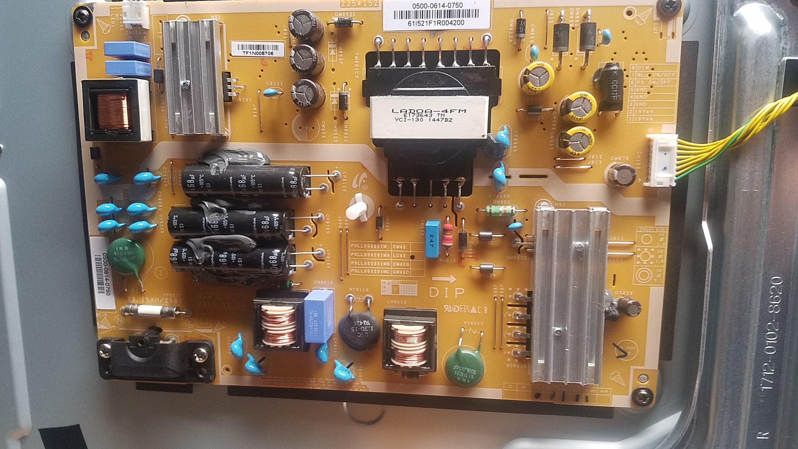

So far i check the connections on ps and i get 19v on connector cn02 on pin 1,2. (this connector doesn't show standby pic)
on main board i have 5v present on connector coming from power button. But, as soon i pushed, voltage is not present on pin going to ps on/off.
So main board is bad???
