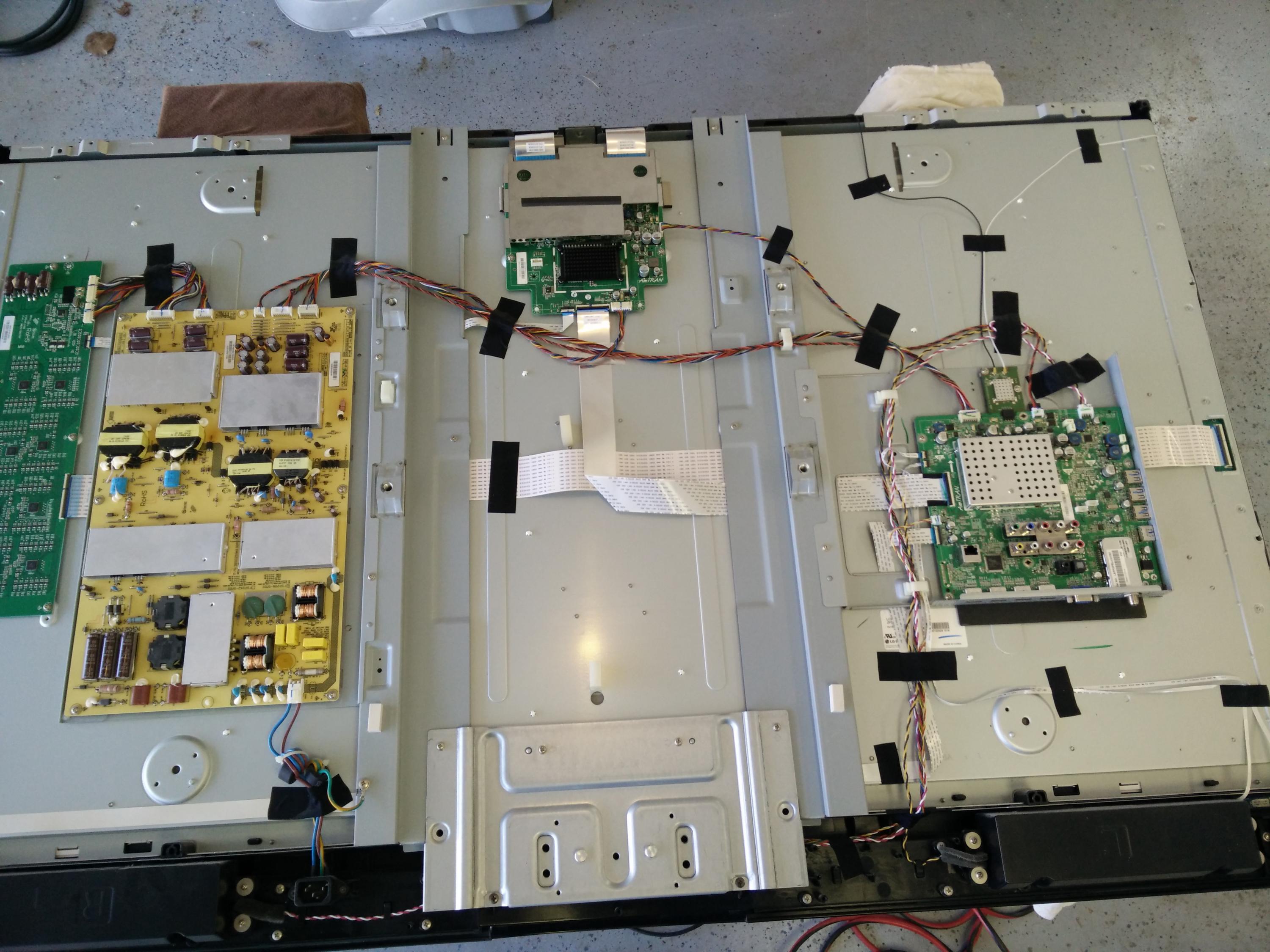

    [Vizio XVT3D554SV] Orange logo, won't power on

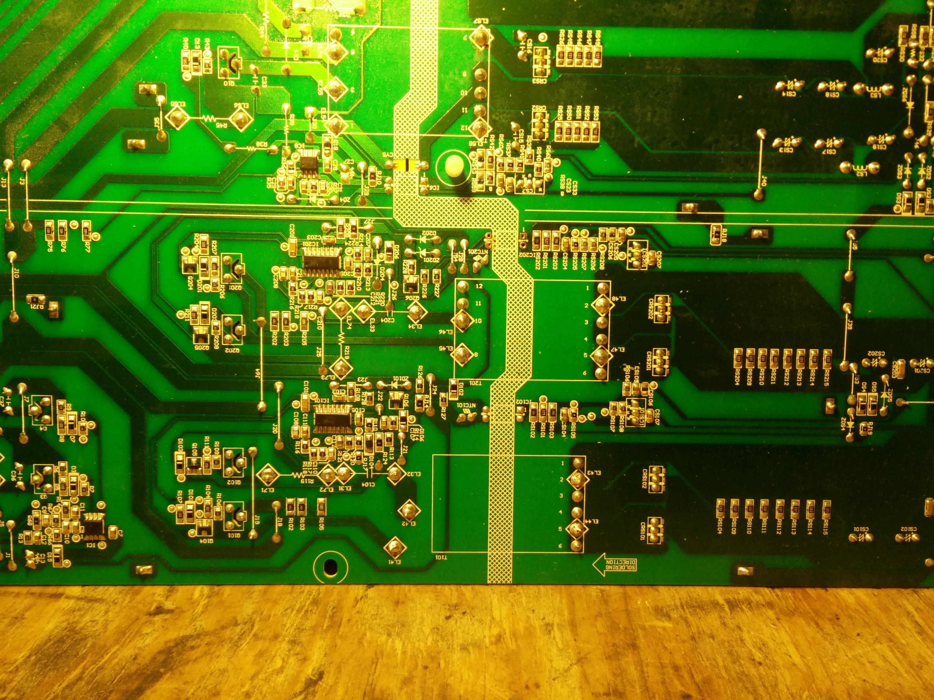

    I've seen one other thread about this same issue (https://www.badcaps.net/forum/showthread.php?t=59325) but there was no resolution.
    Same symptoms as the other thread (orange Vizio light, nothing happens when pressing power button, power board fuse is good, getting 5.1v at connectors, can't get 12v anywhere, no reading at the voltage regulator on main board).

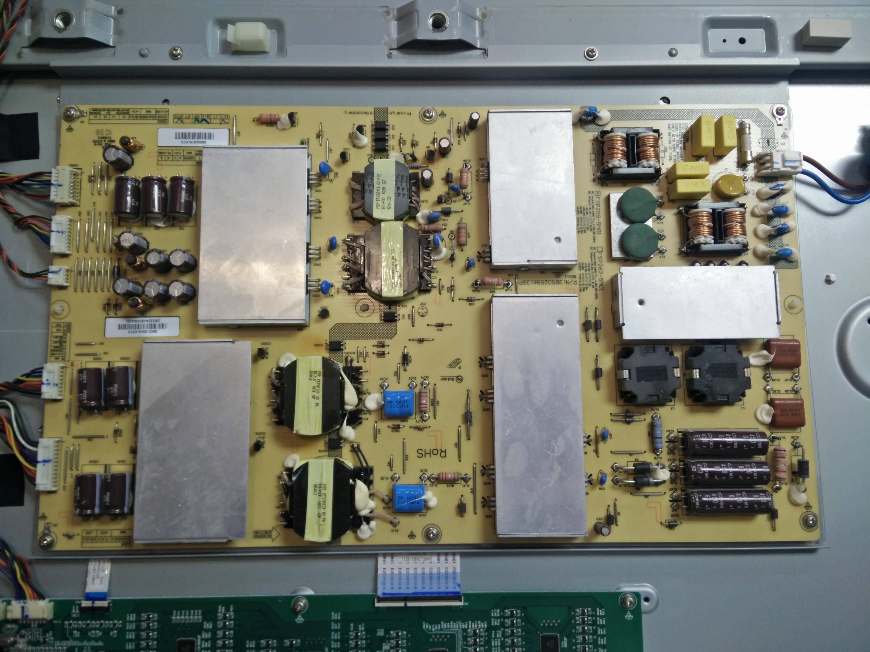

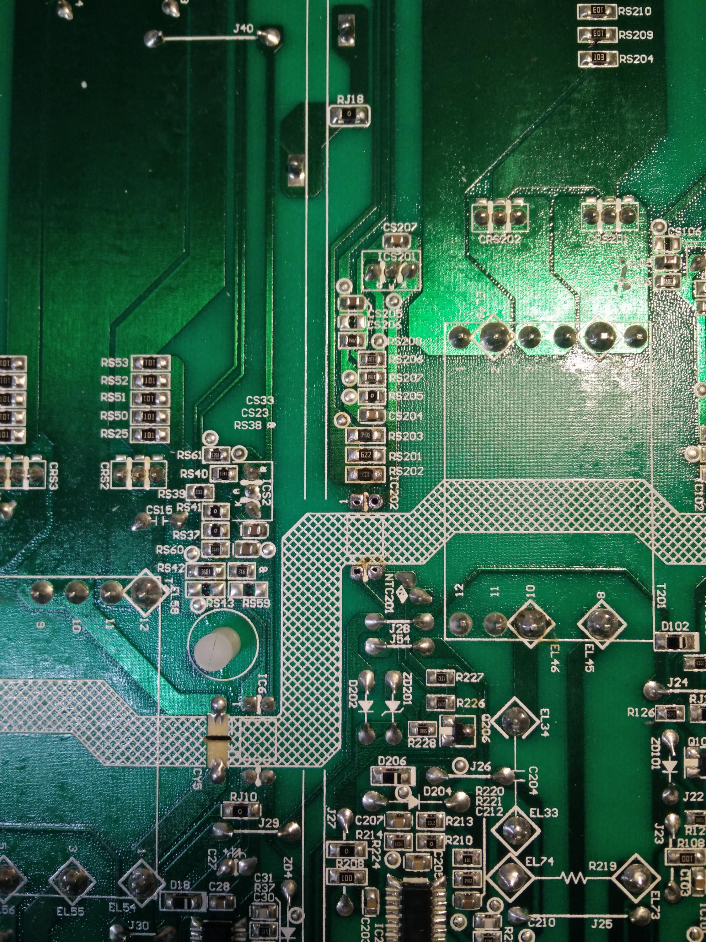

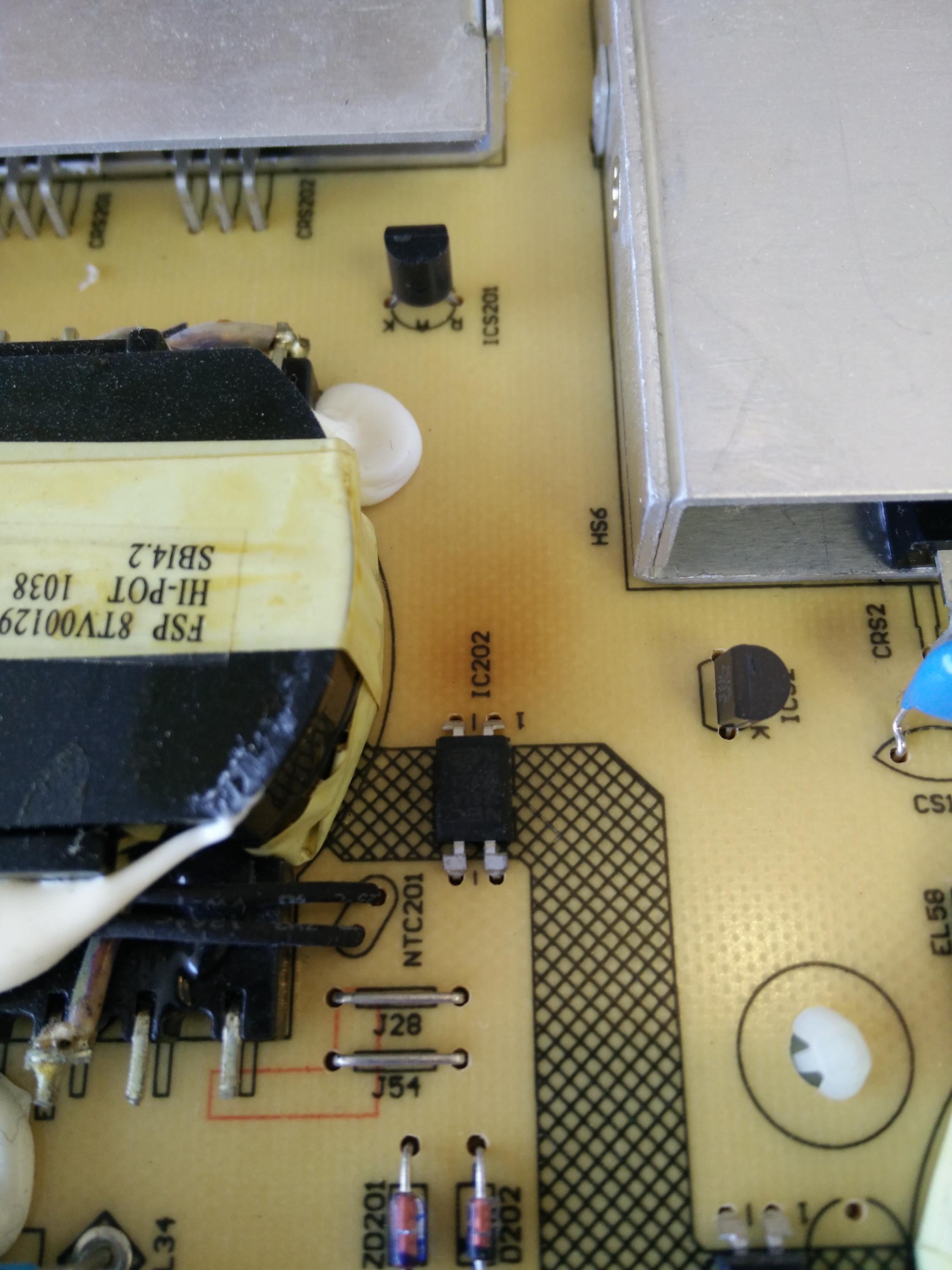

    I did notice a dark spot on the power board (picture attached). Pulled the board and RS202 doesn't look so good. I'm hoping that's a clear cut sign that this thing just needs a new power board.
    Can you guys provide a little insight?

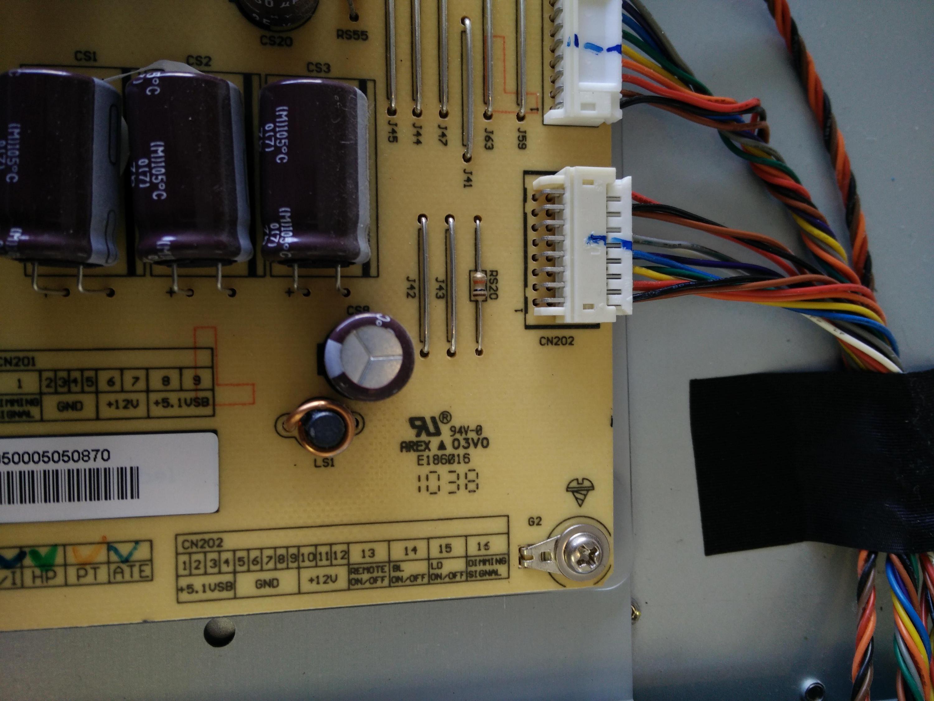

    Re: [Vizio XVT3D554SV] Orange logo, won't power on
    Need voltages from connector that goes from power supply board to main board. Will need pin#-pin label-Pin voltage in standby-Pin voltage when pushing power button and picture of connector on power supply board.
    Format:
    Pin# - Pin Label - Pin Voltage standby - Pin voltage power on
    1 - XXXXXXX - XXv - XXXv
    2 - XXXXXXX - XXXv - XXXv
    3 - XXXXXXX - XXXv - XXXv
    4 - etc.
      Code:
      Pin #	Label
      1	+5.1VSB
      2	+5.1VSB
      3	+5.1VSB
      4	+5.1VSB
      5	GND
      6	GND
      7	GND
      8	GND
      9	GND
      10	+12V
      11	+12V
      12	+12V
      13	Remote on/off
      14	BL on/off
      15	LD on/off
      16	Dimming signal
      For the voltage readings, I'm not 100% sure which pin is which since the connector has two rows but the pin label doesn't. I took a reading from each at the connector side and below is the readings. I'm getting the same at standby and when pushing the power button (no remote - just the stupid power/menu combo thing on the side).

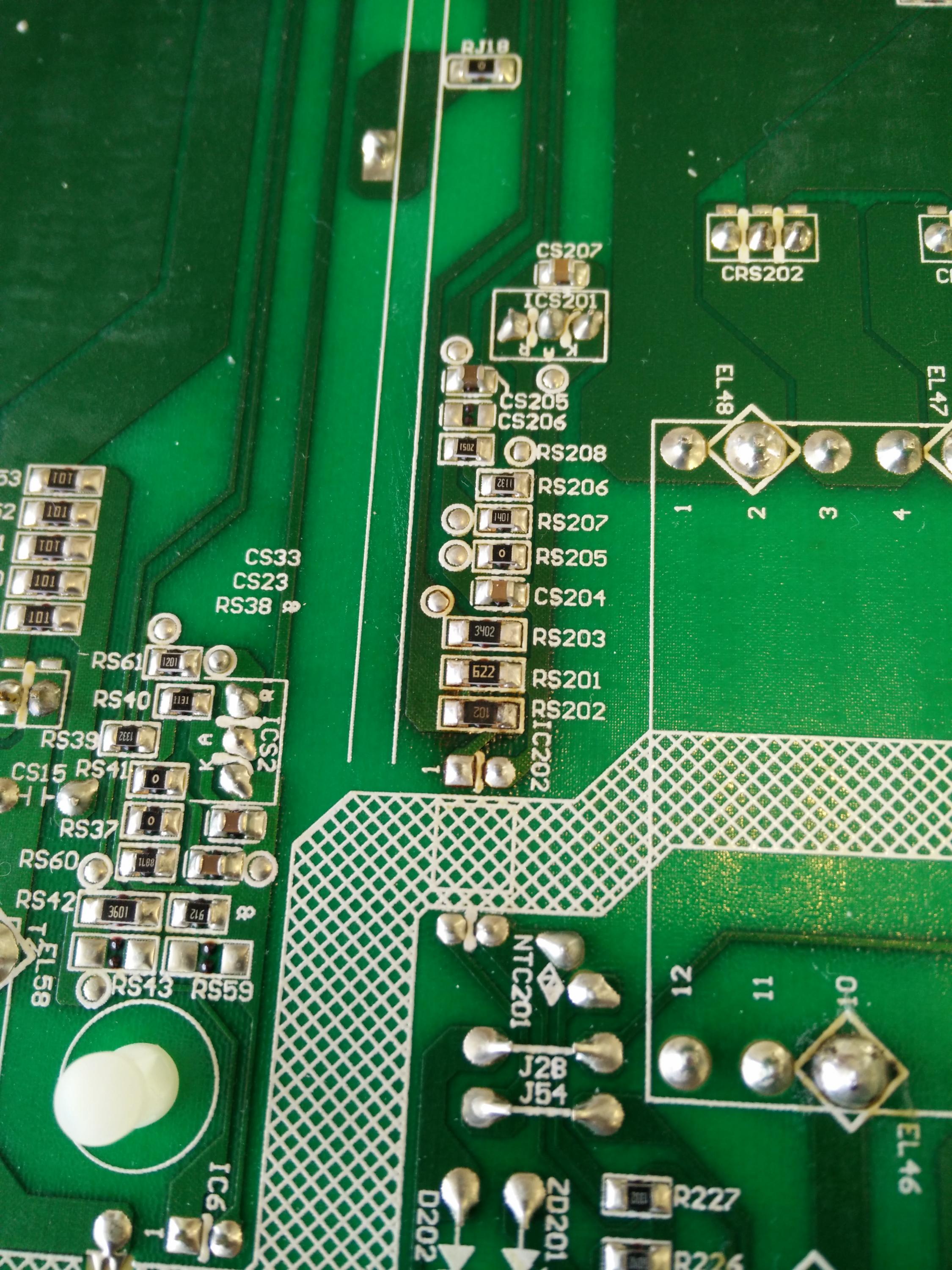

          With your meter in ohms mode can you measure the resistance of RS202 (1K Ohm) and also check the resistance between the two legs on the left then right side of IC202
              I'm seeing 994 for RS202.
              IC202 right side (I believe based on text direction on top of the board) is reading 1454 and left side is 0.
                994 ohms for RS202 is fine.
                IC202 should not read 0 ohms so either that IC is short circuit between those two pins or something attached to those pins is short circuit. What is the part number.

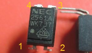

                With your meter set to diode mode set switched off can you check between the 3 pins of ICS201 and give the readings between K/A/R. Cant really read the letters off your photo's. Also what is its part number.

                  If I have my multimeter set to 20k ohms I'm getting a reading on both pairs of legs for IC202 (7.17 right, 11.78 left). Set to 2000 ohms and I still only get a reading on the right pair. Am I doing something wrong? Using the multimeter incorrectly?
                  For IC202 the part # is NEC 2561A WK021.
                  ICS201 (part # KIA 431A 026) readings:
                  R - A: 1288
                  R - K: 942
                  A - K: 680
                  I also find it odd that I'm having trouble getting a reading from the top of the board on both IC202 and ICS201. Readings are fine from the bottom but I rarely get a reading from the top.

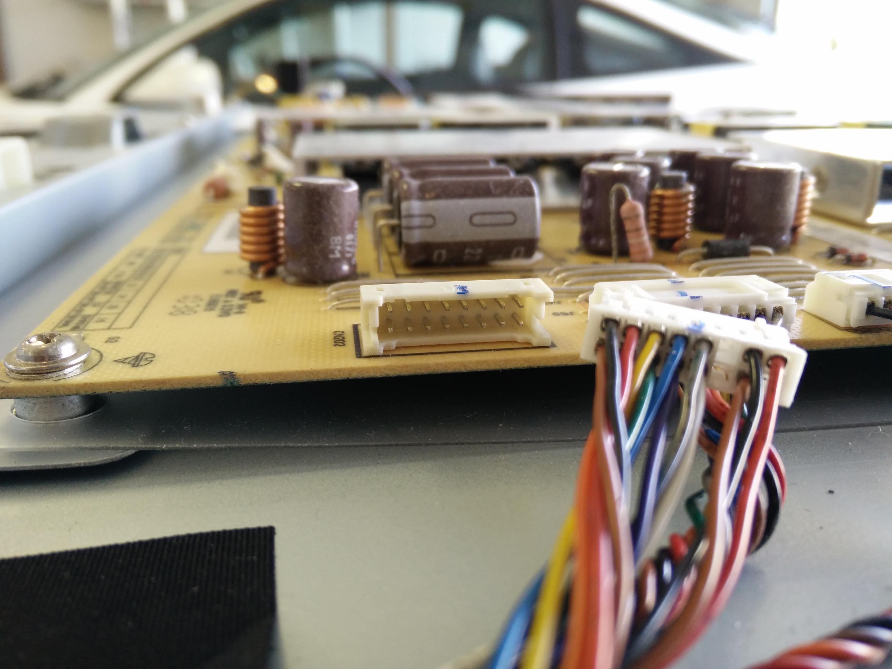

                    Here is the information on the opto-isolator. Can you identify the pins number you say on the left side read 0 ohms Pin 1 of the opto-isolator has the dot nearest it or the line running down it alongside pin 1 & 2.
                    • dick_barton
                      • Aug 2015
                      • 6642
                      • Wales
                      I see that post#1, picture 5 shows pin 1 of the Opto-isolator marked on the circuit board. Is it the two pins closest to RS202 or the other side that measured 0 ohms.
                        The other side. Pins closest to RS202 are getting a reading.
                          You need to unsolder and remove the opto-isolator. Check across the solder pads when you have removed it to see if you still have a short (0 ohms). If the 0 ohms is only across the pins of the opto-isolator then that needs to be replaced.
                          Can you post a focused photo (underside of board) so that the connections from the opto can be traced.

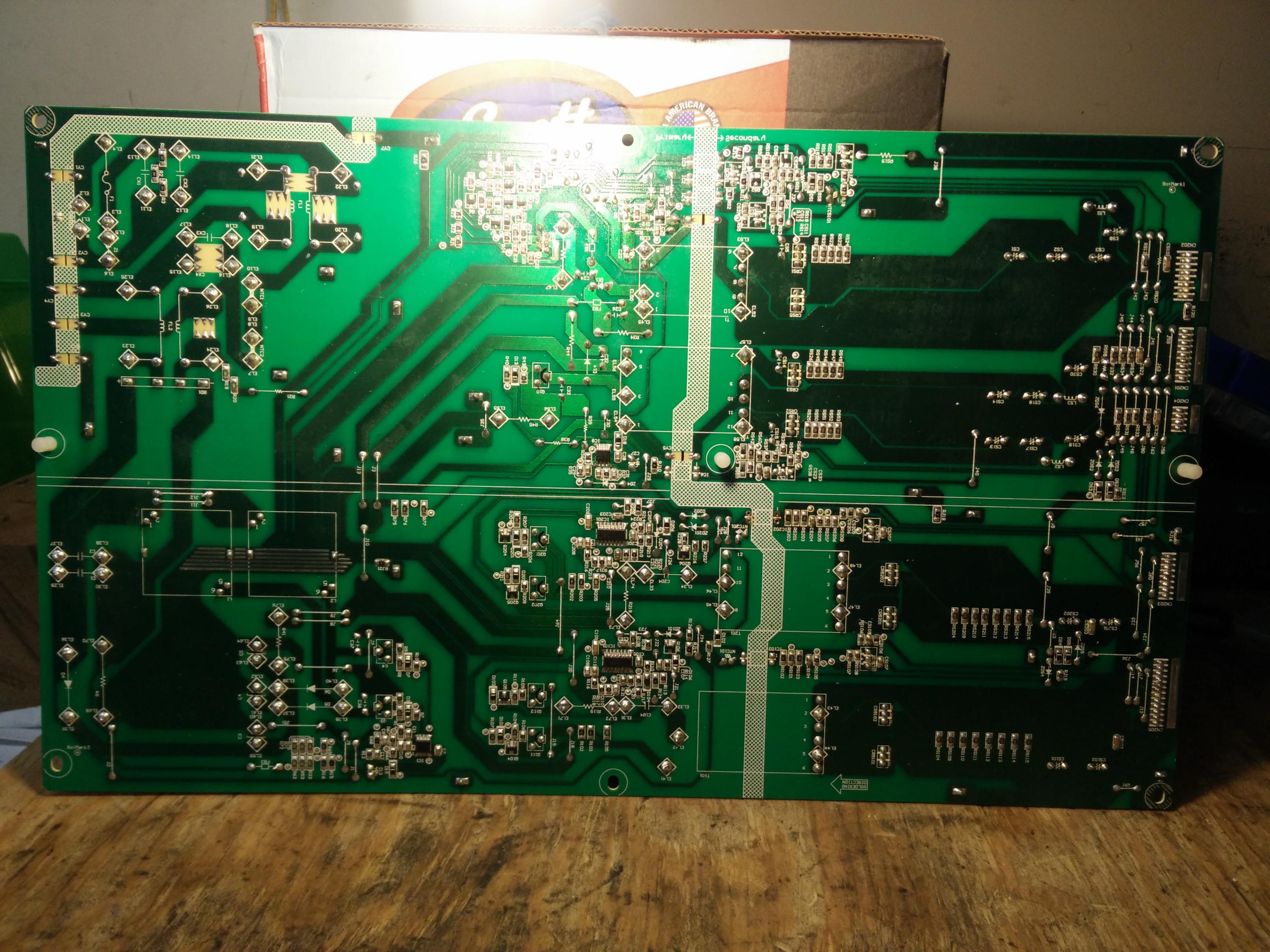

                            www.shopjimmy.com has a pretty good picture of the underside - probably better than I would be able to take.
                            http://assets.shopjimmy.com/media/ca...870-bottom.jpg
                            If that isn't quite clear enough I'll see what I can do.
                            I'll work on desoldering the opto-isolator as soon as I can.
                              I've got the opto-isolator removed but I think I gave some bad information before and it didn't hit me until right now. The right side of the opto-isolator is showing ~1454 ohms but the left side isn't showing 0 - it's showing no continuity at all. That was confusion on my end.
                              With the opto removed both pairs of solder pads are showing no continuity and I'm getting the same readings on the opto as before.
                              Thankfully it's easy enough to reinstall this opto-isolator. Hopefully that information is more helpful.
                              I did get more pictures of the back of the board but I'm not sure how helpful they'll be. They're attached.

                                With the set in standby measure the voltage between pins 1 & 2 and also between pins 3 & 4 and then do the same when you take it out of standby.
                                Pin numbers as shown in post#10
                                  https://www.badcaps.net/forum/attach...0&d=1491156770
                                  Connector back in place.
                                  As you can see from the picture, there a pin labeled with '1' next to it, that will be pin 1, the pin above it will be pin 3, and above pin 3 is pin 5, so basically the left column is for ODD number pin, the EVEN column pins you will have to measure the reading from the back side of the connector using skinny probe.
                                  Right now you have standby Voltage, so we need to find out if you have >2VDC on PS-ON (REMOTE ON/OFF) pin 13 to turn on the rest of the power supply or not, you can easily get to pin 13 from the top side of the board.
                                  It also looks like the LED in the OPTO is bad. What resistance do you get on RS102?
