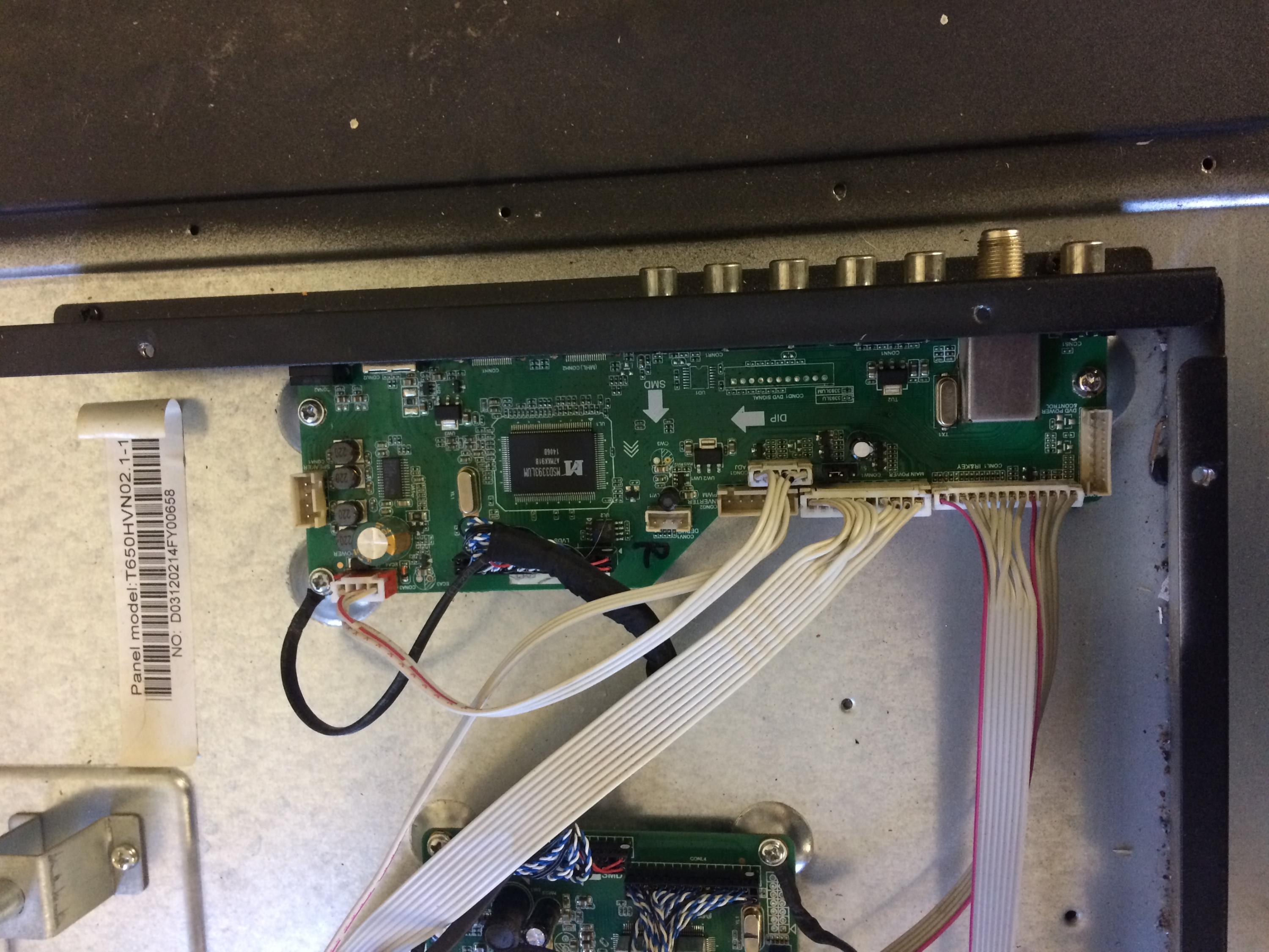

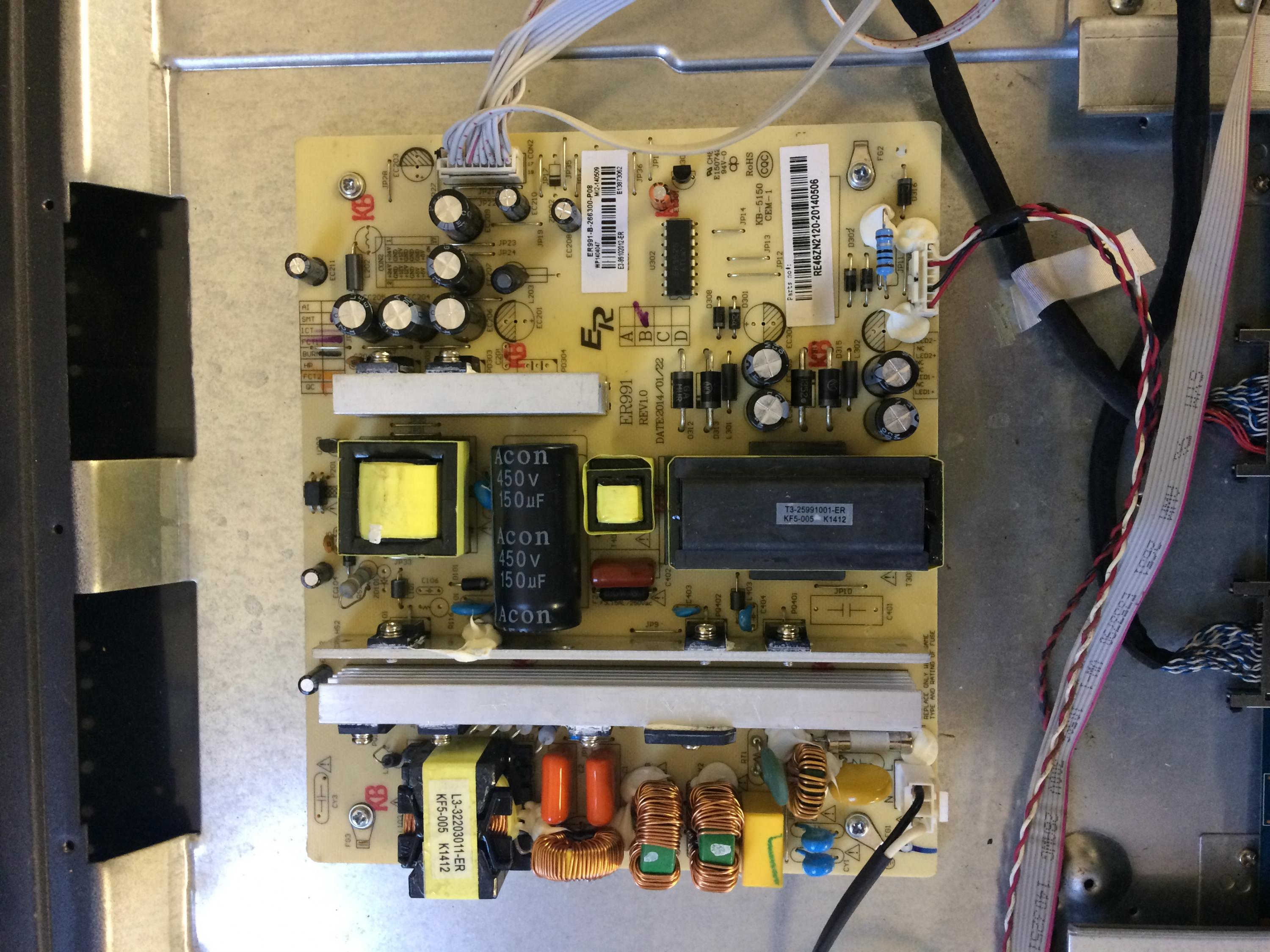

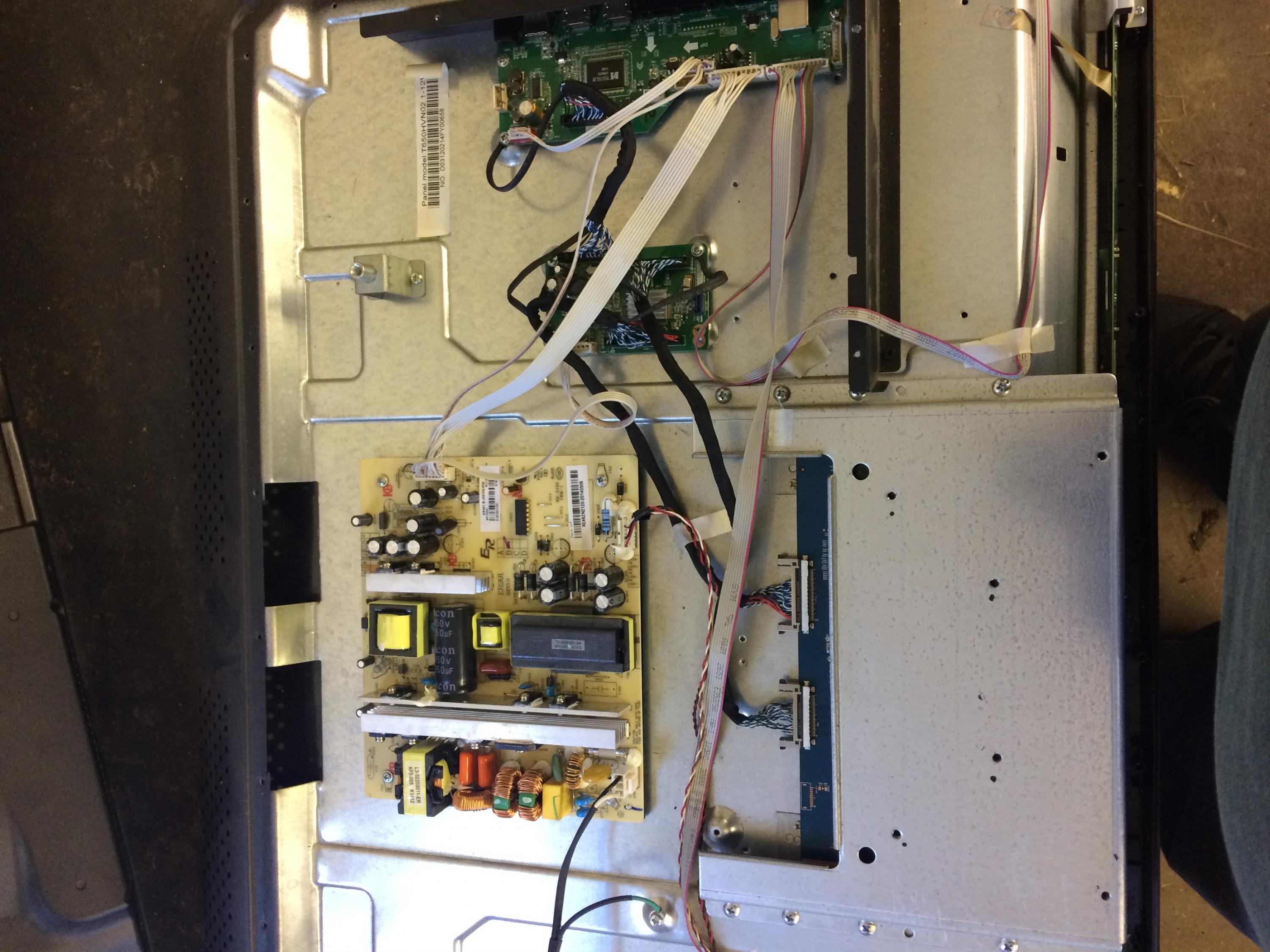

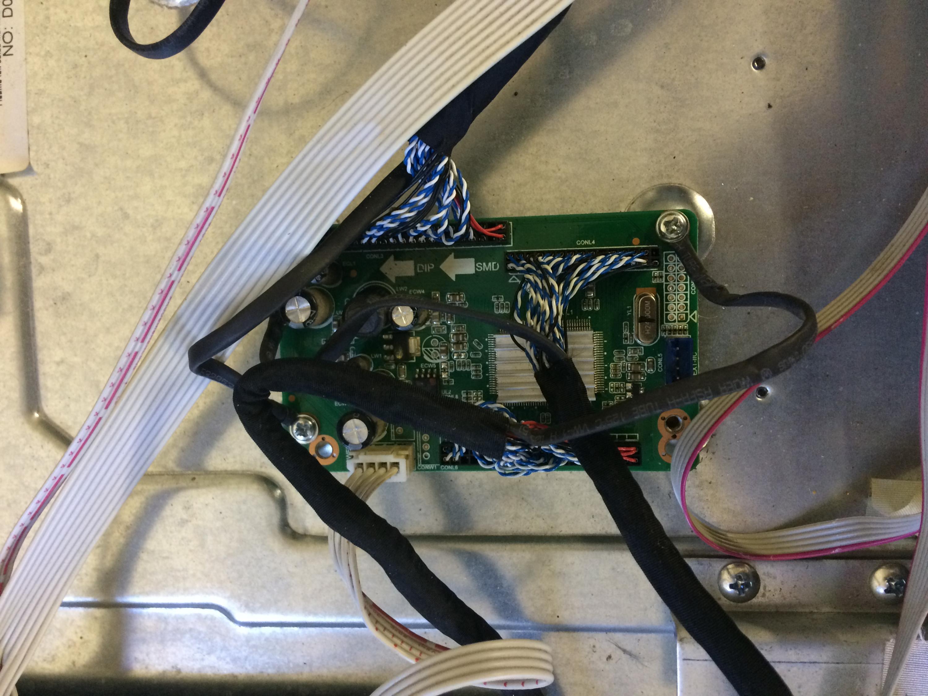

    picked up a RCA 65g55r120q that had stand by but no power up had 2.7 to main board and blinking red so i figured it would be main board. I wasn't too excited about the $125 price tag on a new main board so i decided to wait. I found a donor tv that had a different number I decided to see if it would work i noticed that the plug on the main board that goes to frc board wasnt the same so i left it off i noticed the standby light was no longer blinking and would turn off when power button was pressed. I noticed that if i left that same set of wires unplugged from my original main board that the blinking stand by light went solid. so I swapped out frc board and the jumper that goes to main board. and i am able to power on the set no blue light when powered on (i think there's supposed to be one) but backlights would only flicker once as the set was being turned off. so i swapped out power supply / led board with donor and it does the same thing that the donor tv did which is back lights would intermittently flicker on then off not long enough to see if there is a picture. am i looking at bad caps or a deeper issue? thanks in advance
    forgot to add when backlights would flicker only 9v at power supply to panel

    Need good clear sraight on pictures of back of tv with cover off and each board.
    Need voltages from connector that goes from power supply board to main board. Will need pin#-pin label-Pin voltage in standby-Pin voltage when pushing power button and picture of connector on power supply board.

            Sorry here is what I found
            Power in: 120 v
            Com 2 pin 1: 0v
            Pin 2: 0v
            Pin 3: 0v
            Pin 4: 0v
            Pin 5: 21.5 v
            Pin 6: 12.5 v
            Pin 7: 0v
            Pin 8: 12.5v
            Pin 9: 0v
            Pin10: 12.5v
            Pin11: 0v
            Pin12: 5v
            Pin13: 5v
            Pin14: 5v
            Pin15: 4.5v
            Pin16: 5v
            Pin17: 4.5v
            Pin18: 3.25v
            Com 5
            4.7v right and left
            Main board
            Main power
            Pin 1: 12.5
            2: 3.25
            3: 5
            4: 5
            5: 5
            6: 5
            7: 0
            8: 4.5
            9: 5
            Controls/or
            1:0
            2:3.2
            3:3.2
            4:3.23
            5:3.3
            6:3.3
            7:3.3
            8:3.3
            9:0
            10:5.5
            11:.5.1
            12:.03
            13:5
            Conj 1 adj
            1: 0
            2: 0
            3: 4.6
            4: 3.25
            5: 12.6
            6: 5.1
            Con a3
            1: 0
            2: 0
            3 12.6
            4: 12.6
              Re: 65" rca backlight issue
              No pin names to tell us what those pins are for?
              There are charts printed on the board so put there name right next to your reports so we can easily identify the readings.
                Need pin description don't know what voltages should be on pins.
