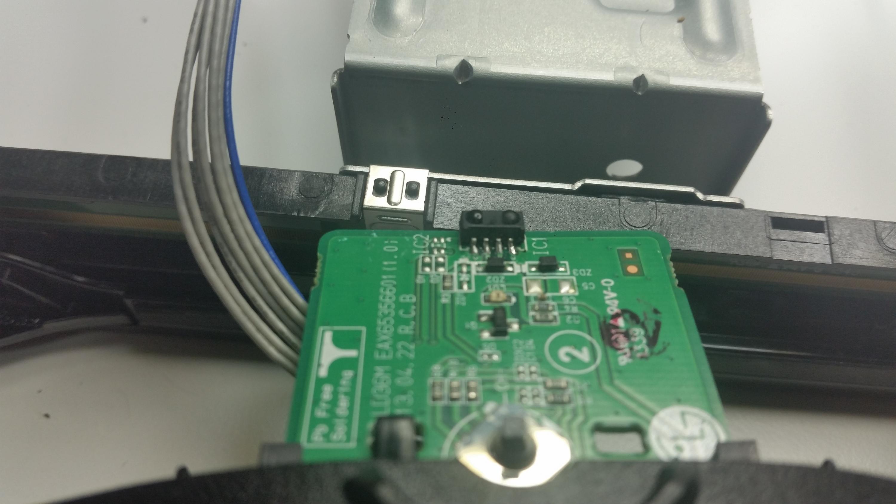

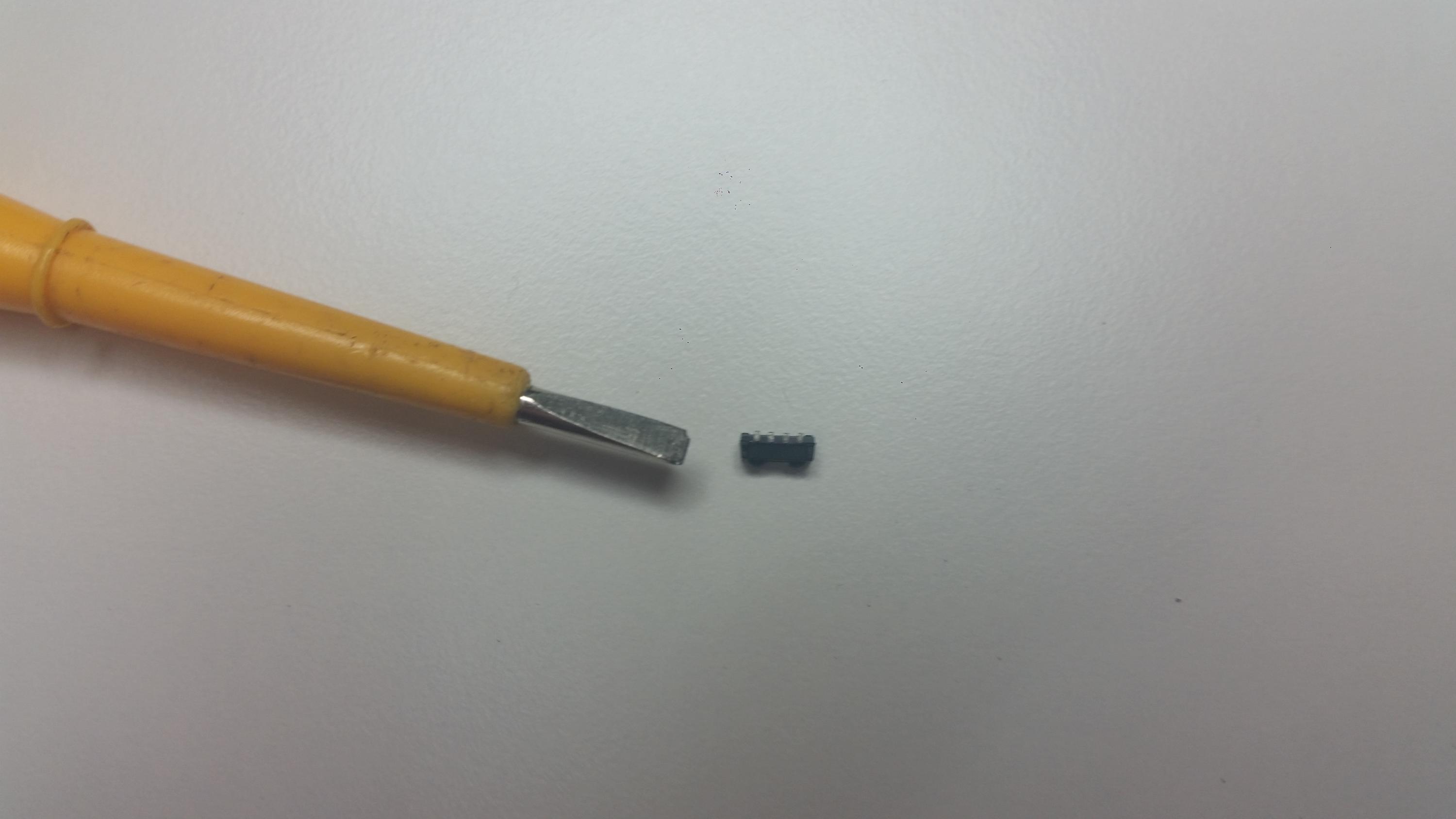

    Hi Guys, I had a further look at this today and found this component lying loose in the front plastic casing near where the little PCB with the on-off switch goes.
    Aha I thought, this looks like the IR sensor and there was a suitable vacant spot on the little PCB with the power switch (IC1) where it appears to have come from... So I soldered it on there. Think my soldering is OK, certainly looks OK under a jewelers loop.
    See attached pics.
    Anyway I thought this was probably going to fix the TV, but it hasn't.
    I still get the same symptoms, power on, a little red LED on the switch pcb lights up... dims.... lights up... dims then goes out and stays out.
    Had a look at the little IR sensor?? chip with my scope. got four pins from the left marked on the pcb G O V G. Seems fairly obvious ti me that would be Gnd, Out, Supply, Gnd
    I had a quick look on my scope
    Got 0V on the G pins, 3V on the V pin and 1V on the O pin. I pressed buttons on the remote and reasonably expected to see some pulses on the O pin. I didn't (unless they are too fast or small to see), Odd that... I thought I would see something. Checked the remote by pointing it at my phone camera - it flashes.
    Any suggestions how I diagnose further, for example what voltage rails should I see on the PSU (got 24V in, 120V and there obviously must be a 3V from somewhere).
    Does the led that flashes and dims twice signify something useful?
    Cheers for your advice
    Rich

        It is an IR receiver module as you suspected and certainly looks as though it is correctly soldered back in place. You should be able to see pulses on your oscilloscope at the O pin when the remote is pointed towards it.
        Is there a part number on the IR module?
        Some well focused photo's of your boards would be useful.

            Your IR board (EAX65356601) I saw on ebay for about $10, free shipping. I think it showed that he'll ship it worldwide.

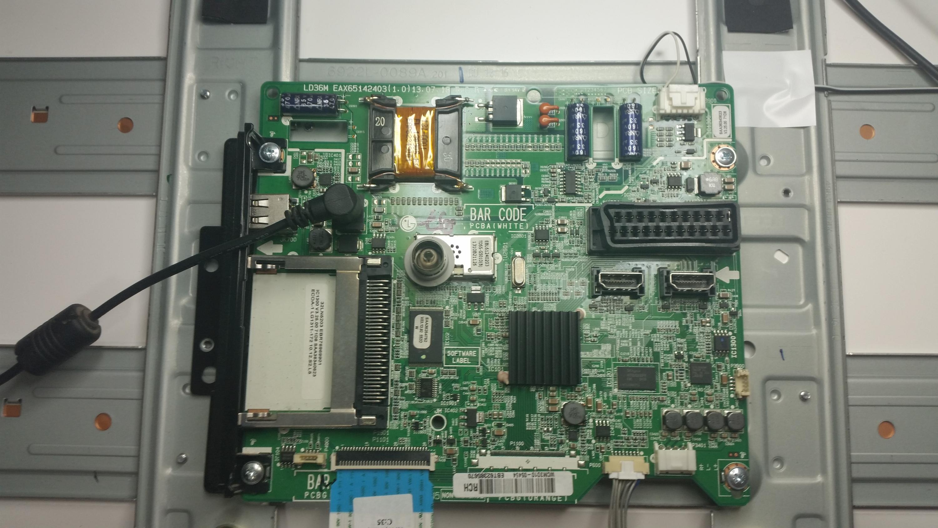

              Re: LG 32LN520B TV power up problem help requested
              Hi Guys

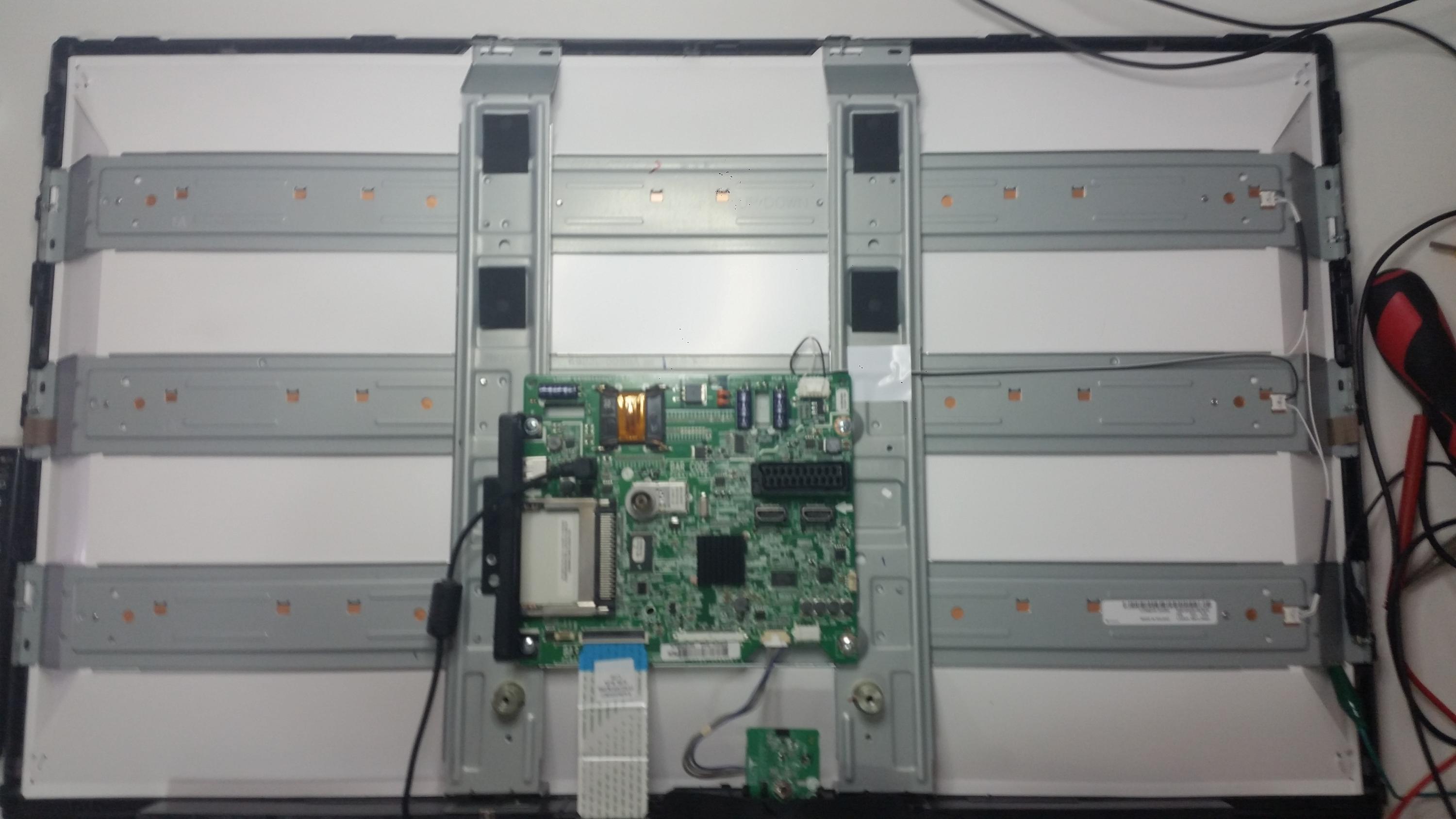

              Thanks for your replies. Only three PCBs in this TV that I can see
              The main one has PSU and most everything else. There is the little PCB with the standby switch (actually this switch also moves left/right/up/down plus press inwards) then a narrow PCB across the bottom of the screen panel
              The little IR sensor did have a part number or SMD code but I would have to desolder it again to see the number. Not a big problem if I really need to.
              Pic of main PCB attached. If these pics not clear enough will get my Canon DSLR out rather than use my phone cam, but I have noticed when I attach pics here they are greatly compressed in file size so I guess that means they lose a lot of resolution?
              Rich

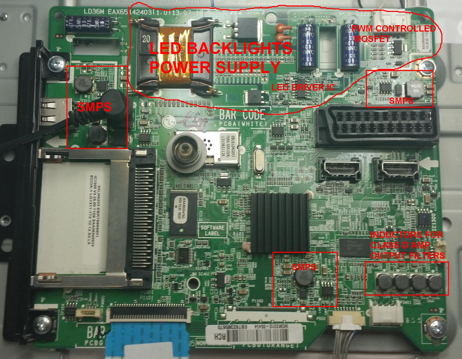

                  That transformer and the SMD power MOSFET and the SMD Diode the LED driver power supply, it boost the 24V DC incoming DCV to around 100VDC or so that is why it has 33uf 160 VDC cap for filter in the circuit.
                  There are lot of buck converter circuits (I see at least 4 inductors for the circuits, not the four inductors by the speaker connector)on that main board to drop down the 24 VDC to run the logic circuits.
                  I believe the TV should function without that IR RECEIVER MODULE in place, so you have to start probing Voltages on the board, without diagram it is going to be tough.

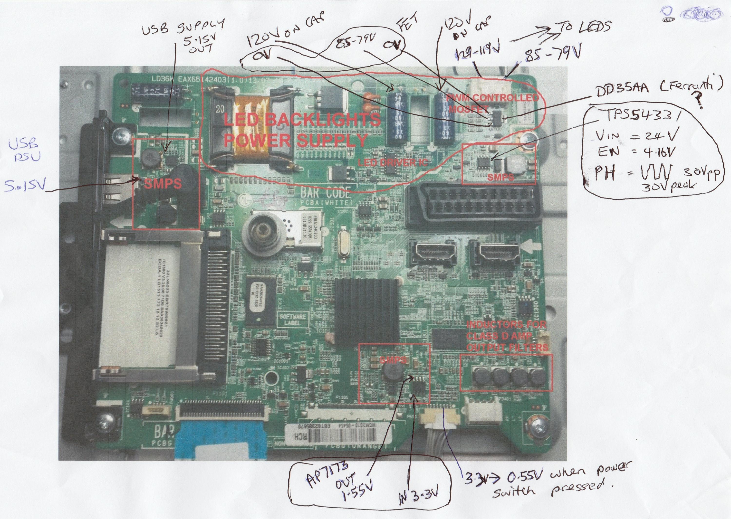

                      Thanks guys for the help so far.
                      Special Thanks budm for that breakdown of the pcb sections
                      given that info I did some more checking - please refer to attached pic.
                      PSU above the pcmcia slot is the USB supply. There is 5.15V on the USB connector V+ so that seems to be working OK.
                      LED backlight PSU - I have 120V on each of the 33uF caps so that looks OK
                      SMPS above the scart socket - IC is a TPS5433.
                      Has 24V on Vin, 4.16V on EN and PH is ackling away quite nicely at high frequency, around 30V peak-peak. The two caps to right of the inductor just above the SCART have 3.3V on them. This looks OK to me.
                      The bottom PSU, the IC Is an AP7173
                      https://cdn.badcaps-static.com/pdfs/...405400f8d7.pdf
                      Has 3.3V on Vin and 1.55V on Vout. Measured R1 and R2 (according to AP7173 datasheet) they both read 2.5K so that should give an output of 3.3V / 2 which is.... hey guess what! 1.55V! All is OK here then.
                      The connector and wires (bottom right) goes to the little pcb with the IR sensor and switch. Pin 3 of the connector has 3.3V on it and when I push the standby/power switch it changes to 0.55V. That seems quite reasonable to me.
                      The connector to top right goes to the backlight LEDs. It has 129-119V on one pin (it seems to discharge when I put my Fluke DMM on here and when it drops to ~ 119V it jumps back to 129V and repeats. The other pin to the backlight LED has 85V-79V on it and follows the same discharge pattern on my DMM.
                      The component below the backlight connector is I think a FET (marked DD35AA and an F logo which may be Ferranti?)
                      Can't find a datasheet for this device, however it has (from the top)
                      0V in pin 1
                      the same 85-79V discharging on pin 2
                      and 0V on pin 3 (which connects to GND)
                      Which says to me a MosFET that is switched off which explains why no Backlight LEDs illuminated.
                      Also that discharging 120V seems a bit odd, like it must be a very high impedance source to do that with a DMM and yet it can't be otherwise it could never supply the LED current Just checked it goes direct to the 33uF caps which do the same discharge thing.
                      OK so that's as far as I am with this, I'm not a newbie with electronics but really not sure what to test for next. Everything I check seems to be OK but something is quite blatantly wrong somewhere as it won't even try to power up.
                      This is my first attempt with an LED TV - they do seem harder figure out than the old CRT ones even though there is less stuff in them!! I do hope that is not typical of these things

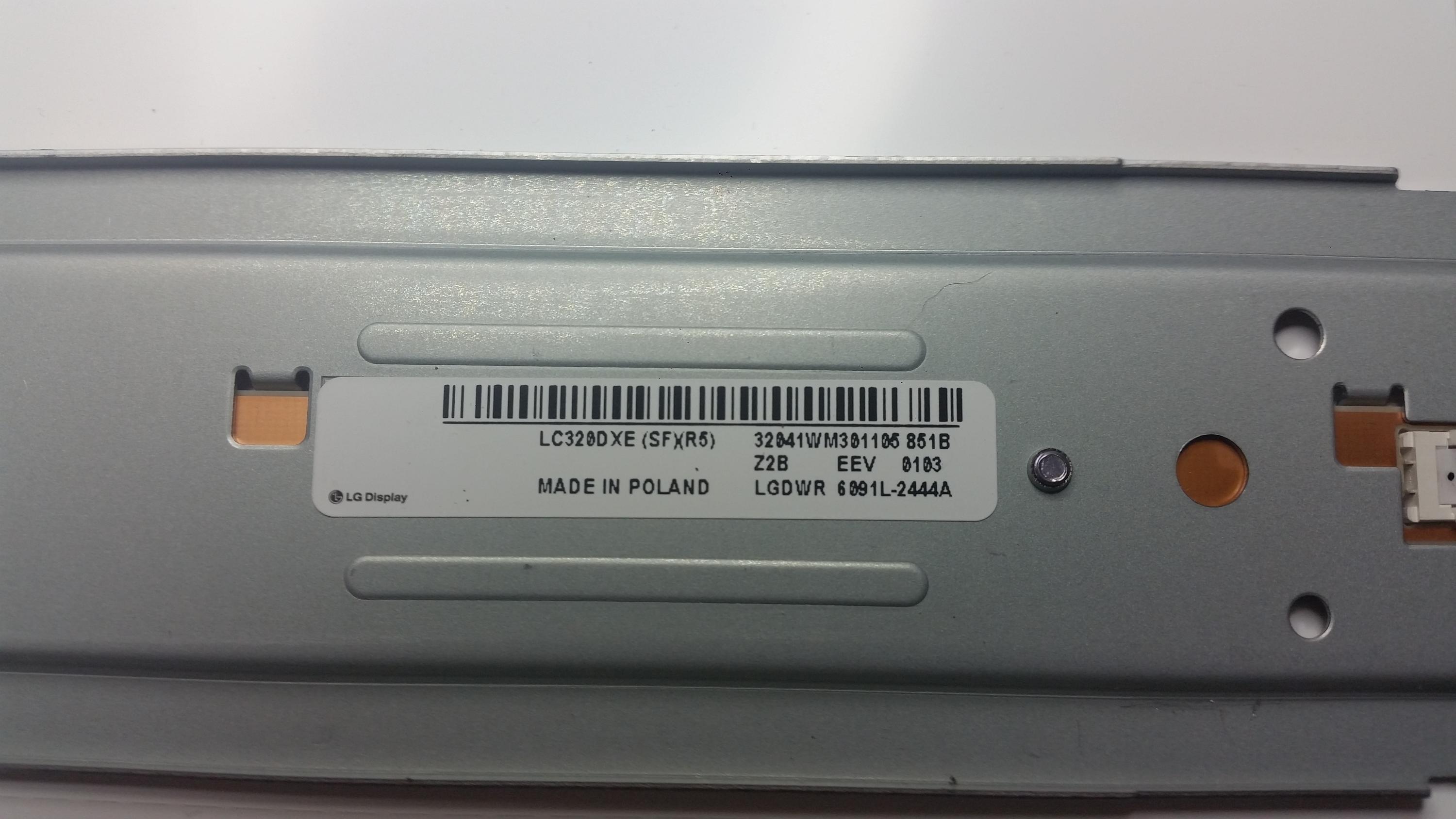

                              The back metal panel of the LCD set normally has a sticker with the panel details on it. Samsung, AOU , LG etc. and model number
                              • dicky96
                                Sun Seeker
                                • Mar 2017
                                • 1825
                                • Spain

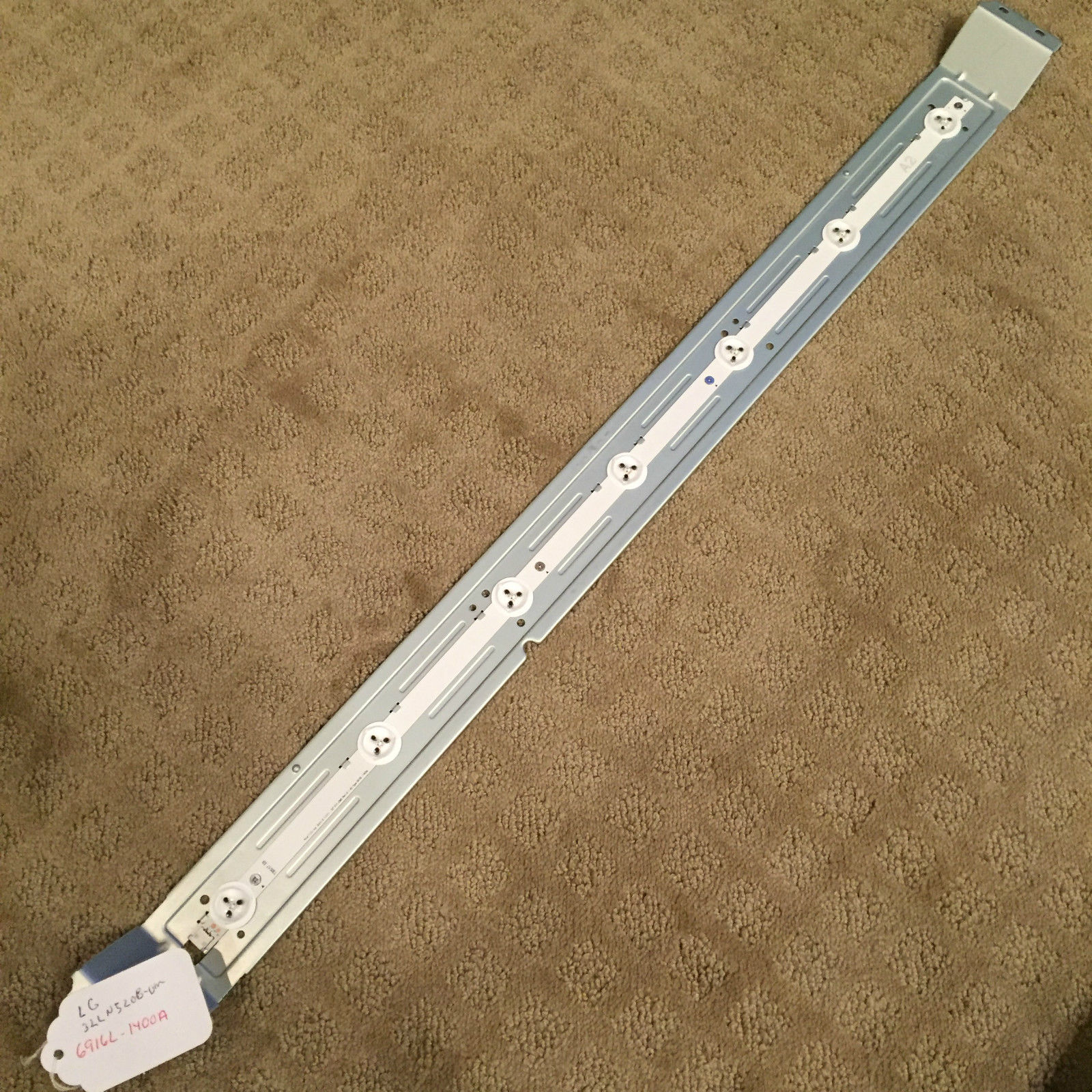

                                @dick_barton
                                Had a look on reverse of the PCB - no components or markings at all.
                                There is a sticker on one of the bars that support the LEDs
                                See pics, these any help?
                                Cheers
                                Rich.
                                Follow me on YouTube
                                Learn Electronics Repair
                                https://www.youtube.com/channel/UCFX...R8UZ2vg/videos
                                • dick_barton
                                  • Aug 2015
                                  • 6642
                                  • Wales
                                  Thanks for the information which proves useful.
                                  There are 3 strips of 7 leds per strip = 21 leds.
                                  If 3V/leds = 63V and if 6V/leds 126V.
                                  You say in post #11 "the voltage is 129V when first switched on" so the leds should flash and then the voltage falls turning the leds off.
                                  I suspect that if the 3 strips are connected in series (42V/strip) that you have a led(s) fault.
                                  If you have access to a current limited power supply then I would test each strip.
