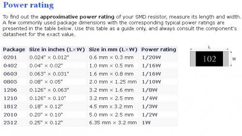

                                        i maybe wrong but i think (K 1608 X7R ) means
                                        C = Standard. Two significant digits and number of zeros. J = ±5%. K = ±10%. M = ±20% ... This option is limited to EIA 0603 (1608 metric) case size devices.
                                        so maybe
                                        http://www.ebay.co.uk/itm/10-X-CAP-M....c100677.m4598
                                        or cpc but they now have a £5.00 minimum order
                                        http://cpc.farnell.com/avx/0603yd474...x5r/dp/CA07662
                                        try rs components or cpc etc im not sure if wiltsgrove in river street birmingham will sell them
                                          #60
                                          Re: LG 32LN578V - Picture; No Backlight
                                          smd sizes
