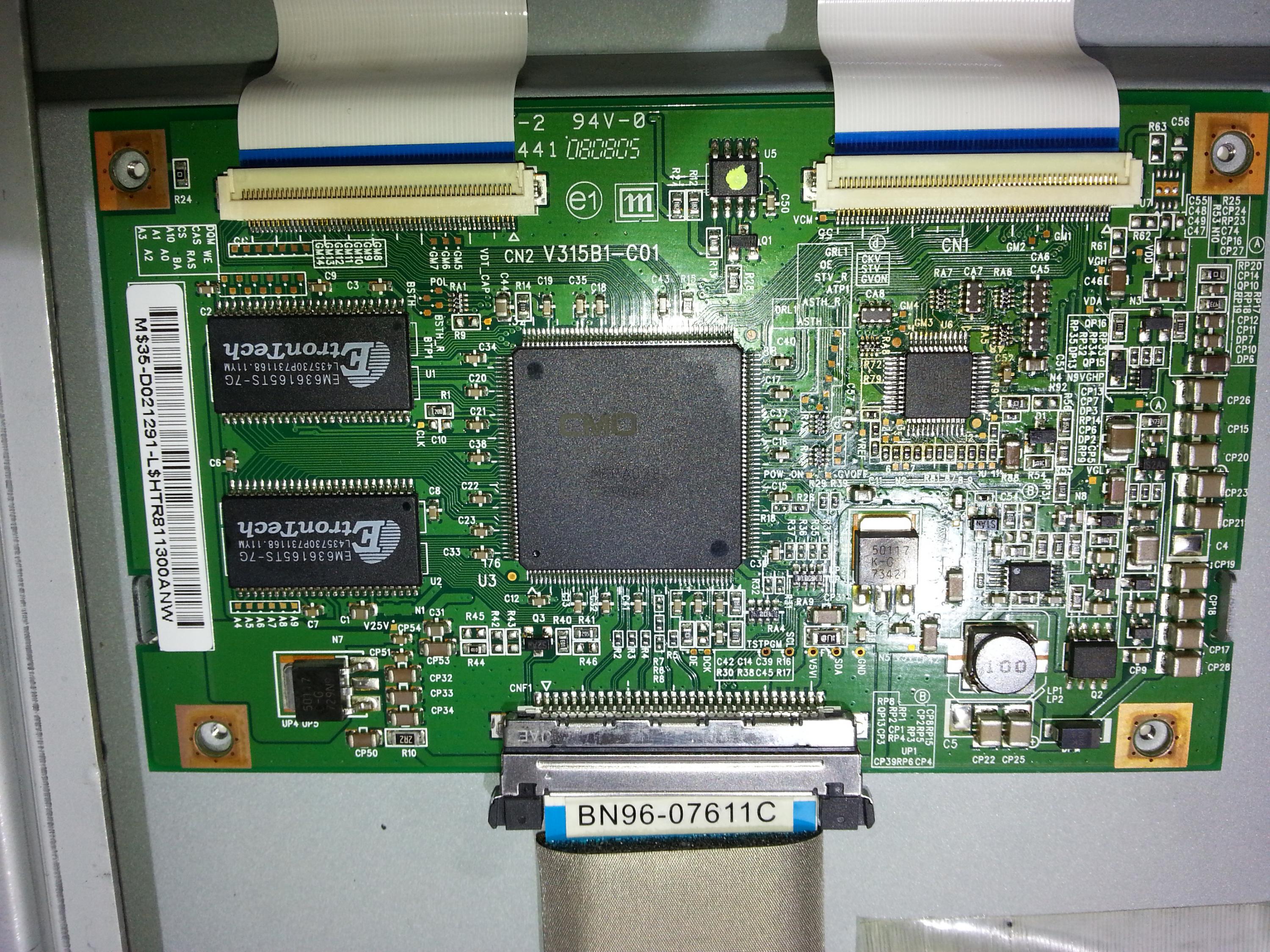

    Good day folks. Hopefully someone can point me in the right direction with this Samsung TV which displays a white picture even after replacing the AS15F on the T-con board. I checked the caps on the T-con board and they seem OK. Someone told me it could be a panel fault...has anyone else had this issue when the picture's still the same even after replacing the gamma IC ? Any point in taking off the metal frame and inspecting the buffers ?

    I take it you've removed the possibility of it being a faulty AS15 by measuring the gamma voltages ?

      To be fair I haven't measured those. I just assumed that replacing it with a new part would immediately eliminate the possibility of that part being faulty. You may be right to a degree, though I doubt the new part is also faulty out of the box...

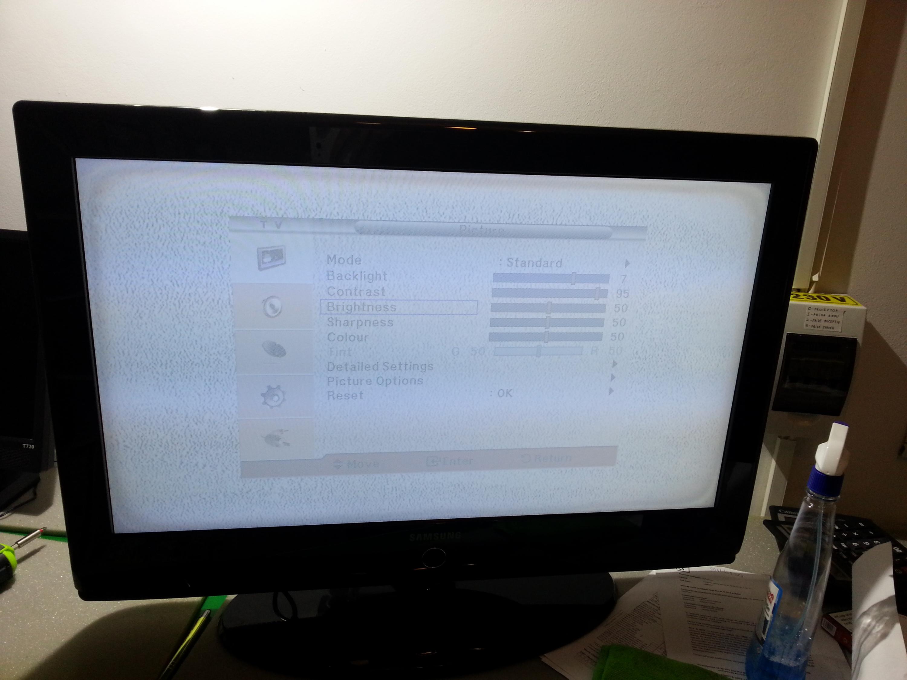

        This is what the picture looks like. As you can see, the OSD is affected as well.

          Have you tried the Tcon self test as on page 30 of the pdf attached.

            No, I have not done that because I didn't know about it, plus the T-con in that brochure doesn't match the one I've got and I'm not sure how well the results can be replicated on a different T-con without letting the magic smoke out...will definitely keep that in mind in the future.

              Surely there is a gamma correction /as15 problem, are you sure the ic was new? Or you picked one faulty previously removed? Or it is a soldering problem, check it well... if you are in doubt post pictures of the job, how many as15 you have replaced?

                First things first: Measure the Gamma Voltages!

                  I too believe it's still a gamma issue. The IC was bought new - I never save any SMD parts off of old boards anyway and I never use salvaged parts for clients because they may fail shortly after. I've already closed the set back up, but the solder job looks perfect to me - almost factory made. I wouldn't call myself a pro, however, I have replaced several of these with positive results. Perhaps something killed it immediately after startup :|

                    AS15 is powered from AVDD signal that is 16v approx., check theese vcc pins..
