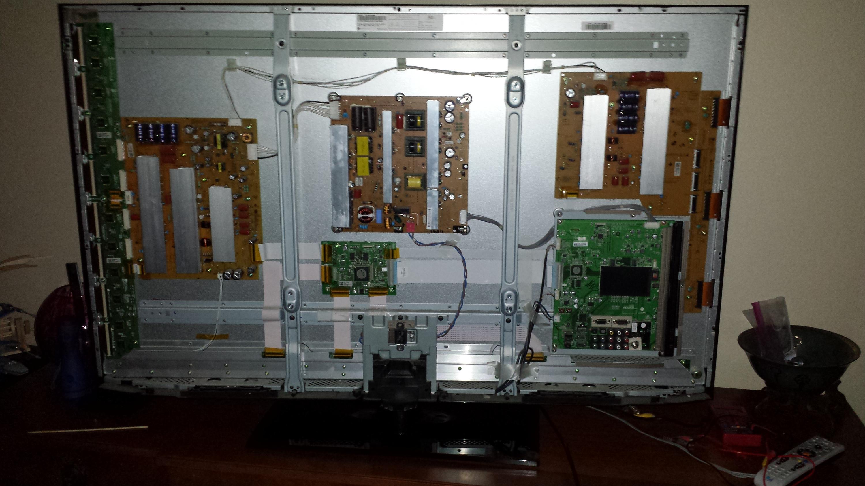

    I need help trying to diagnose which board might be bad on my LG Plasma 50PZ550-UA TV. I can turn it on and see a faint glow on the screen, but no picture or sound, and the only button that works is the on-off switch, I can press the other buttons like menu and volume control and the red LED on the front panel will blink to indicate that the button was pressed, but nothing happens on the screen. I've already removed the back and checked all power supply board output voltages and they are all there on the correct pins on all output connectors, so I'm confident that the problem is not the power supply.
    I've visually inspected all other circuit boards in an attempt to locate any obvious problems like blown out or puffed up caps, ICs or transistors with holes or burn marks, etc, and I did not find anything that's obviously bad. I now need to try to figure out which board/s might be causing my problem, and I'm not quite sure how to proceed with doing this, so any help here would be greatly appreciated, thanks.

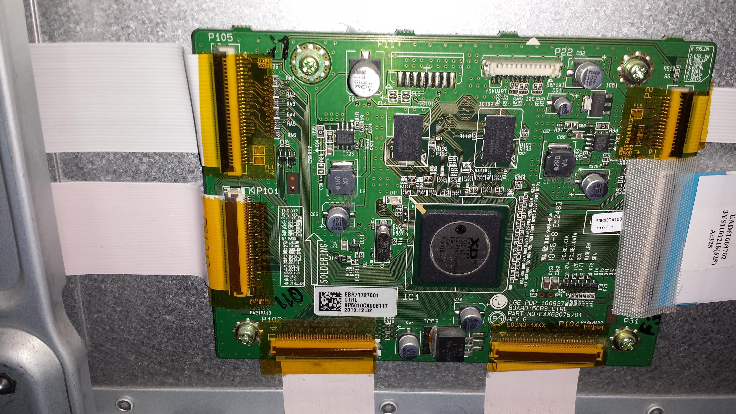

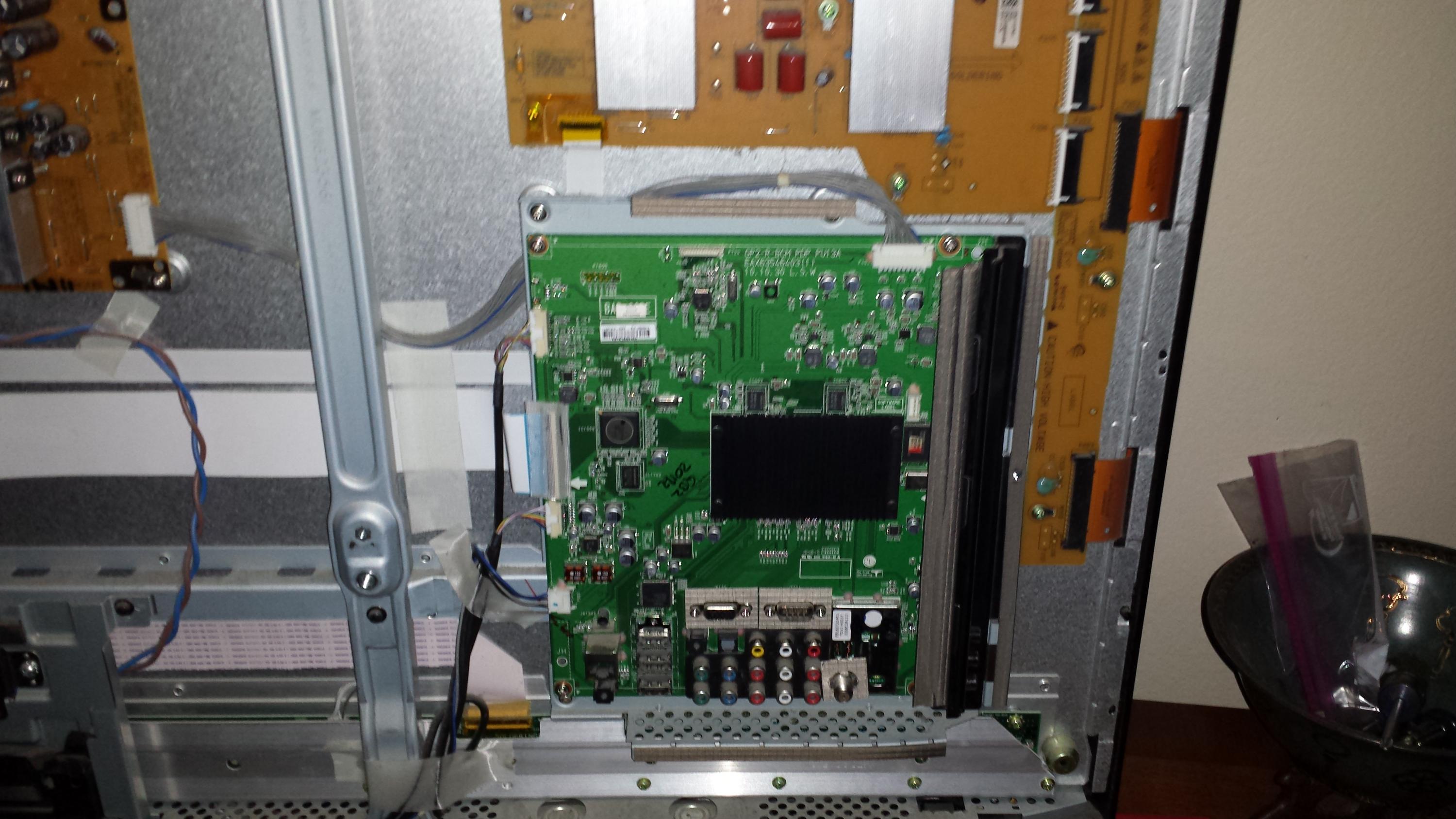

                  Okay, the first picture is the logic control board, followed by the main board, and then the whole set of boards.

                    Short the two holes next to R51 & R52 with a paper clip or piece of wire. Unclip and remove ribbon cable A:325, power up and check if you have patterns on the screen.

                            I finally got around to doing this test, and it works, I have the test patterns on the screen, solid red, solid green, solid blue, then gray, followed by a series of sweeps across vertically and horizontally. So I'm going to try to find a main board to order for it.
                            I found one on ebay that has a slightly different part number, and have asked the seller if he knows if the part number he has for a 60" plasma, EBT61533403 is compatible with the board I have, part number EBT61533103, maybe you or someone else on this thread would know? Both the ebay board and my board have an additional part number that matches completely, the number is: EBR73043303. So I'm thinking that maybe they are compatible, but I just don't know for sure, the look the same in the pictures?

                              Try reflowing the BGA under the heatsink.
                              If that fixes the fault you could consider taking the board to a TV/console/pc repair shop and ask them to reball it.
                              Should work out cheaper than the replacment part.
                              However if you give it a good reflow it can last for a decent amount of time anyway.

                                I will remove the board and have a look, but I'm not sure I have the solder skills for doing a re-flow on something like that? Although there may be something to that, since I can't see anything obviously fried on the board as it's mounted. And I did run across several internet postings on youtube and other places about putting main boards in the oven to make them start working, but I'm a little leary about trying that?

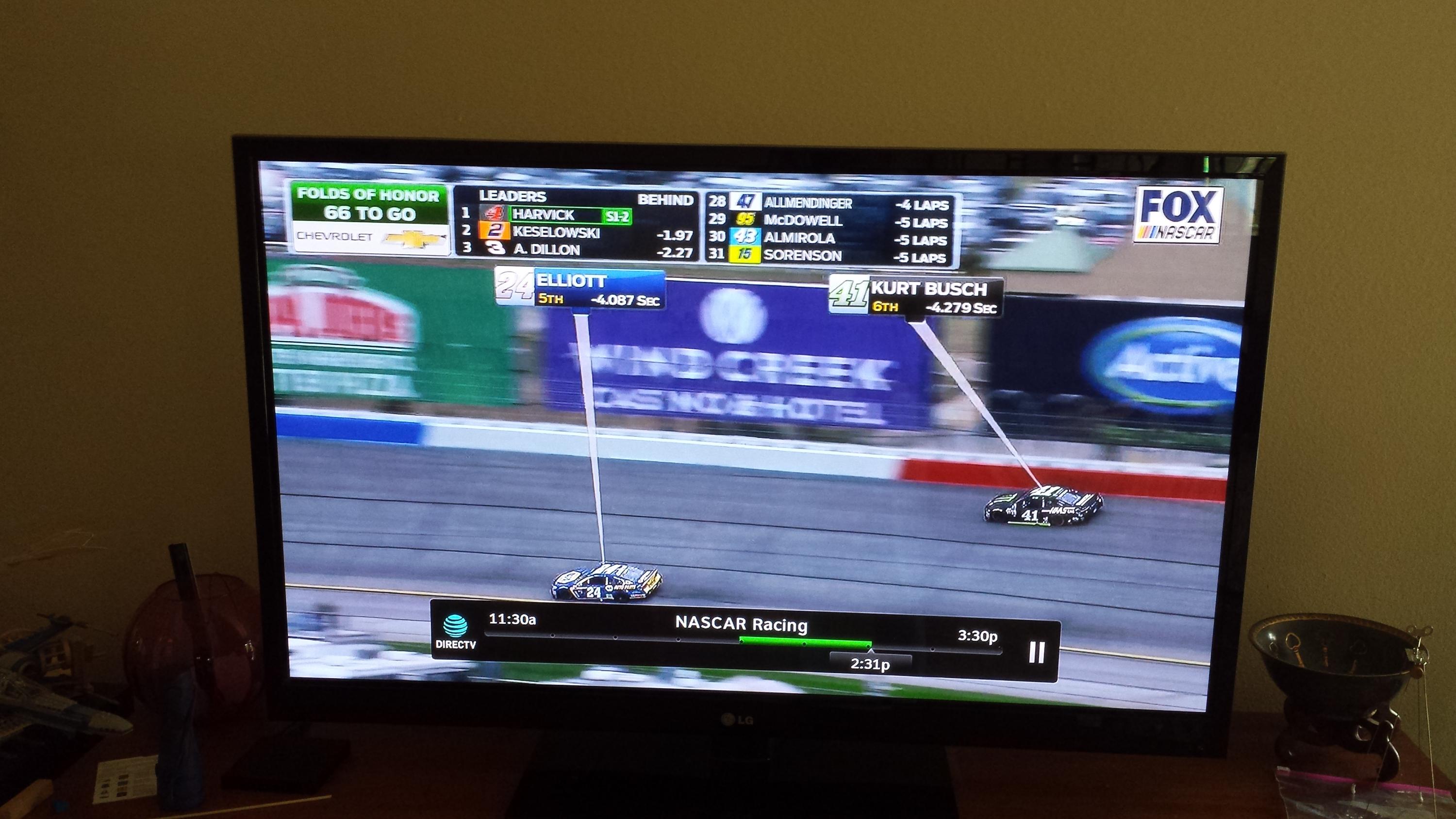

                                  I fixed it, probably by, "reflowing the BGA under the heatsink...", as suggested by Hamie. The process I used to accomplish this, is shown in the following youtube video, with about 2 minutes of heat gun on each side of the board. I was pretty surprised that it worked, but it did amazingly enough. Thank you all for the help with troubleshooting, I'm really happy that I don't have to spend money to fix this right now.
                                  https://www.youtube.com/watch?v=8sslythR5HE

                                    Forgot to attach the proof of concept photo.
