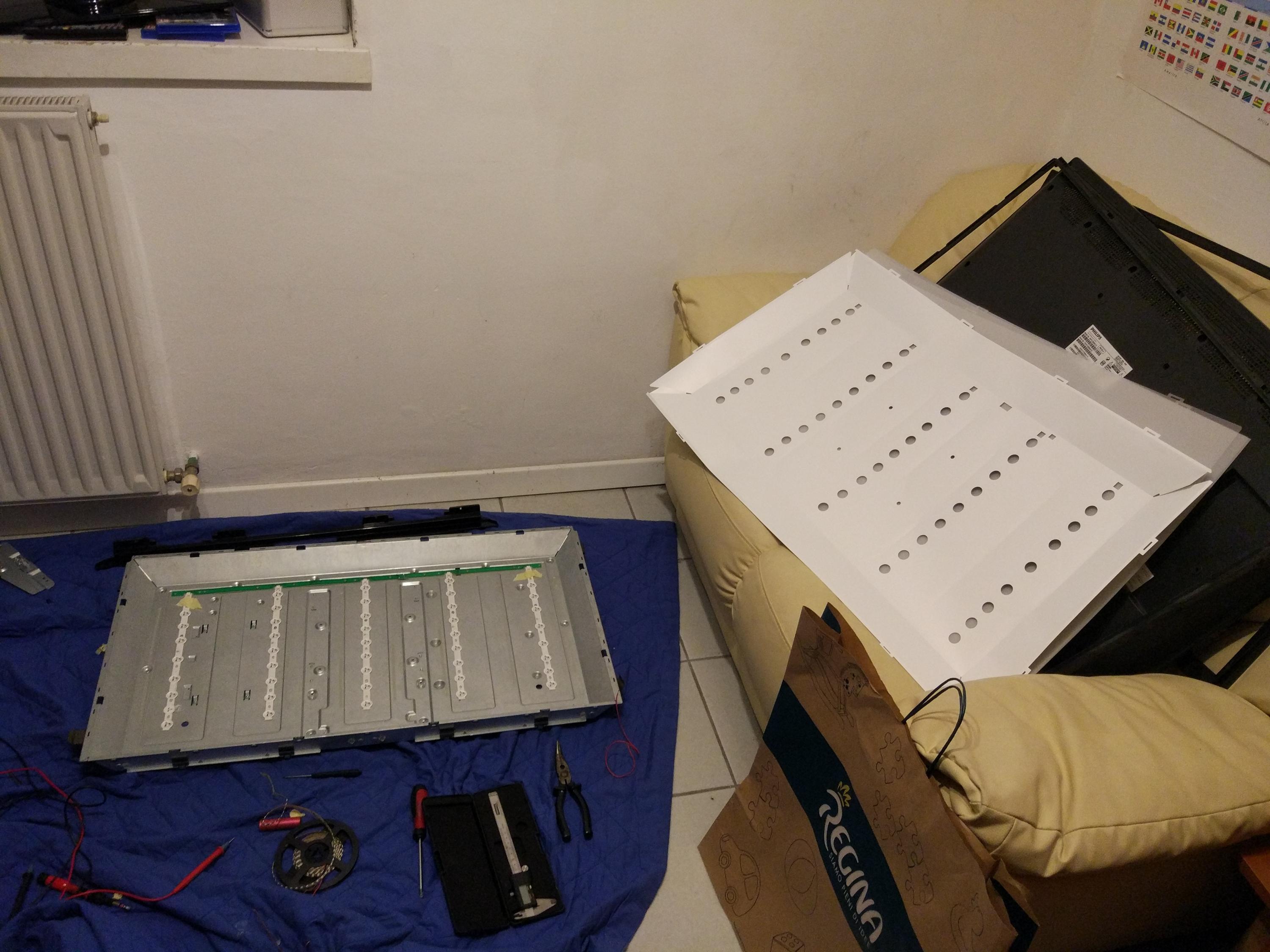

    Hi, I have this tv with the backlight that doesn't work. It's a vestel set.
    I've opened it and found three bad leds. I've replaced them with 3 led from a 3528 led strip.

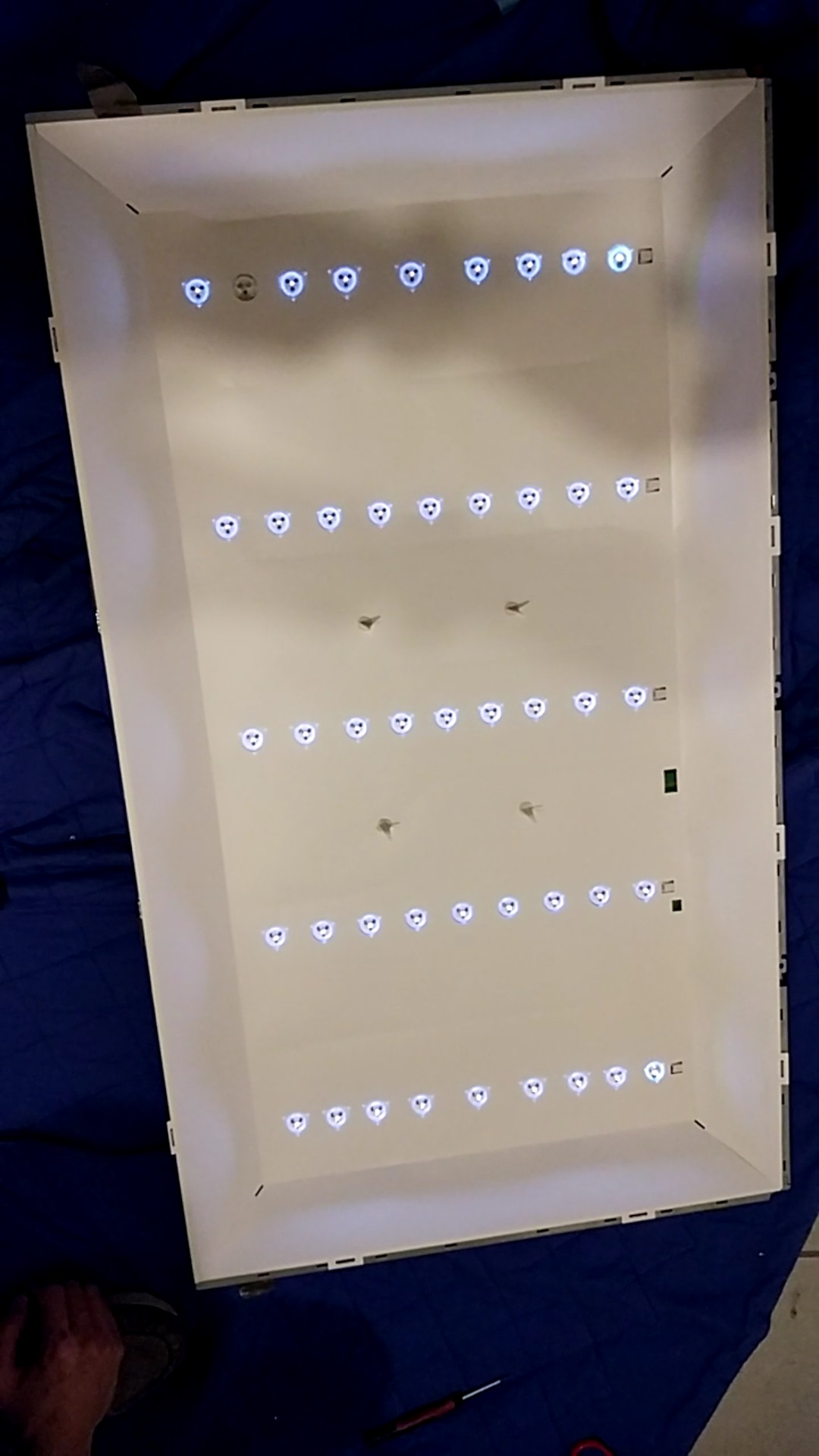

    Now every led lights up but the brightness is very low and slowly fade away (20 sec)
    How can i solve this problem? maybe i can put a small resistor near the new led that I have replaced? because I think that it hasn't enough resistance
    I wouldn't like to buy new tv led strip because this tv is crap and it's not worth it
    Sorry for my bad english

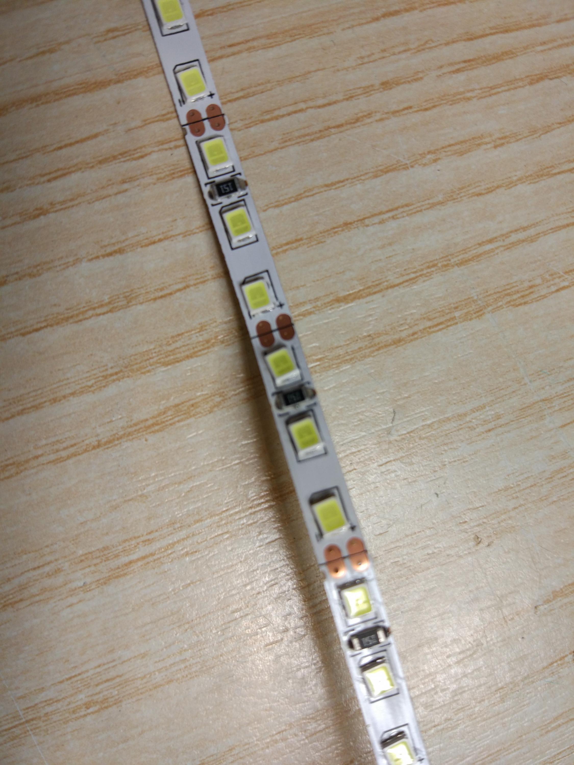

      i don't know about the replacement leds from the strip, I know that the strip can be cutted and powered with 12volt every 3 leds.
      At the moment I have installed (to replace the original led burnt) a Led from the strip with the resitor (with 151 written on it) because without that restistor the new led burns immediately.
        Re: PHILIPS 40PFL3008H led backlight repair
        Well those LEDs on the replacement strip are NOT made to handle 200~400mA, I doubt that since 3 LED per section so total Vf is about 9V, that leaves about 3V vdrops on the 150 Ohms current limit resistor which the current for the LEDs is limited to 3V/150 Ohms = 20mA (0.02A), so no wonder those replacement LEDs blew up!
        You need 1W rating LED!

            If you don't replace them with suitable leds then it is highly probably that more and more will fail very quickly.
            You could by a led strip for your set and do a stacking method or replace the faulty ones with ones from the strip.
            If you search the forum you will find information on both methods.

                  I've short out the pads and now the tv works great! i have set the backlight to low and updated the firmware.
