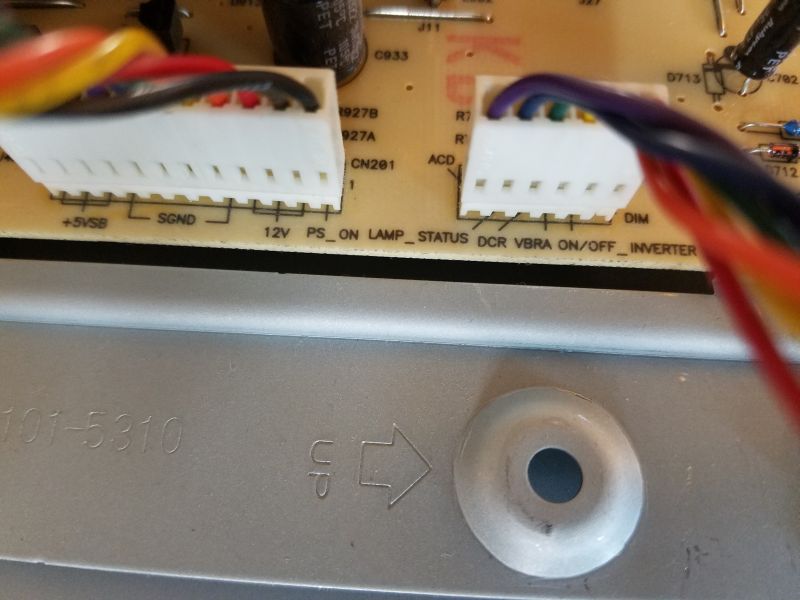

    The power board has the connector with three 5VSB (standby), five SGND, three 12V, and one PS_ON. SGND is ground?
    With the power plug attached and tv off, I get 5.23V from the three 5VSB and nothing on the others.
    Power on, 5VSB's are 5.20V. The 12V are 12.26V and PS_ON 2.26V.
    Looks good to me... is PS_ON 2.26V within spec?
    The next connector over, when off, no voltage at any pin. With power on:
    ACD 0, Status 0, DCR 0, VBRA 0, On/Off Inverter 2.26V, DIM 3.05V.
    Don't know if this is as it should be?
    Next step is inverter? Not sure how or where to test it.

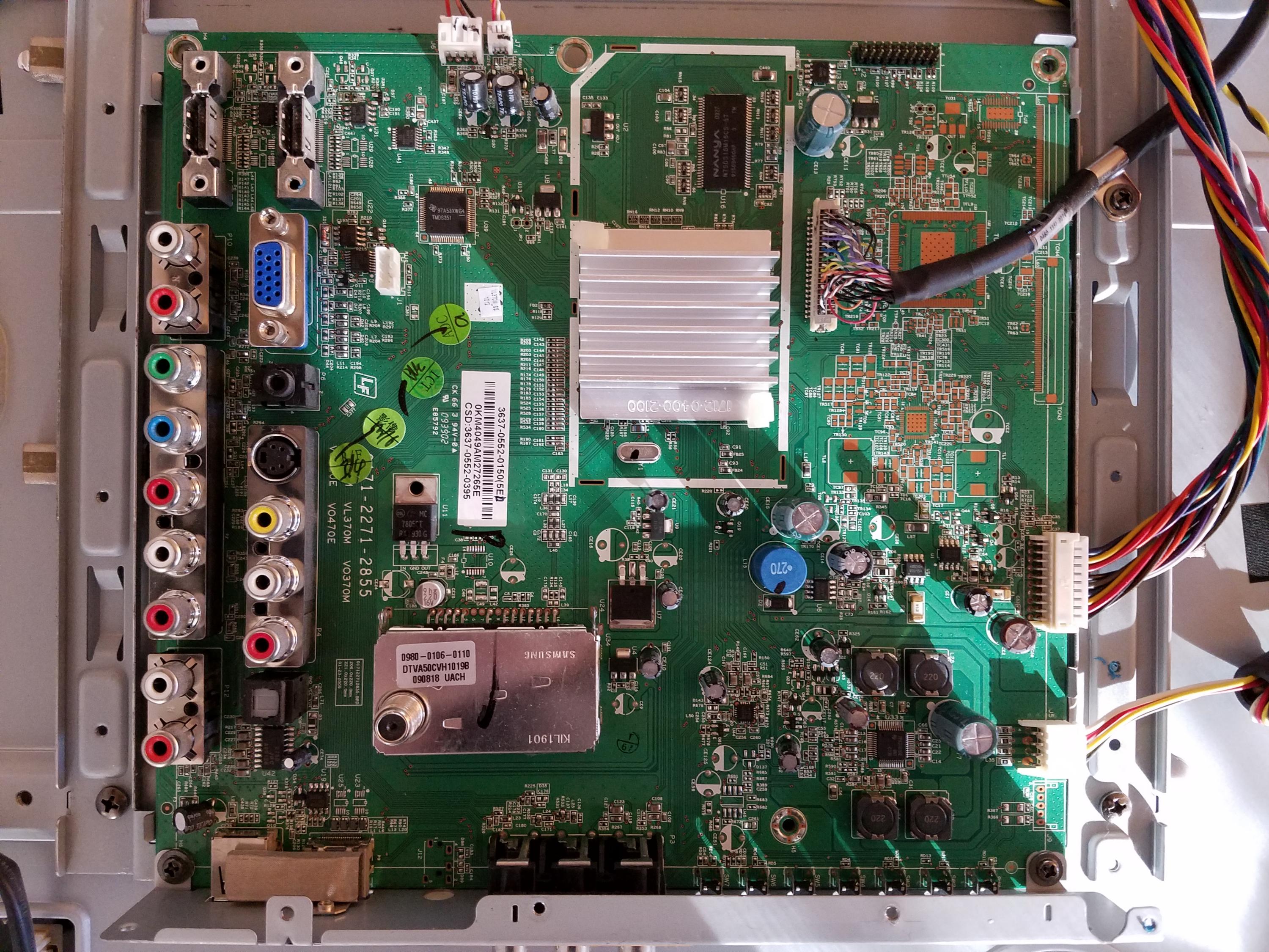

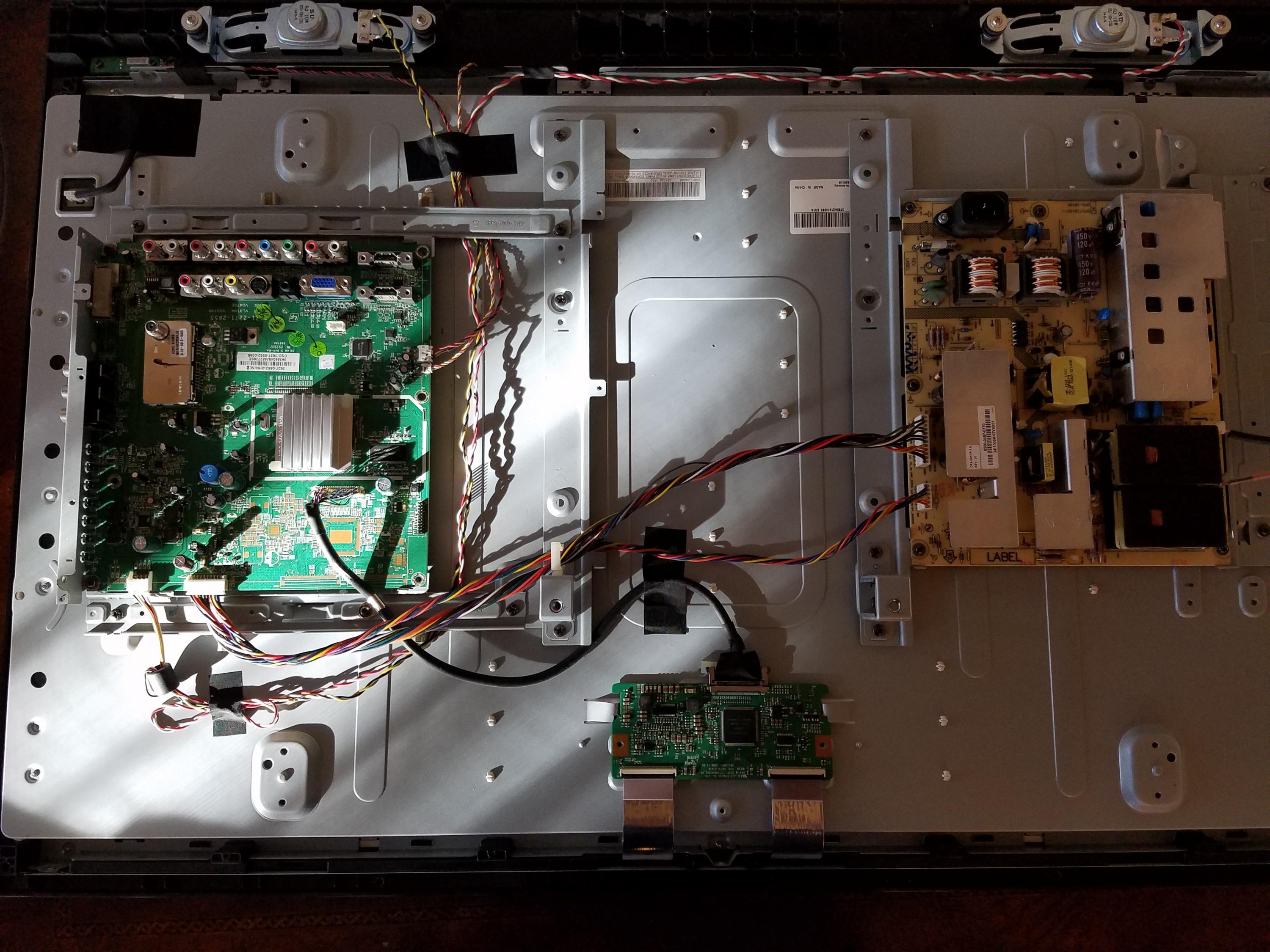

      Please up load good clear pictures of the whole back side of the TV showing all the boards.
      • Hallatauer
        • Aug 2014
        • 9
        Re: Vizio VL370m LCD
        dskall.. no flash...
        Budm... photos

                With power on:
                im not sure what the first 4 that are reading 0 volts are for

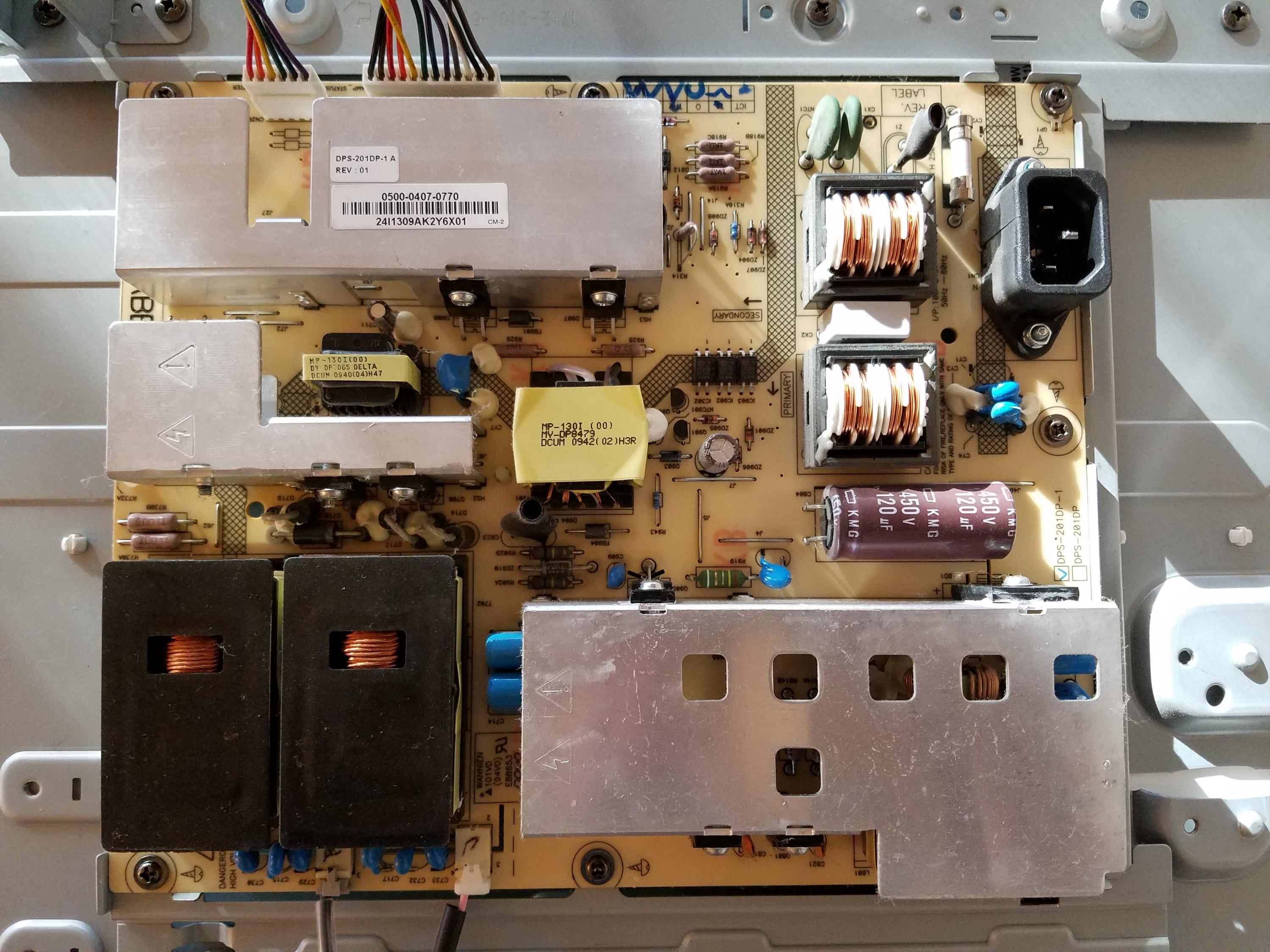

                can you also take a picture of the back of the power supply thanks
                • dick_barton
                  • Aug 2015
                  • 6643
                  • Wales
                  Can you post a picture of the bottom of the power supply board as well focused as possible.

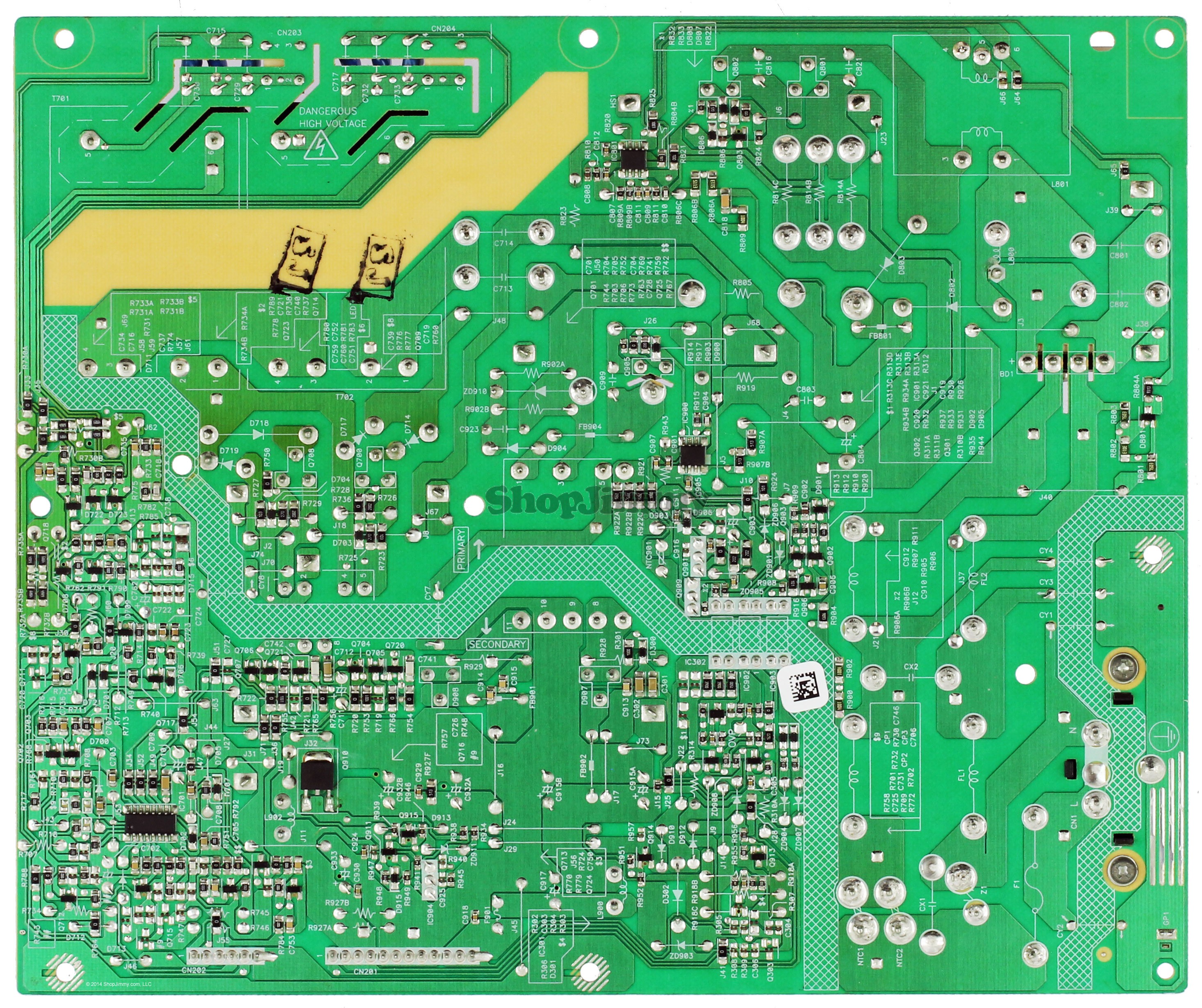

                      i didnt realise these boards had a 24v section, (so in post 8 please ignore my comment regarding the 24v question) i was trying to work out what section provided the voltage too the transformers.
                      some clear pictures of the psu on shopjimmy
                      http://www.shopjimmy.com/vizio-0500-...pply-unit.htm#
