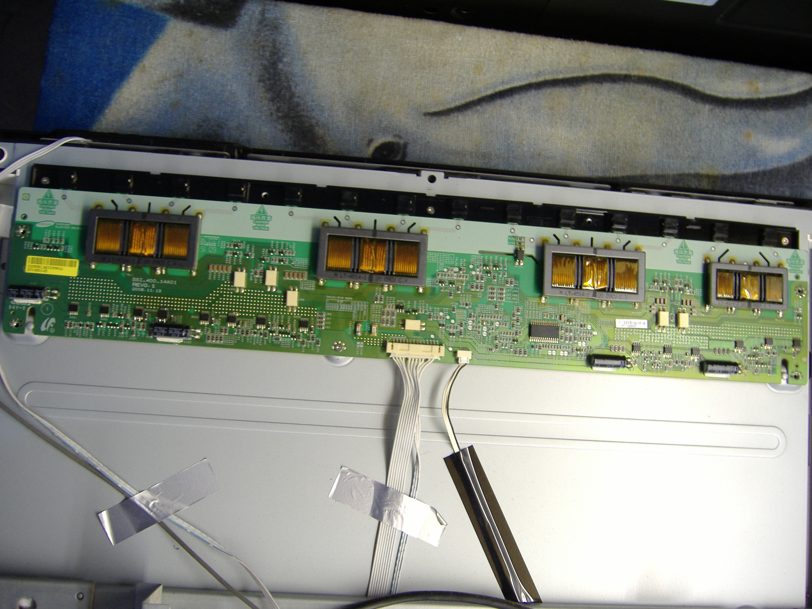

    Hi Guys,
    This television came in without a picture two weeks back. It was switching on with the led going from red to blue.
    The 24v & Blon were present, so I took the inverter pcb out to check for shorts.
    The invertor pcb divides the 24v to two banks of cemfets. One of the 7amp fuse's suppling one of the banks was open, with a dead short on that particular bank of cemfets. (AO4614B)
    I replaced Q321 AO4614B with an AO4614. (no B)
    The specs' show the AO4614B capable of handling 30amps pulsed drain current, the AO4614 20amps pulsed drain current.
    The set has come back with Q321 short & fuse blown again. (obviously weaker)
    I've replaced with the same AO4614. (No AO4614B on hand & cust eager)

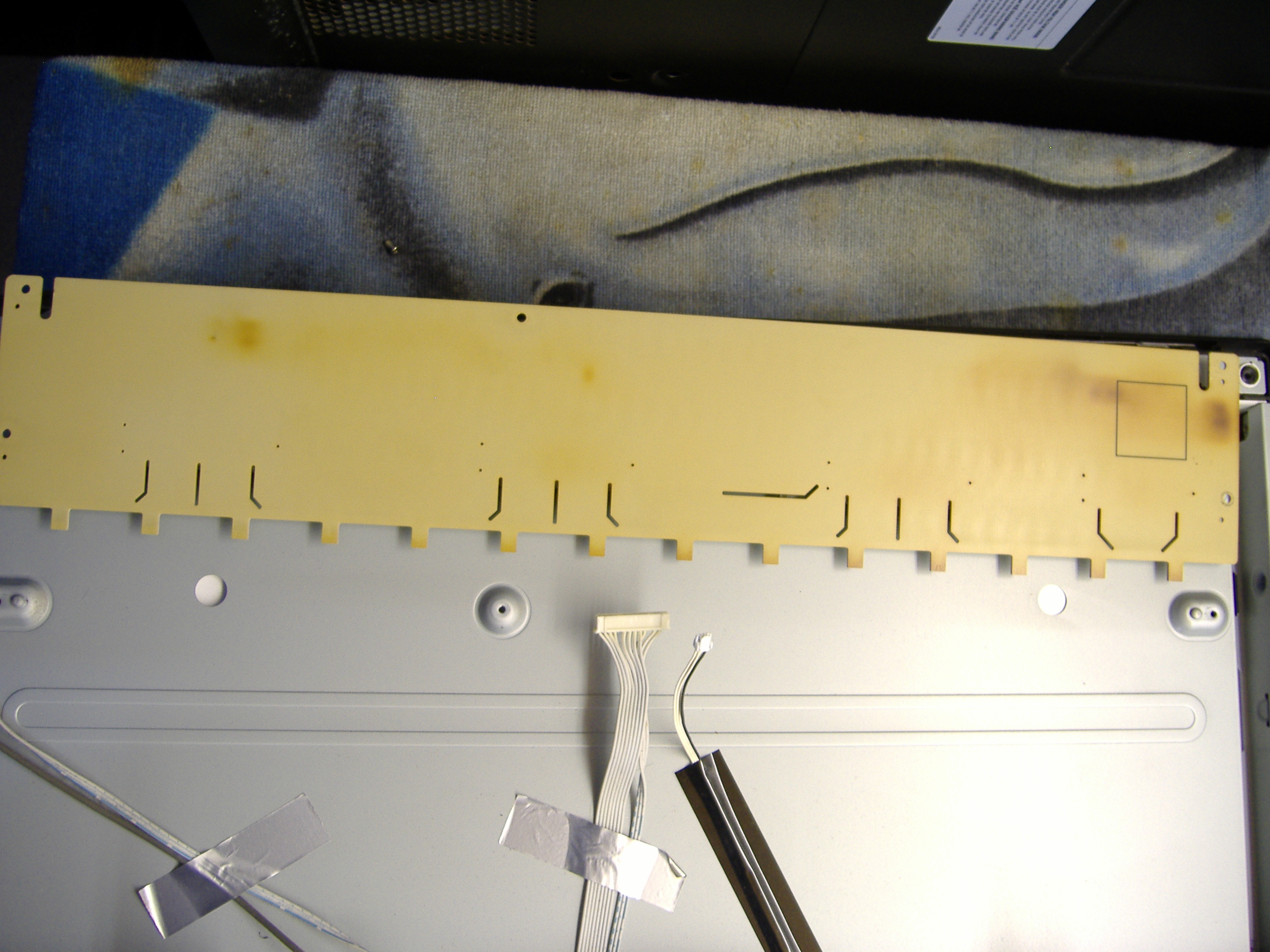

    Why after running awhile do all the cemfets get very hot?
    (can't believe some thing so small can endure this heat) see photo
    Busy trying to source the AO4614B.
    It is an old Lcd, and I'm sure the panel has seen many hours.
    Should I replace all of them in one go, or one at a time as they fail??
    Seems like a silly question, I just need some input please.

    Re: Sansui STY0440 cemfets hot/ failure?
    Watch my vid matey on the SSI-400-14A01 buddy you need to resolder lots of SMD parts that can cause the fets to blow as well as the SEM2071 or whatever it is.
      Infact Im in such a nice mood I will save you the effort watch this:
      https://youtu.be/2QTfOy4BUpU

        Thanks Reecey, grand of you, I was about to ask how to get there, Thanks.
        I've had 3 returns on the same day, so not so grand this side. Will post other 2.
          Thanks again Reecey. Identical set in clip as mine. Now to try source new chips.
          I had ripped second hand ones off another board.
          Is there a reference library of sorts that would have led me straight to the clip on utube? or would I have had to go through all the clips to get there?
