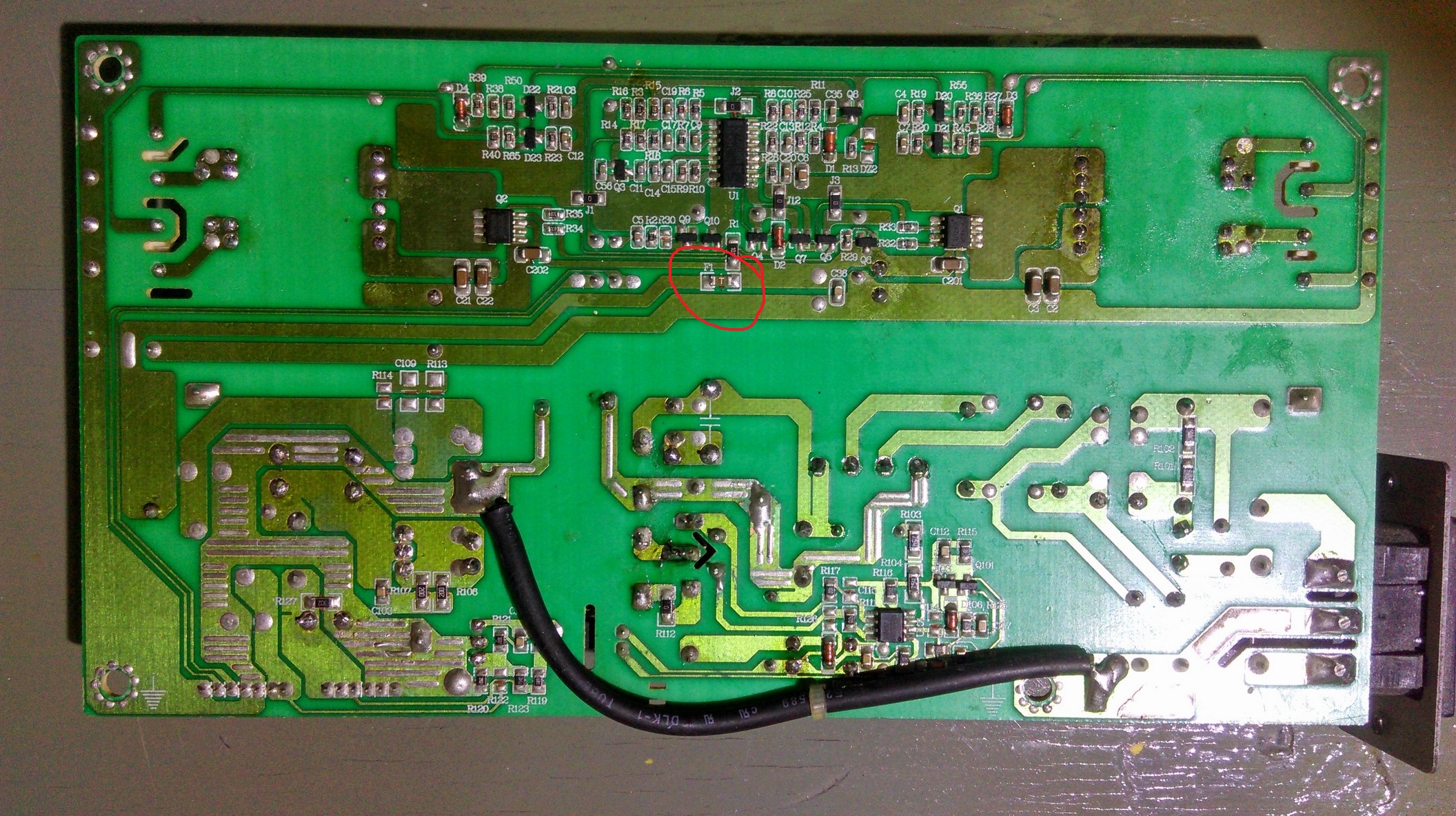

    Vivax Imago lcd tv 2230 no backlight
    Hi!

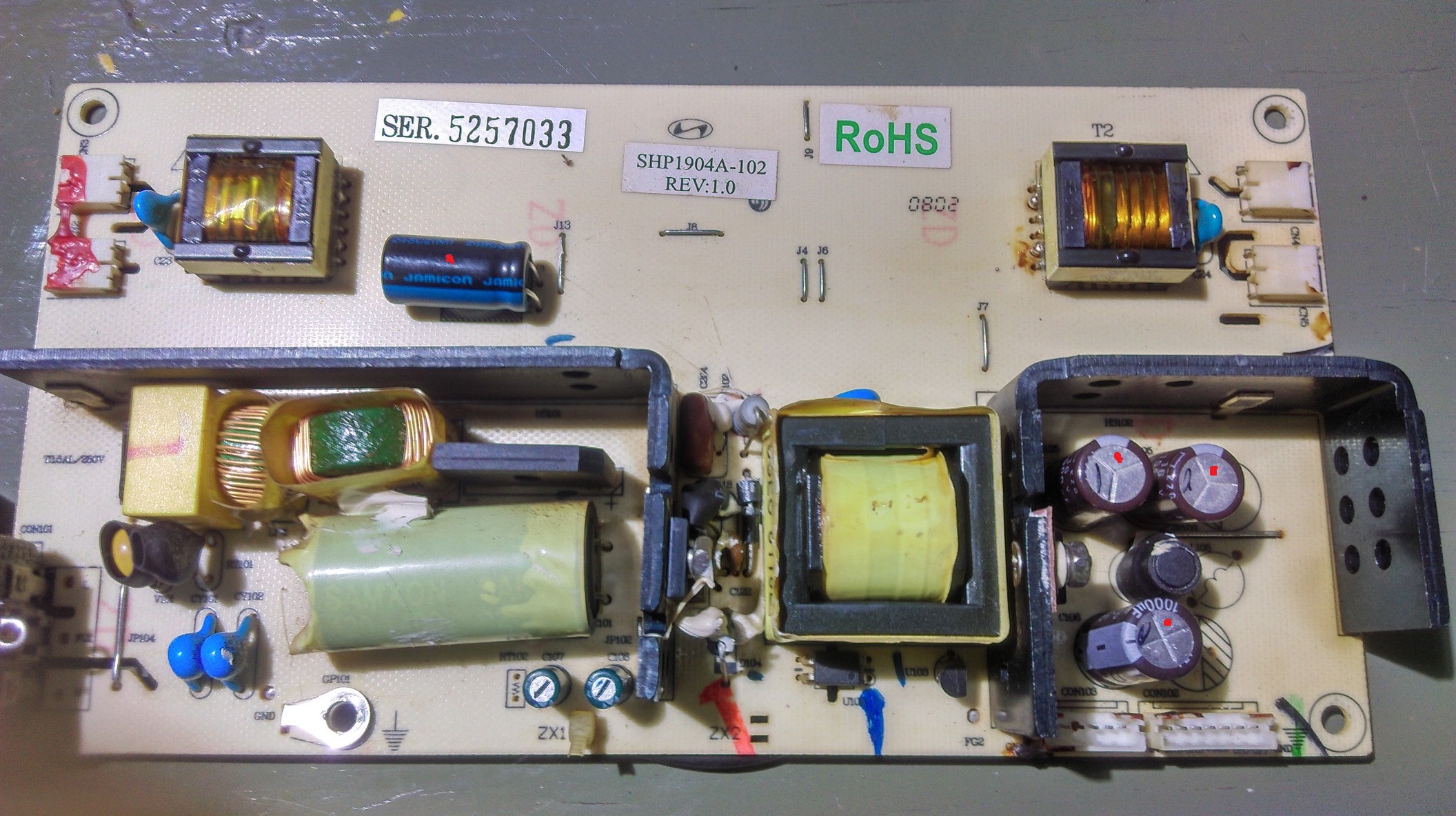

    I got problem with my lcd tv.
    There is no backlight but picture is there when flashing with lamp.
    There was 4 bulged capacitor (marked with red dot on picture). When replace all 4 capacitor still no backlight.
    I try to put spare cfcl lamp but nothing happend.
    This is markings of board: SHP1904A-102 REV:1.0

    Will need to post some voltages to see what's missing

      i got 12v on pins. but no 5V
      buzing sound came frome transformator

        i find blown smd fuse. There is mark on them "T". i don`t know values for it?

          Re: Vivax Imago lcd tv 2230 no backlight
          page 5 may help
          https://cdn.badcaps-static.com/pdfs/...acfc979420.pdf
          SMD SMT 1206 Fast Acting Fuse 5A 32V
            Use your ohm meter and check there is no short or low resistance at either end of the fuse to ground. It blew for a reason and the fault may still be there.
