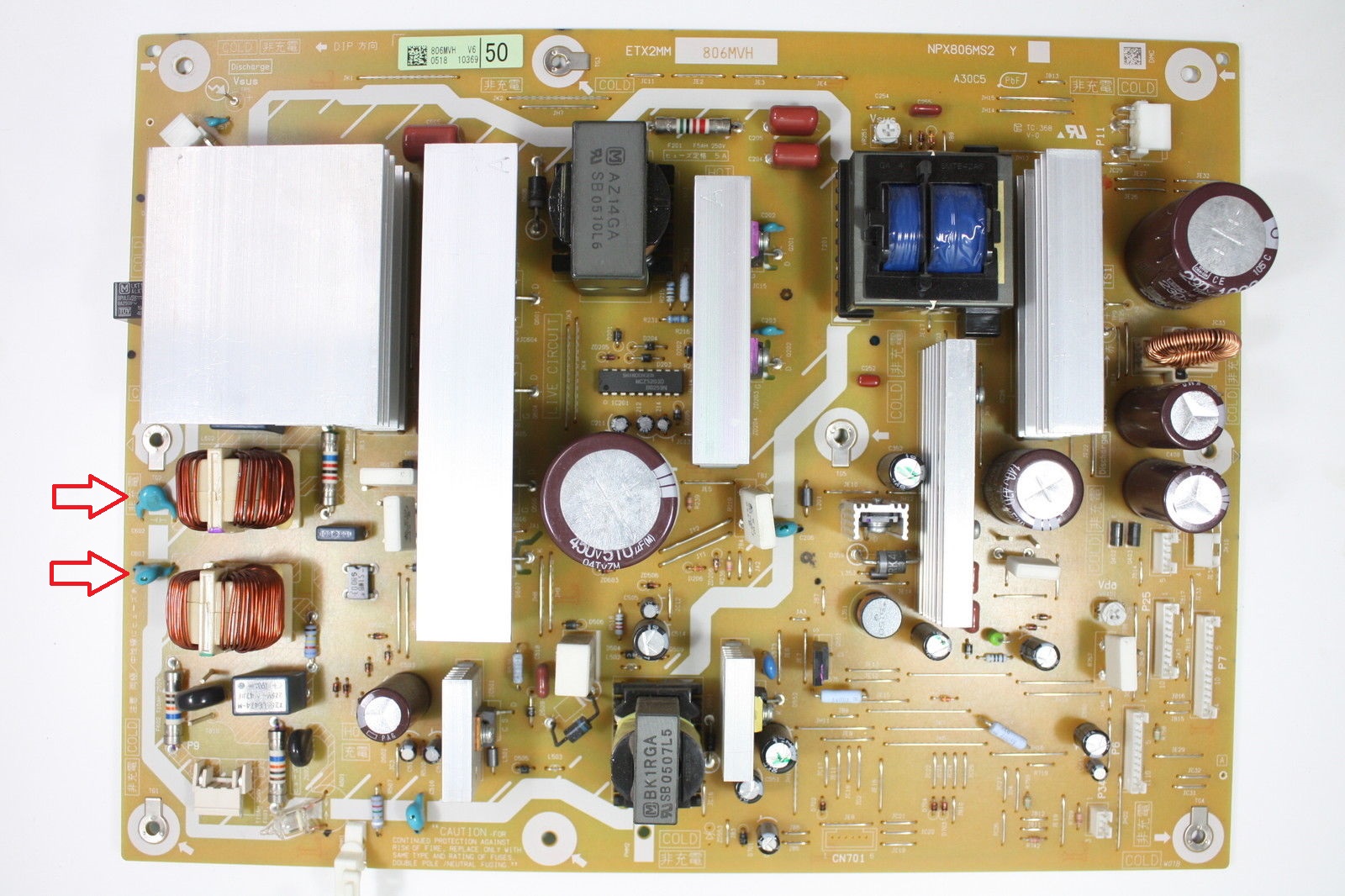

            #65
            Re: Panasonic 50" VT20 arcing at edge of panel to frame
            I've been following this out of curiosity. 20 years or so ago, a friend and I arrived at a customer's house to repair a C-Band satellite dish. We got quite a surprise when upon touching the dish, we got a nasty shock. It took forever to figure out where the voltage was coming from. Turns out, the person's TV had a defective capacitor (or at least that's what he was told later by the repair shop). It was feeding 200V or so to the chasis. The voltage was then traveling over the outter braid of the coax to the satellite receiver and then all the way out the coax to the dish.
            Turns out, the voltage was also what had damaged the satellite dish. It caused a failure on the motor that rotated the dish itself.
            • dick_barton
              • Aug 2015
              • 6643
              • Wales
              #66
              Originally posted by infrag
              OK fair call.
              How do I test this and what Cap am I looking for?
              Happy to post pictures of the psu if needed?
              In the circuit attached they would be CY1, CY2, CY3 & CY4 all which connect to chassis so look for similar ones on your power supply board. I would remove and test.
                Well to be honest the schematics give me a headache. I'd rather try to find them in circuit... Anyway I've had a look in the PSU for the caps going down to earth and found a few. I have 1 suspect which I've tested before but put back in as it seemed close enough.
                Its a 230V 1000uf cap. It tests at 913uf. Initially looking at it seems fine but comparing to the other caps it has what seems like the begininnings of a bulge. Hard to say though. A resistance test returns 515kh reverse polarity and a jumping erratic reading the right polarity way.
                Any advice on that or should i just wing it and get another one?
                • dick_barton
                  • Aug 2015
                  • 6643
                  • Wales
                  #68
                  The blue caps in the photo are probably the capacitors. Check if they are connected between the live or neutral input and chassis.

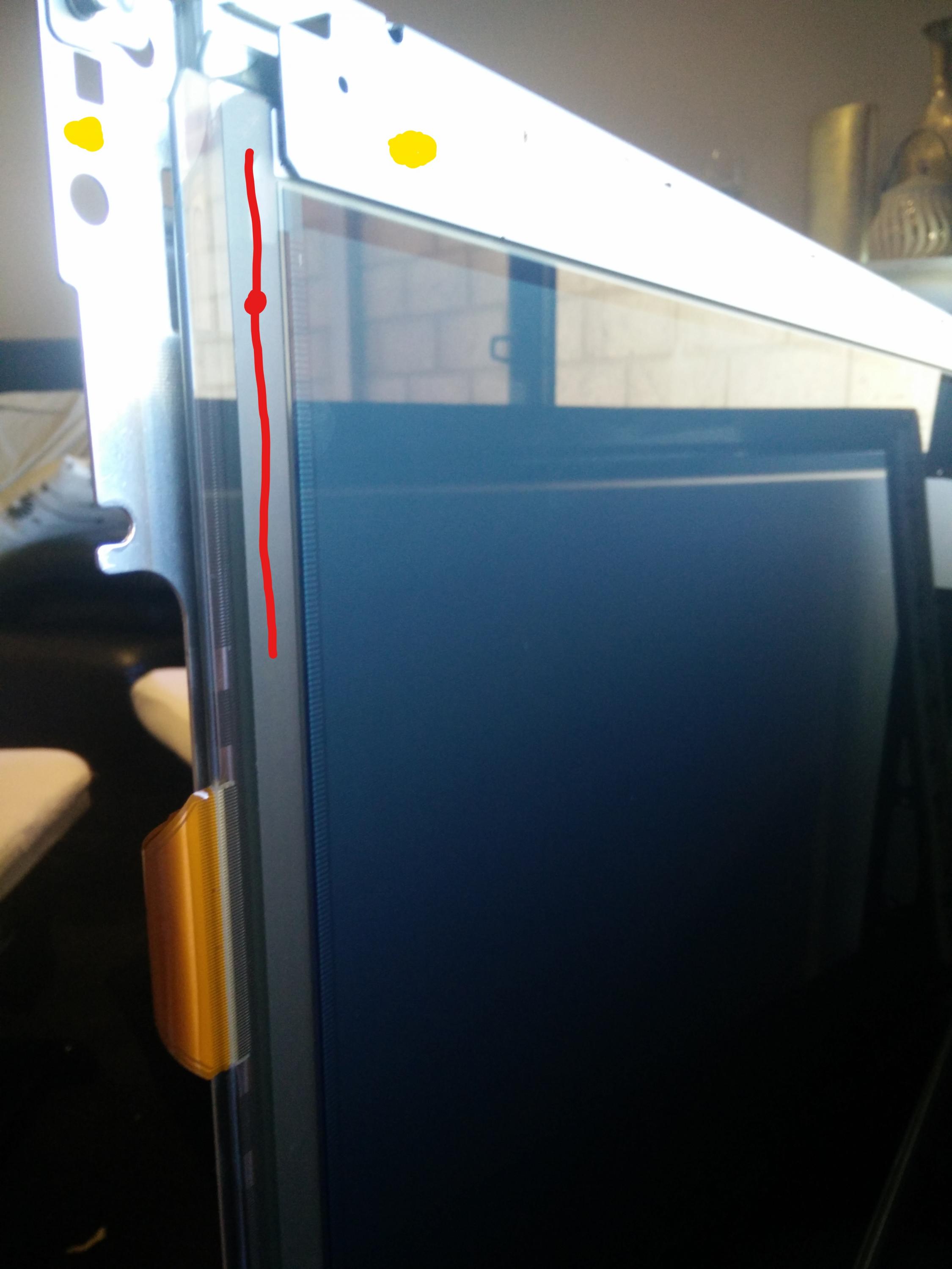

                          #72
                          Yes. I did check that. However since I made sure the frame was sufficiently grounded to the chassis there is no voltage to measure.
                          • infrag
                            • Jun 2012
                            • 89
                            • australia
                            #73
                            So in the picture attached I measure AC voltage between the strip indicated in red and the frame/chassis of the TV indicated in yellow. Does anyone else get this? I dont expect anyone to actively pull their TV's apart to check but I'd be very interested.
                            If you take the complete metal frame off the front and just measure between the strip and the chassis/frame of the TV does it make any difference for you?

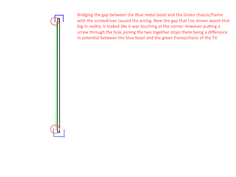

                                #75
                                Originally posted by budwich
                                still trying to get my head around this.... so with statement, and the latest picture, are you seeing any more arcing in this "mode"?... assuming this statement means that the "chassis" and the now unmounted bezel are / were at the same ground potential. In one of your earlier posts, you placed a screw driver on the "chassis member" (I think ) and could cause a arc... is this true still / interpretation correct?
                                OK sorry for the confusing statements.
                                The screwdriver arcing was when I didnt have the metal bezel properly screwed to the frame. Therefore I could get arcing between the metal bezel and the frame with my screwdriver. Does that make more sense?
                                Since I have made sure its all fastened properly together while testing the frame and metal bezel is all at the same potential.
                                I can get arcing between the strip I've marked in red and the frame/bezel of the TV though with my screwdriver. Does that make sense too or have I just confused it more for you?
                                    OK I'll try to draw a usable diagram in paint tomorrow on a computer to explain what I did and where the arcing on the screwdriver was from.
                                    As a side note can I test an A board from a 65" vt20a TV on a 50" vt20a TV and vice versa if the connecters are the same? I'm aware the backing plate might be different but I just want to test it if need be? (I picked up a 65" on Saturday night but it won't turn on with a 10blink code)
                                    • infrag
                                      • Jun 2012
                                      • 89
                                      • australia
                                      #78
                                      Attached is a badly drawn pain picture trying to explain the frame/screwdriver arcing I mentioned earlier in the thread.
