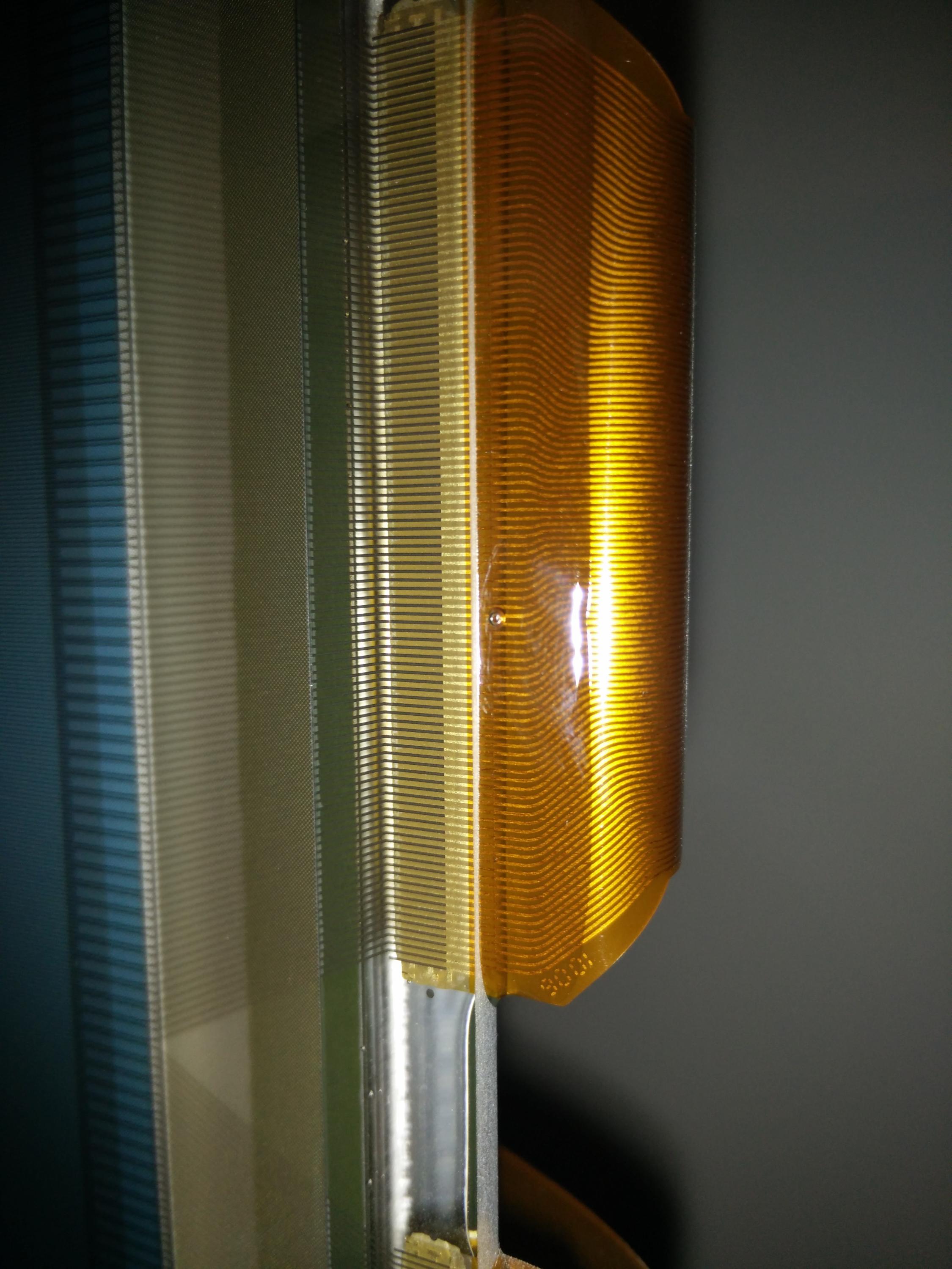

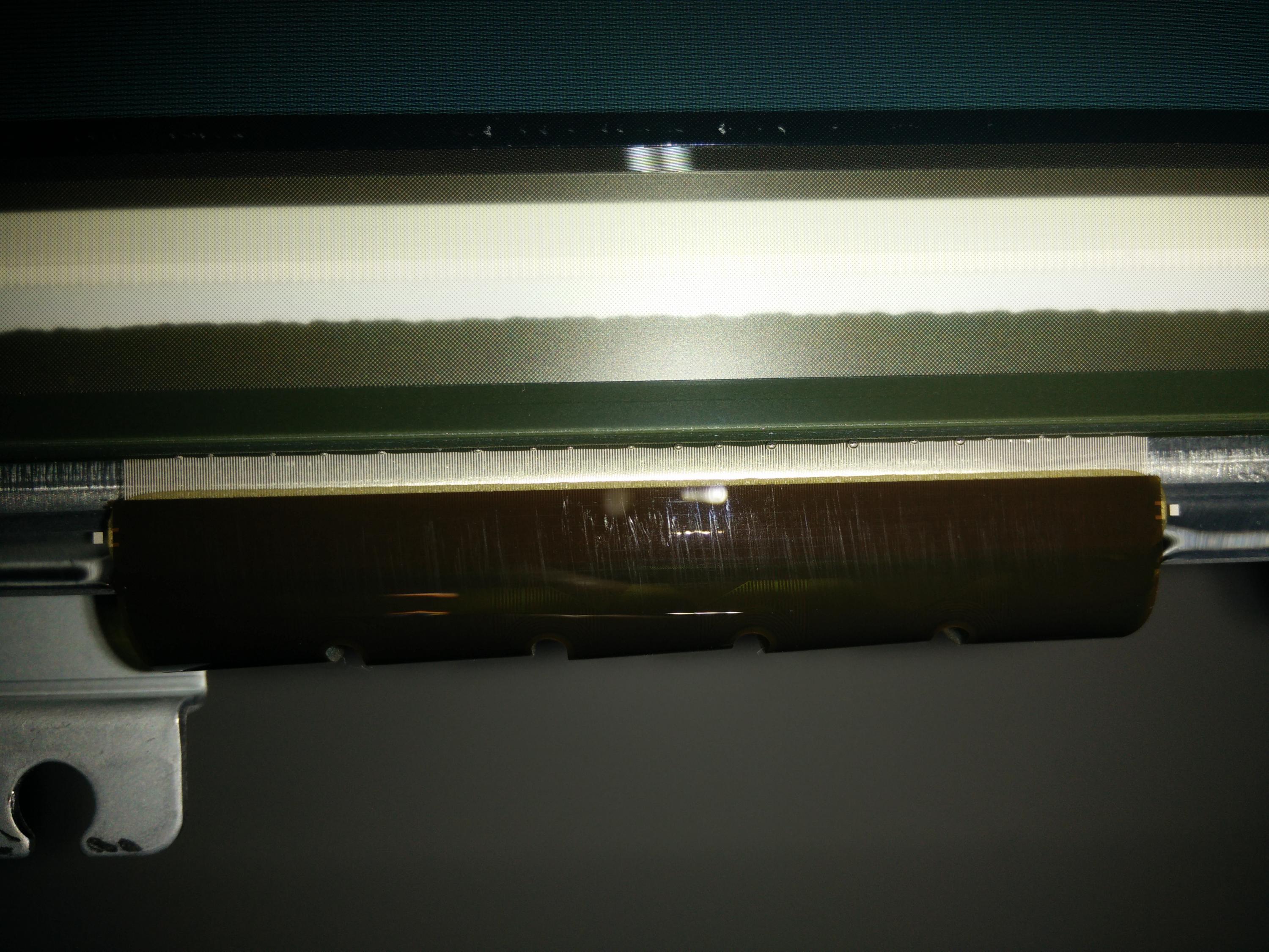

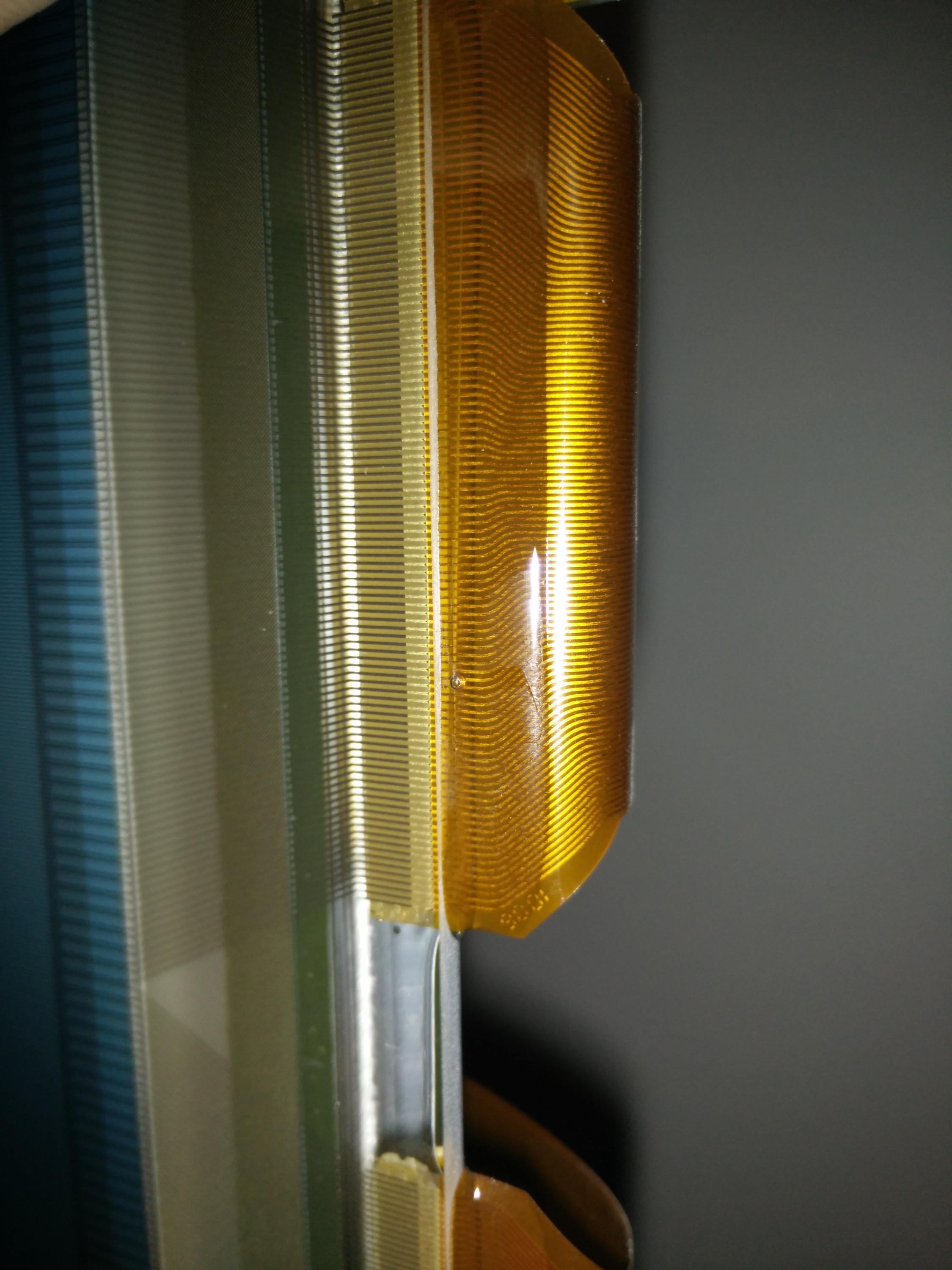

                  OK I've taken a few pictures to show the 'solder blob' things. Please give your analysis on this thanks

                    Also I've remeasured the voltage on the front of the panel to the frame. From the silver kind of layer (just off from the black part of the glass) to ground there is ~ 34V AC and ~ 3-8V DC.
                    The symptom I described earlier in the thread has now also returned. I'm not sure if this is a result of me taking the shielding off but the once the TV has been on I turn it off but it stays in 'hot standby mode. It never switches the relay off and goes properly to sleep. USB devices that are plugged in remain powered on. (Ive tried with them removed and it makes no difference.)

                      I've also taken a short video with just the bottom metal shield on. It looks a bit crappy because it needs to be dark to see the sparks. I've also used a screwdriver to apply a real little bit of pressure which makes it arc heaps.
                      https://drive.google.com/file/d/0B-d...ew?usp=sharing
                      Also after adding this bottom metal bar my TV entered standby again properly. Might be because it was unplugged for a bit while I checked my earth and neutral potential.
                      The check between the earth pin and the neutral showed up less than 1v.
