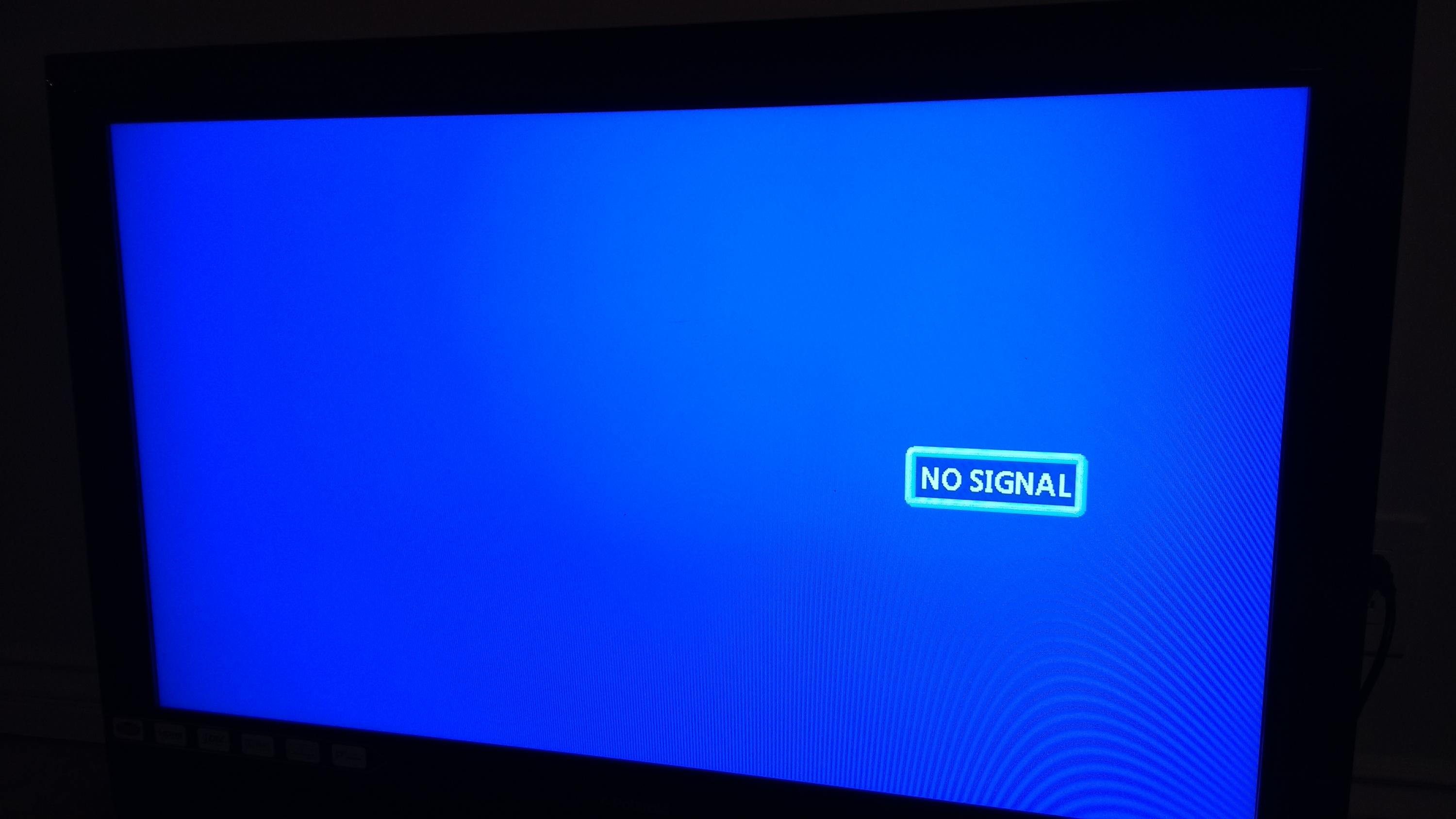

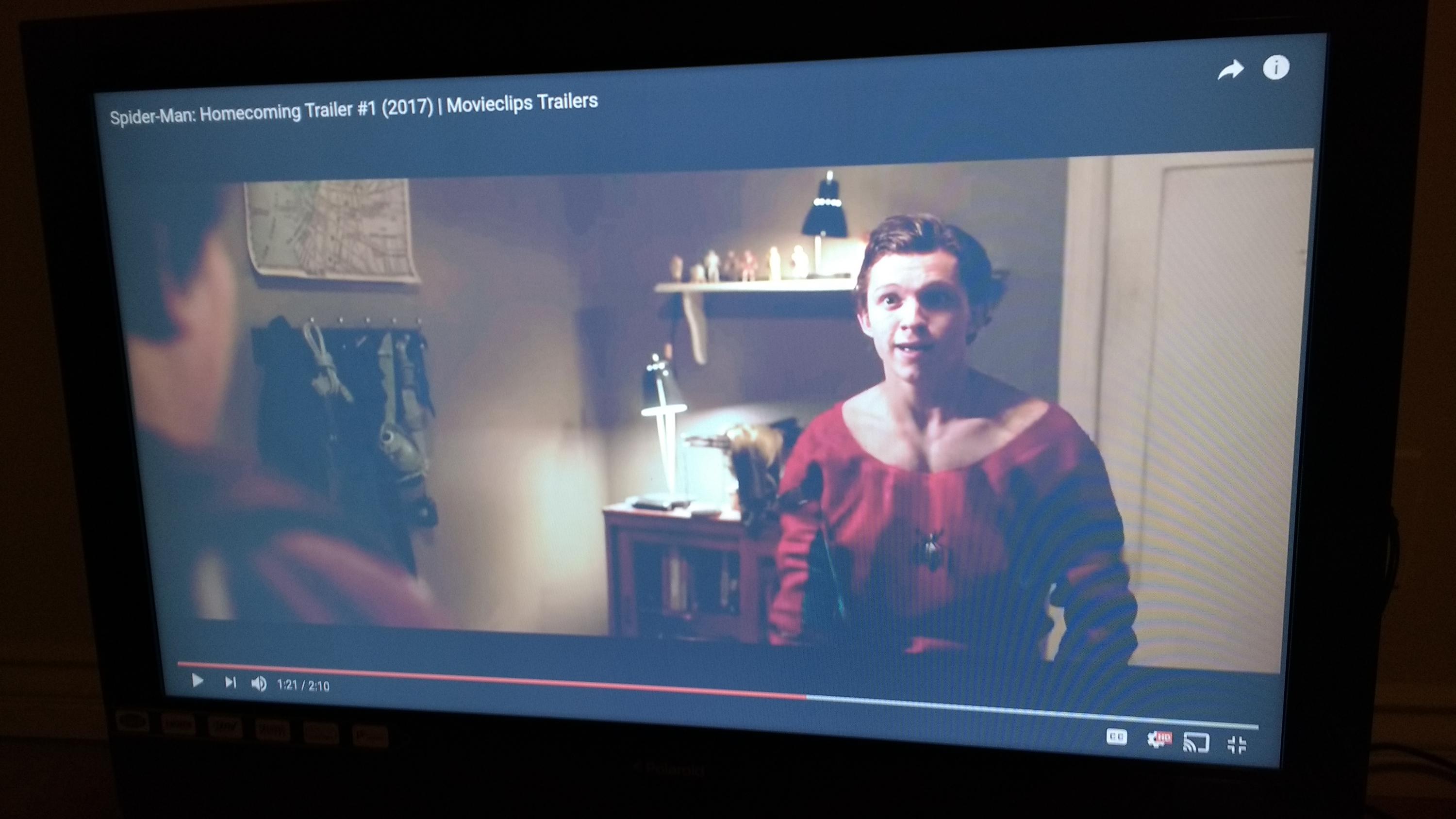

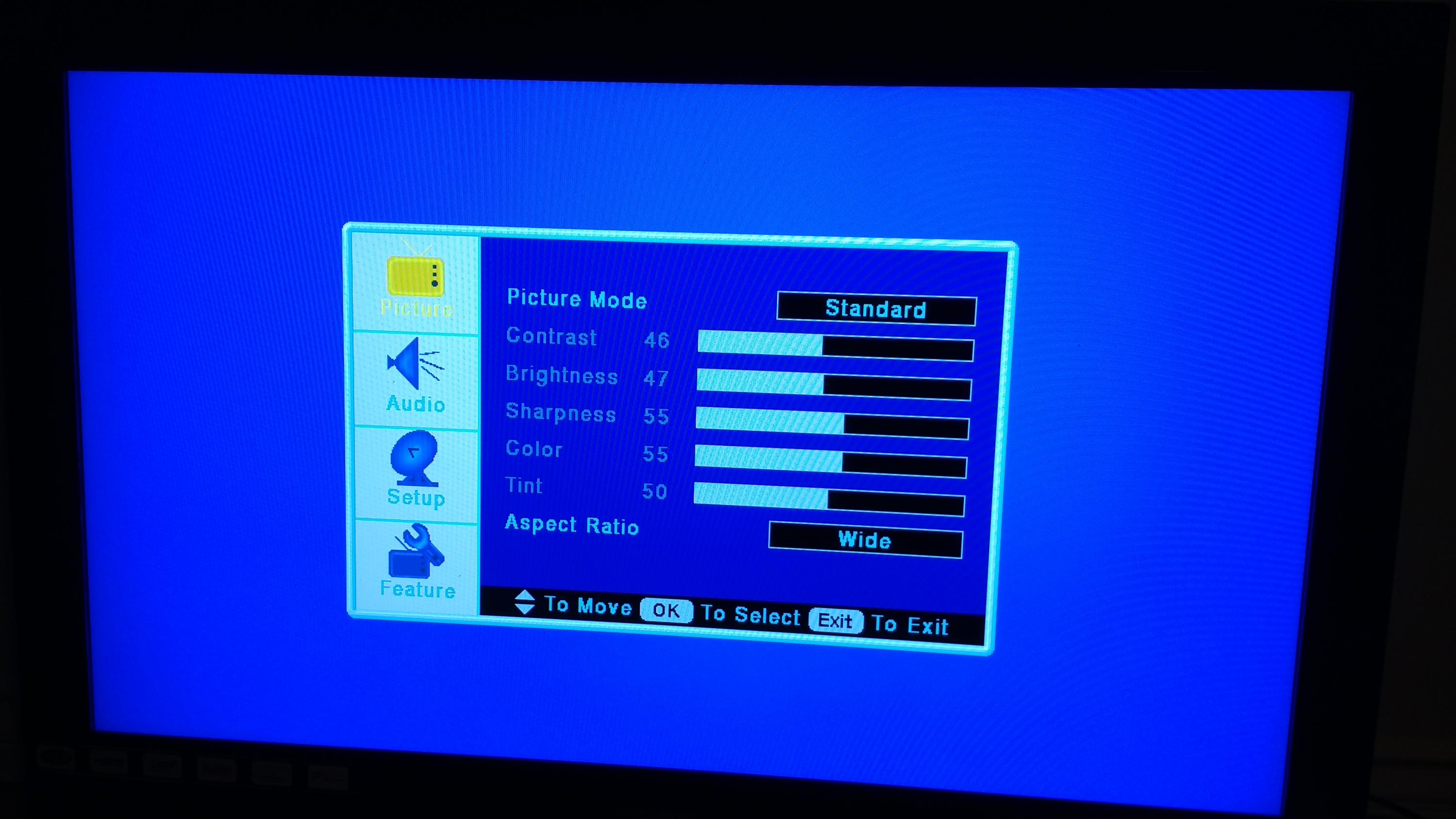

    Hello, I'm working on my grandpas Polaroid 42'' LCD Tv. When the TV is turned on for the first time in the day the picture and menu is very bright and washed out. After about a minute the problem lessens but the picture is still washed out, however the menu colors seems normal (black is dark black not faded black). Also the No Signal screens do not have faded colors.
    So far I changed HDMI cables, tested with A/V cables(picture still washed out), Unplugged and cleaned the main board and T con board.
    What could be the problem? bad panel? Main board ? T con board ?

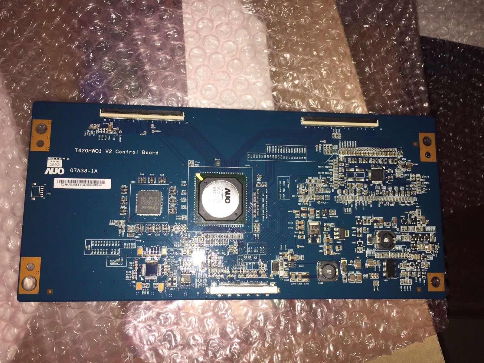

    Can we see the pictures of the T-CON board?

      Re: Polaroid TLX-04244B bright white washed out screen issue
      not my board but it's this one, tomorrow I can open back up the TV and get a shot of mine.
        posted a image of it. if it helps. thanks
          The 48 pin chip top right, it is an AS15 ?
          It needs replacing.

            +1, or at least check the GAMMA Voltages.
              Okay checked and the chip is AS15-F.

                Hope I tested this correctly here are the Voltages
                1. (14.78)
                2. (14.74)
                3. (14.73)
                4. (14.62)
                5. (14.12)
                6. (13.59)
                7. (11.14)
                8. (9.95)
                9. (9.92)
                10. (9.91)
                11. (6.98)
                12. (6.38)
                13. (6.21)
                14. (6.04)
                15. (4.55)
                16. (4.31) VGMA16
                17. (3.79) VGMA17
                18. (3.37) VGMA18
                19. (2.97) VGMA19
                20. (0.69) VGMA20
                21. (0.56) VGMA21
                22. (0.37) VGMA22

                  Try this https://www.badcaps.net/forum/showth...ighlight=gamma
                    It looks bad.
