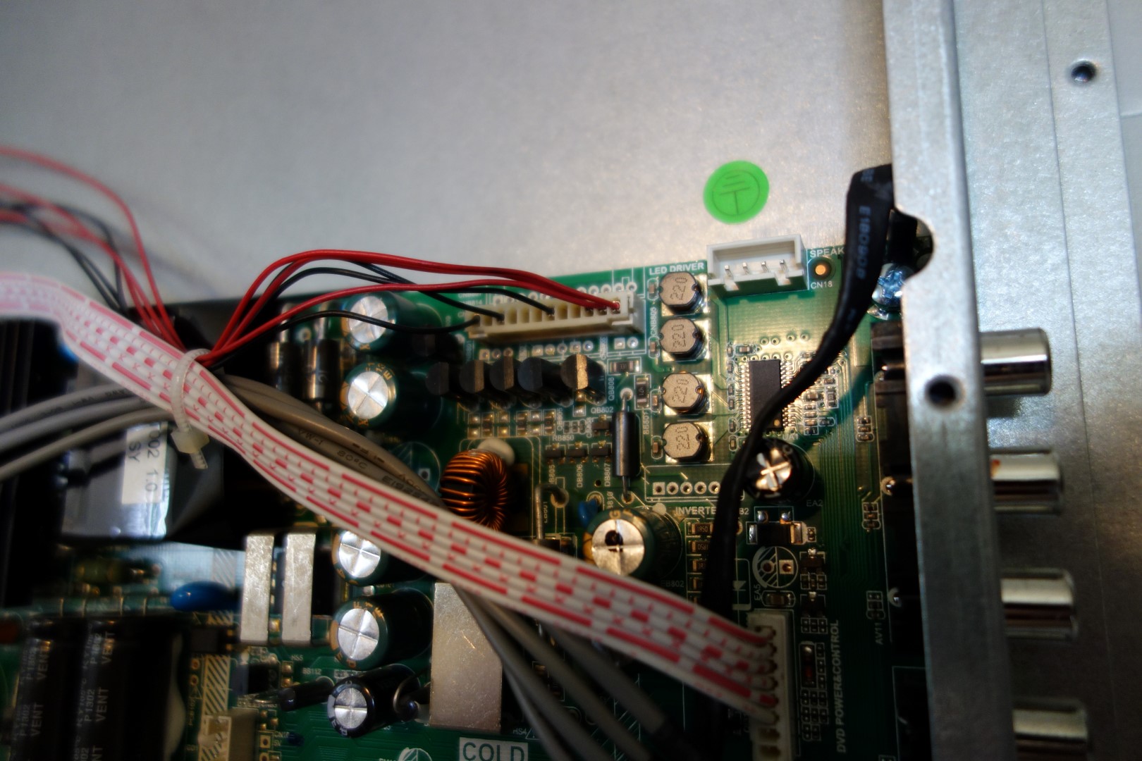

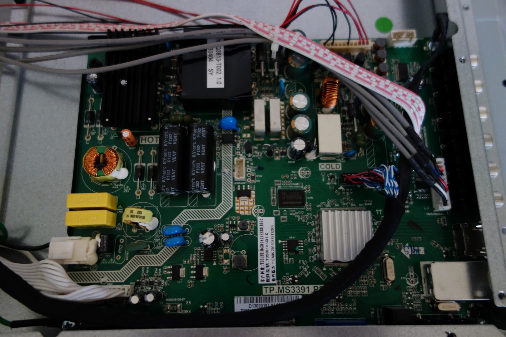

    The backlight LED's pulse on briefly every second. There is a previous thread about this problem with a confusing solution. This is an LED TV with a built in DVD player and combined power supply/main board. https://www.badcaps.net/forum/showth...t=rldedv3988-a
    The backlight power wires appear to be fed by 3 thin red wires. I measured about 25V DC steady on each of them. They were not pulsing. The last post on the previous thread indicates the cause could be bad LED's in the strip.
    There doesn't appear to be a DIM or ADJ signal since it is all one board. There also is no backlight control, just brightness in the user menu.

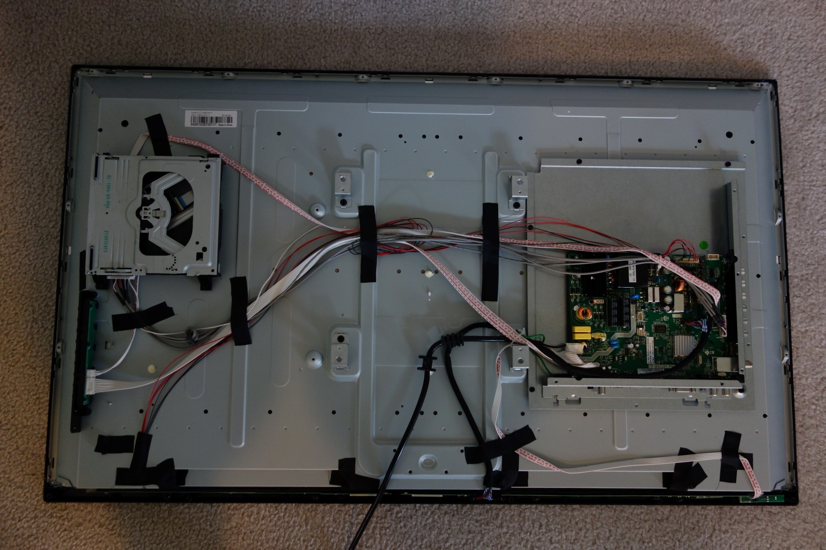

    I disassembled the panel and found the top row of three 10-LED strings is out. Guess I need to research troubleshooting and fixing this.

      those RCA's are utter garbage. Even on a Vestel set, one is able to adjust the back light in the menu. Also it's one of these one board has it all TV's.
      Anyway... test each LED on that bad sting with your DMM in diode mode.

              I've broken every panel I've had to disassemble. My mistake this time was I moved the panel with all the plastic panel pieces behind them. I thought this would protect it but ended up flexing it more instead. I also grabbed it by the sides which flexed it more- should have only grabbed it from the top. Once I had the front bezel off, the LCD could have been removed on it's own by prying off the circuit boards at the bottom that were double sided taped down. Initially I just flipped everything over to take a look at the backlights (panel was still fine) but decided to remove it to better access the strips. In hindsight, this was the correct approach to minimize handling and I should have just pried off the top LED strip.
