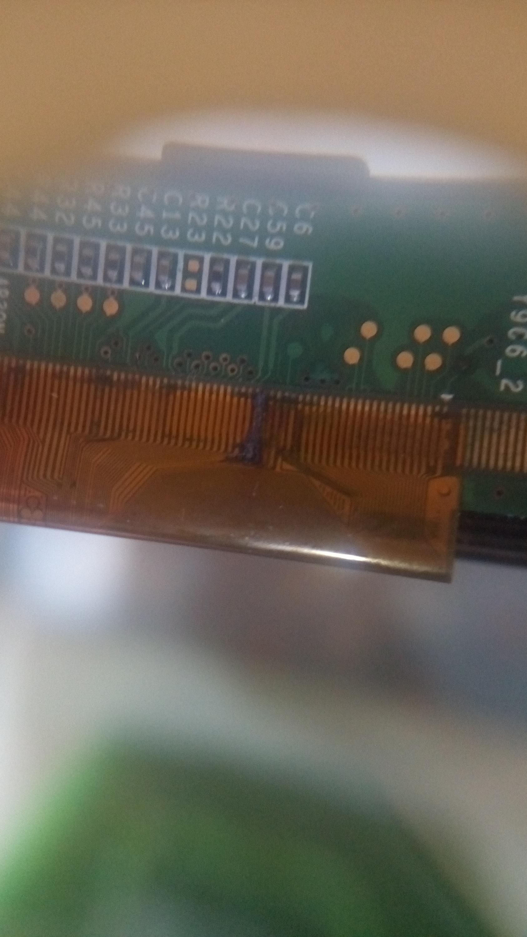

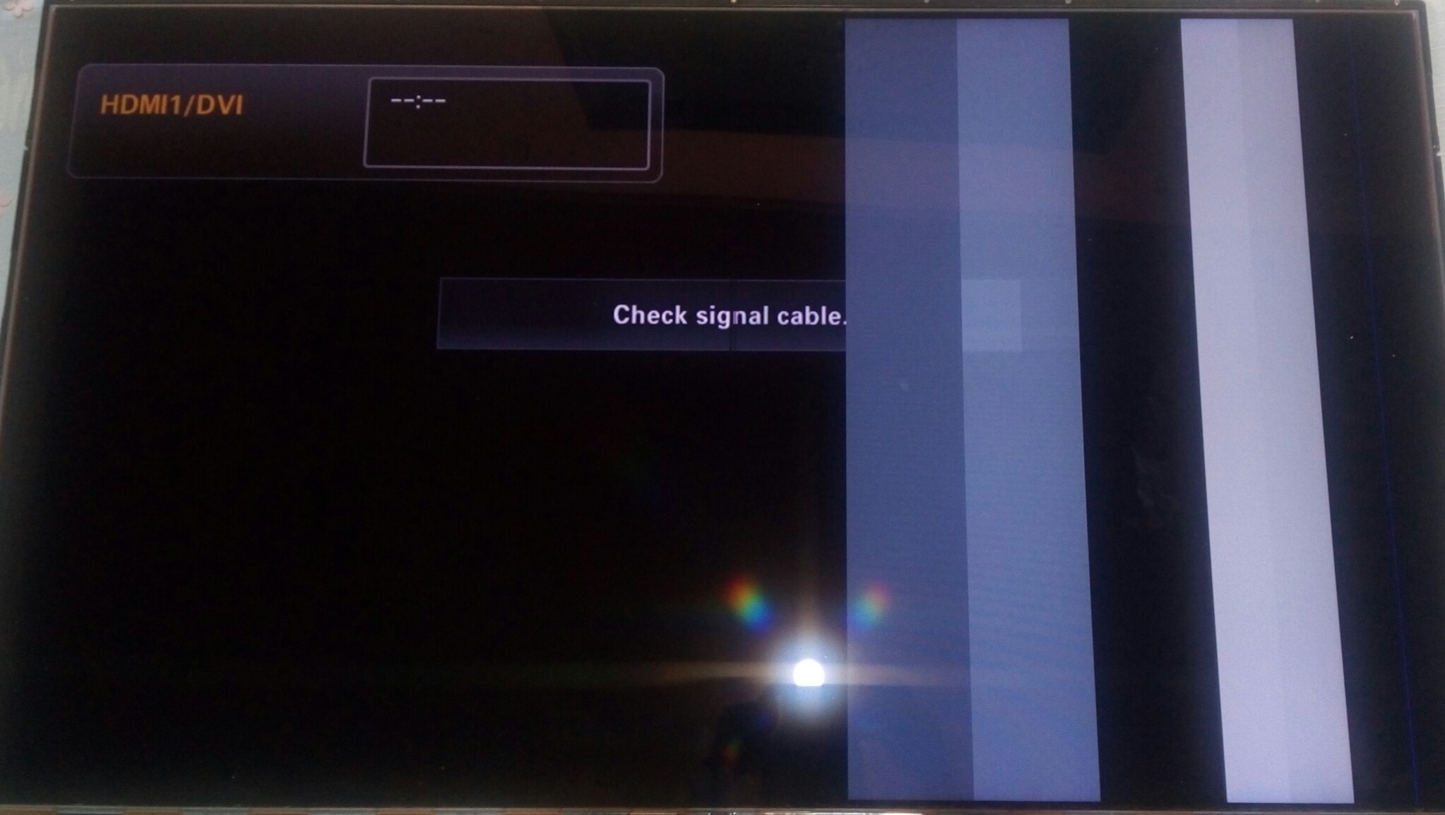

    I acquired this TV hoping I can still fix the defect. As you can see from the picture

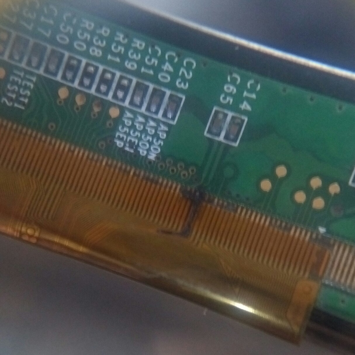

    half of the screen has vertical bars. Bases from what I have seen from the forums here and elsewhere on the internet, it is causes by the faulty connection between the LCD and the flex or what is called the TAB BOND. And so I thought that maybe I could fix this one using the methods I read from the forums here which uses thin foam, tape, or thin silicon material in between the flex and frame to improve contact. Unfortunately, upon opening up the TV and inspecting the tabs I found that this TV has a different case. Its not just a simple loose contact problem. As you can see from the pictures (barely, sorry i dont have better camera for this)
    2 of the flex ribbons have burns. One or more tracks has been burnt off.
    Now I wanna ask the experts here. What do you think? Is this thing still fixable? Maybe scraping the insulation from the flex ribbon and soldering a thin wire to the board? The tracks are very thin though. How about replacing the flex ribbons? I've seen videos on youtube where they completely remove a flex ribbon from the LCD, clean the contacts and then reattach it using a machine.
    Many thanks in advance.

    If you have the money to buy a machine then go for it but I would say out's out of the price bracket of most people.
    I had a similar problem recently and by carefully cleaning the tab connections I got the picture back. Fortunately it was only gunk shorting across the copper tracks that was causing the problem and had not damaged the copper tracks.
    However it those tracks are burnt (cannot really tell from the picture) then I don't know how you can repair them.

      Buying the machine wouldn't be practical. Buying a replacement panel would be cheaper but wouldn't that cost something close to the price of a new TV set. For now I'll to wait until I can think of a solution. Maybe look for a similar set with a good screen. Or try soldering a thin wire to bridge the contact to the board.
      I have observed that the tracks that were burnt off is the same pin number on the other one. I wonder what signal this is and why it caused the burn.
      I'll post again if i can pull this off.. Its a nice TV I dont wanna let go to waste.

          Looks like there has been some water damage...

            glass cleaner damage.
