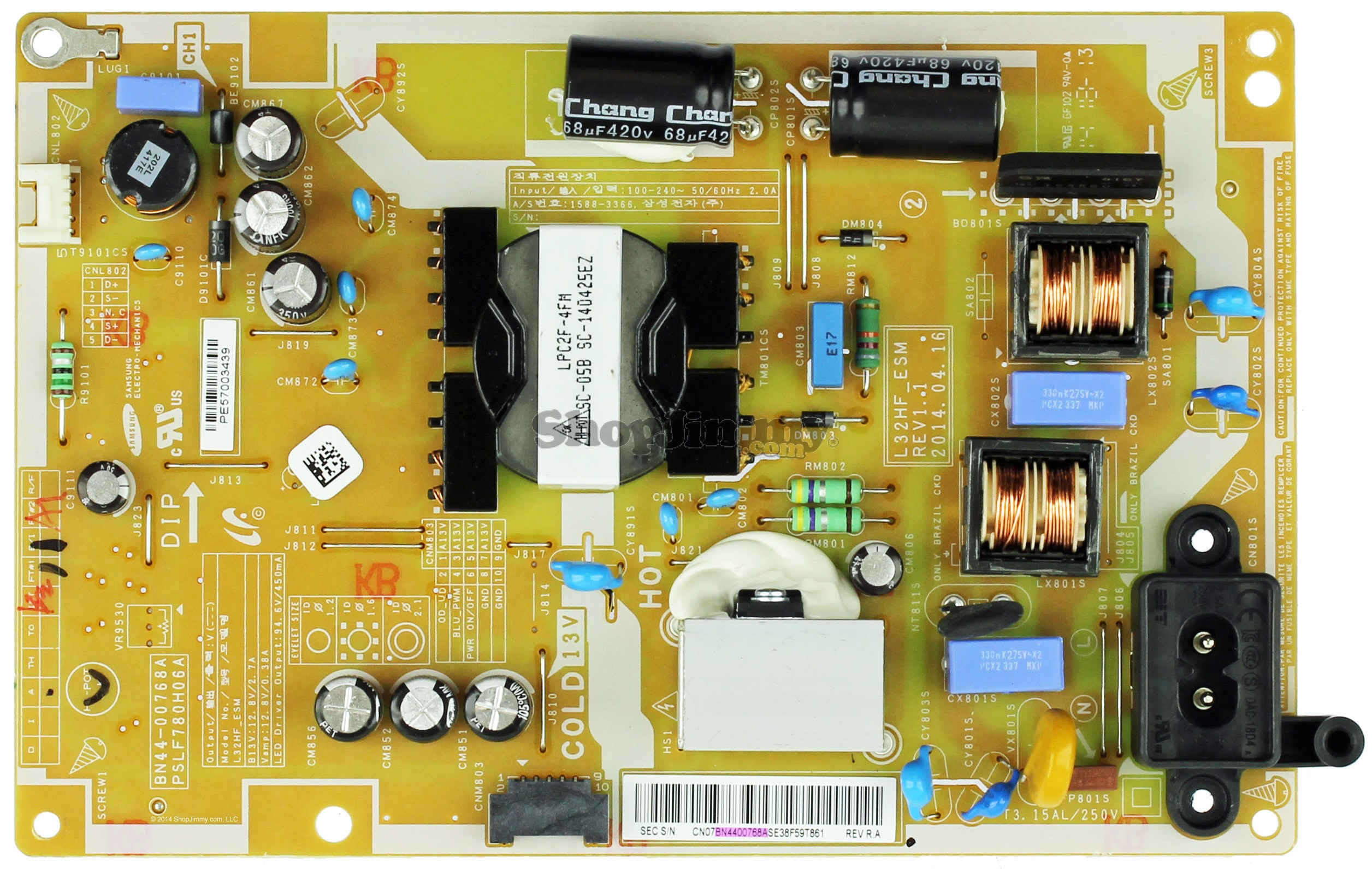

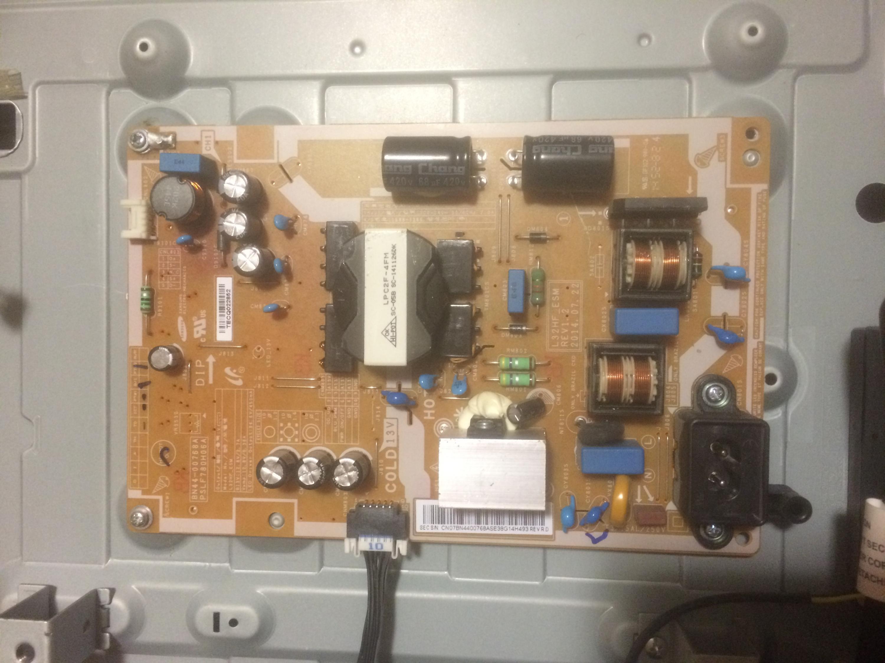

    I have a BN44-00768A power supply that gets power,but not to both backlight leads
    Checked voltages from Main Board to Power Supply. All Checked Good
    I have a Standby light
    I see no signs of bullgin/swollen Caps
    I see no signs of burnt out components
    I have 2 sets of wires that go directly from the PSU to the led strips
    With Tv on , and led strips unplugged from PSU. I get 145v on right. and 0v on the left.
    I Get the same results with the led strips plugged in also.

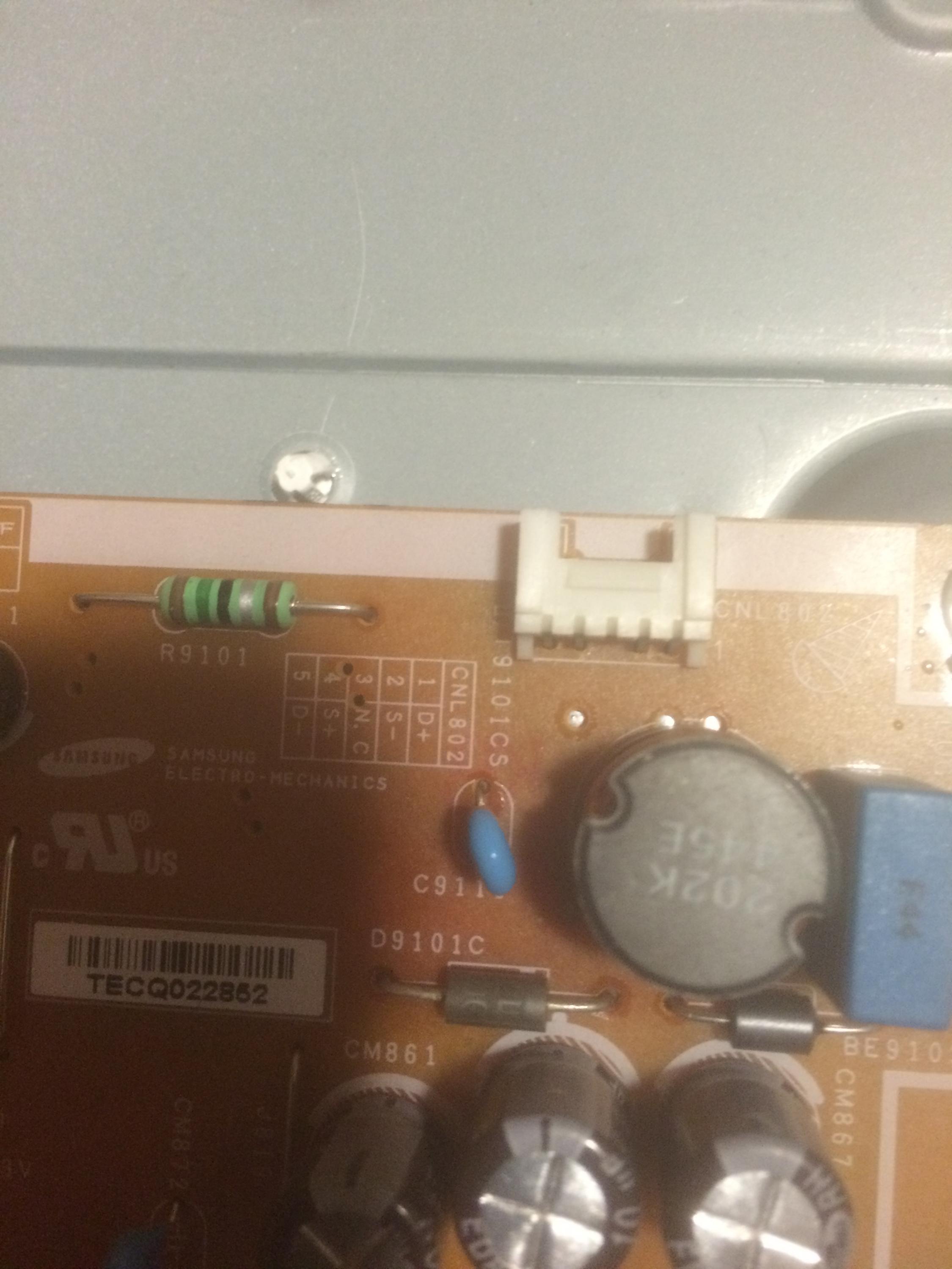

        You have 2 LED strings on CNL802.
        You measure 145V on one pair and 0V on the other with the LEDs disconnected? Then there is something wrong with the LED driver circuit.

          Are you measuring the Voltage at the LED connector with the black probe to the chassis GND?

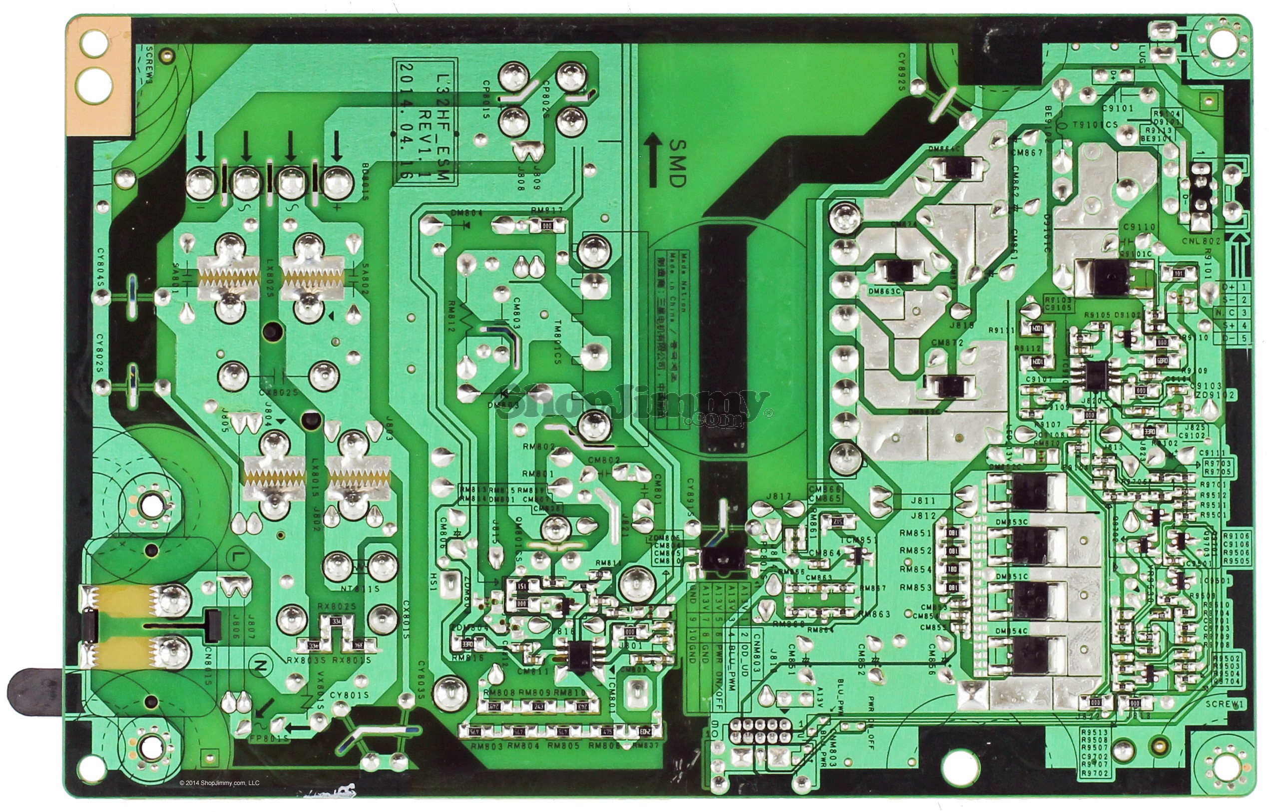

          Pictures provided by shopjimmy.
          http://www.shopjimmy.com/samsung-bn4...led-board.htm#

            I used the the chassie as ground when checking voltage
            Where is my led driver?
              Re: Samsung un32h5203 No Power to Backlight
              https://www.badcaps.net/forum/attach...0&d=1485273273
              Top left is the LED power supply/control circuit.
              The LEDs are connected in series so when you disconnect the LED connector you will only get the Voltage reading on pin 1 only (that is the Anode of the LED string).
              Right now you have open circuit in the LED string.

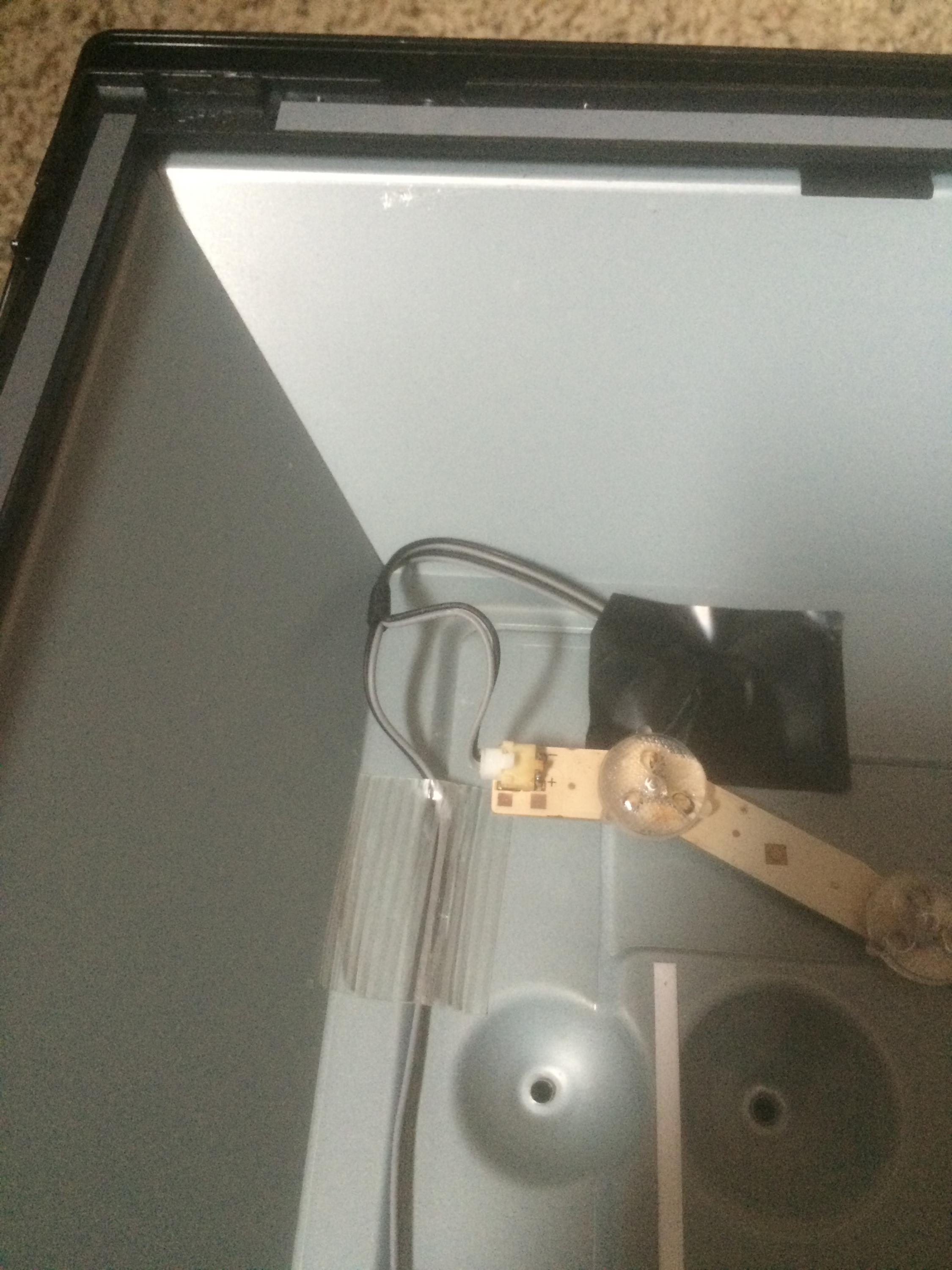

                Yep. that's what i was thinking. but the only one side getting voltage threw me off. Because there is no board or wires connecting the strips inside the chassis

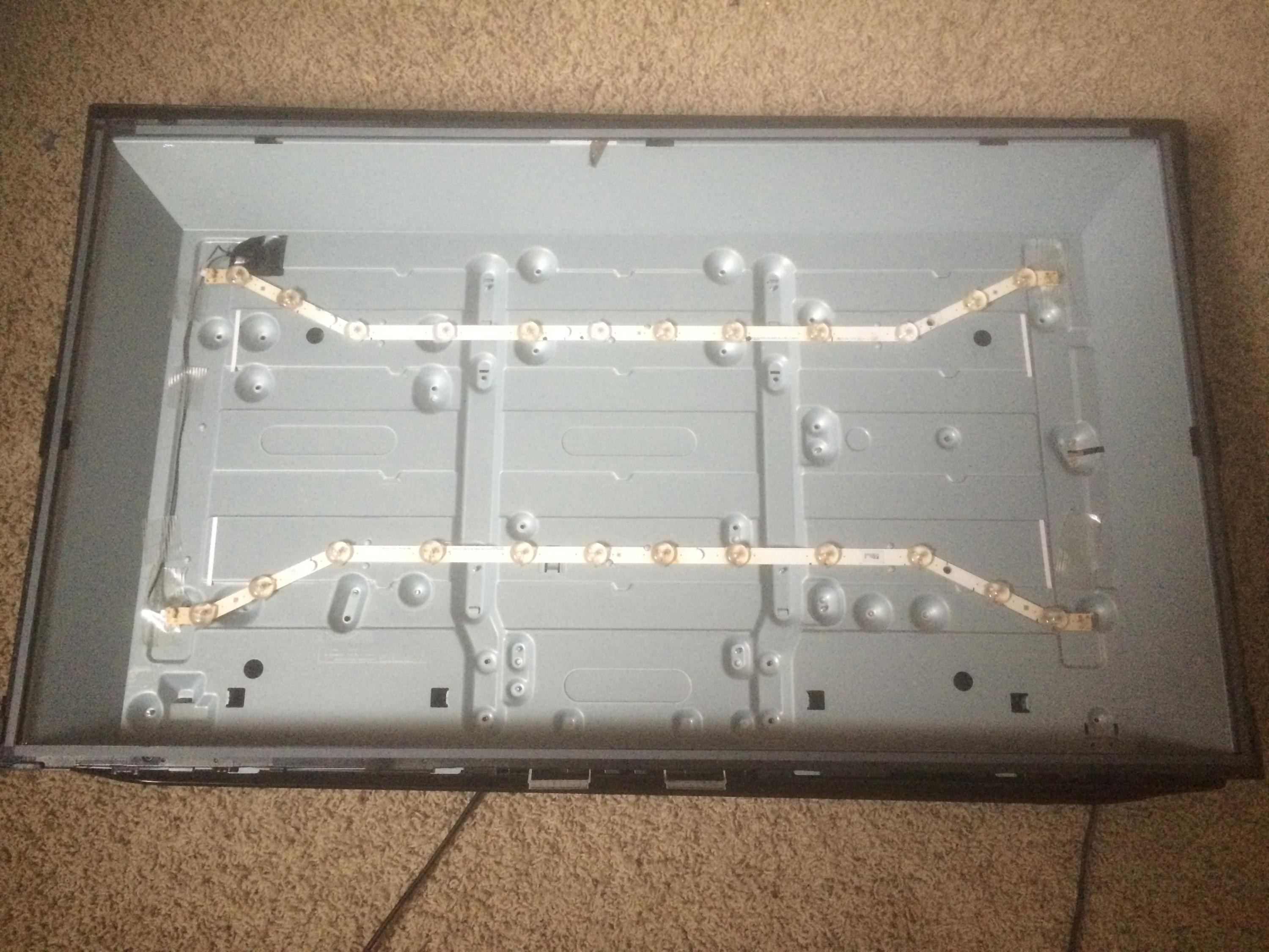

                    This is my Panel.
                      You have 24 LEDs, if I remember correctly on this model, they 6V LED (DUAL LED in one package).
                      As you can see, you have two wires per strip and they are terminated in series connection at the LED connector on the power supply board.
