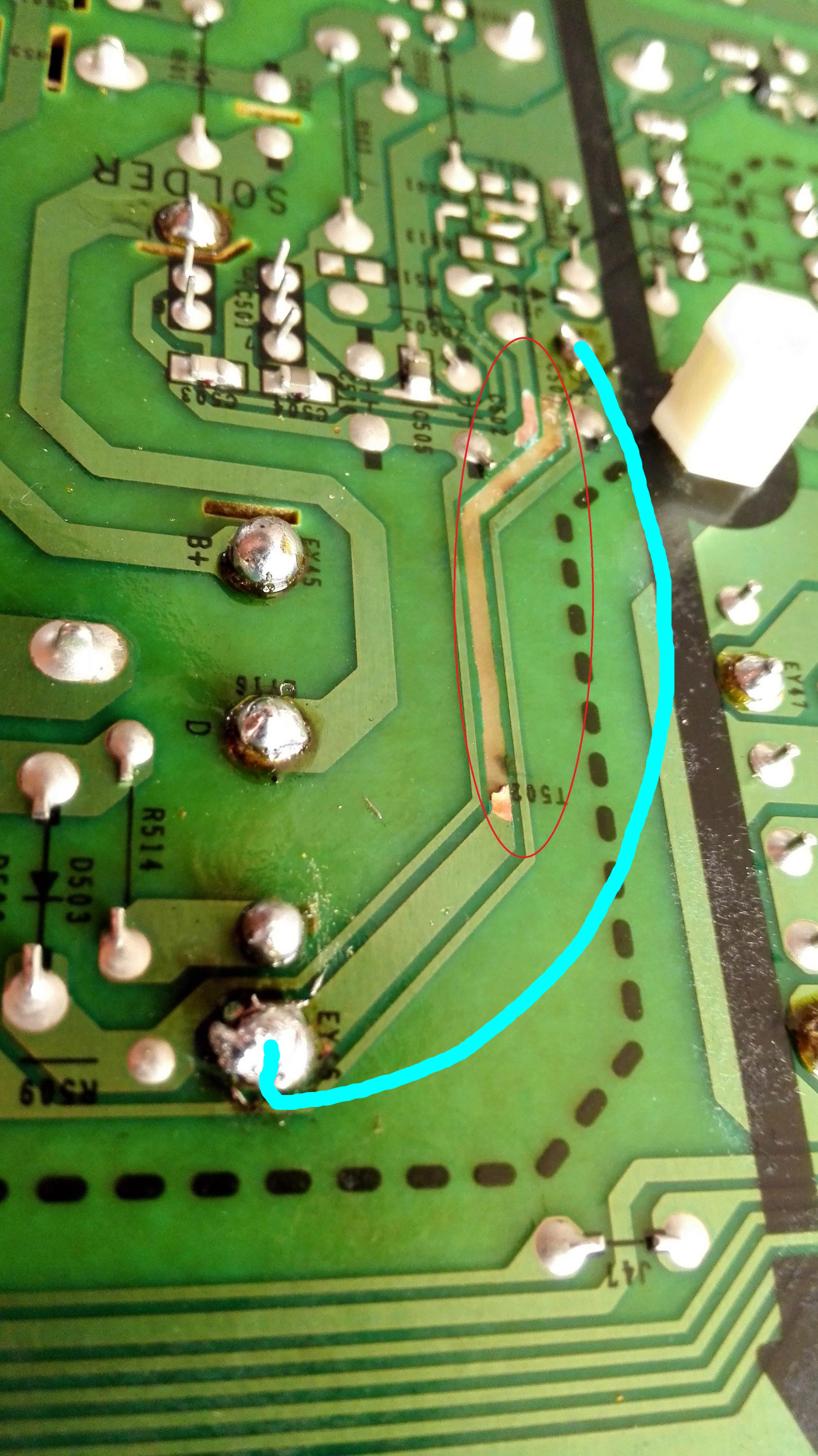

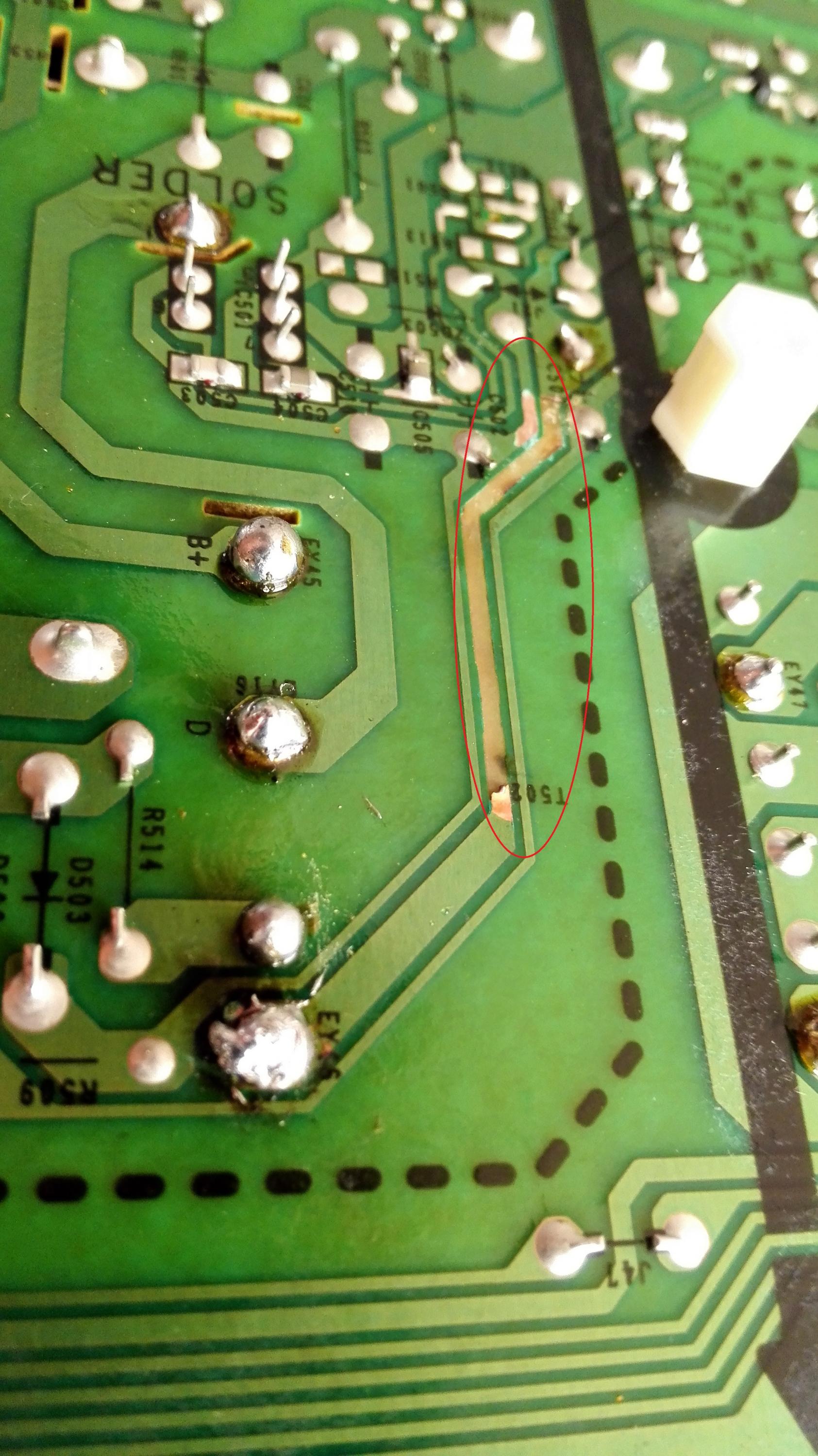

    Hi Guys,
    This is my first attempt at tv repair, i usually just do basic things like cap replacement on lcd monitors so my knowledge is not that much.

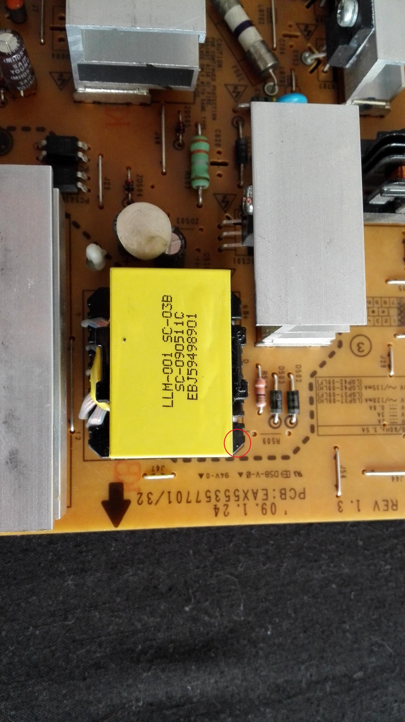

    After opening the to measure standby voltage as there was no light in front of the tv, the board is eax55357701/32 as per pic and there's a burned trace to from what i assume is a transformer ?
    My question then is whether i should get a board from ebay or this trace can be manually redone ? i.e. solder a wire from the leg of the transformer but to which point (s)

    That looks easy enough to put on some bodge wires, but you need to be sure that whatever caused the issue won't burn it out again when you power it up. Don't skimp on the size of the wire, those are some meaty traces.

      Thanks for the response jondoe, i am just not sure to which part the wire(s) needs to go to from the transformer leg

        The track appears to have vapourised so whatever caused that needs to be looked at otherwise replacing it with wire is not going to solve the reason it happened in the first place.
        Was the power supply placed on the back of the panel or slipped down on to the panel and shorted when the set was switched on?

                I'd scratch off the lacquer and attach the wires directly to some "good" track material, just for the purposes of testing.

                  You don't need to scratch anything. Just attach the wires to the two points that are already soldered where they come through the board.
                  I would also resolder the bottom connection.

                      I would do as diff says and use multi-stranded insulated copper wire and attached at the nearest adequate solder point at either end of the break.

                          Thank you for the suggestion, i did this, and replaced the fuse that didn't have continuity, i however am not sure if the fuse i used is of the same rating, because i have power for 5 seconds and it goes back to standby, i am going to pickup the proper fuse today and will see how that goes.

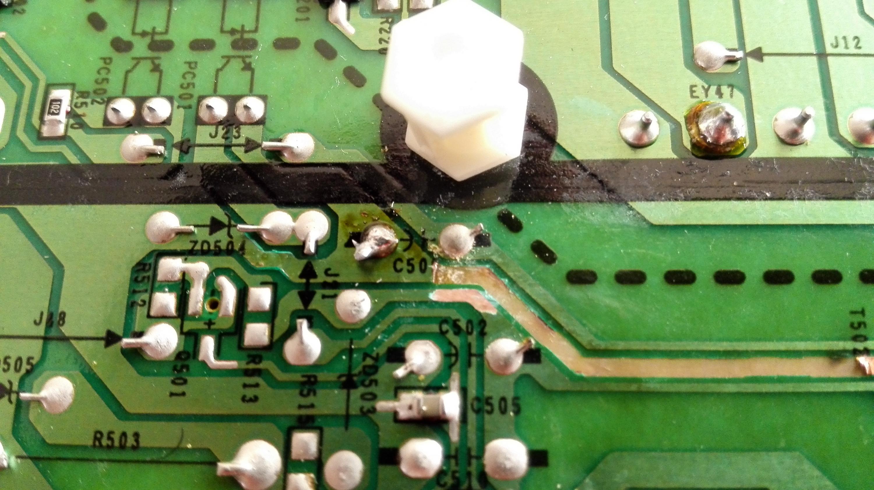

                                  Reflow all the soldering points you can, expecially of the heavy components 'cause they have kicked the board in the impact and may have cracked the joints.
                                  Clean your iron, your soldering is pretty ugly.

                                    That joint EY47 on RHS of photo looks like cracked solder.
