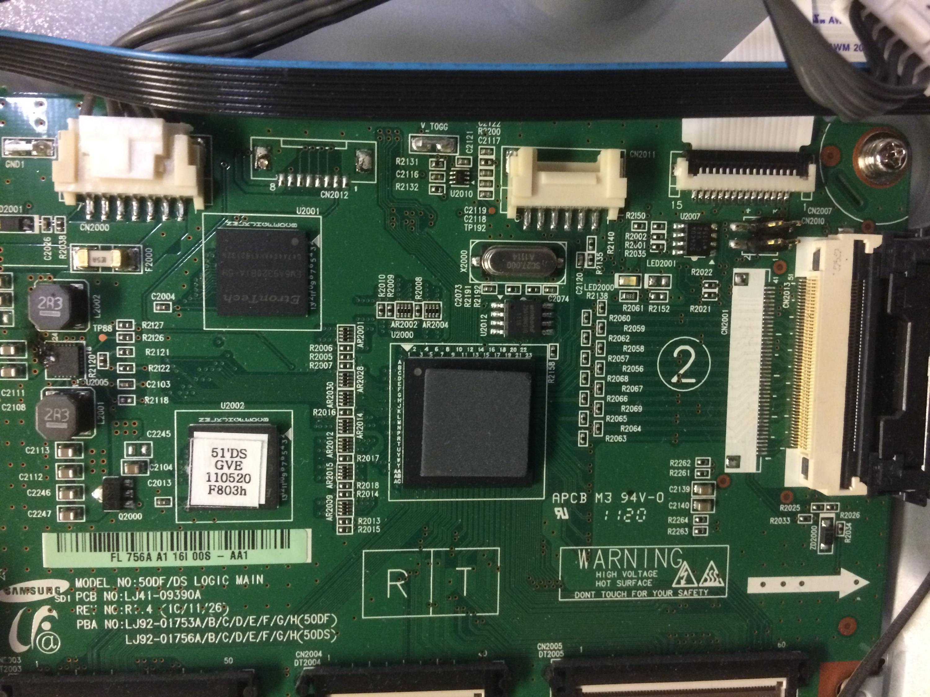

    Hi all
    I need to know which of the two jumpers needs to be shorted to activate testmode on logicboard (pattern generation)
    See attached picture
    This is a plasma, Samsung PS51D6905

    Re: How to enter testmode on logicboard Samsung
    https://www.badcaps.net/forum/showth...+test+patterns
    • petehall347
      • Jan 2015
      • 4426
      • United Kingdom
      what happened to u2005 ?
        Thanks for that input Pete, didn't see it myself.
        Was only focused to put logic into testmode.
        Obviously this board is bad.
