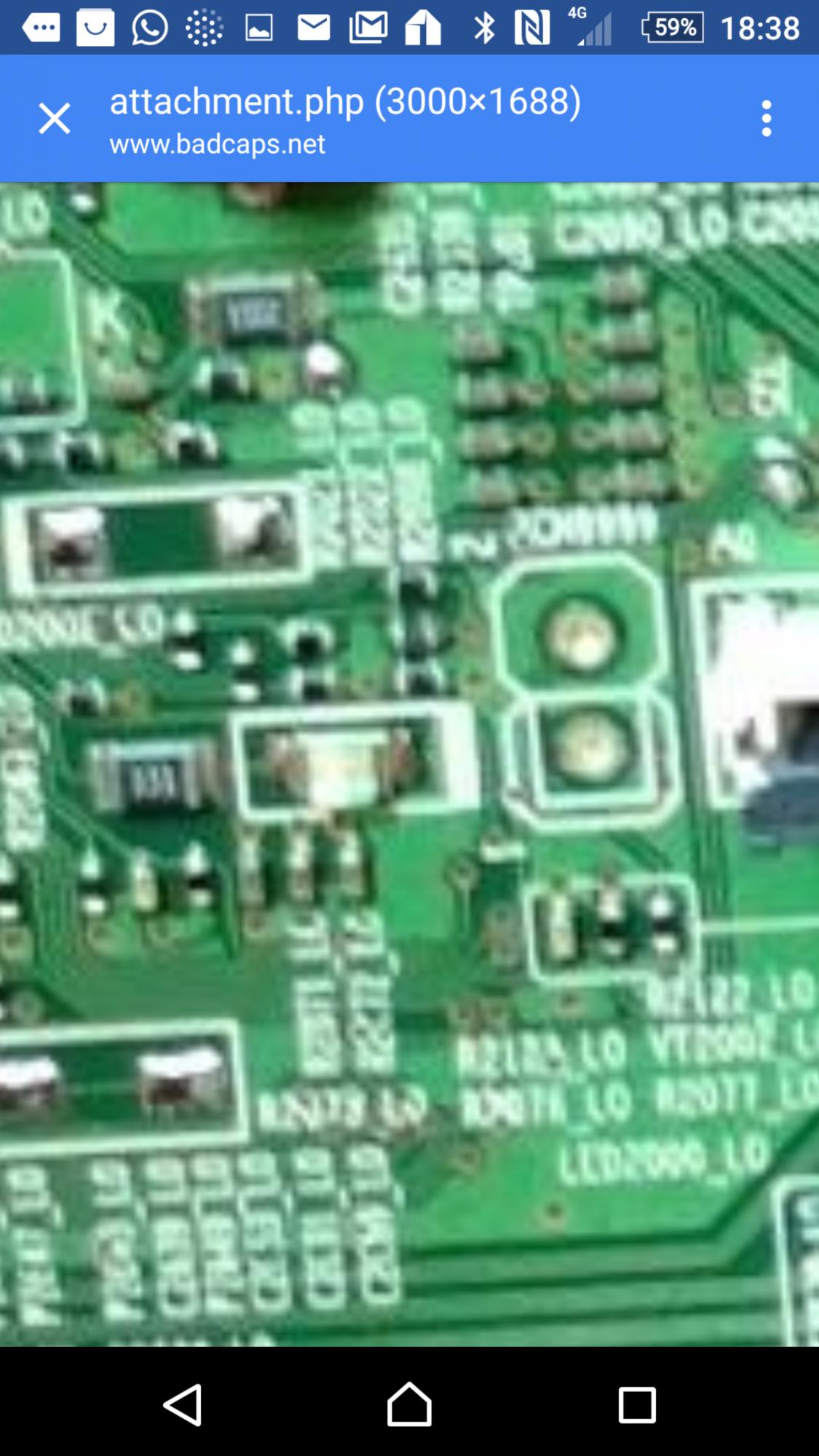

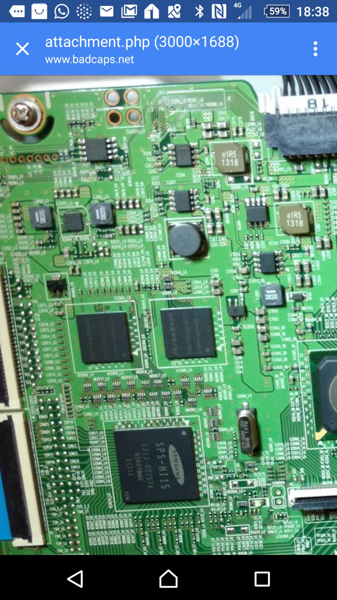

                #47
                Re: Samsung PN60F5500, making me question my sanity
                OK so this is the control board section of the mainboard.
                • Hamie
                  • Apr 2014
                  • 1383
                  #48
                  This looks like the LED for the control board.
                  Does it blink? Either with the power supply jumpers in place or if you remove jumpers and plug back in mainboard?
                  If this led doesn't blink I'd seriously consider replacing the mainboard.

                    #49

                        #51
                        By "a slow Blink", do you mean once every 5-6 seconds?
                        Mine did this too. It's an indicator of a fault. Some i think have said Drv reset.
                        Also, on the pn51f8500 I've been testing, to get the test images, the mainboard needs power. I know Hamie recommended to remove the power to the mainboard, not sure why. If that board doesn't get power, how will it fire up it's CPU and generate the test images?
                        But I wouldn't worry about generating test images since we know you know have a slow blink. I would first look to the X/Y main board since mine did exactly the same thing. You don't even have to pull it, just measure across all 3 terminals, 1-2, 2-3, 1-3. If you have a dead short on any of these pins on any fet, you likely have a problem. My replacement board for the pn51f6xxx was only like $16 shipped. check out how much a replacement is. May be worth it to try that next if it's cheap enough.

                            #53
                            Regards,
                            Mark
                            Thanks, Mark! By slow, I mean once every 1-2 seconds, haha, I guess my idea of slow is not as slow as yours!
                            I guess I will pull the X and Y and check all the fets and get back to you.
                            • mtnickel
                              • Jan 2017
                              • 31
                              #54
                              Blinking every 1 second indicates the mainboard status is ok. So an overload fault may be less likely.

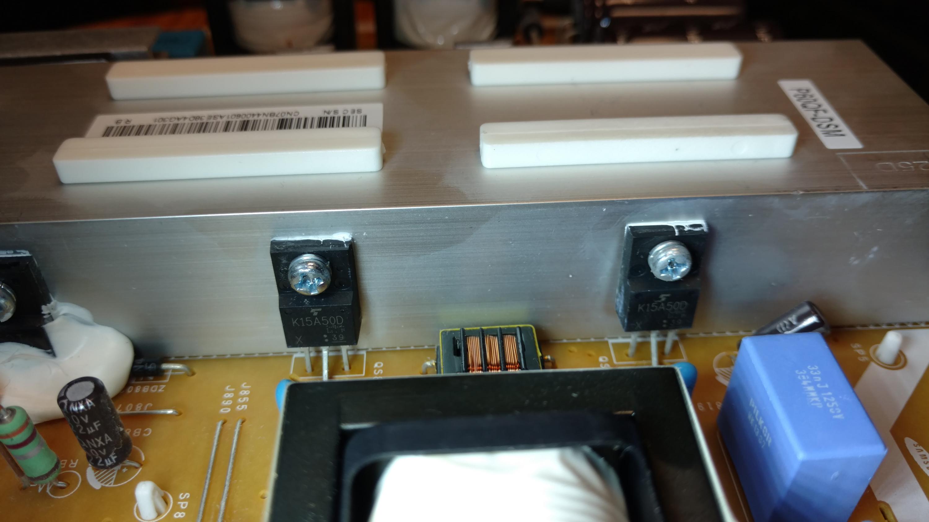

                                  #56
                                  Okay, so I tested all the components on heatsinks on the Y and X boards and the only shorted junctions I'm finding are on the X board: QS801C and QS802C read shorted (in both directions) only between the two pins adjacent to each other; they don't read shorted to the single pin by itself. This is in circuit; I haven't desoldered them. This an issue? Also, I had tried replacing this board, but it didn't solve the issue, but it's possible I got a bad board, I suppose.

                                    #57
                                    Pictures?
                                    Testing in circuit is usually ok. Is it a dead short (less than 1 ohm?). Also, I know on my board some parts looked like transistors but were just diodes. Could you read the number on their face?

                                      #58
                                      Pictures?
                                      I was testing in DIODE check, but when just checked with OHMS I found that both read 20.0 ohms either way between adjacent (side by side) pins. The number on both parts is: K15A50D. See picture attached. Thanks for your help!

                                        #59
                                        20 ohms could possibly be normal. I'm no circuit expert, but on mine, the dead transistors were a dead short. One would likely have to look at the traces, see what it's driving, etc. Maybe others with more experience can chime in.
