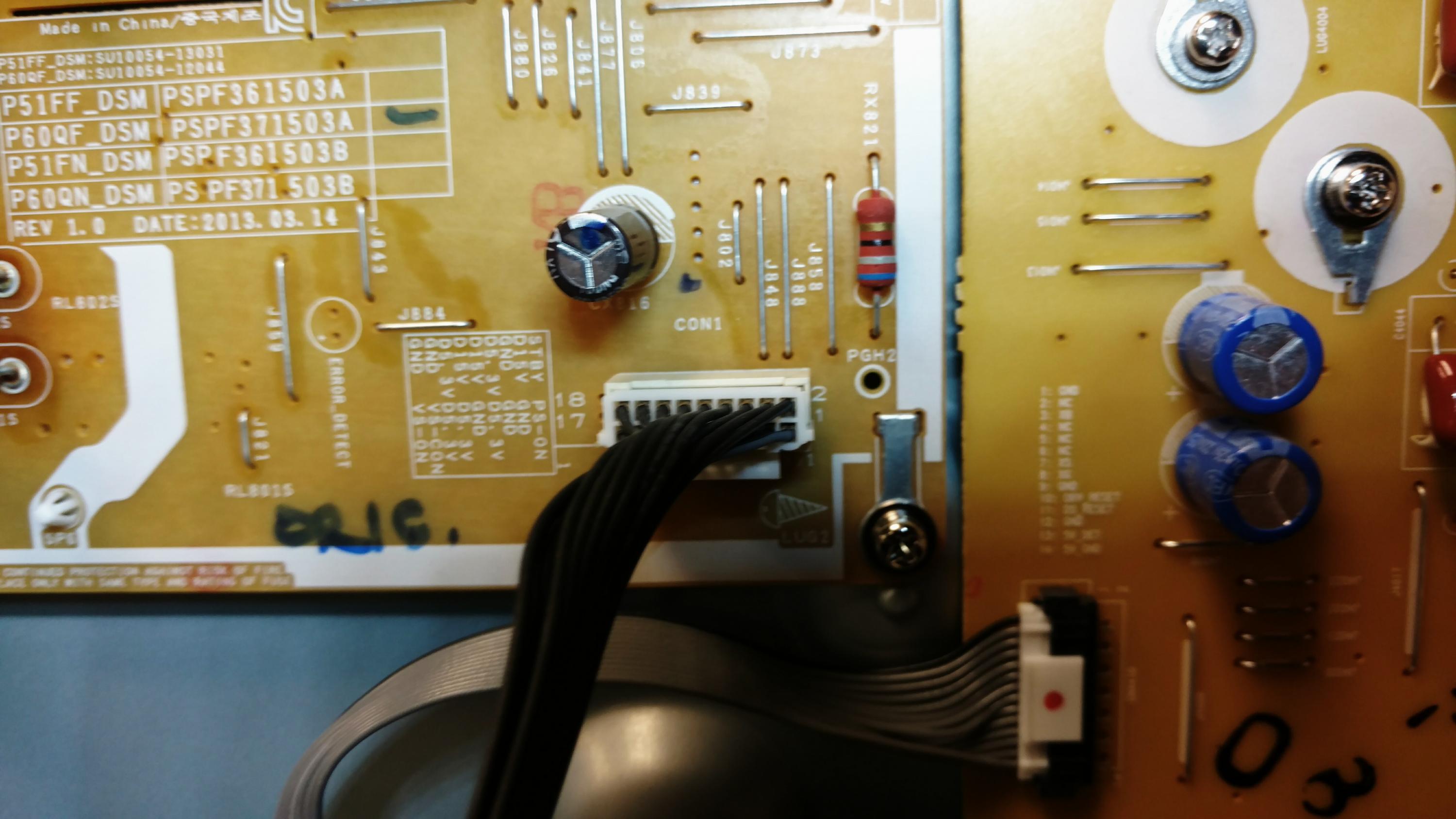

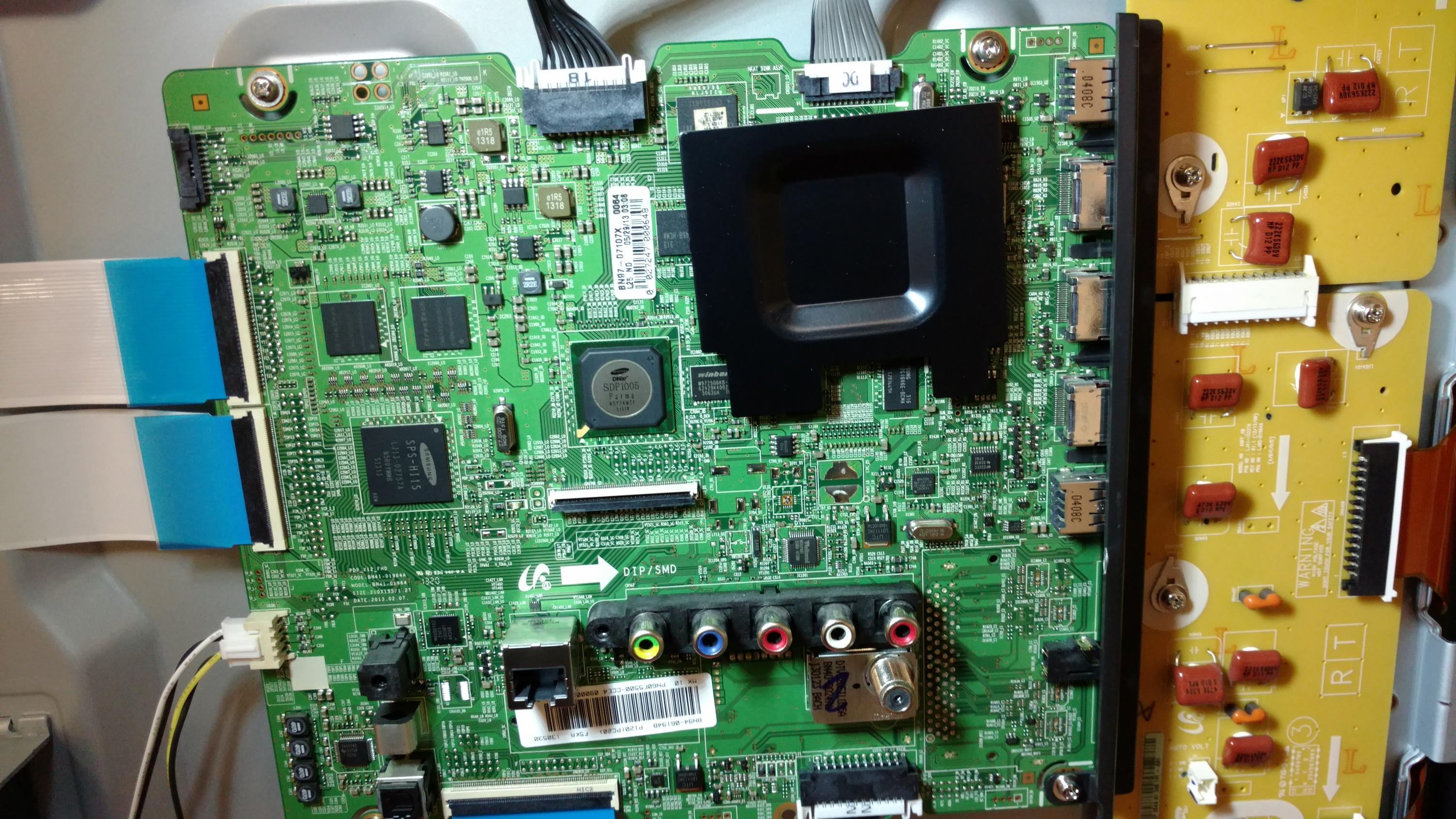

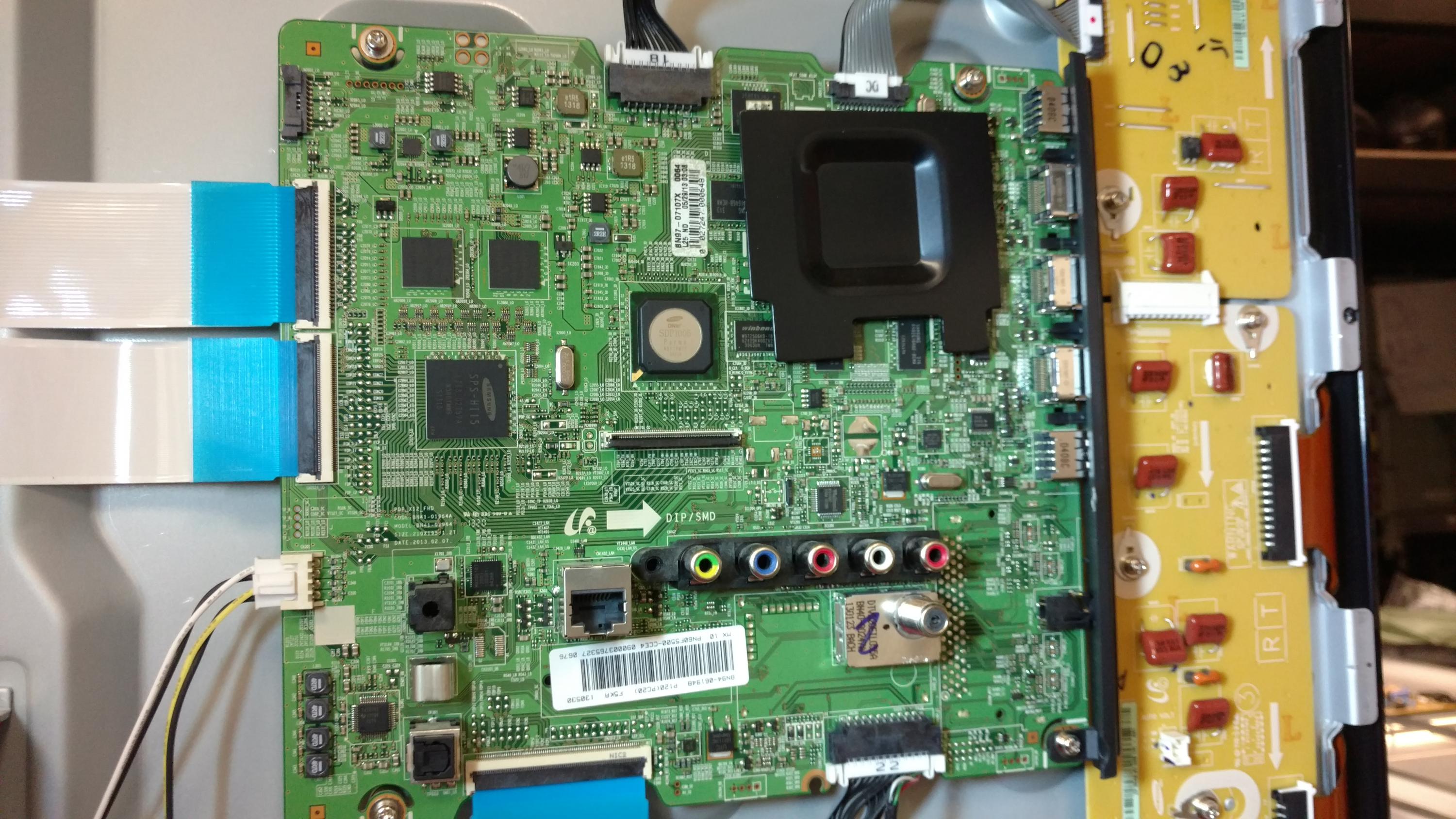

    Posting a good focused pic of your main board might help someone to locate the jumpers for you.
    Along with identifying the jumper, I need to know precisely what else to do in setting it up for running test patterns. Thanks!
    Here are new (hopefully better) pics of the main board and another pic for posterity. Actually, the third picture was something that an octogenarian customer showed me in his home and I had to share. What a difference 100 years makes!

      You have 4 holes on the mainboard close to the wire with 18 written on it. Jump holes 3 and 4.

                          Well, this plug is confusing. Can someone help me identify the correct pins? The problem is the legend doesn't have a numbering system as they often do (and even other plugs on this board do). Here is a picture:
                          • Hamie
                            • Apr 2014
                            • 1383
                            #33
                            Re: Samsung PN60F5500, making me question my sanity
                            What's so confusing about it?
                            Pin 1 is ps-on, pin 2 is standby?
                            • Hamie
                              • Apr 2014
                              • 1383
                              #34
                              So PS on jump to the pin below it.
                              And stby to the pin diagonally to the bottom.

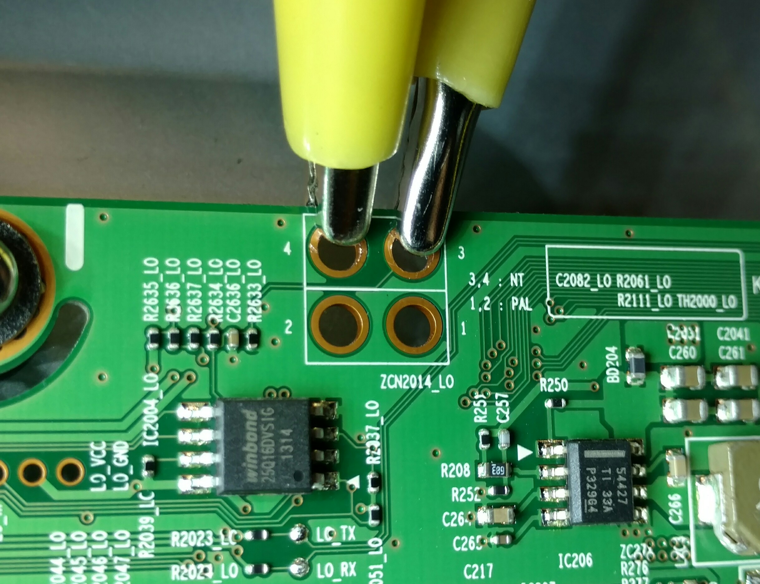

                                Thank you for explaining it. Okay, So I jumped it in that way and also jumped pins 3 and 4 of the test pins on the main board and plugged in the TV, still no picture, no test pattern. I tested the VS, VA VE and VSC and they all stay up now, though.
                                Did I do this correctly or....?
                                  Can you show me your 3-4 jumper please
                                    Here is the picture.
                                      Strange one. I'll give you that.
                                      Has the panel got a glow to it now the voltages are up?
                                      My thoughts would be that the control portion of the mainboard as failed in someway.
                                      You could try applying some pressure to the BGA chips closest to the jumpers and see if test patterns kick in.
                                      Although pure guess work I'm afraid, I'll leave it open to someone who has actually worked on this model, as I have not.
