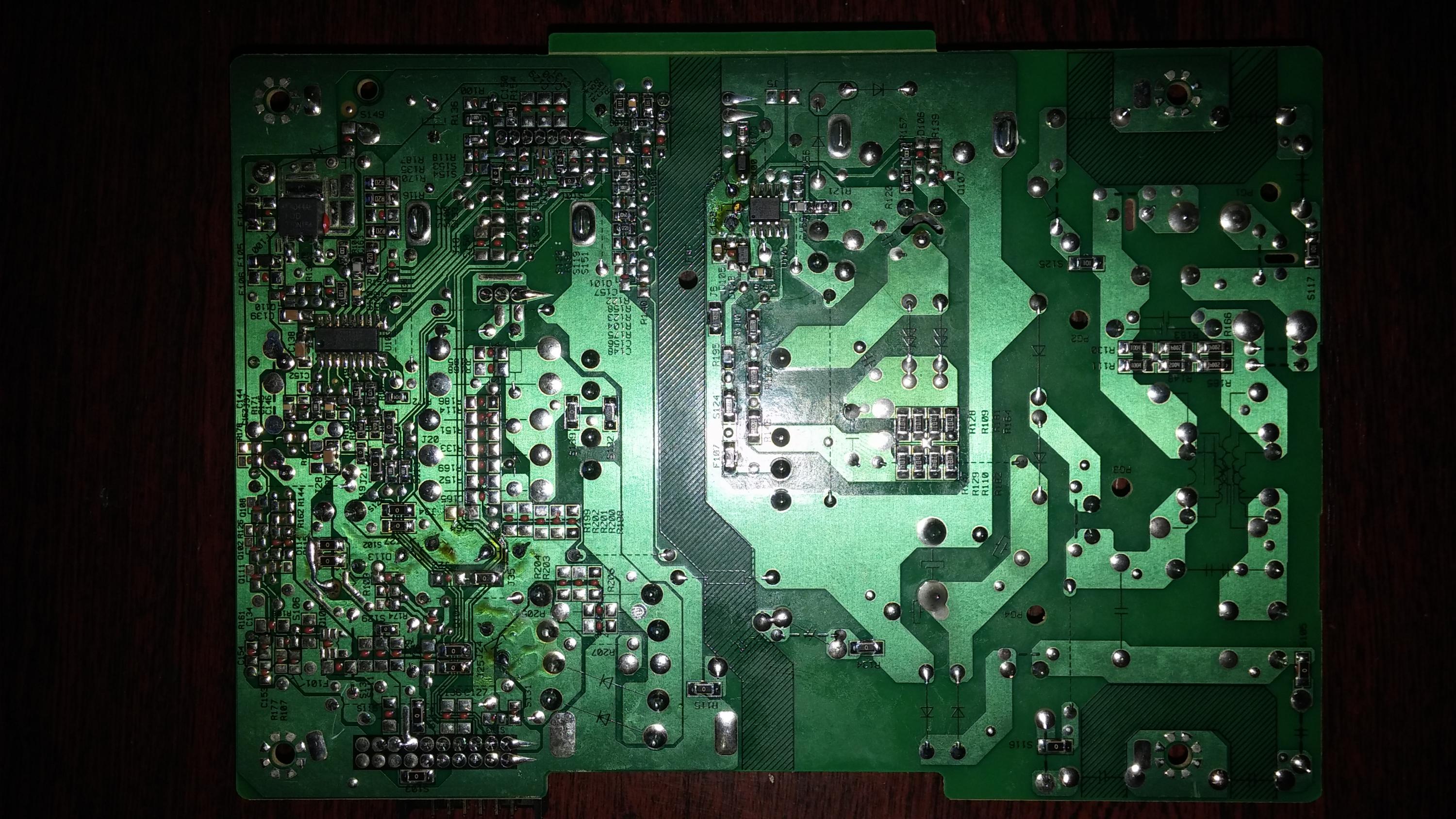

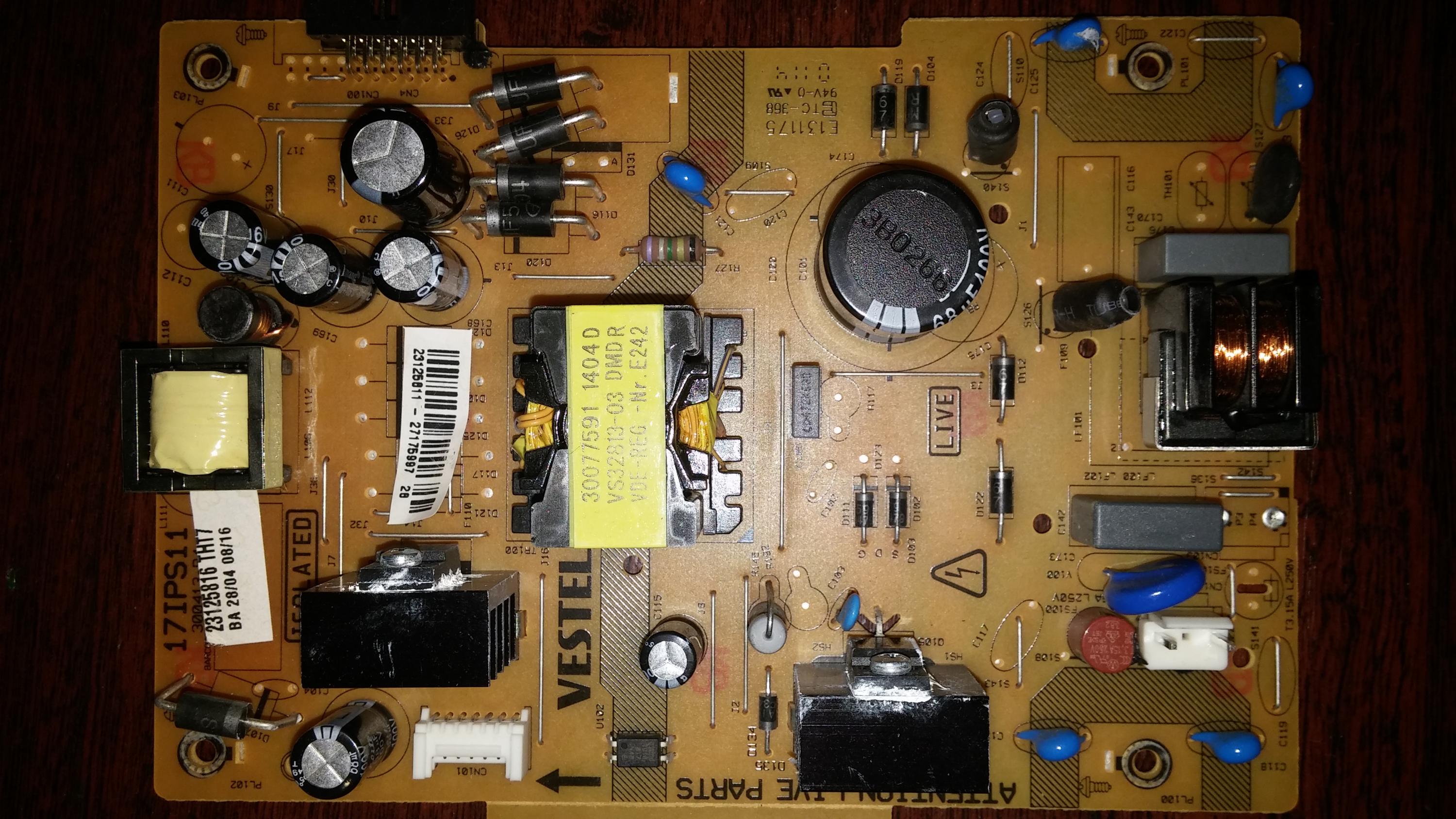

    So as the title says... I have got the most F-ed up power supply that I need to somehow repair since it is either impossible to get it in Croatia or too expensive.
    First things first, it is a 32" Quadro LED LCD TV which all of a sudden did not wont to turn on, no backlight but there was some picture that could be seen in a dark room and the sound was OK.
    Opened it up, tested the LED strips and there were 6 dead LEDs, replaced them put everything back up, nothing changed. Measured the output on the power supply and it gives 42 V on DC range and 96,4 V on AC that goes straight to zero after a few seconds.
    I replaced the caps but that didn't fix the problem, and I dont know where to look since this the first LED that I am trying to repair.
    Any suggestions?
    The pics are here.

        Looking at the capacitor close to connector CN101 rated at 100V I would expect the Led voltage to be somewhere near that voltage 70 - 80 V but this is just guess work.

                          Got the PCB to a frend of mine who repairs TVs and he told me that both of the SMD ICs on the back of the PCB (green side) seem to have wrong readings and that they should be replaced, so I am gone order new ones and ones I replace them I am going to make a new post.
                          Thanks guys
