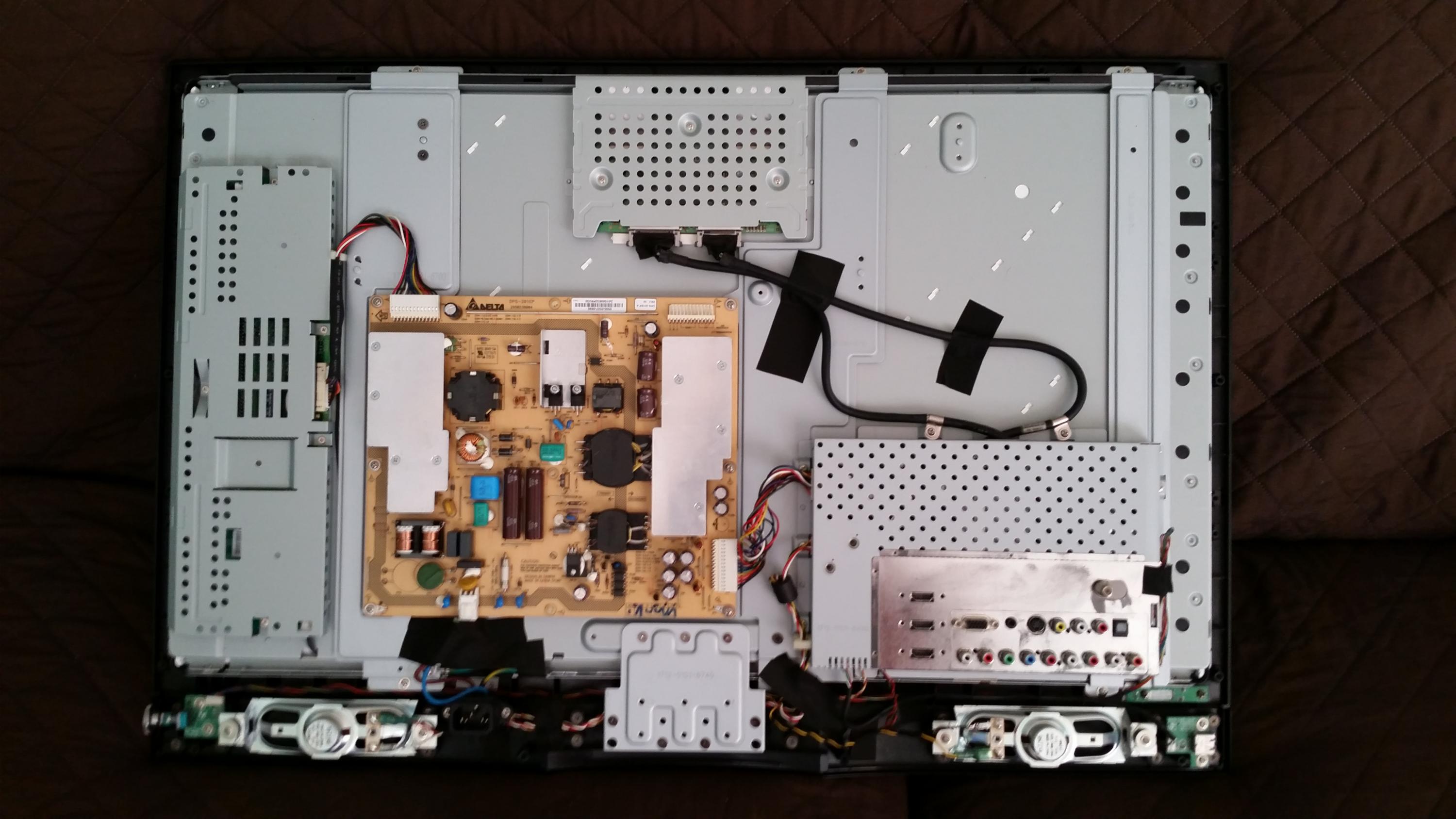

    Checking this tv Vizio SV320XVT for my friend.He told me the tv started with
    no video but with sound now when turned on it shows Vizio image and then
    black screen but Vizio lights stay white and no sound.It doesn't give chance
    to do anything no menu if hit Imput button do nothing.I checked some voltages
    CN3 Pin 1-----3.7v with tv ON
    Pin 2,3,4--14.2v " "
    Pin 5,6,7,8---0v
    Pin 9,10,11---6.4v
    Pin 12------4.5v
    Pin 13------4.5v
    Pin 14------7.5v
    So what could be the problem,the backlight inverter,the tcon board or the main board?
    Thanks for any help.
    See attached file

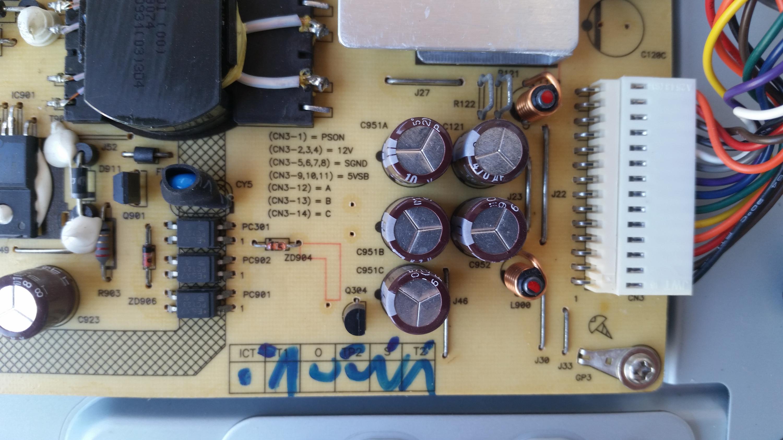

      Re: Vizio SV320XVT no video no sound
      We need the name of each pin so we can tell what Voltages are not correct.
      The picture is also not in focus so I cannot tell where the CN3 is: main board or the power supply board?

        Thanks for answer.The CN3 is in the power supply,the names are:
        Pin 1= PSON
        Pin 2,3,4= 12v
        Pin 5,6,7,8= SGND
        Pin 9,10,11= 5vSB
        Pin 12= A
        Pin 13= B
        Pin 14= C
        Attached new photo
          OK, you do have all the command signals, but at this point your meter probably has low batteries so the Voltage readings are showing higher tan normal, you need to check your meter to make sure is OK.

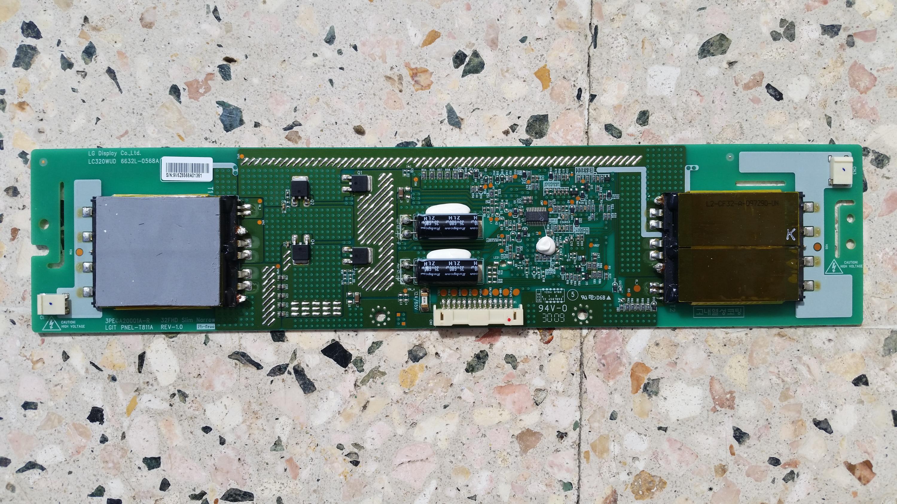

                      It means the panel is working because you can see the text on the screen with flash lights.
                      If you look at the back of the TV in the dark room, you should see backlights shining through some holes of the back side of the LCD panel, it does not sound like you have backlights otherwise you will not need the flash lights to see the image on the screen.
                      We need good clear pictures of inverter board.

                          Attached picture of the inverter board.
                          • dick_barton
                            • Aug 2015
                            • 6642
                            • Wales

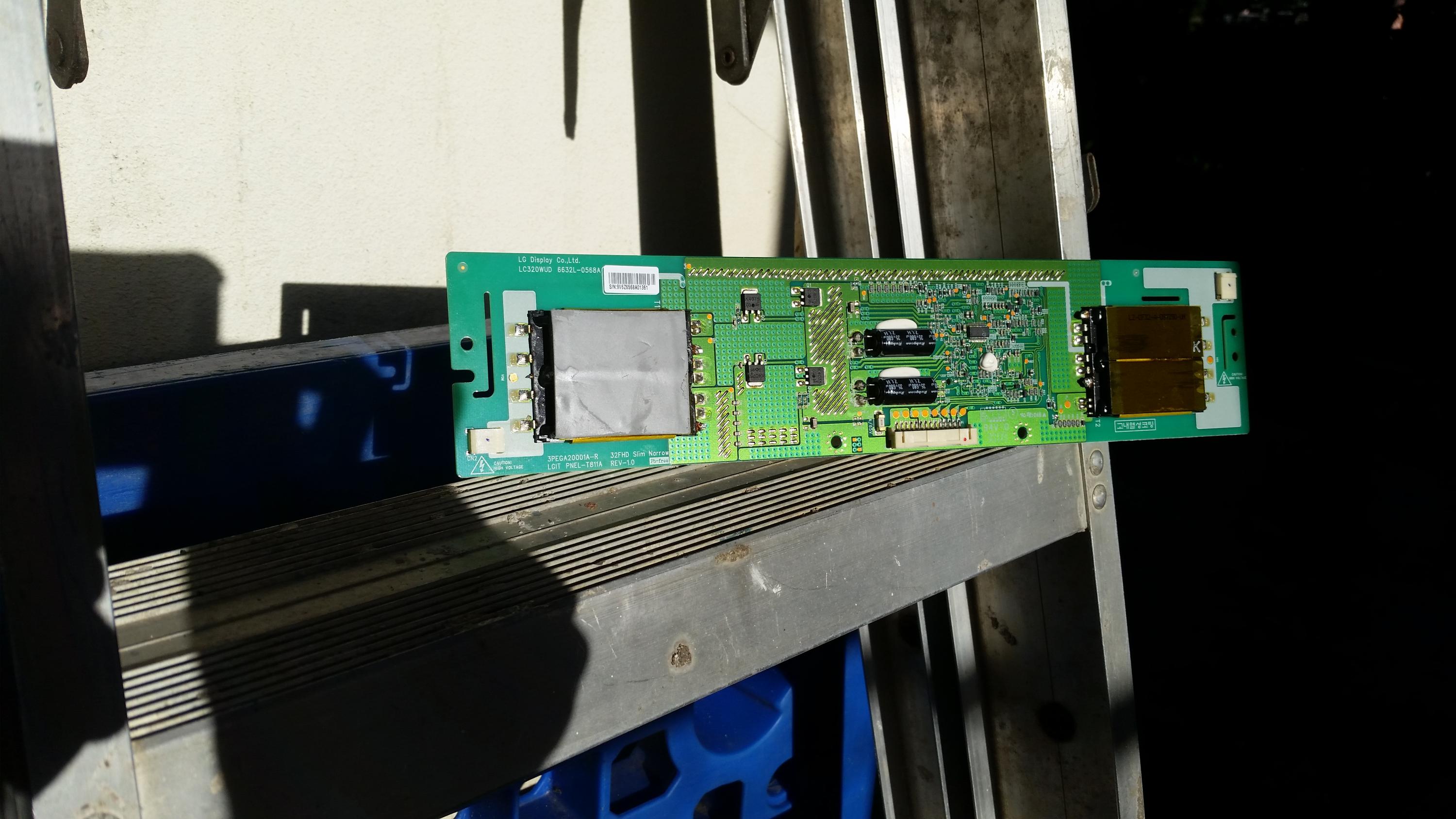

                            When hit power button the screen turns on and show the vizio logo and then black screen.
                            Check you have 24V on both sides of the white ceramic fuse marked ?A/65V (can't really read it from the photo)
                            • ruben53
                              • Sep 2015
                              • 37
                              Yes it has 24.4v on both sides and on both capacitors.It is 12A/65V
                              Attached another picture
                                What dcv do you have on these test pads when TV is turned on?
                                VBR-A
                                ON/OFF
                                VBR-B
                                STATUS
                                  What is the IC number (OZ9966?)
                                      What is the LCD panel P/N? LC320WUD-SBT1???
                                      The STATUS (LAMP STATUS) test pad may give a clue.
                                      Per spec sheet:
                                      Normal : Low (under 0.7V) / Abnormal : High (upper 3.0V)
                                      Agree that it can be the Transformer, CCFL, PWM IC.

                                        VBR-A---0v
                                        ON-OFF--1.6v
                                        VBR-B---3.2v
                                        Status---5.4v
