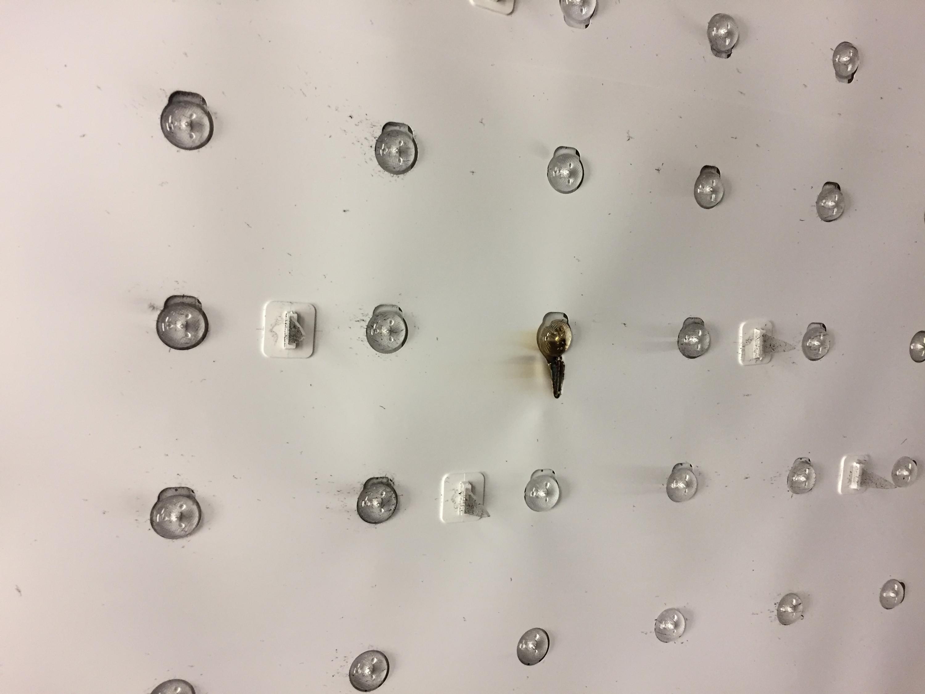

          • skinner
            • Jun 2013
            • 54
            Re: Samsung un75f6300- upper half of screen is dim

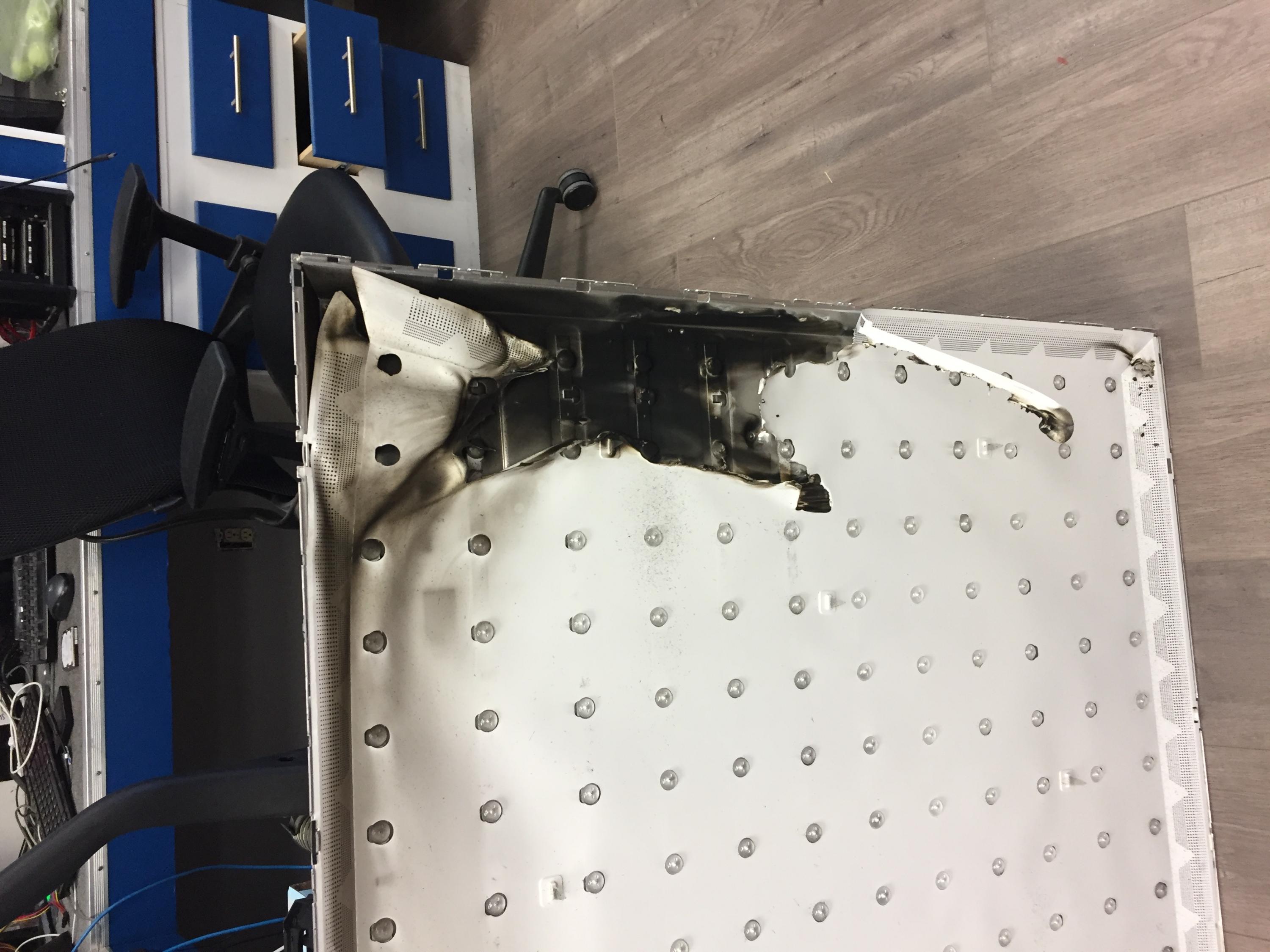

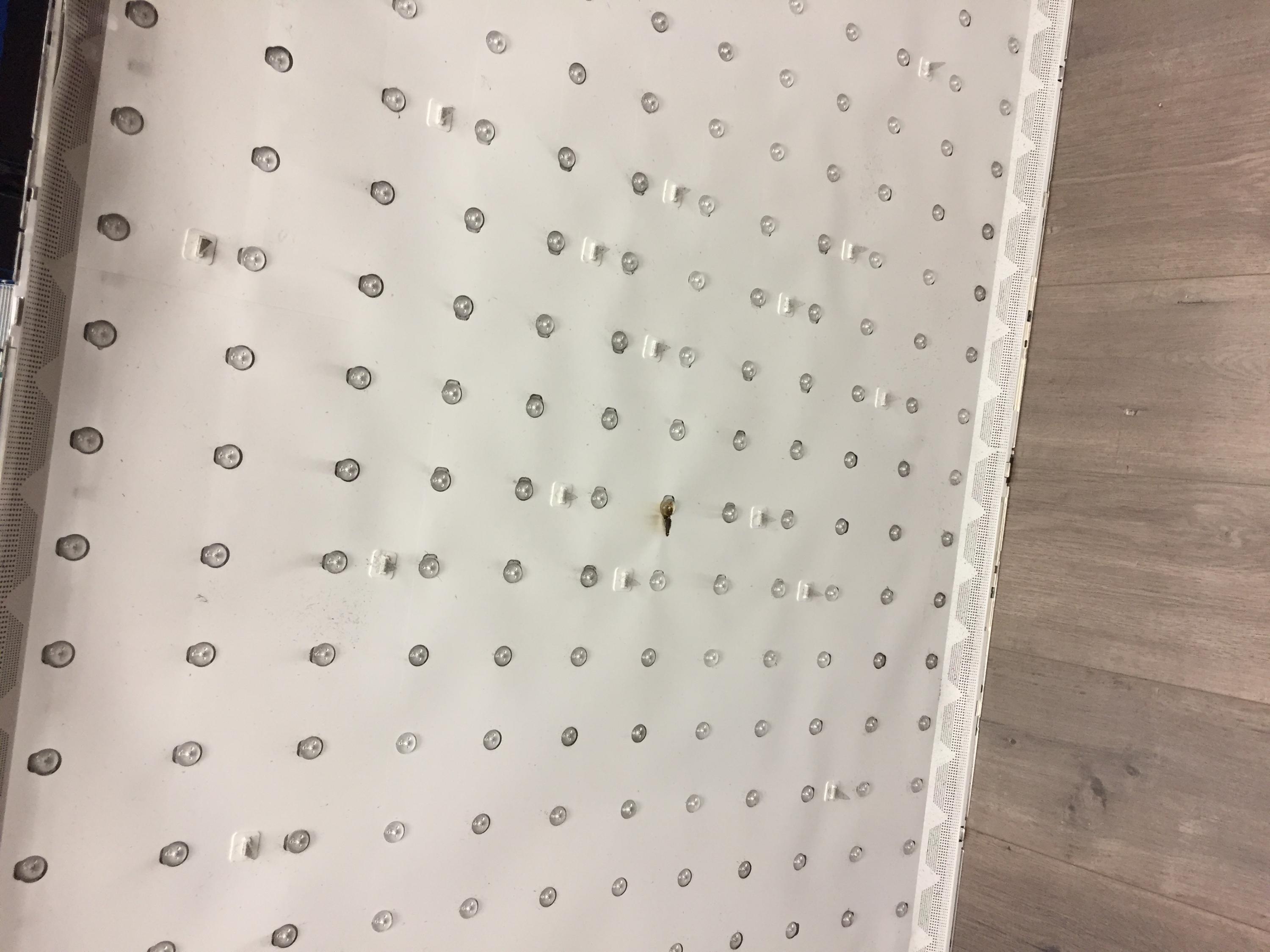

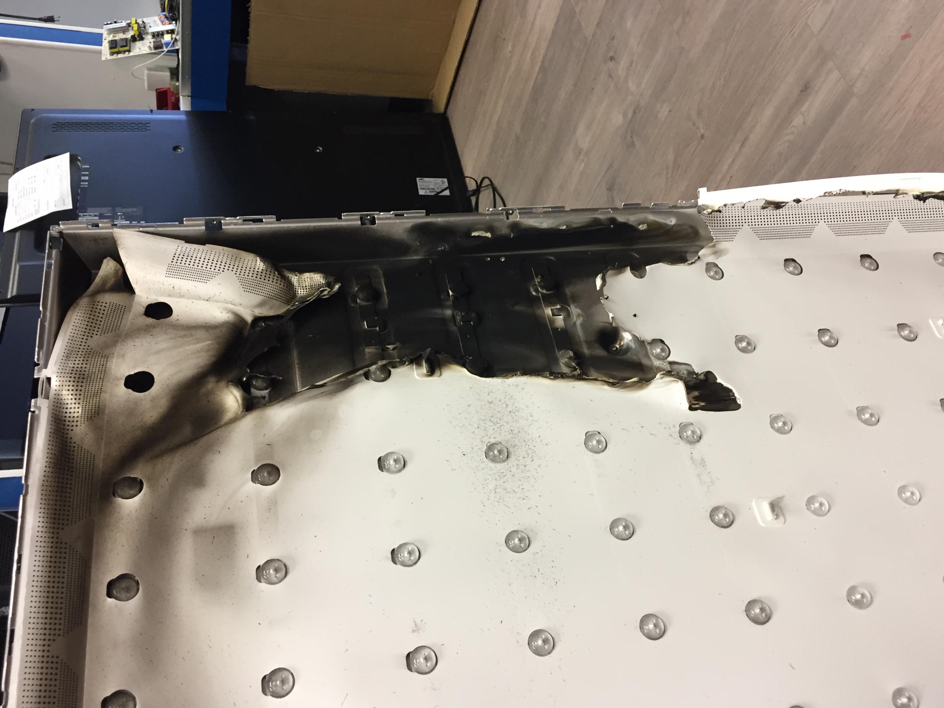

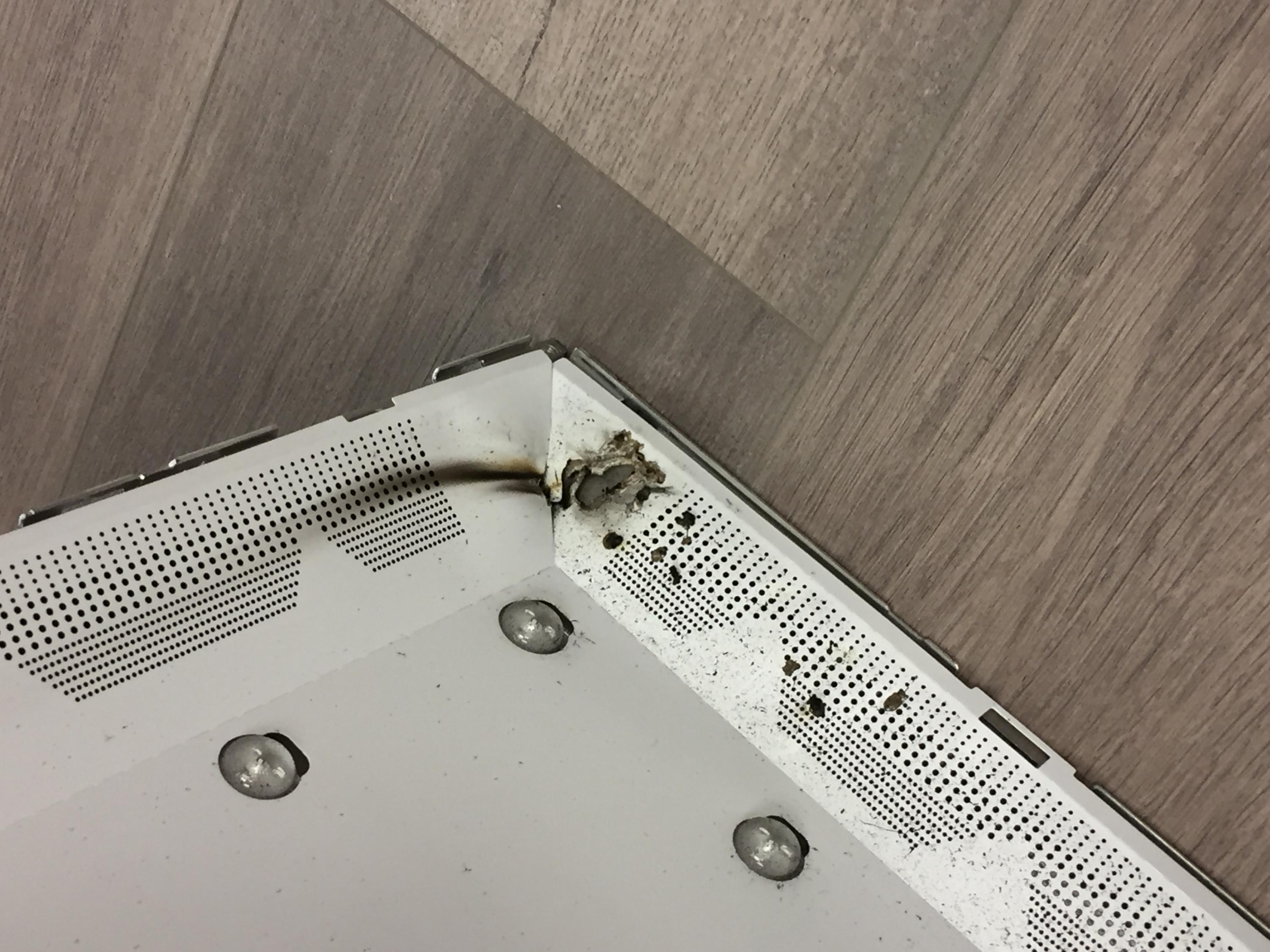

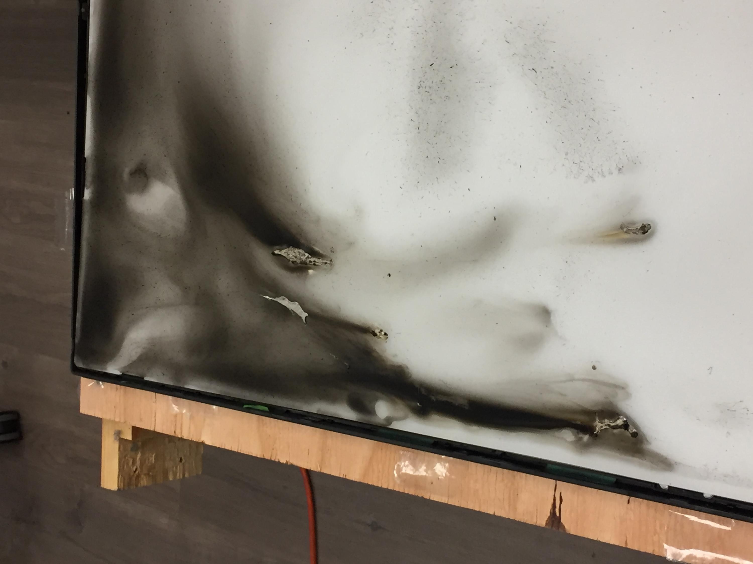

            I had the same issue and I wanted to share my experience with everyone. I swapped the top and bottom connector for the backlights on the power supply but still had the same issue so I was able to rule out the PSU. Suspecting backlights I took the panel apart and there was my issue. I think I have a back light issue.
            • saddle_au
              Waste Warrior
              • Jan 2013
              • 121

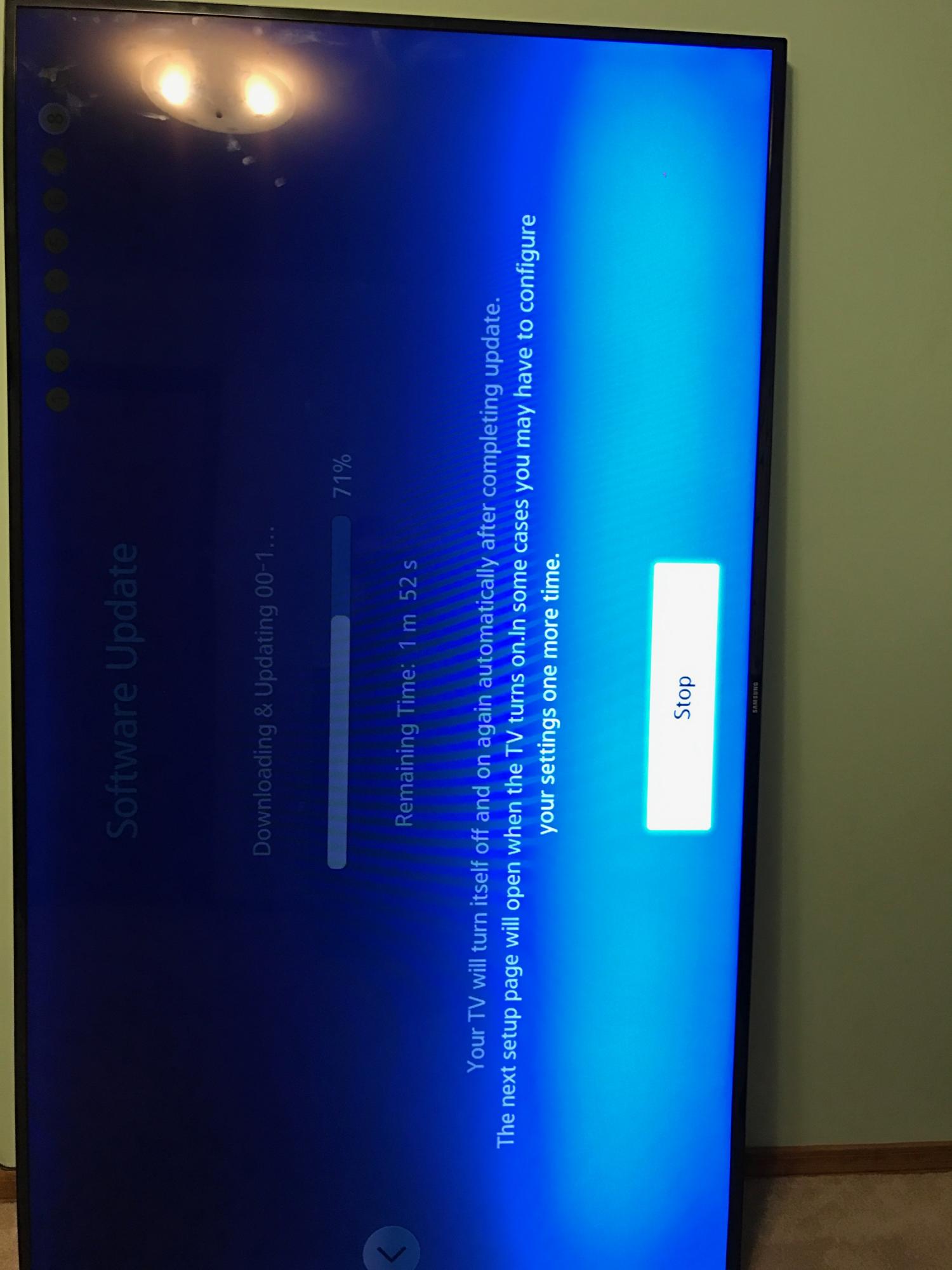

              Hate to jump in with a non-fix comment, but do you think a single led has allowed the plastic reflector sheet to catch fire? It looks like a led in the middle has also started to burn through.The edge burn in image 4 looks like a cable or joint fault.
              Unless that unit has been dunked in sea water or something else very unusual, I'd be sending Samsung those images immediately. Local to us, Samsung Washers have caused double digit home fires here due to condensation (I think) issues and high voltages.

                  Ouch thats looks terrible
                  Its crazy that such thngs are allowed to happen to the consumers and there is no recourse with the manufacturer...
                  And they in turn milk us dry on replacemnt sets..
