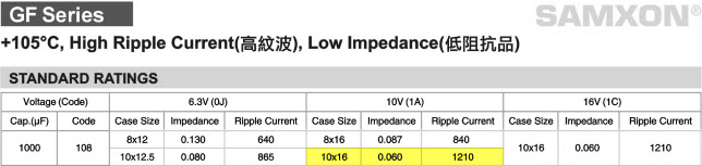

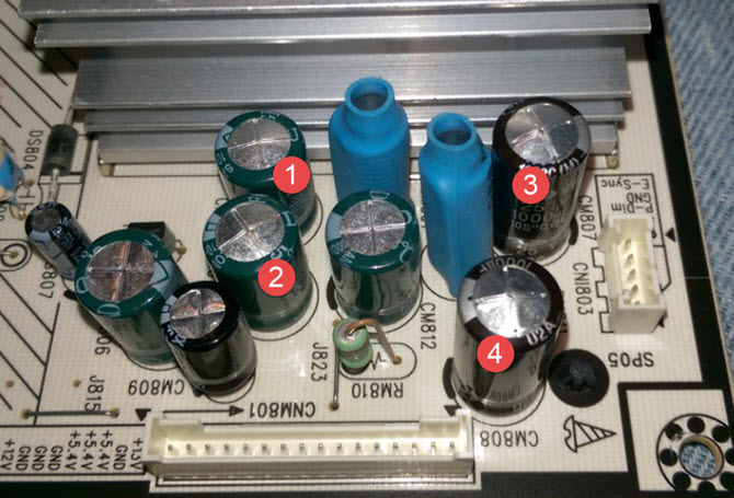

    Recently, my Samsung LNS4041DX/XAA is taking several minutes to start up. It will click several times and eventually turn on. In searching the web, I found several references to this occurring due to bad caps on power board (BN44-00134A). I opened mine up and found the several bulging caps (pictured). I've pulled them from the board and I'm looking to replace them.
    Capacitor 1 and 2 (CM817 / CM811)
    Samxon 1000uF, 10V, 105C8, GF(M), UDA
    10mm, 16mm (diam, height)
    (pictured)
    Datasheet (Samxon GF)
    https://cdn.badcaps-static.com/pdfs/...2d7a55af48.pdf

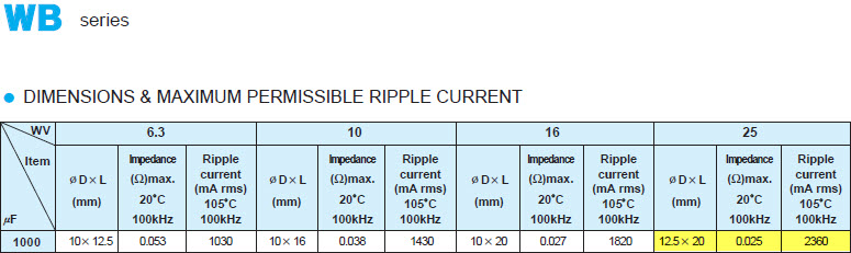

    Capacitor 3 and 4 (CM807 / CM808)
    Samwha 1000uF, 25V, 105C(M), WB, U2A
    10mm, 21mm (diam, height)
    (pictured)
    Datasheet (Samwha WB)
    https://cdn.badcaps-static.com/pdfs/...e01af2af63.pdf
    I've looked on Mouser and found a couple of close replacements, but the ripple current aren't exact. Is it better to order a replacement that has a slightly higher or lower ripple current? How about higher or lower Impedance / ESR?
