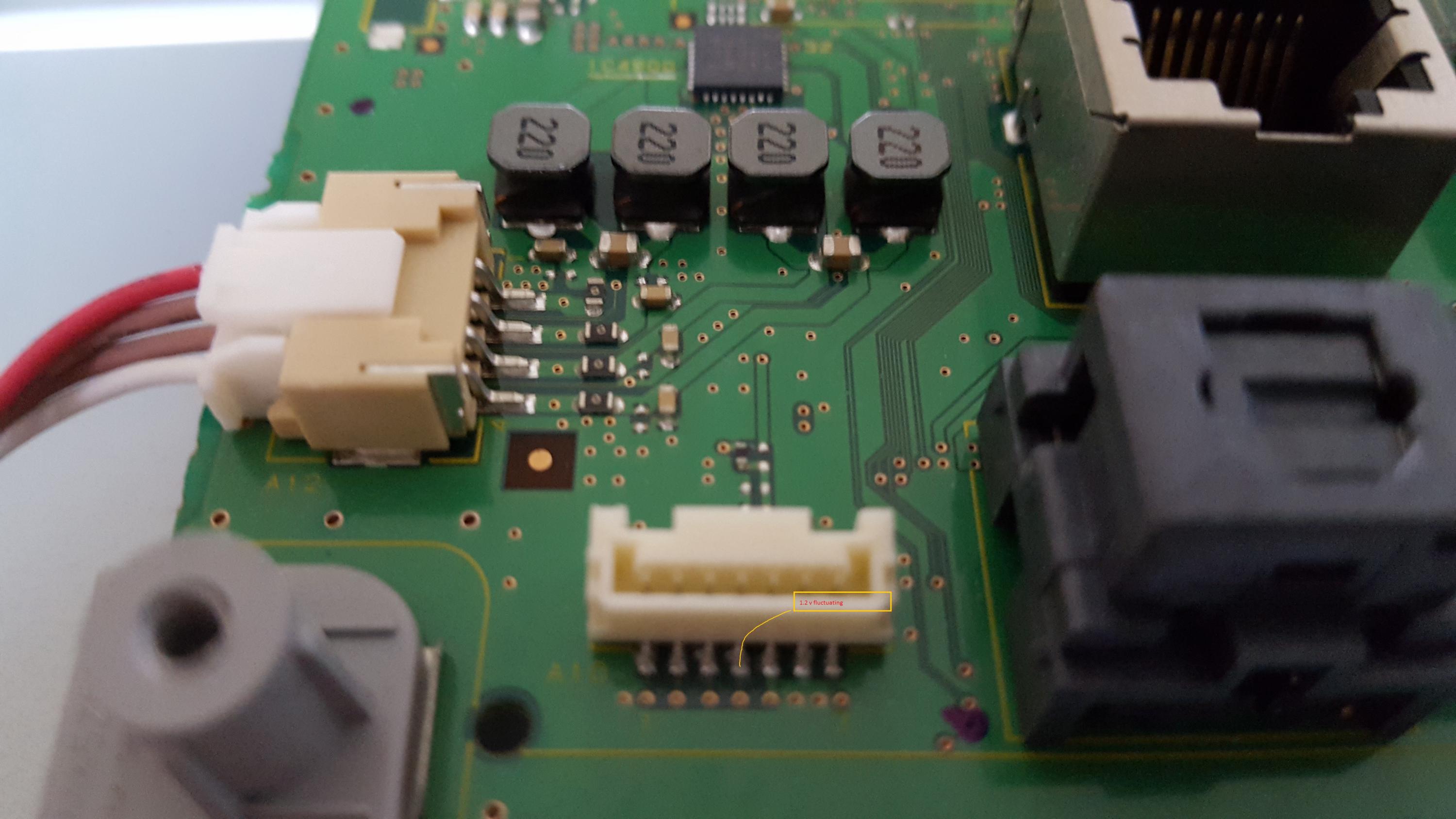

    Woke up on xmas morning to find my 2 year old panasonic tv just blinking at me.
    Whole screen blinks at one second intervals.
    Please help.
    Please see attached.

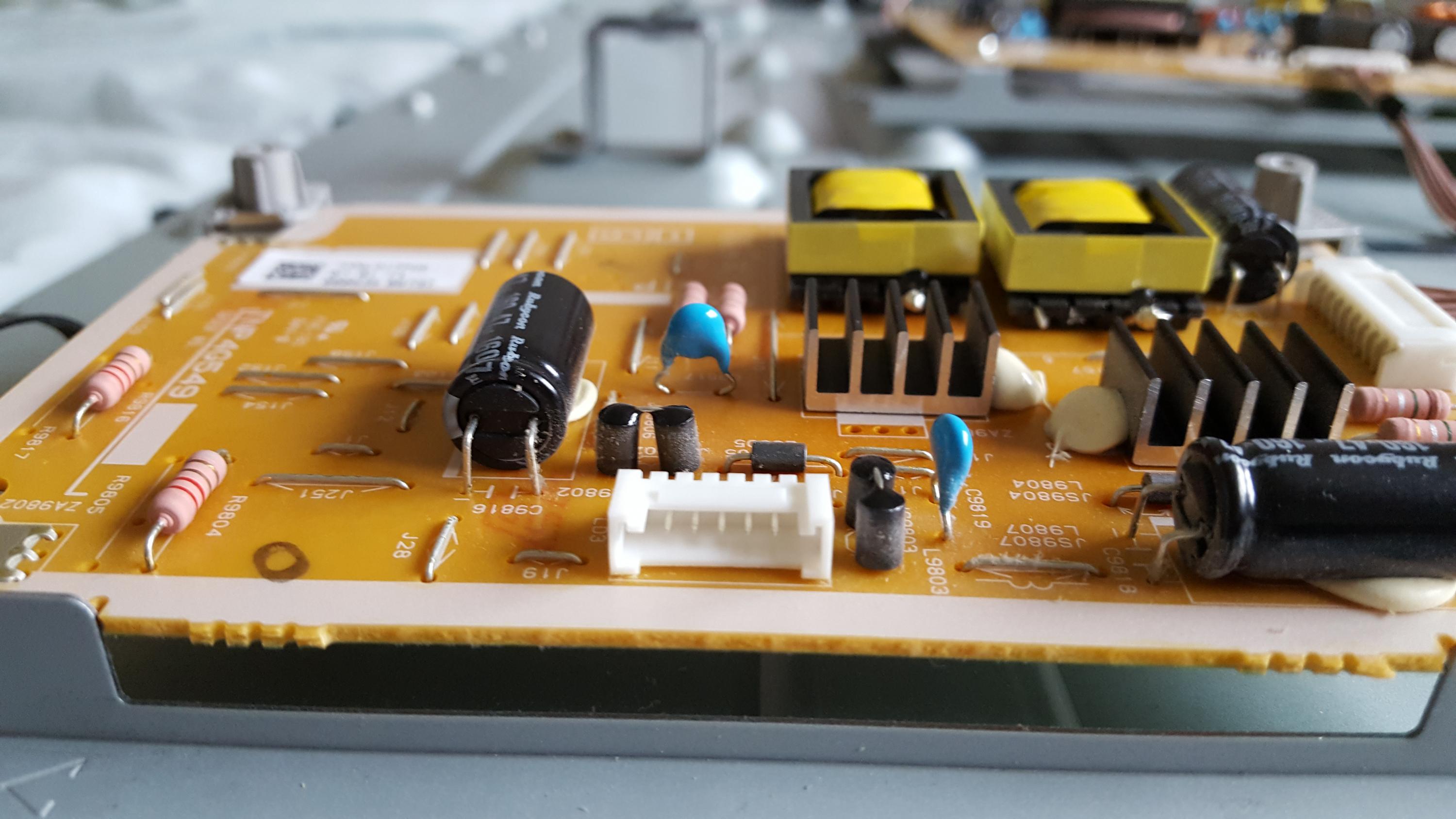

    i am getting a steady 5.2 volts at the standby pin with all leads disconnected.
    the centre pin on the main board to the Tcon board is fluctuating from 1.1v to 1.25v.
    i get 107v fluctuating to 85v on the outlet from the LED driver board.
    Ihave not yet removed any further panels to check LED's
    Many thanks in advance

    You have one or more blown leds, its nearly always the leds on this particular set.
    Done about 10, always been leds
    Some just done come on
    Some come on and no display
    Some come on and flicker

      After stripping the TV down i found 3 rows of LED's not flashing and 3 rows that were.
      i swapped out 2 good ones for 2 bad ones and got those to flash too. but still only the centre 3 strips flickered.
      After swapping the bad top strip (L1.R1) with the centre (L1.R1) the outer 3 flashed.
      so it leads to one strip of (L1.R1)
      will report back if fixed, many thanks for your help

        if you have a multimeter
        then set on diode mode and test each led sep
        you just have to scratch the paint a bit
        https://www.youtube.com/watch?v=eEJoPCa7Kt0
        then you can see whats what.
        Some times they do go in a bad way and take out the inverter
