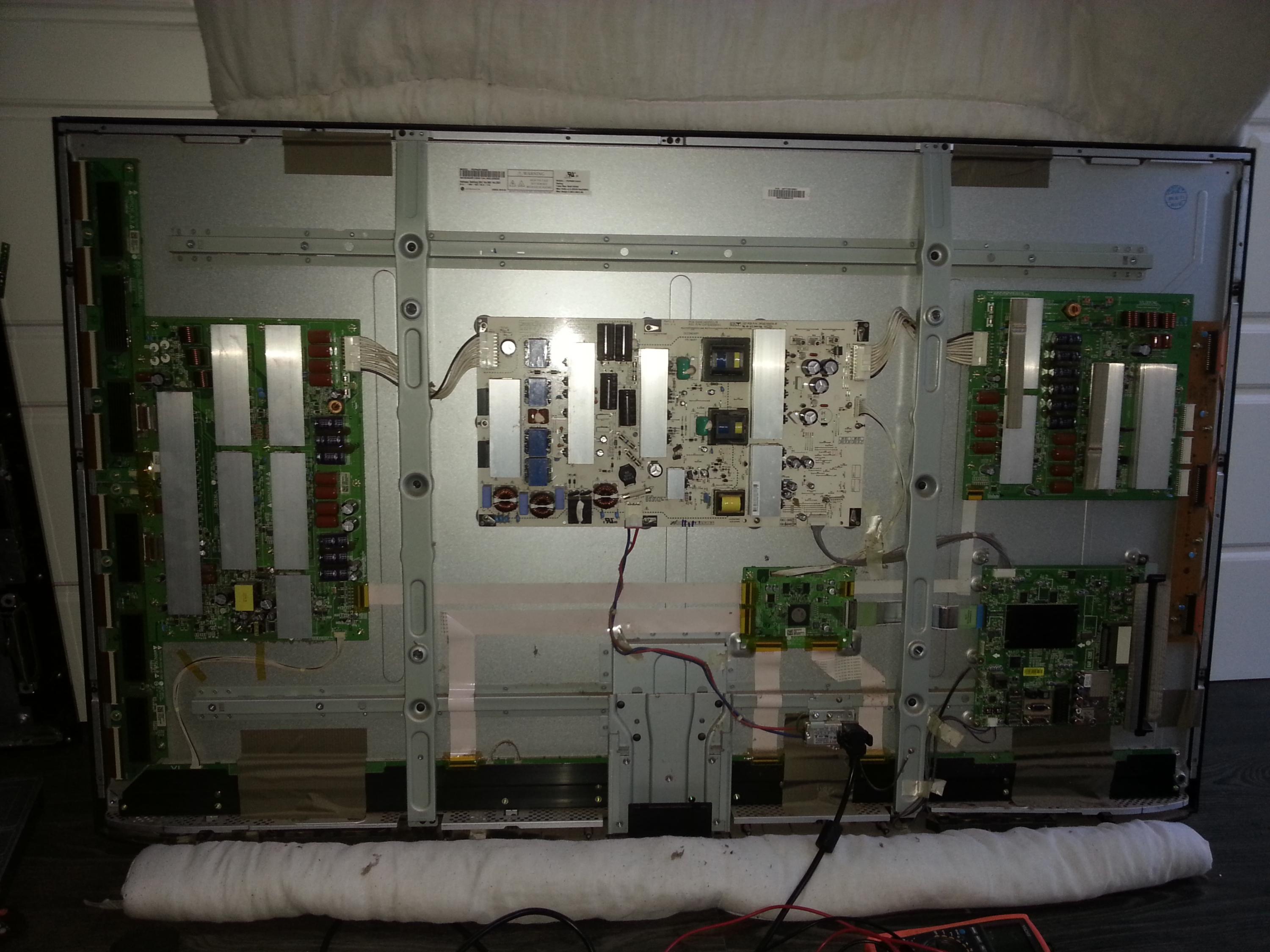

    I have a LG 60PK590 here.
    On power on, the screen lights for a couple of seconds then dims but is still glowing.
    All the voltages check out and when I jumper the two holes on the control board and power on the TV I get the test patterns.

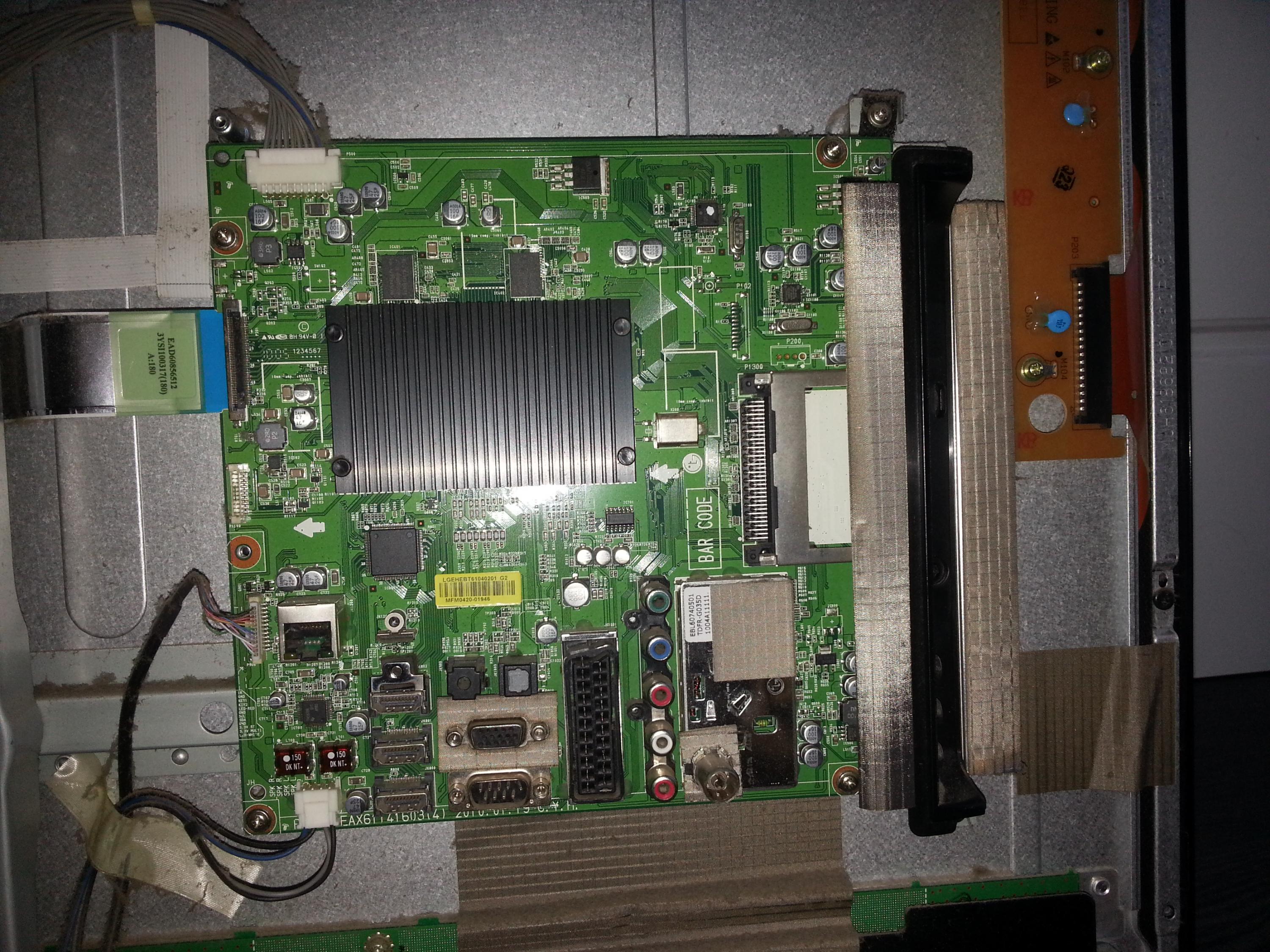

    This suggests the mainboard, its a EAX61141603(4)
    Has anyone repaired one of these or similar ? any pointers ?
    I've probed a points and there are voltages all over, the XD engine IC gets warm.

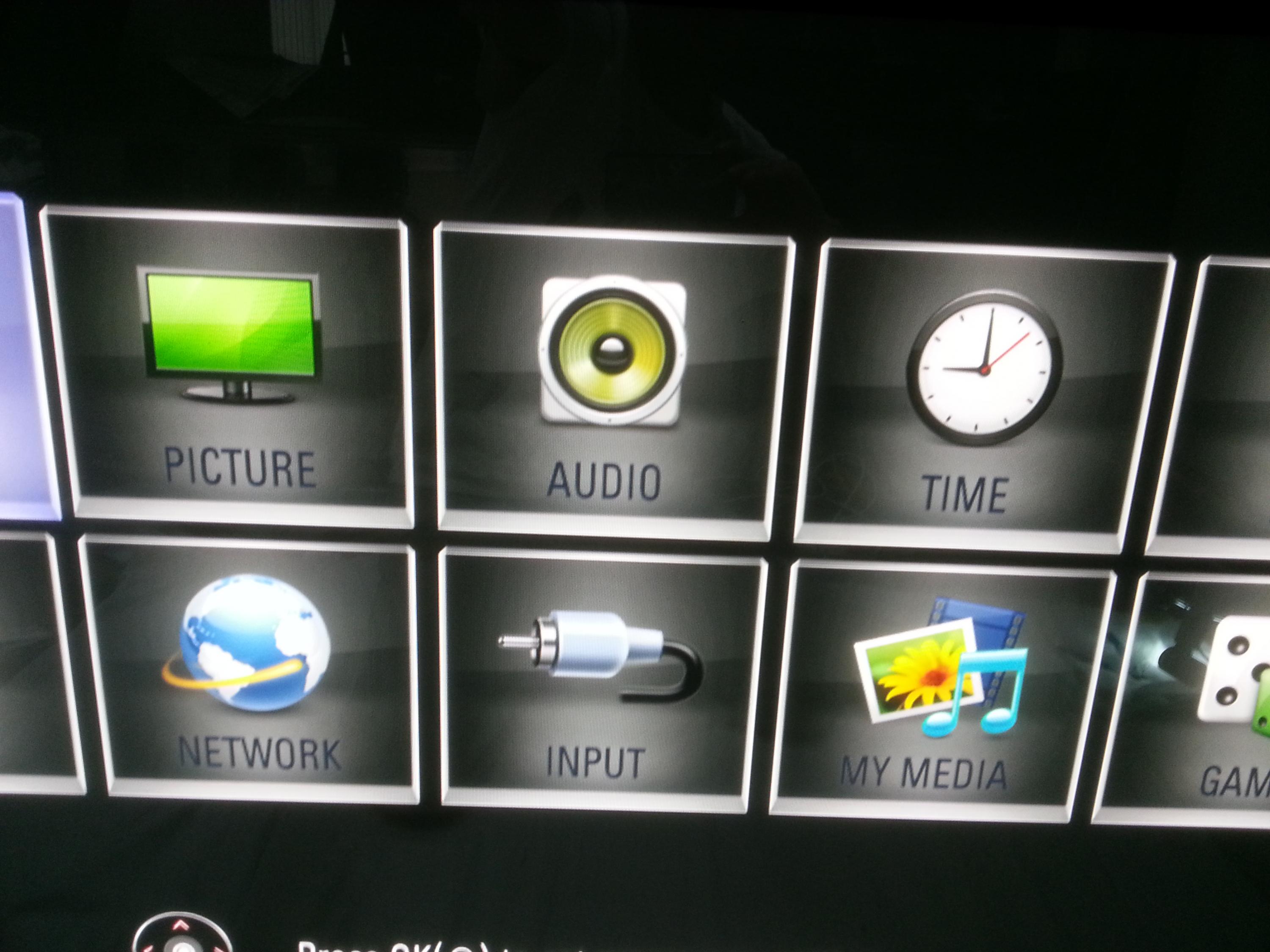

    Ran the test patterns bud ?

        Re: LG 60PK590 mainboard ?
        Yes

          Shit, still recovering from last night out. Replace mb then
          Maybe reflow cpu or reflash the firmware.

            Haha, no worries mate. I was thinking reflow last night but thought I'd ask anyway.
            Yep, gave it a reflow and BINGO ! The TV is now working

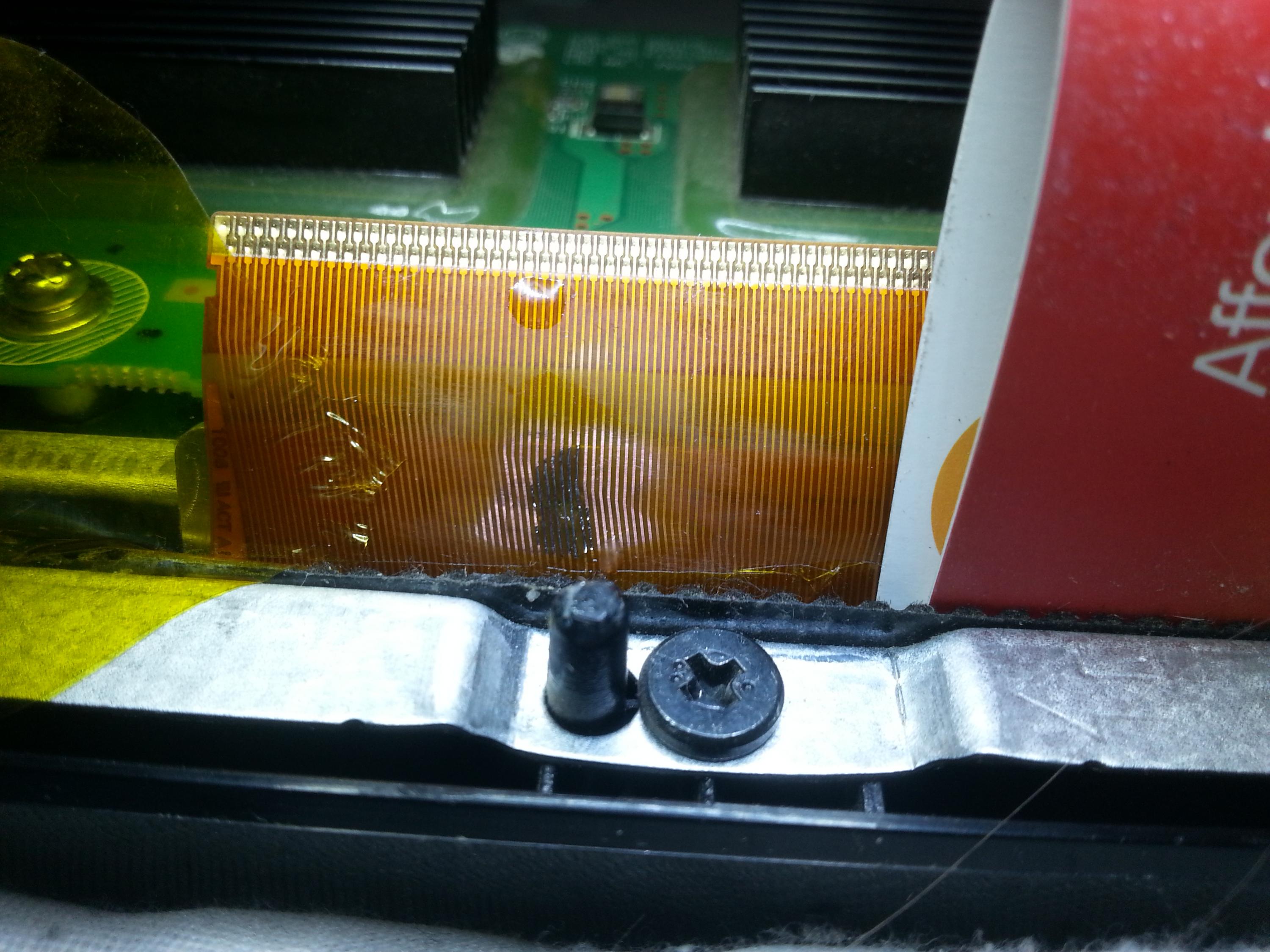

              That's weird, works fine with the back off. I put the back on and there is a strange double click of the relays and the TV does not come on.
              I take the back off and it powers on fine, back on and double clicking....

                Well, as I finally got round to fixing this I thought I'd post what happened.
                I managed to catch one of the ribbon cables going to the screen.
                5 traces cut meaning there was a black line all the way across.
                Using single strands (0.15mm) from some mains cable, my iron set on 300c and my microscope I have managed to repair the traces.
                I sanded back the ribbon to it revealed the copper, applied some flux and tinned the traces. I placed a small aluminium heatsink behind so I had something to press up against.
                I tinned the copper wire and carefully soldered them on.
                A dab of transformer resin sealed the work.

                      Thank you. It wasn't as hard as I imagined. Having a stereo microscope meant I could see what I was doing and as I was laying down with my hand on the floor it was nice and steady. I was concerned the flex might melt as I applied heat but it didn't.
                      I used a Bakon 950D and the small bent tip. Nothing special really.
