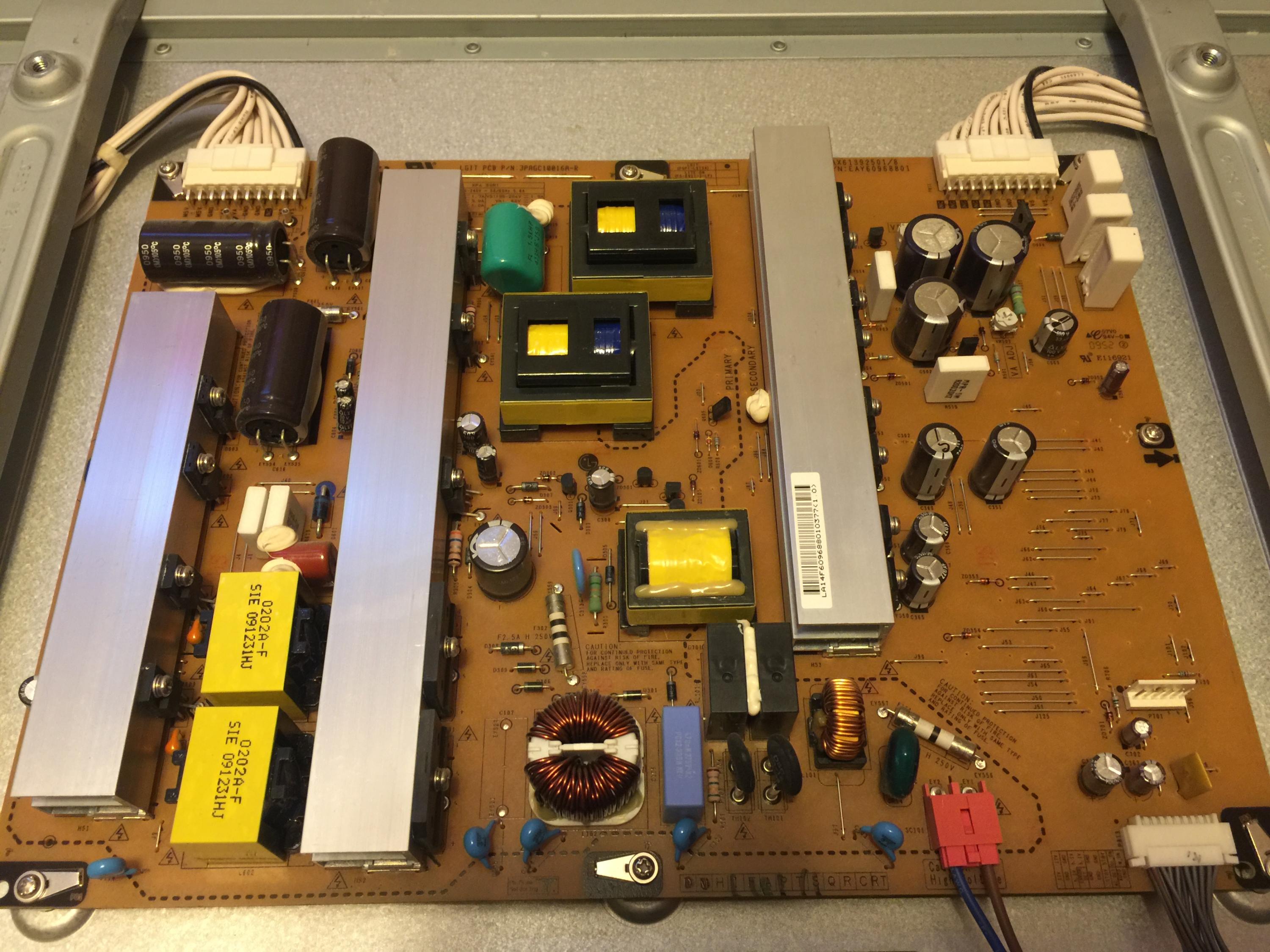

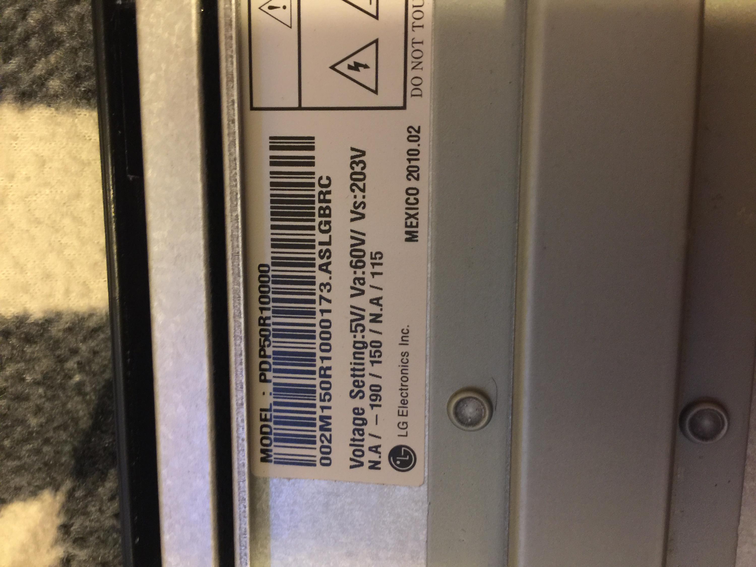

    I have used these forums previously to help troubleshoot and repair capacitors/replace boards on LCD sets, however just was asked to look at my first plasma. I've done some reading about the differences in boards but the testing of the voltages/y vs. z boards confuses me.
    The TV clicks when trying to power on. The screen will flash gray a couple times then the set shuts down. I've unplugged both y and z boards and turned on the TV to only exhibit the same behavior. I've checked all capacitors for failure and there is none visible. I've checked the 3 white resistors in the upper right of the board and they all measure 10.4 ohms stable. I have also removed the board to check for broken solder points and nothing jumped out at me there either.
    Beyond that I'm not sure what or how to check next. I do see the VA and VS test points but not sure how to test (from point to ground to test voltage?).
    Thank you in advance.
    Jason

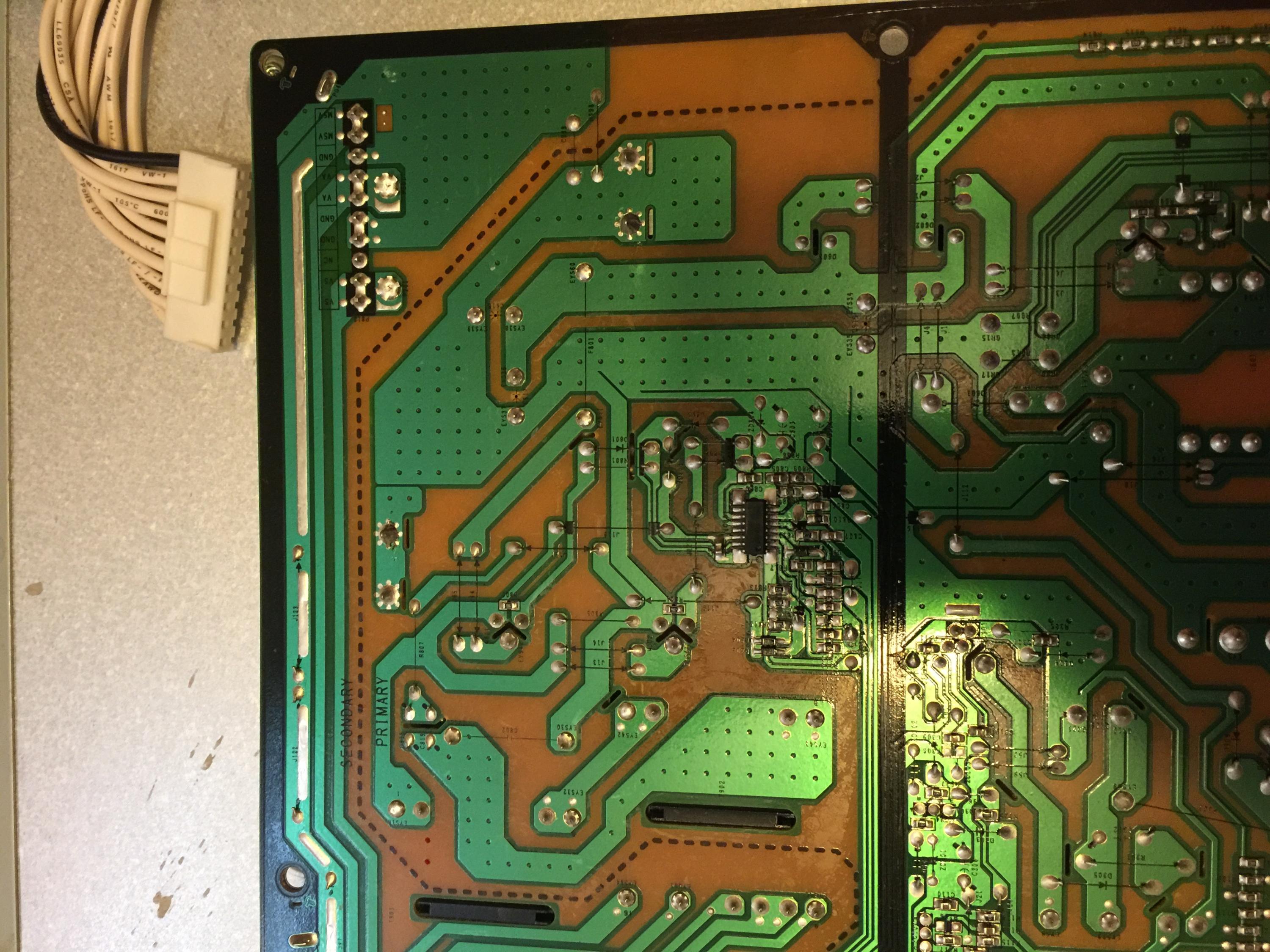

    Re: LG 50PK550 clicking - plasma newbie
    Photo of the underside of the board.
    • jason424
      • Dec 2015
      • 187

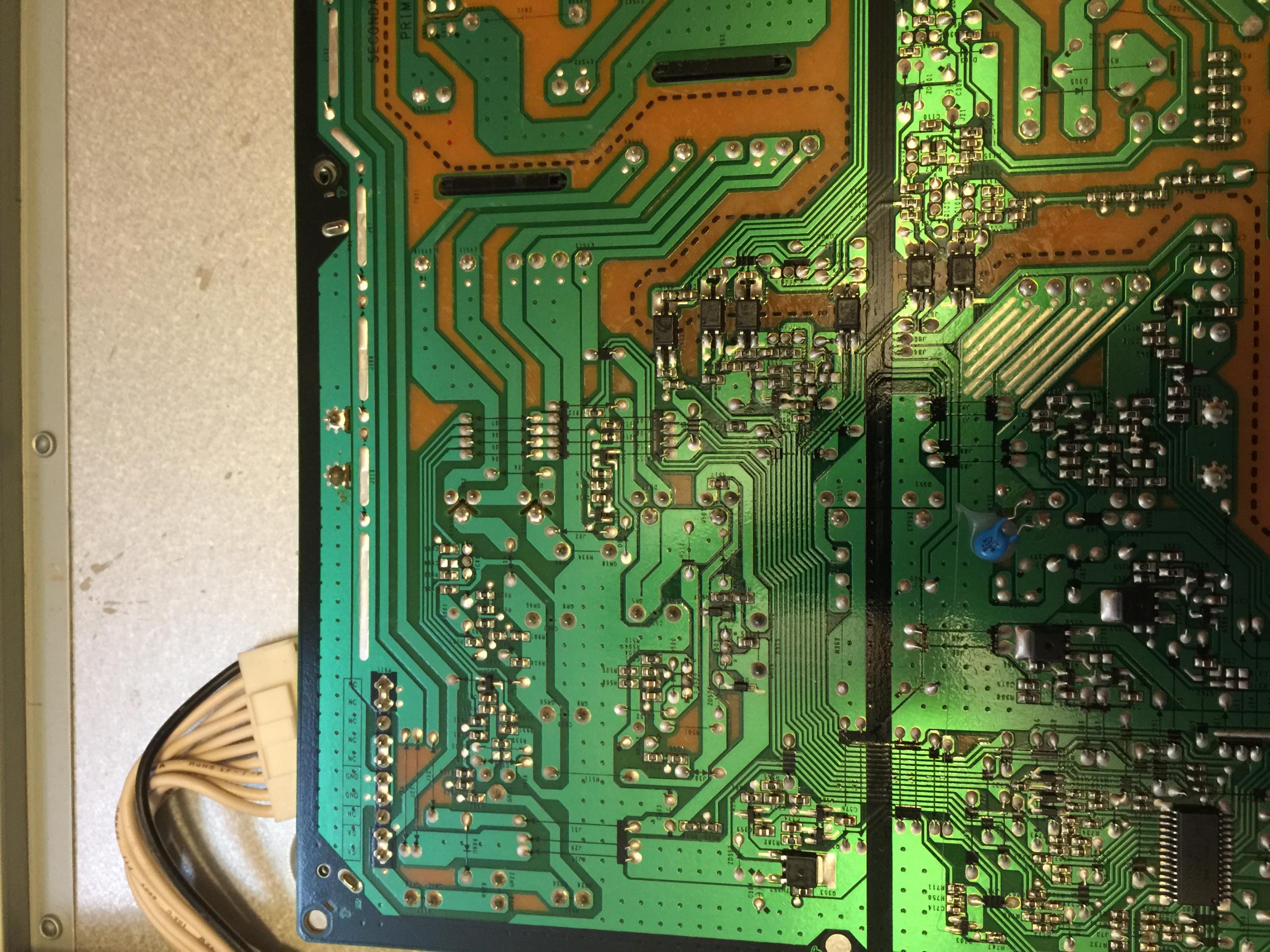

      Attached 4 quads of the board.
      EDIT: I just noticed these all rotated counter-clockwise before uploading.
      Thank you,
      Jason

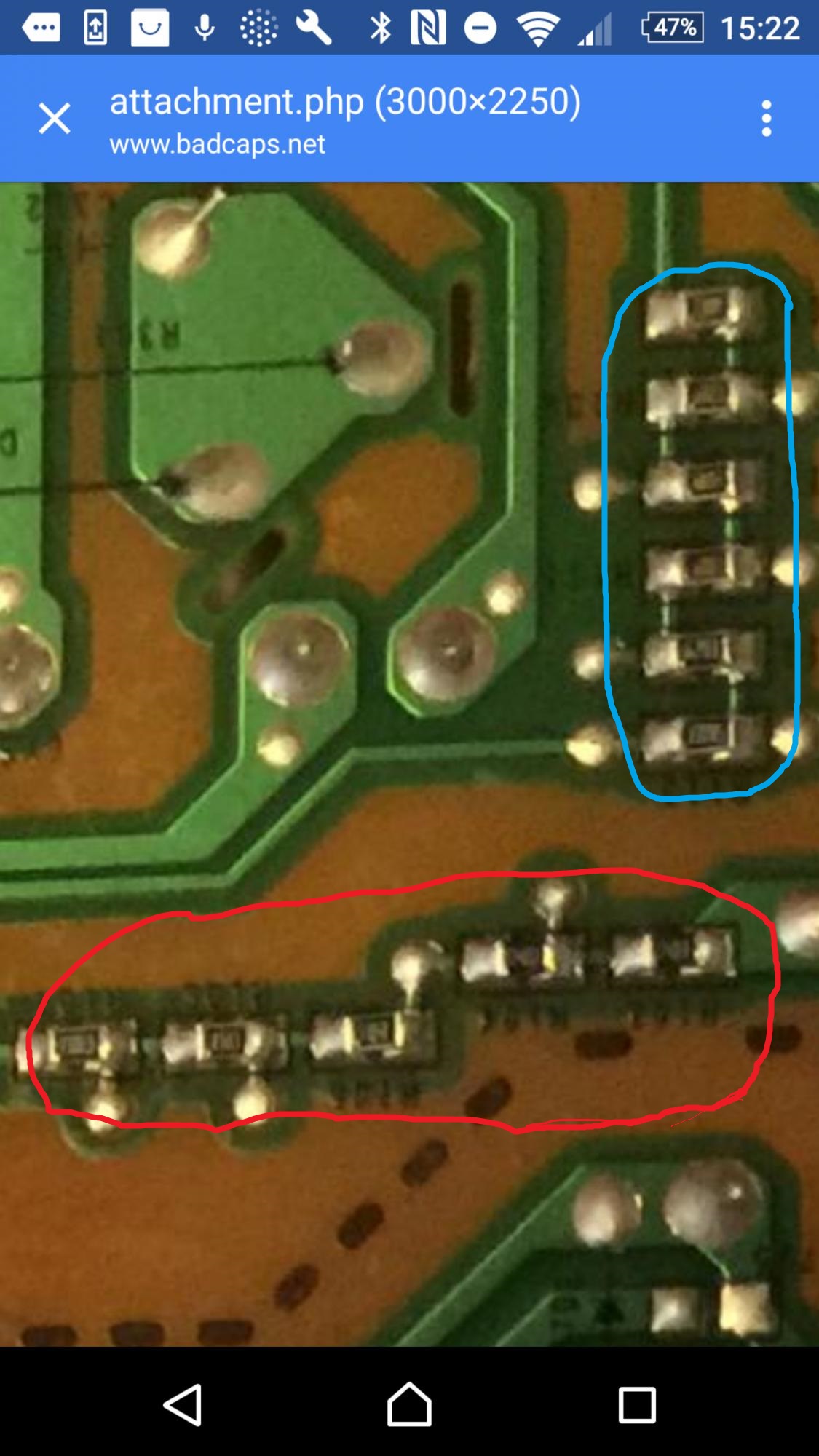

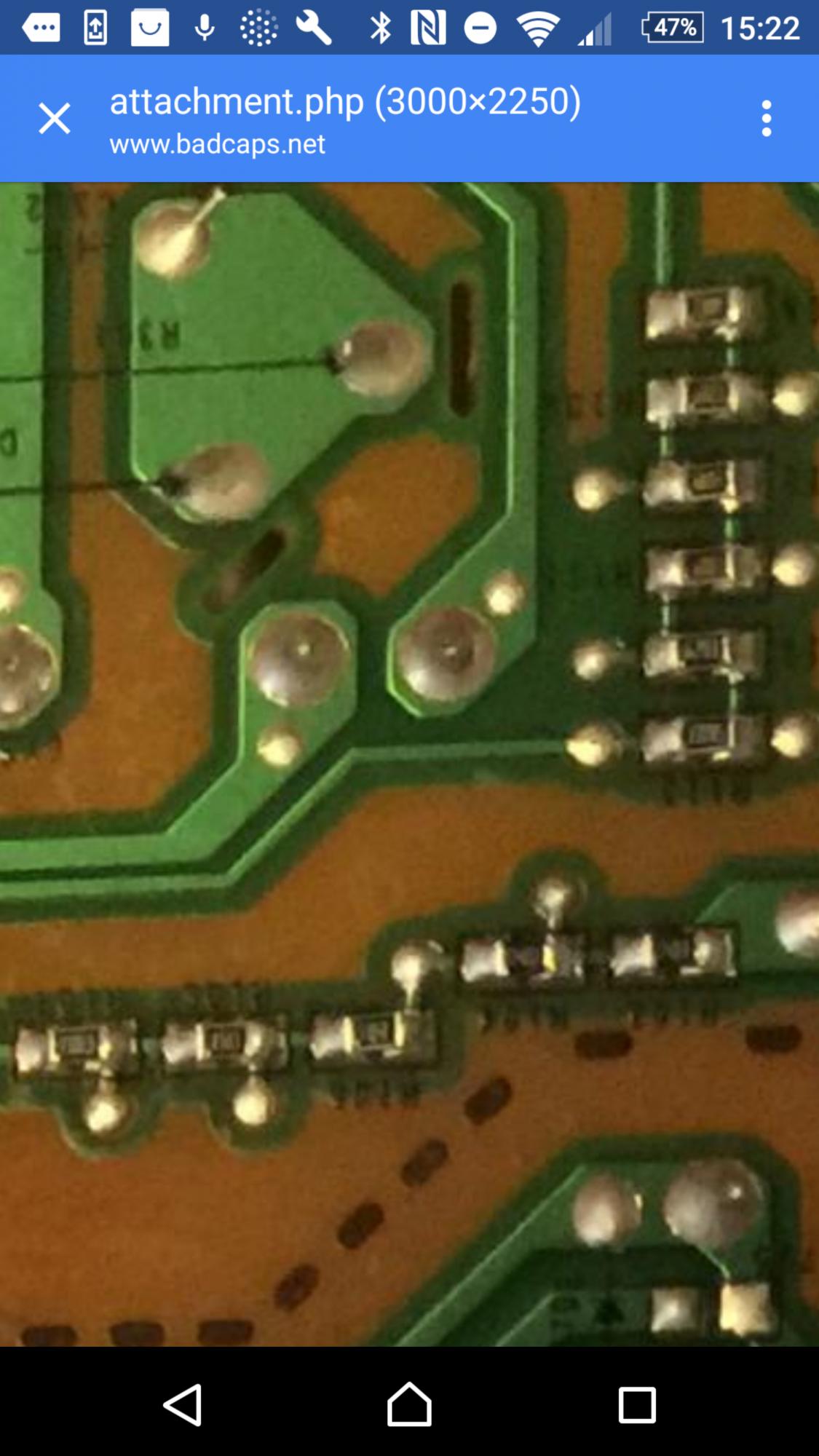

        Test these resistors here:
        The ones that are not in parallel can be tested with your meter without removing them from the board.

          Wasn't positive the resistors you were referencing in the screenshot of my pic. I tested the 2 pins pointing to in the pic below, stable at .5
          Your mention of those that aren't in parallel don't need to be removed from board to be tested...does that mean that the 3 I tested (in the upper right of the board) should be removed to test correctly? I did not remove them when I tested at 10.4 each.
            No I'm talking about the smd resistors.
            the wirewound 10ohm resistors are fine.

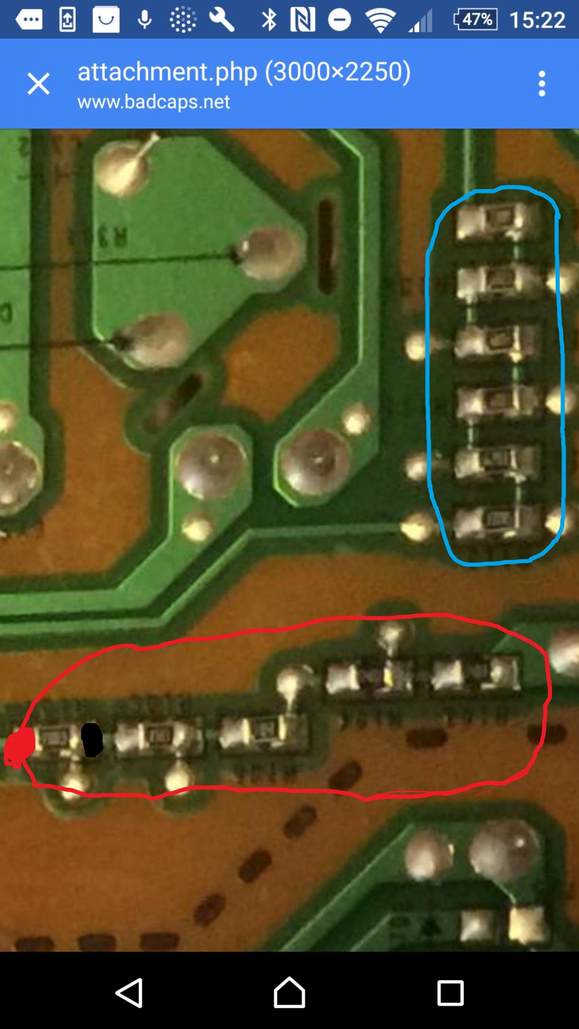

                ok so i have no idea what you're doing
                see pic, blue circle resistors are in parallel, red circle resistors are in series.

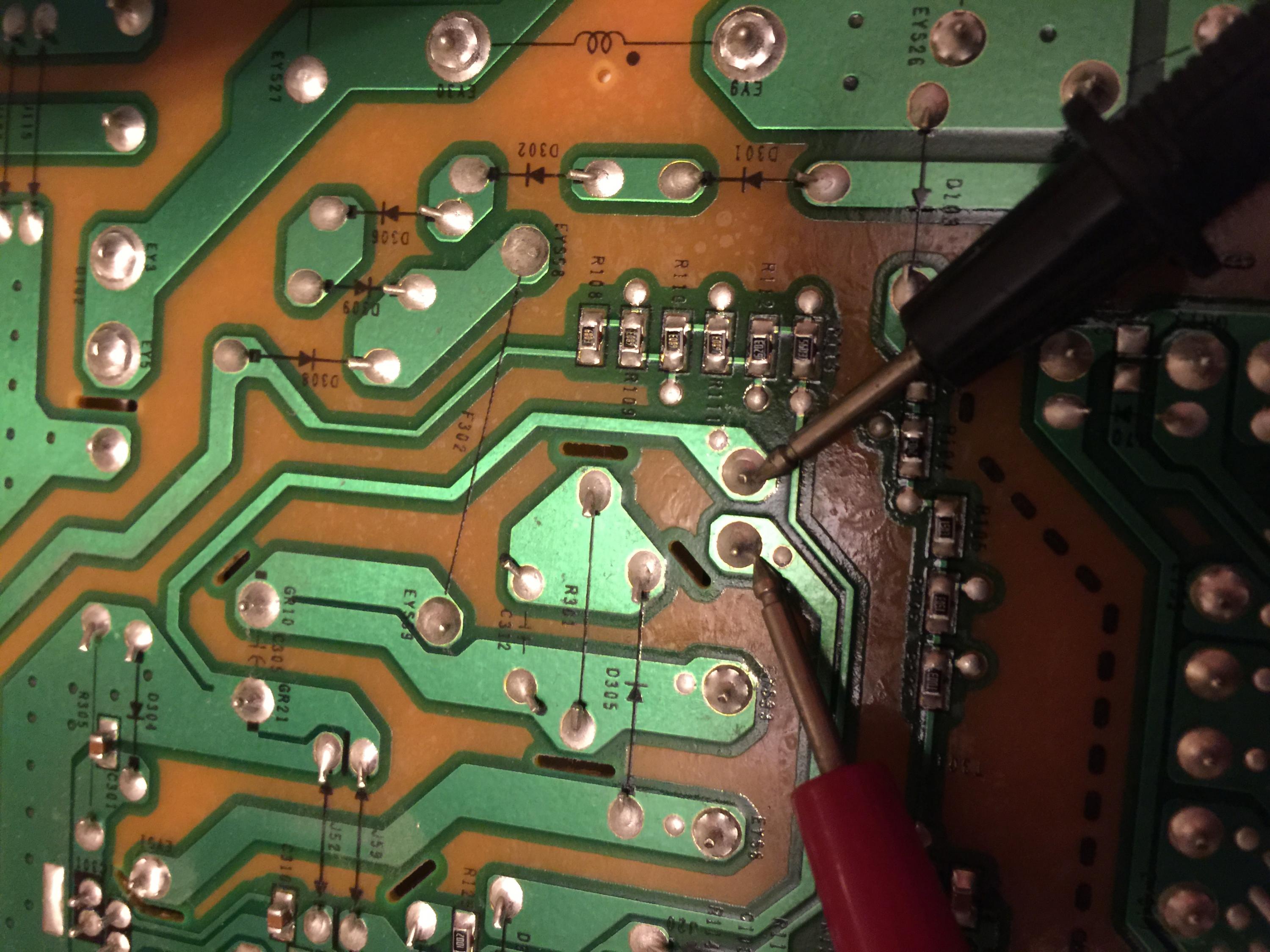

                • Hamie
                  • Apr 2014
                  • 1383
                  ok now put meter in ohm, and check this resistor. put black probe where ive put the black dot and red on the other.
                  post results.
                    OK, sorry I misunderstood.
                    I set my meter to 20k and get nothing when testing. I checked all 5 (R103-R107) and get nothing on all of them.
                      They are all over 100k
                      • jason424
                        • Dec 2015
                        • 187
                        R107: 96.8
                        R106: 140.6
                        R105: 140.5
                        R104: 199.3 then changed to nothing
                        R103: 199.0 then changed to nothing

                          Resolder the lot- A very common problem..the solder cracks-not visible to the eye.

                              Just those five, If you look closely there's another chain of five nearby,resolder that chain too !

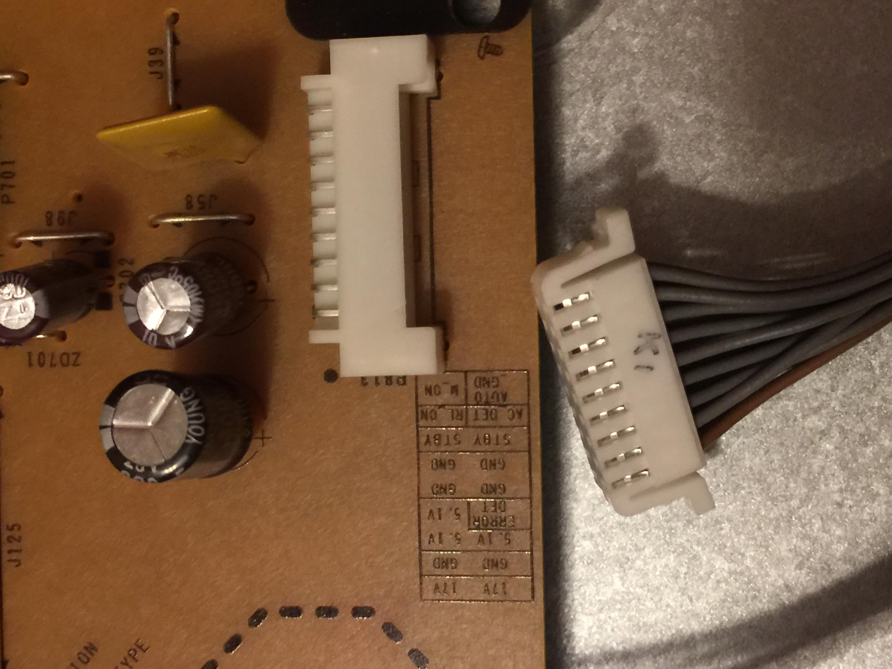

                                  Can you jump the power supply on without the mainboard.
                                  RL-ON jumped to any 5v
                                        I don't get anything when I run a jumper wire from RL ON to one of the 5.1V.
