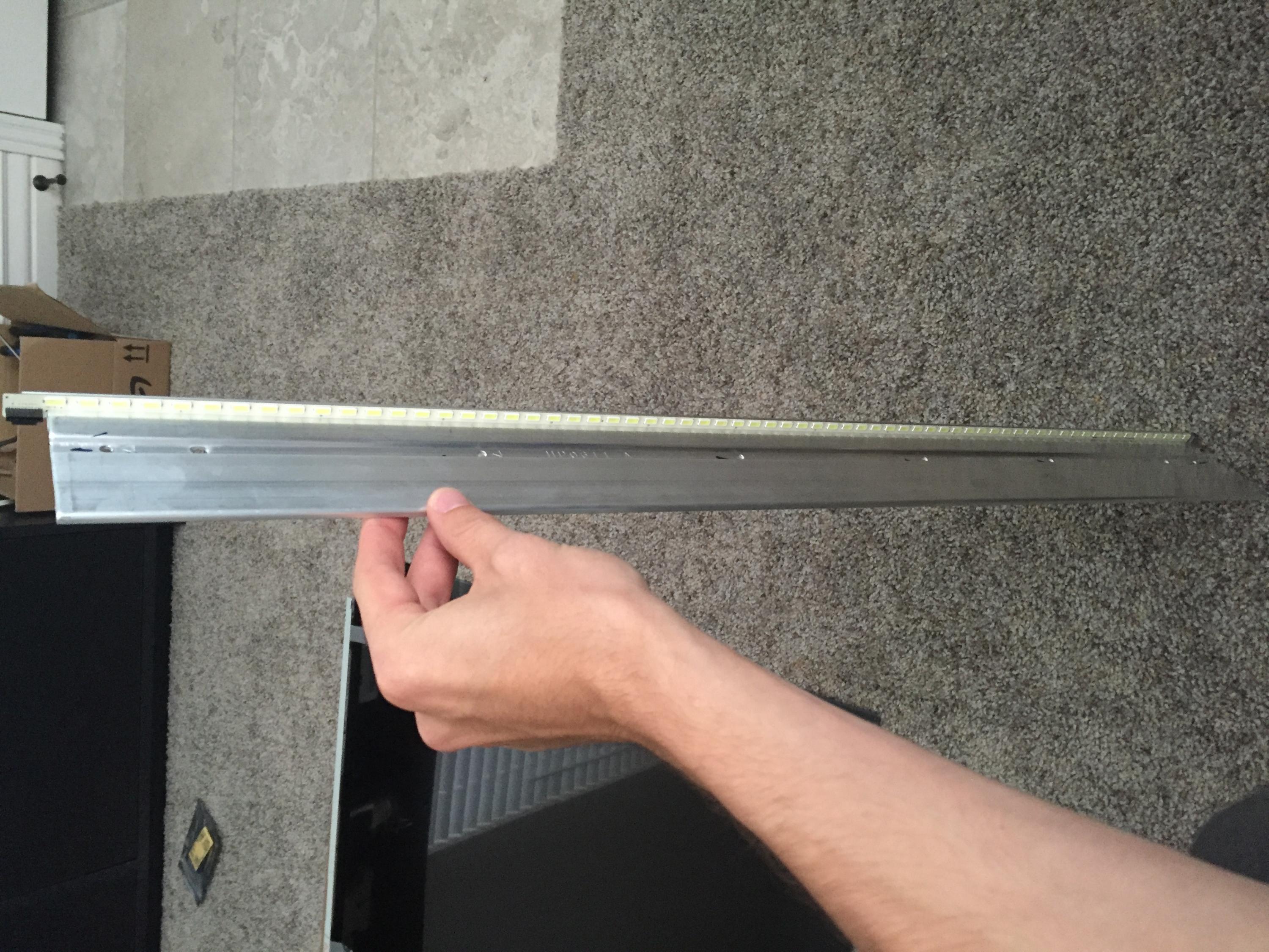

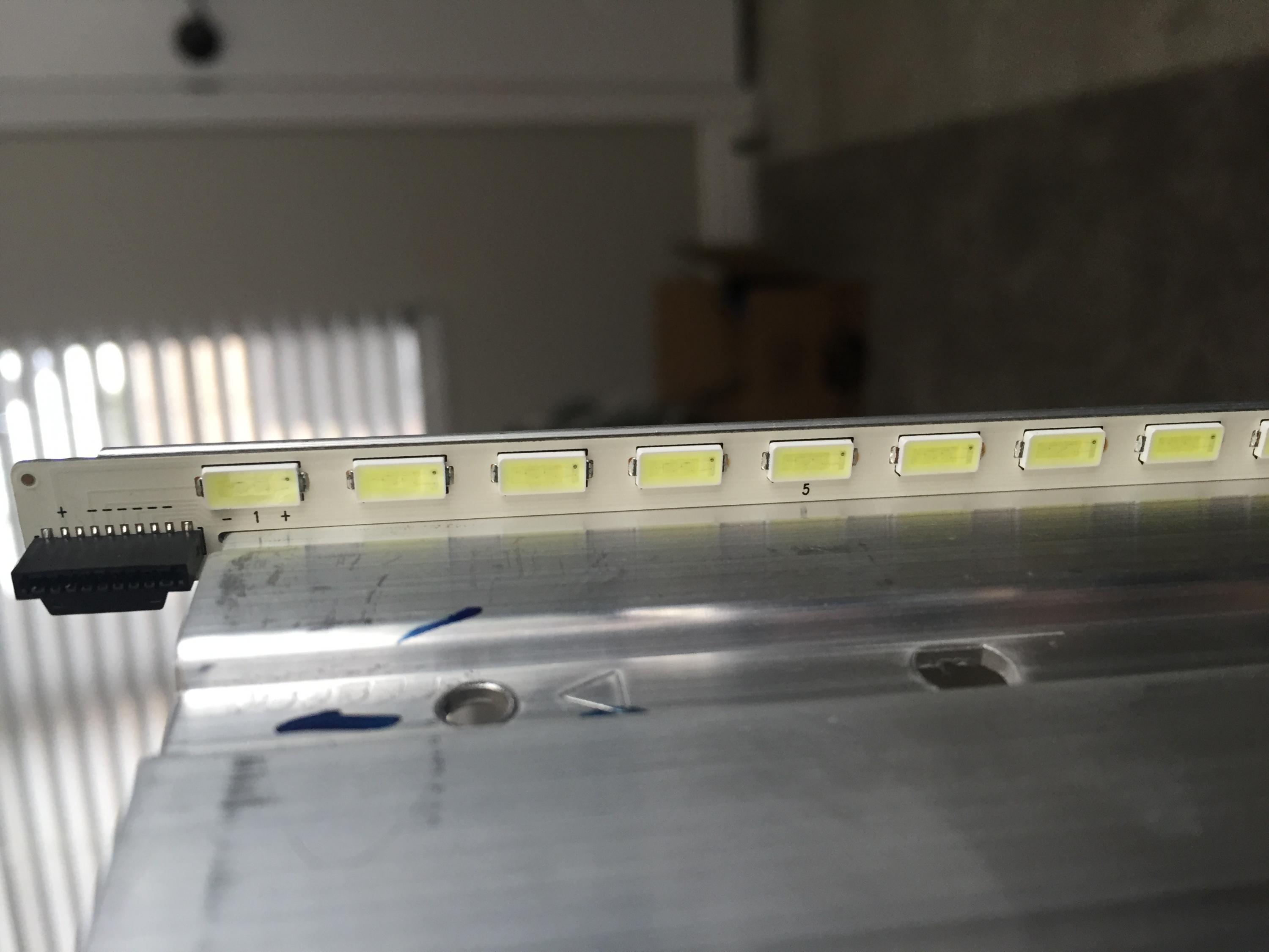

    Here are some pictures for reference of the LED strip. Thanks.

                  now . need to turn off the TV and make each led as diode check it.
                  also need to messure the led long and wide. i think they are 7030 . mean 7 mm x 3 mm . 6.3 volts forward . check after you are knowing those. write here to drive you where to buy 100 pieces for less than 7 USD

                    Re: LG 55LS4500 Dim Bars Across Screen
                    Okay, so I turn off the power and then put my multimeter on diode mode? I checked the first 11 LEDs and they showed around .68 with the leads reversed.
                    Interestingly enough while I had one end of the multimeter on one of the LEDs that was out, I touched the metal of the tv and the LEDs came back on.. Does this mean that the LEDs are okay, and there is just a ground connection that gets too weak when it gets hot?

                                #35
                                Those readings are the Vf of the protection diode, you need to reverse your meter probes and test them again.

                                    #37
                                    They are dual-LED (6V, LEDs connected in series) then your meter may not be able to test them.
