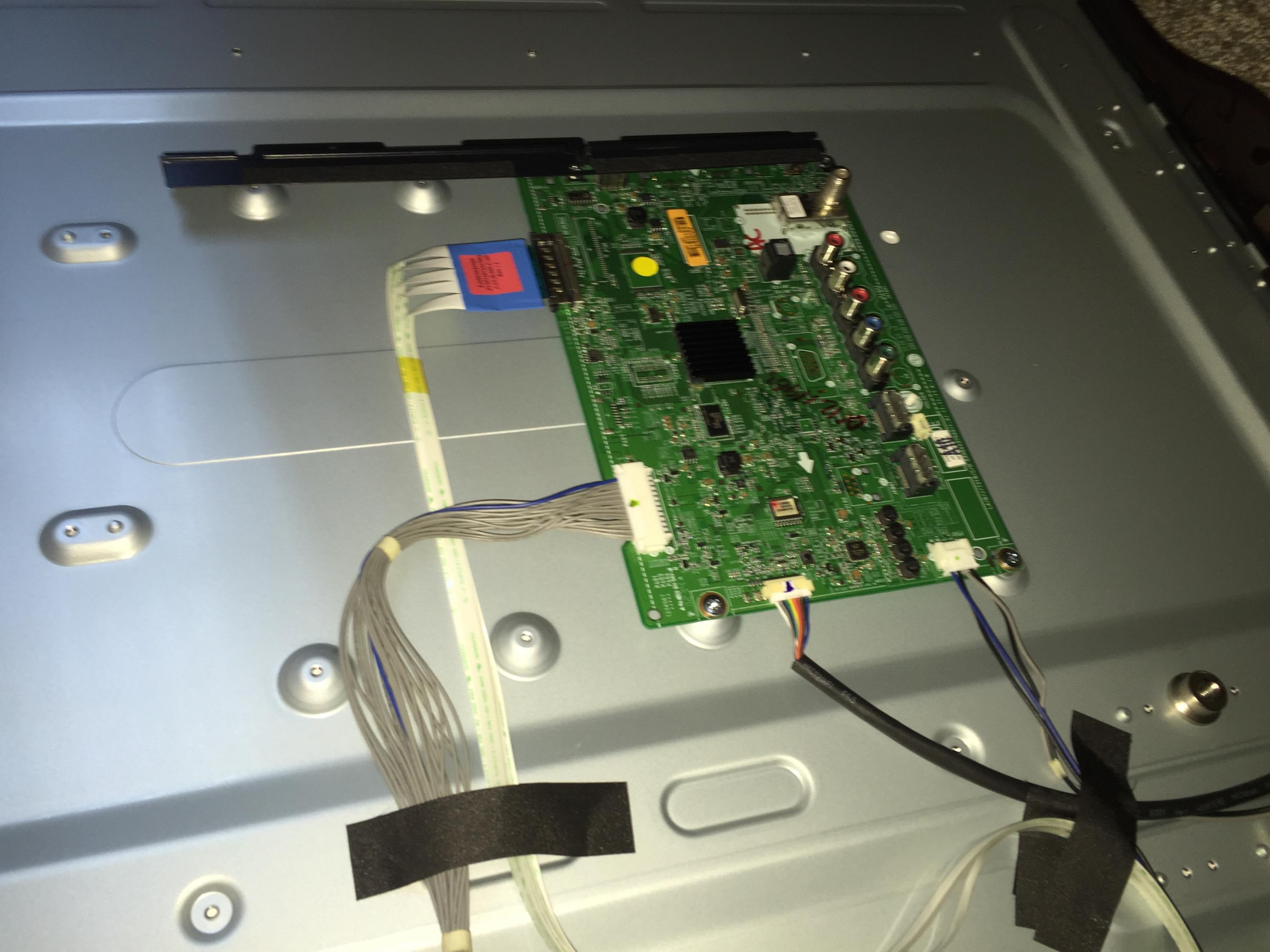

    first of all....take the screen in part and turn on with out screen you can see if there any fault at led.... if there no fault then back here.

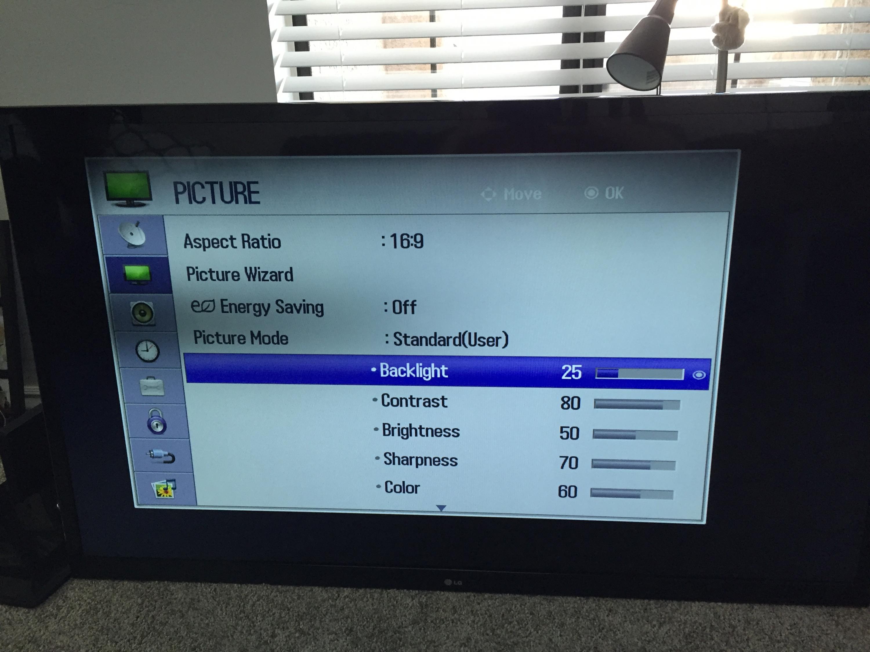

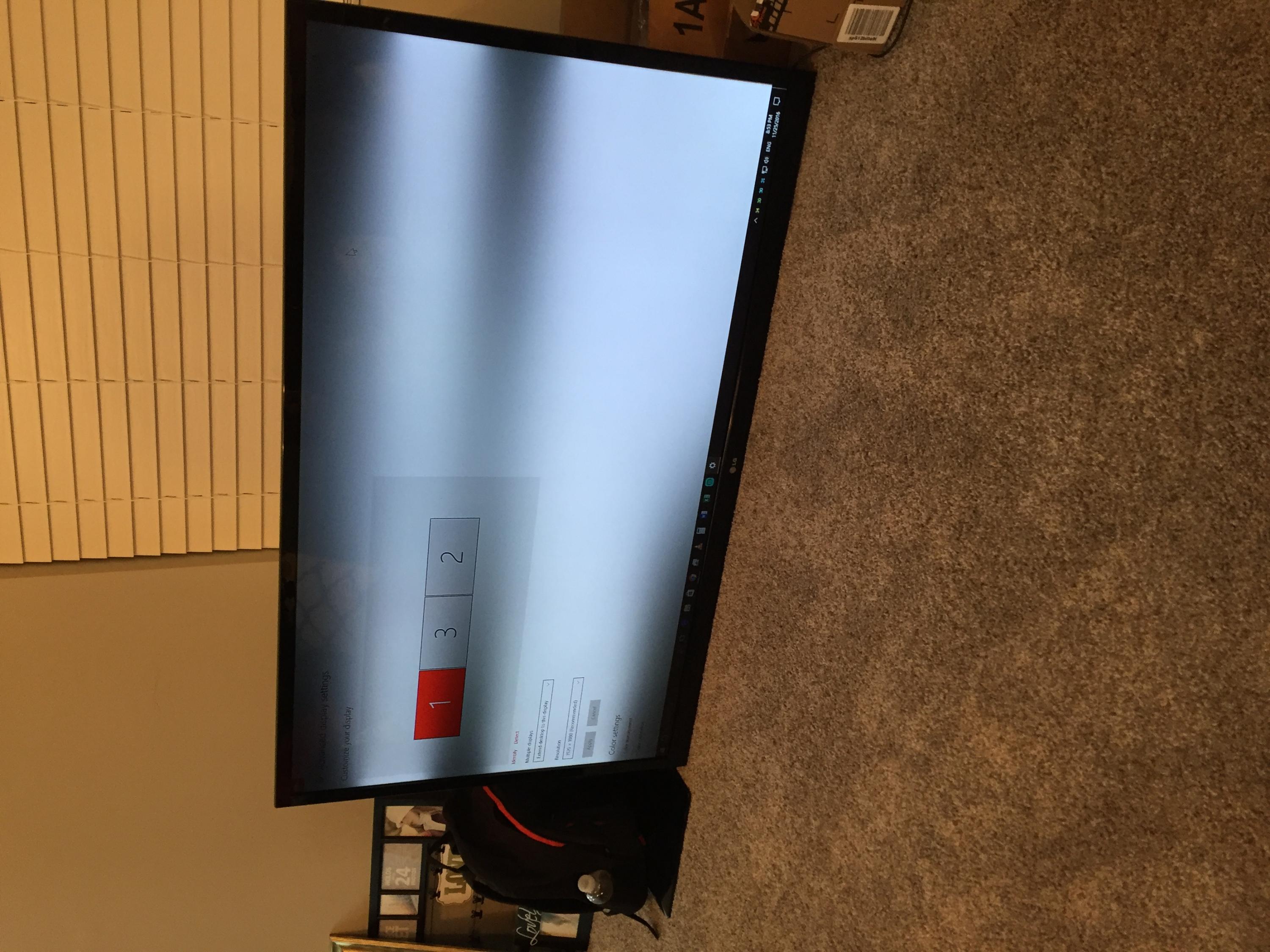

                          Re: LG 55LS4500 Dim Bars Across Screen
                          Hey budm, thanks for the insight. I currently have the backlights (not brightness) down to 25%. The same thing still happens.
                          You think it's the LEDs themselves and not something on the PS board? When I turn the TV on just now, only the top right corner LED has dimmed. Then after a couple minutes, the top left corner dimmed which produced the dim bar effect, and also a part on the left side dimmed. I think this is an edge-lit TV, could it be that the top right edge LED or LEDs are shorting and not allowing the correct current to flow through to the other ones if they are in series. But why would it only affect the top half of the screen?
                          Attached another picture of semi-dimmed.

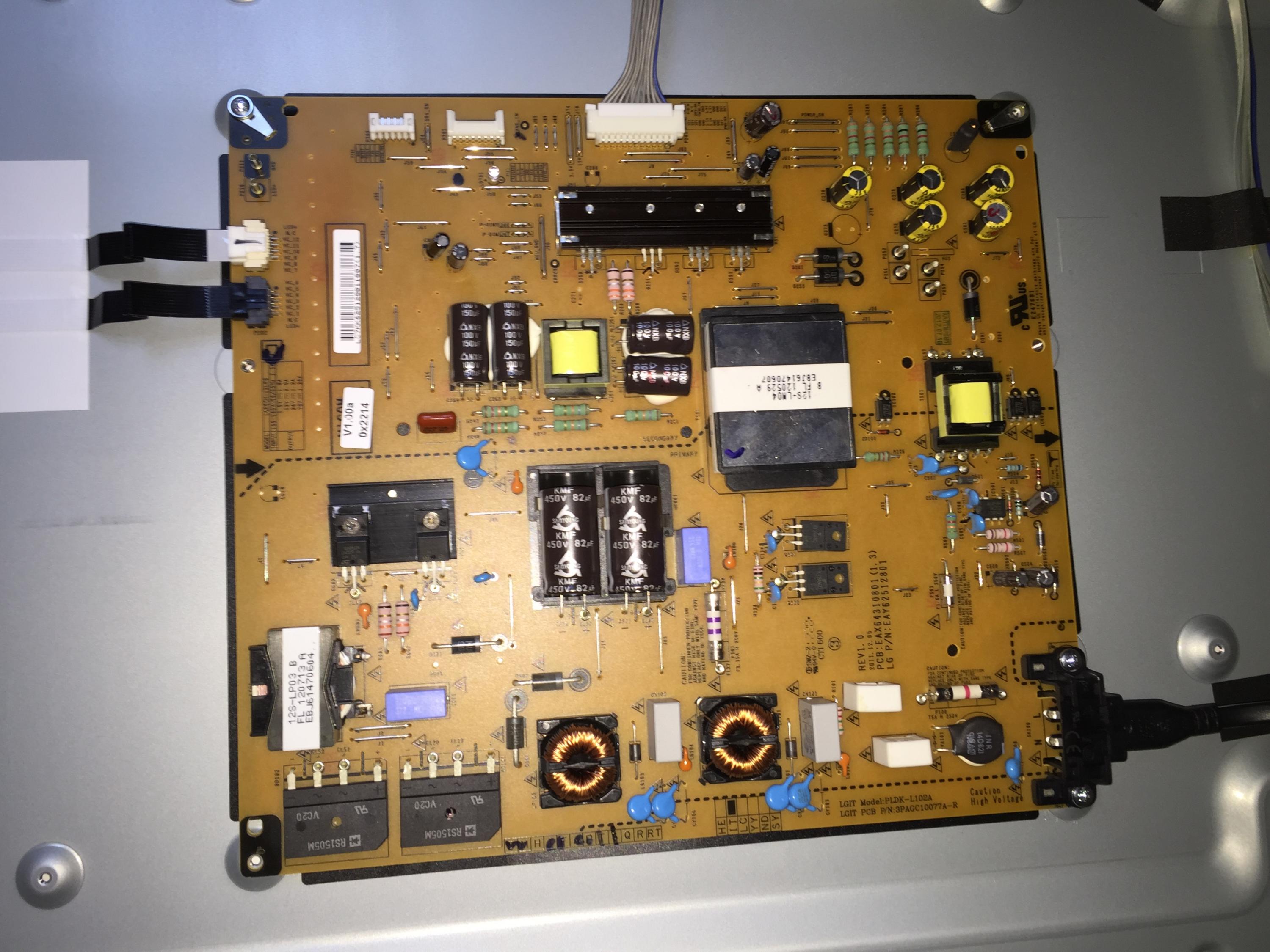

                            why don't post photos on of the power supply and how many cable groups going to main boards... if they are 2 sockets then you have other issue with local dimming.

                              It looks to me that the LEDs on the right are all on at lower level backlights setting because if you look your pictures above form post 1, you have dark shades on left and right side of the screen. You will need to replace the LEDs.
                              Now you only have on the left side.

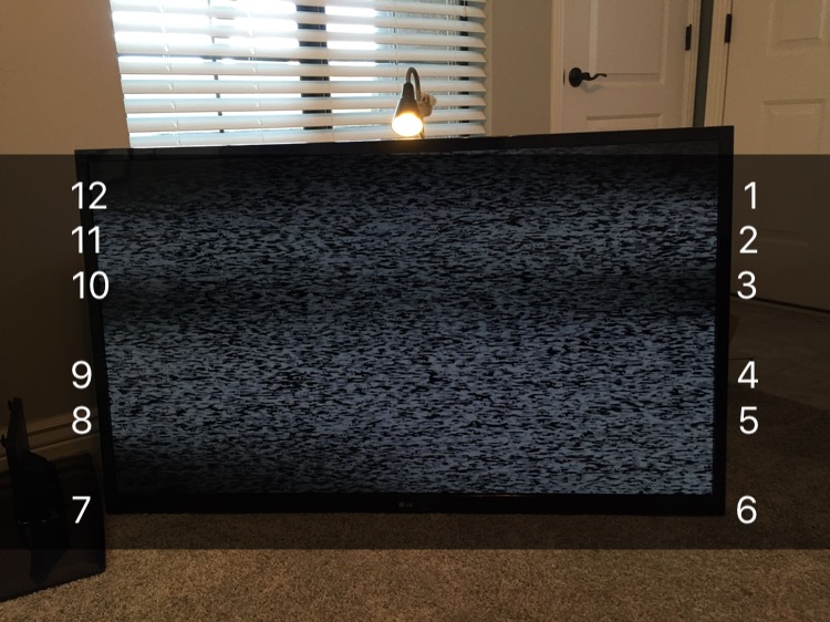

                                  Okay, if I let the TV sit it eventually goes to the top two bars and lower left corner that dim like in the first picture I uploaded. Here are pictures of the PS board and the main board as requested.
                                  Diah I'm not sure how to get into the EZ-Adjust menu, I can get to the installation menu.
                                  I checked the LED voltages again with those parts dimmed.
                                  VC 1, 3, 7, 10, and 12 all have around 25V going to them. Those seem to be the ones where the bars are. See my third picture for that assumption.
                                  So are we set on LED's then? Could it not be something wacky with the LED driver on the PS board (because the PS board has that LD701 light flashing)? I unhooked the LED cables and started up the TV, and it still gives the flashing light (which makes me think LEDs are okay, problem with PS/LED driver board).
                                  I then plugged in the LED cables to the PS board and checked voltages, which all read around 20v consistently (which makes me think no shorts in LEDs otherwise wouldn't see constant voltage?) The LEDs did not light up the backlight after plugging in their cables with the TV on but the screen was still on as I could do the flashlight test and see it. Don't know if this info helps. Thanks for the help so far all!

                                    forget my point to EZ_Adjust and local dimming , your set don't have. so 100% LED fault. take screen in part.

                                      Alright, got busy through the holidays but now I have some time to try and make this tv good. I have it taken apart and I can see the side strips of leds.. where do I go from here? Should I start testing each led individually?

                                        turn on your TV with out the screen.. and you will find which LED dimming or going off after awhile.. give time to them till the fault appear
