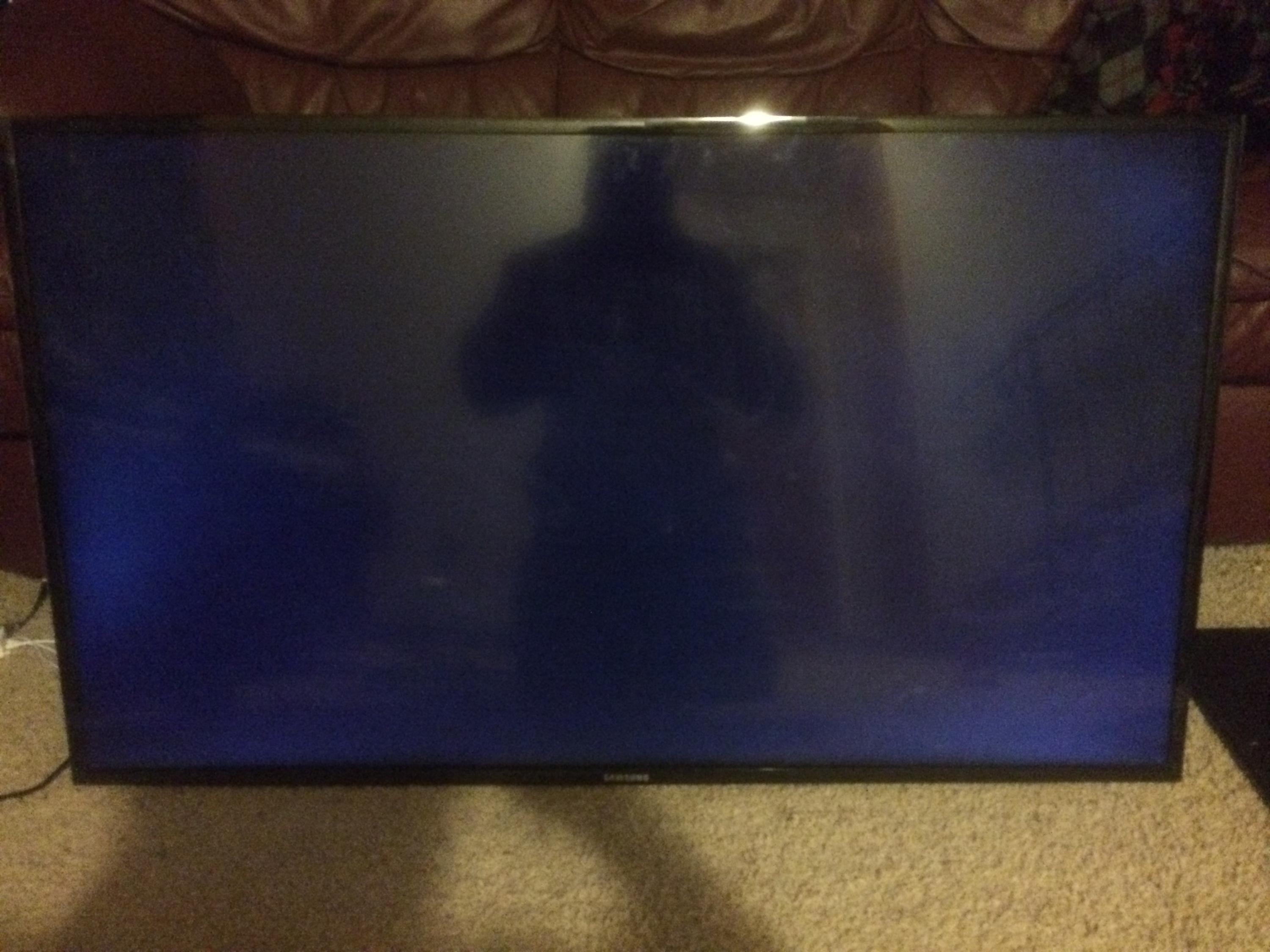

This tv has a good backlight and sound. Has stand by light and will power on and off. My first thouhgt was a bad T-Con, but for the price of the t-con i could pay 30.00 and get all 3 boards. So i replaced all 3 boards new from shop jimmys. Still have the same problem. Is there anyone that can shine some light on how to fix it??
Samsung Un50h5203f Backlight and sound no Picture

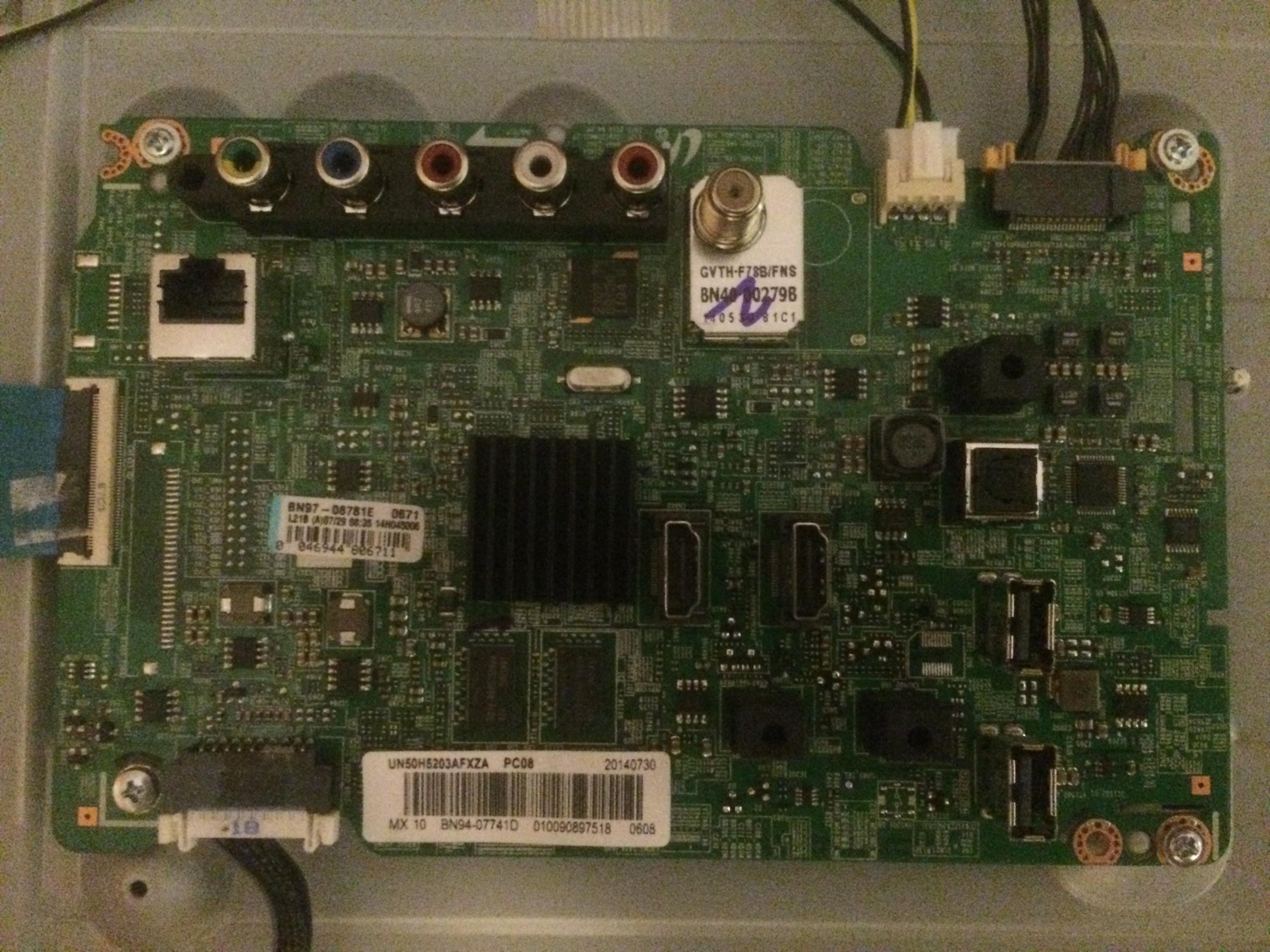

Please post pictures of the TV turned on and pictures of the boards in the back. -

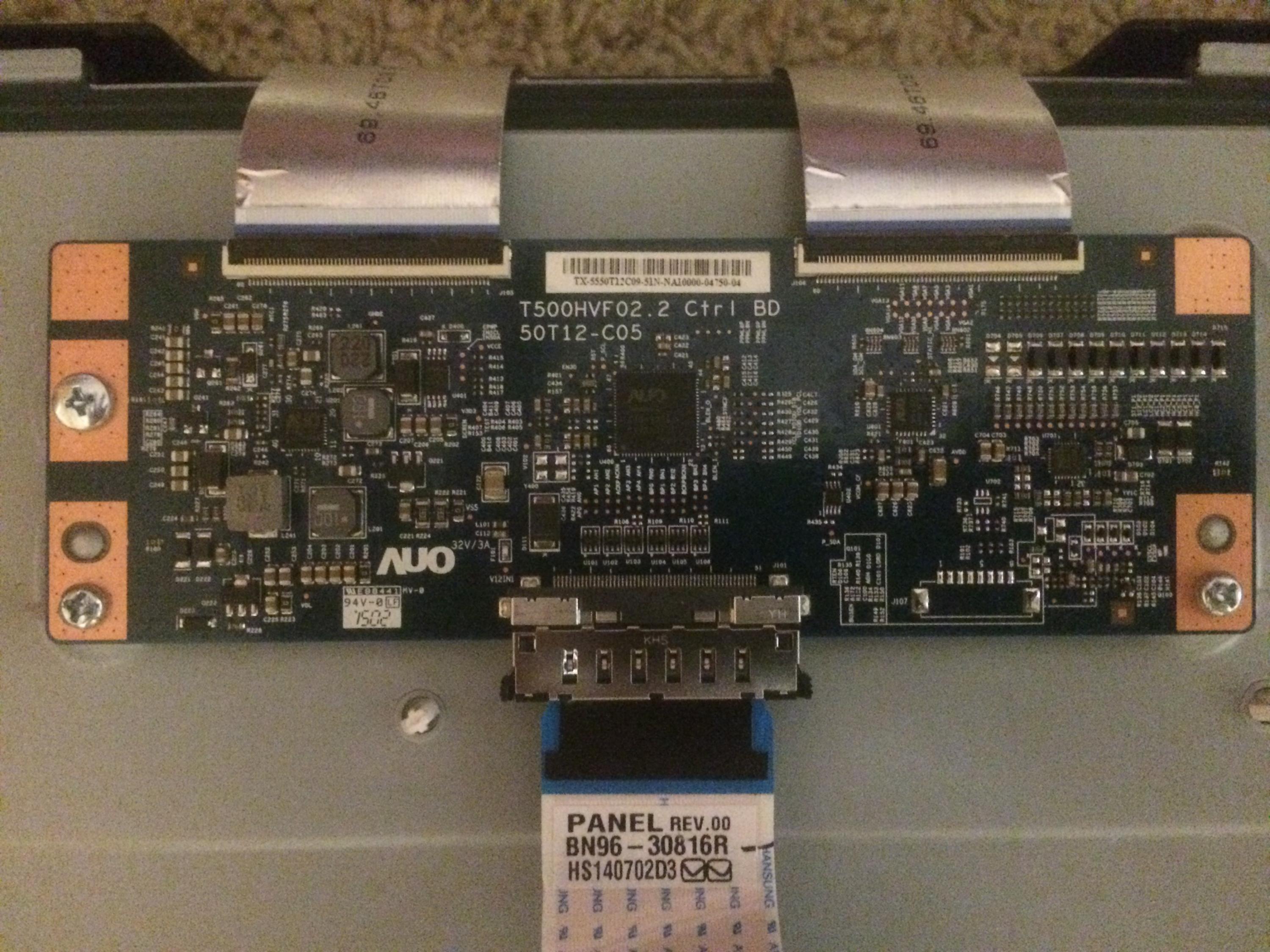

So are you getting 12vdc at both ends of the SMD fuse with ref. to the chassis Gnd on the TCon when TV is turned on?Never stop learning
http://www.badcaps.net/forum/showthread.php?t=24809Comment
Re: Samsung Un50h5203f Backlight and sound no Picture
Check BOTH sides of that fuse to see if you have 12 volt like Hamie and Budm asked.
If you do,disconnect one ribbon from the t-con and try,then reconnect and disconnect the other one,see if you get halve a pic.Proud owner of dozens of broken TV's and many,many,many boards.
Our website and passion:http://hollenhundshepherds.com/Comment
yes both sides. ok ill try the ribbon cableComment
Ok i get half a picture when i just dissconnect the right tcon ribbon cable. and when i just dissconnect the Left ribbon cable i get half black screen that ghost to whiteLast edited by realdealthill; 11-27-2016, 03:23 PM.Comment
any suggestions?Last edited by realdealthill; 11-27-2016, 03:23 PM.Comment
UPDATE: Fixxed.. I put electrical tape over the exposed metal under the buffer board.. AND BAMMM! she fired rite up!! Thanks to everyone for their advice!!Comment
