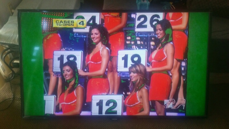

    I've got a neighbor's tv here at my house that had a jog wheel/power button that wasn't working. Opened it up to find the ribbon cable hanging on by a thread. There were only two wires still intact. I removed the cable and repaired it but unfortunately the cable is shorter now. It works but the cable needs to be longer. Well i tested it before returning the tv to the neighbor and all was good. The tv turned on but i noticed the picture had a greenish tint to it. She sent me a picture and would like to get some suggestions as to the cause. Thanks in advance

    Lose Lvds cable possibly or lose ground screw.

      I will check for a proper ground. If that doesn't do the trick I'll be ordering a new lvds cable. Thanks for the quick response.
