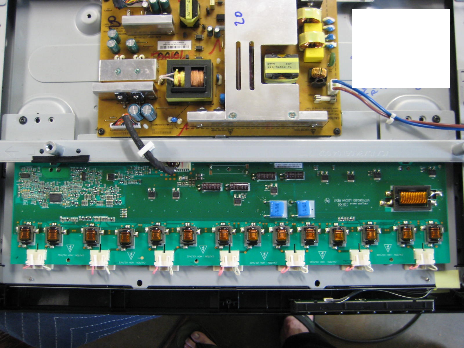

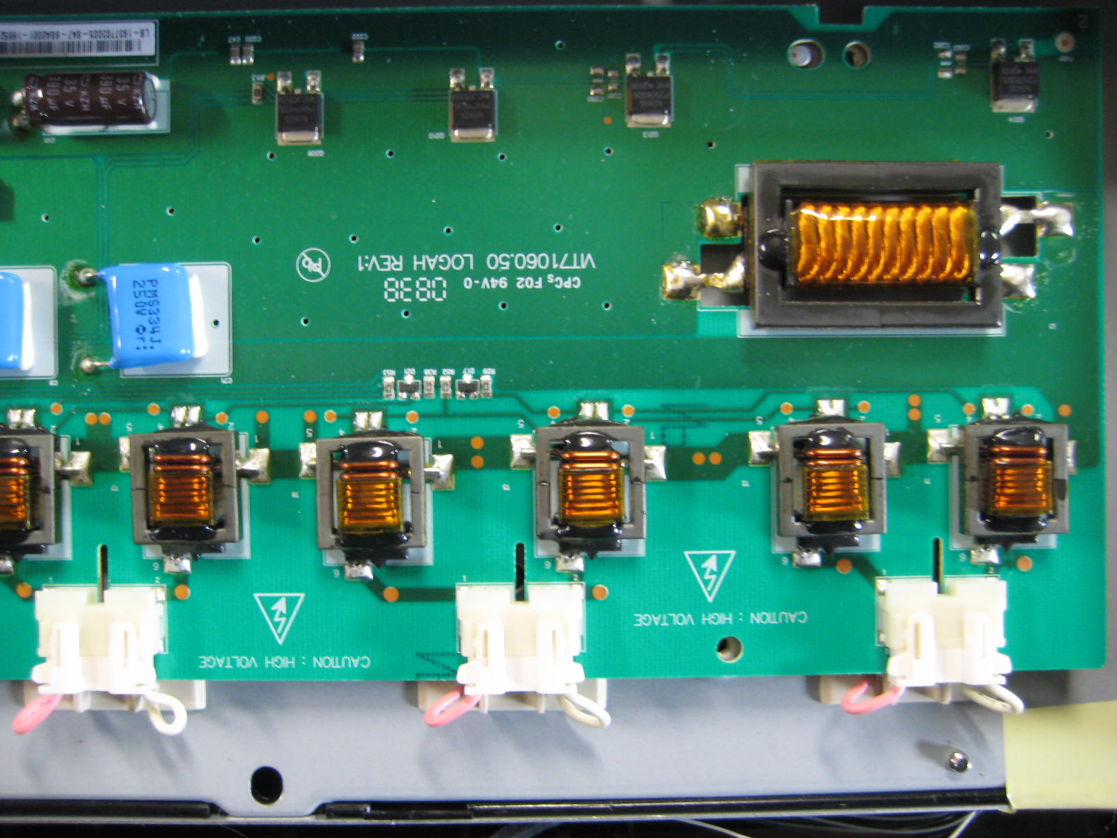

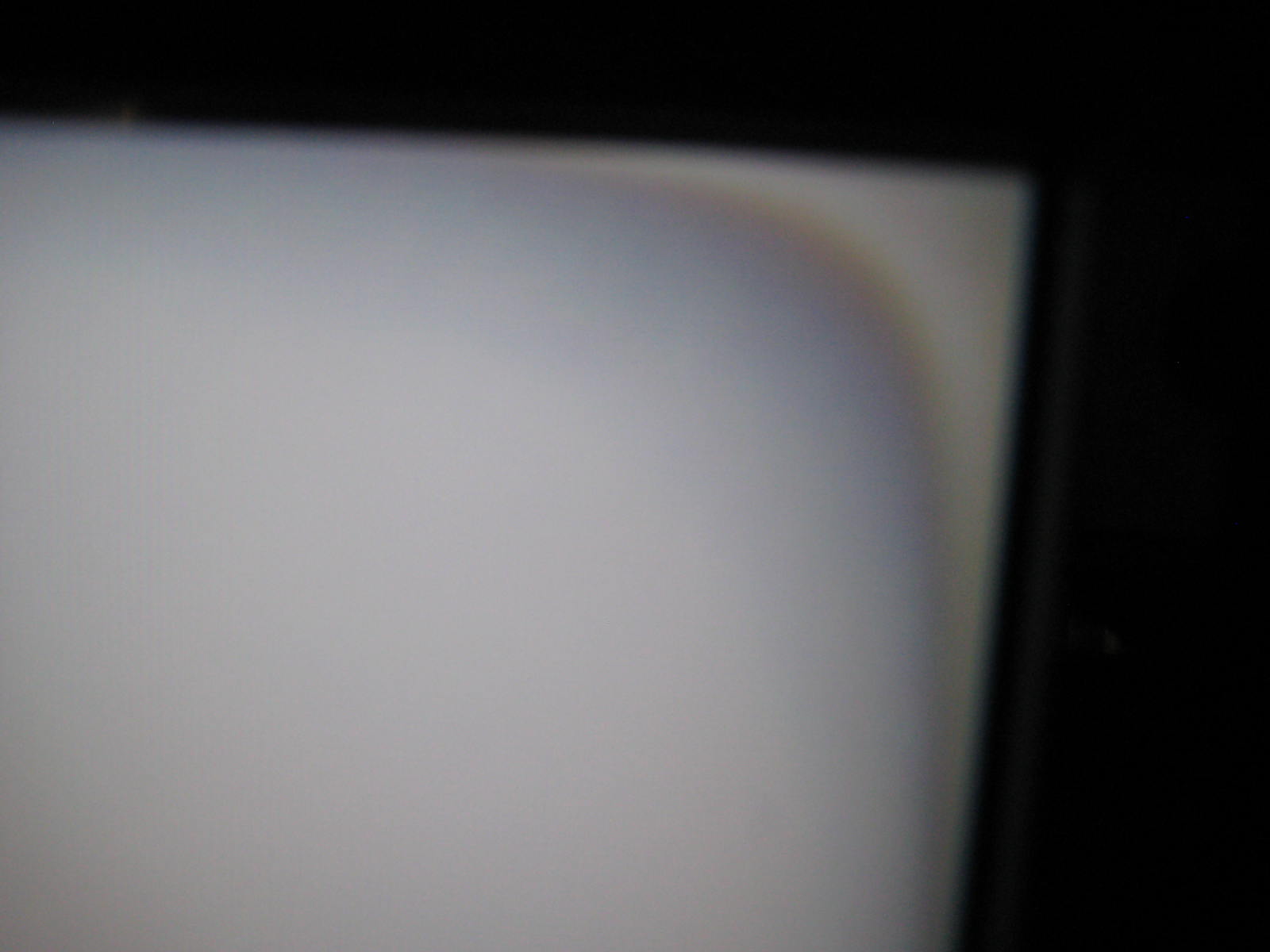

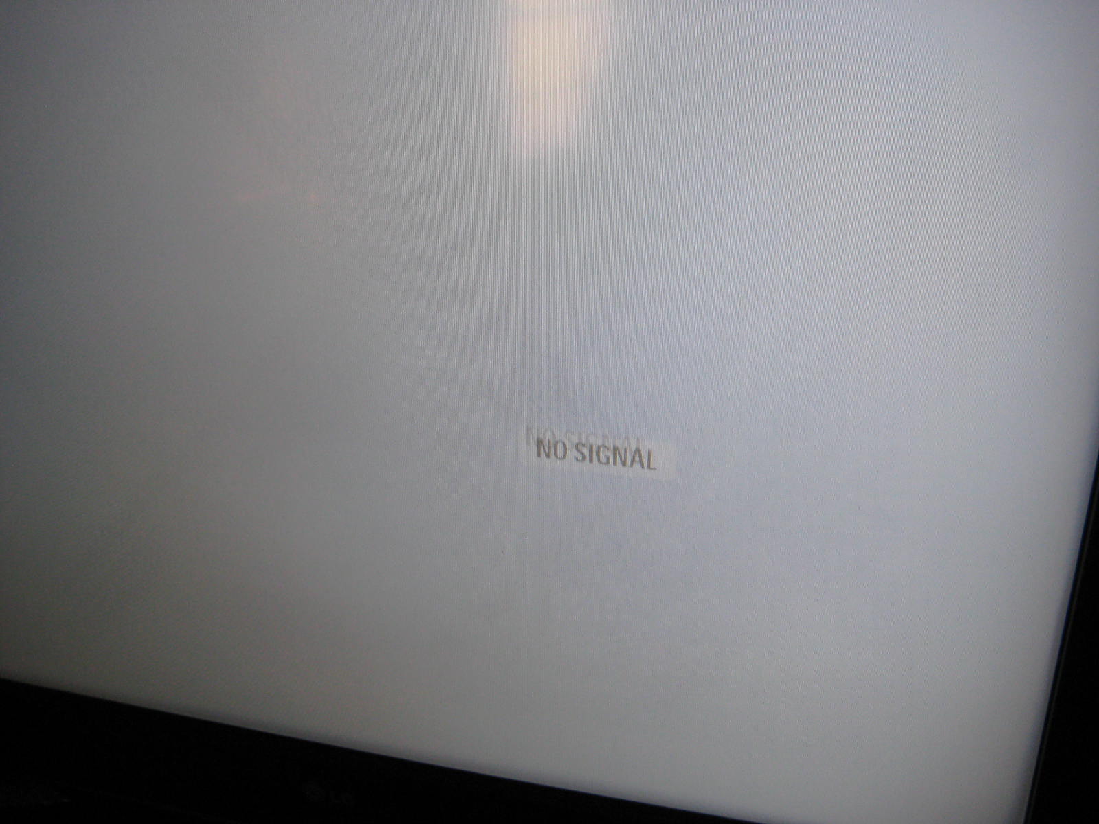

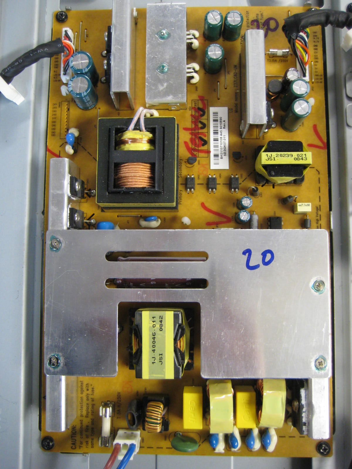

    I have a friend's LG3710-UM Prod date Dec 2008 to look at.
    When turned on the screen is light grey with a sort of ghosting effect when the "no signal" icon dances around the screen. All four corners of the panel have pulled in a bit showing radiused corners. Close look at the middle area shows markings in the grey color that look like "bicycle treads" running at angles.
    When signal to fed through it looks as though it is in black and white though more greyscale and weak at that.
    Cursory look at boards reveals Taicon on power supply and all look good. There is a notable buzz from the inverter board.
    Just wondering where to look for issues. I did have a spare power board which I recapped with Panasonic FC and/or FM with no change.

    Re: LG 37LG10-UM has grey screen color and ghosting

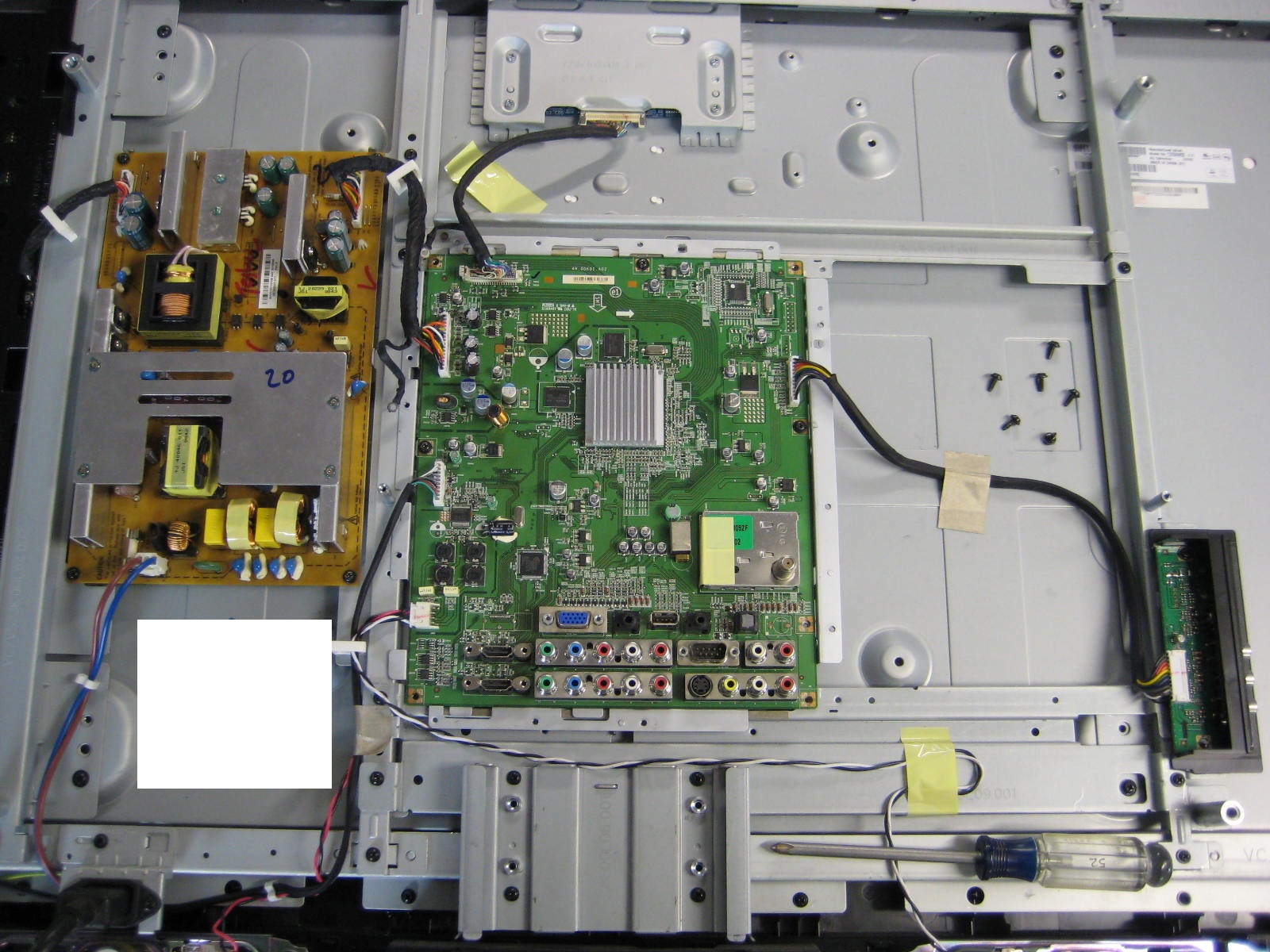

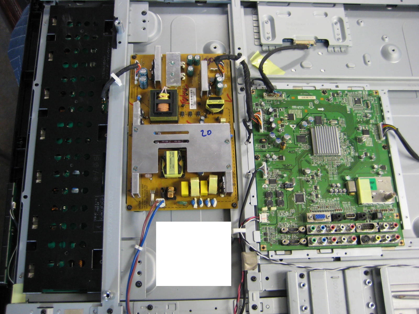

    Posting pictures of the back of your tv showing the boards with clear pictures may help you more with fixing your problem
      Thanks. It's not my first rodeo here. I've been busy with other projects to take the pictures. They'll be up later today. Didn't really expect a response.
      • axlmastr
        • Aug 2005
        • 158

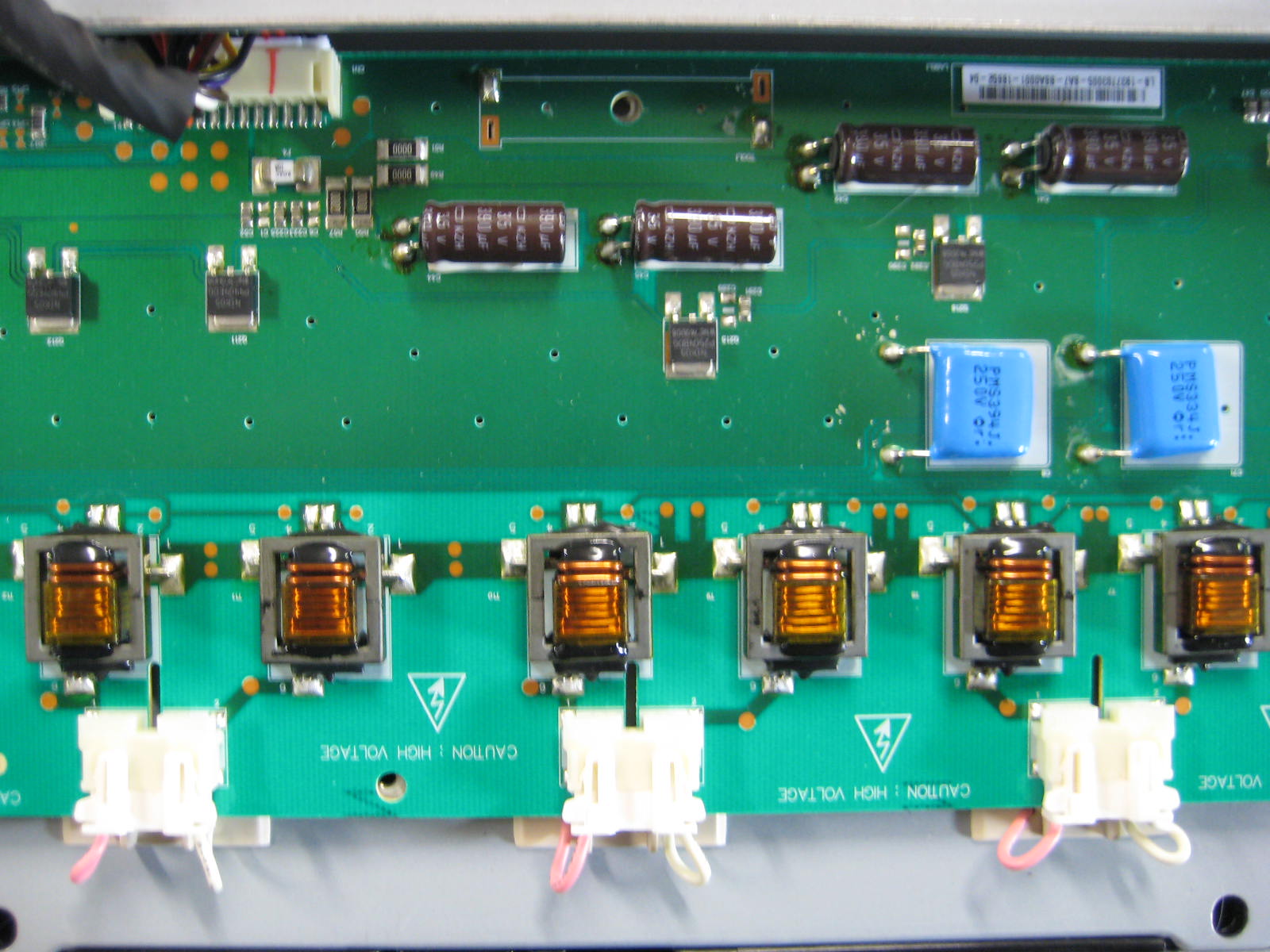

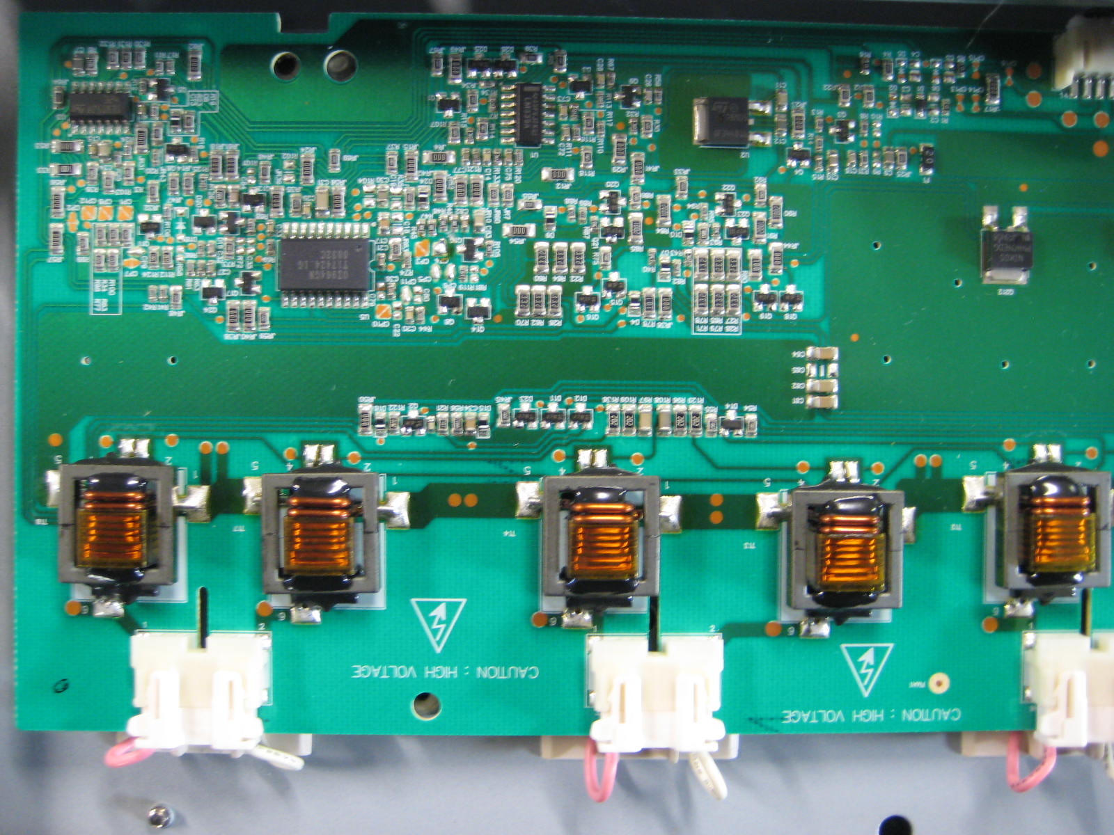

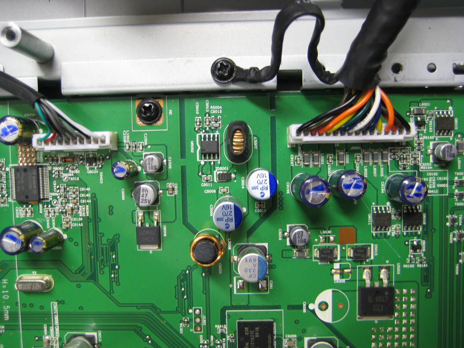

        Pics posted
          I would think backlight issue...one or two of the CCFL may be weak....or the Inverter circuitry has a fault transformer/coil...or component.

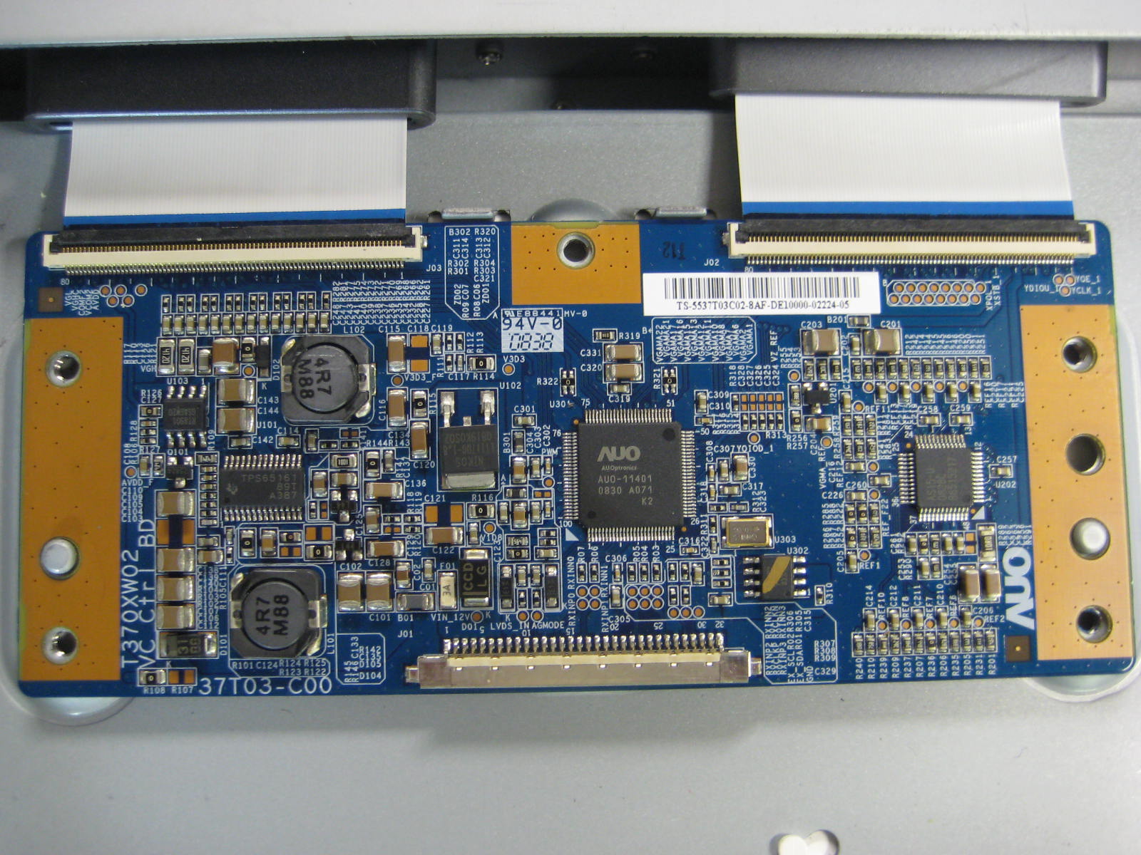

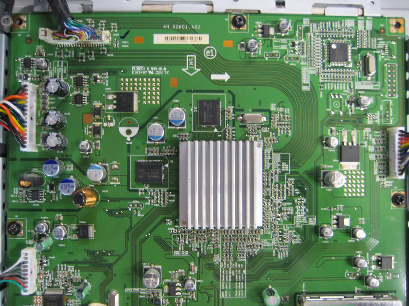

            Thanks for the reply, but if it were backlight then the screen would be dark and the image would need to be seen with a flashlight. The image is quite bright so backlight is not an issue. Though I mentioned some buzzing from the inverter board is is working since it is firing the bulbs.

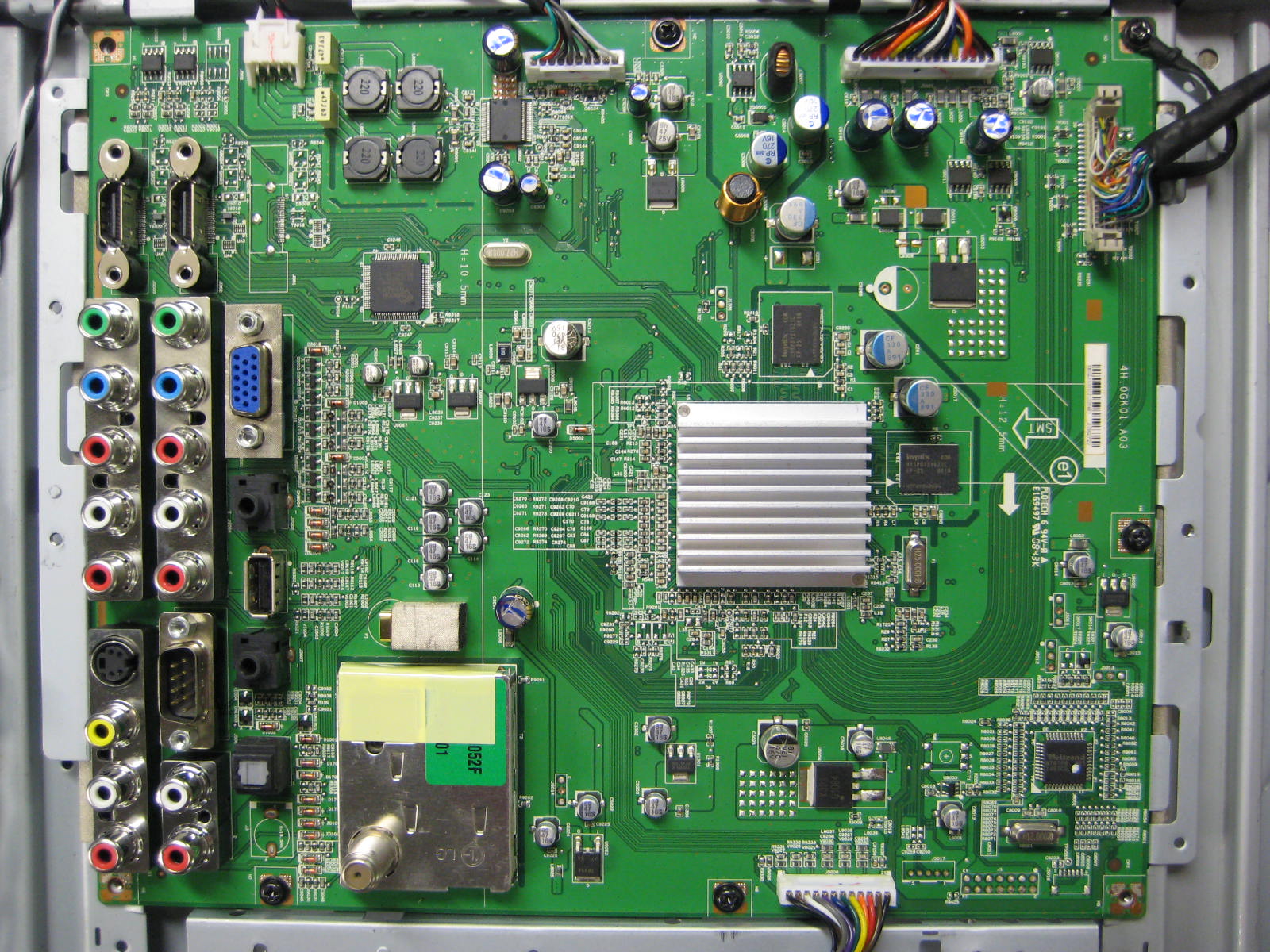

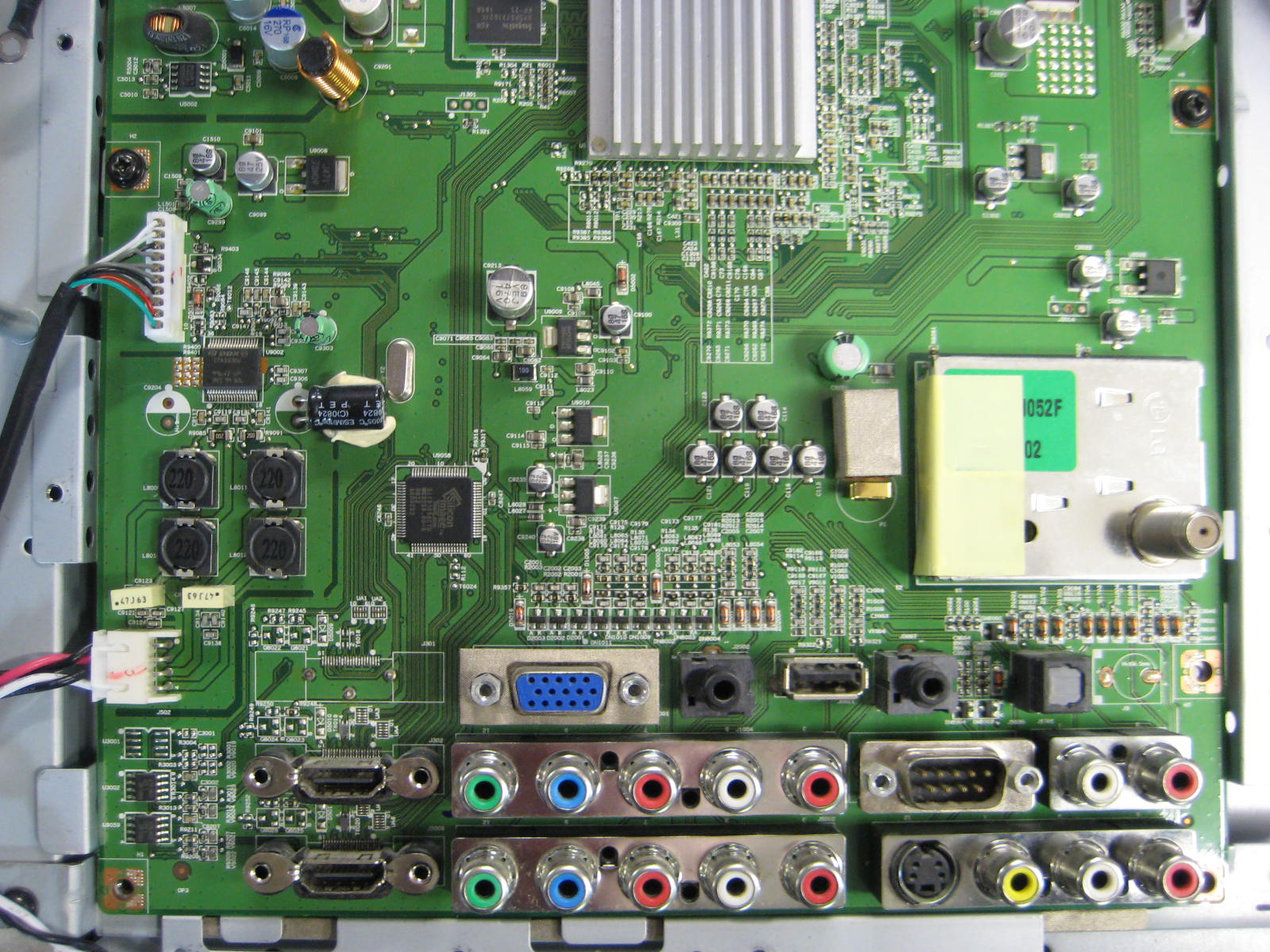

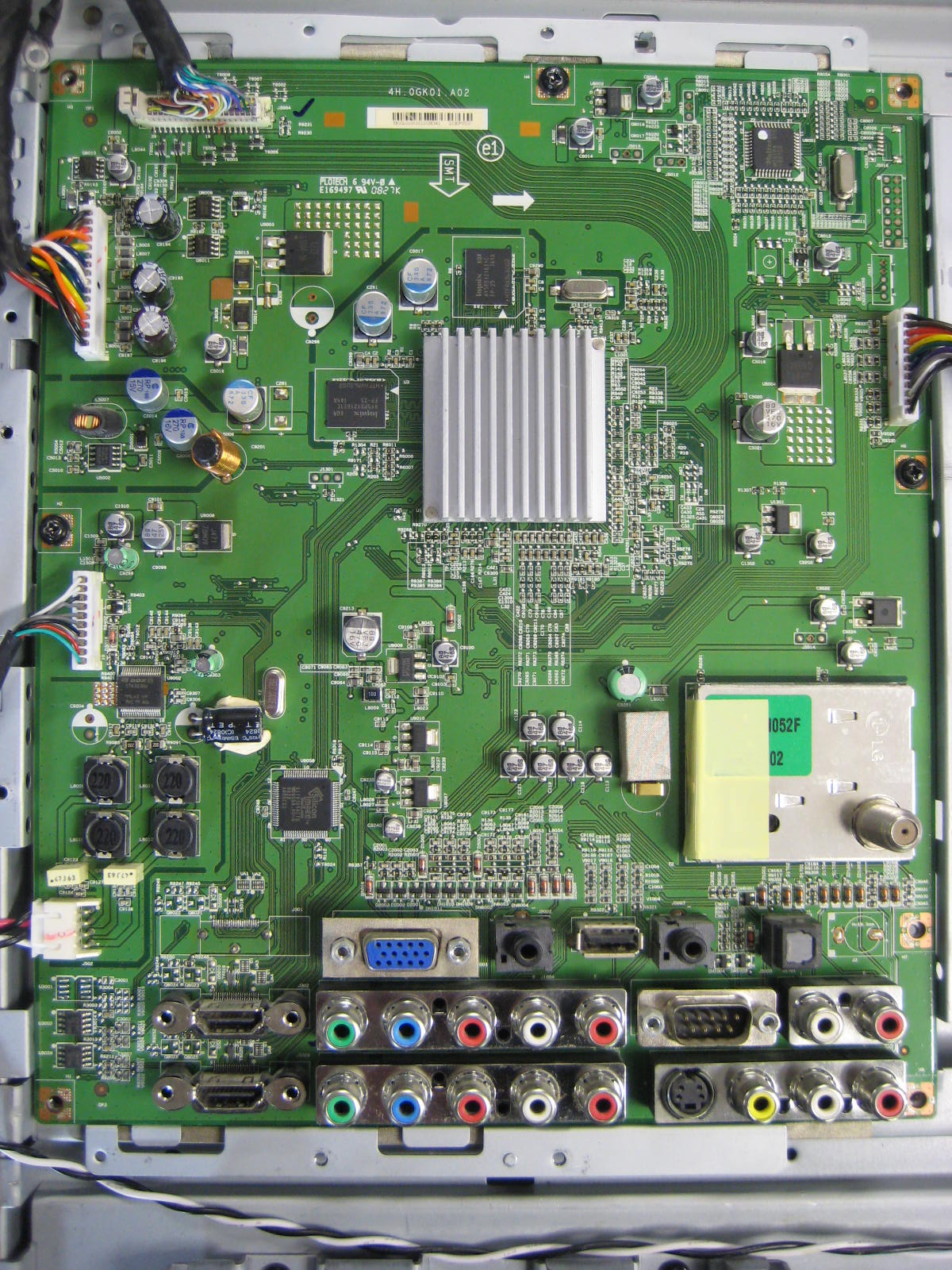

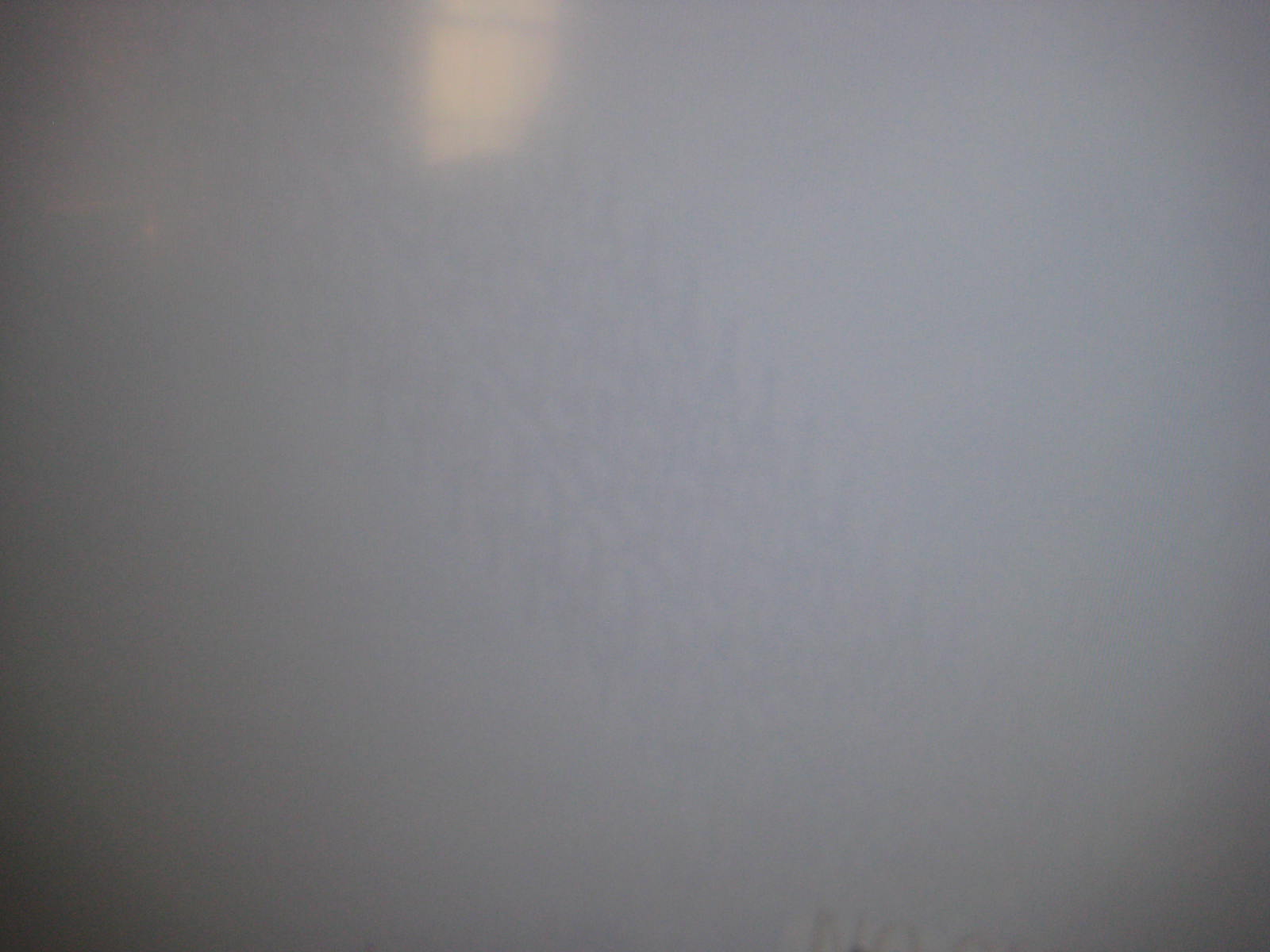

            The issue is lack of color from the panel (very monochrome) and the ghosting effect is an additional issue. That I would say is more of a logic/main board or bad LVDS cable or connection. I have two other logic/main boards to sub in.
            Attached are some pics of a recapped logic/main board I have and the reverse side of that board as well as what the display looks like with a signal through it.
              I'd suspect the AS15 chip on the tcon, measuring the gamma voltages would confirm this.
                +1 check the GAMMA ref. dc Voltages to start with.
                  Okay I'm game. How would I measure the gamma voltages?
                    It looks to be the two rows of copper pads at the top just to the right of the sticker.
                      These two rows are marked XPOL_1 & XSTB_1. The top row has a "B" before it.
                      Here's the voltages:
                      Top Row L-R: 15.56; 15.51; 15.49; 14.08; 15.39; 15.13; 1.05; 0.18
                      Bottom Row L-R: 15.50; 15.42; 15.50; 15.47; 13.65; 15.29; 0.34; 1.63
                      Over to the right of the rows is a triangle of pads marked YDIOU_1; YOE_1; YCLK1. I can't tell which mlabels apply to which pads but the readins are: 0.0 for the upper left, 2.08 for the upper right, 0.28 for the bottom center.
                      According to the legend on the PCB the top row L-R is VGamma 21, 16, 13, 11, 8, 6, 1. Bottom row L-R is VGamma 22, 17, 15, 12, 10, 7, 2. Odd that there are 8 pads per row and only markings for 7 per row.
                      If it turns out to be the A15-U IC then I can change it.
                            Yes i'd change it.
                            Sometimes there are thermal pads on top of some of the ICs on the tcon which then touch the metal shield that covers them. If these aren't replaced the tcon fails again quite quickly.
