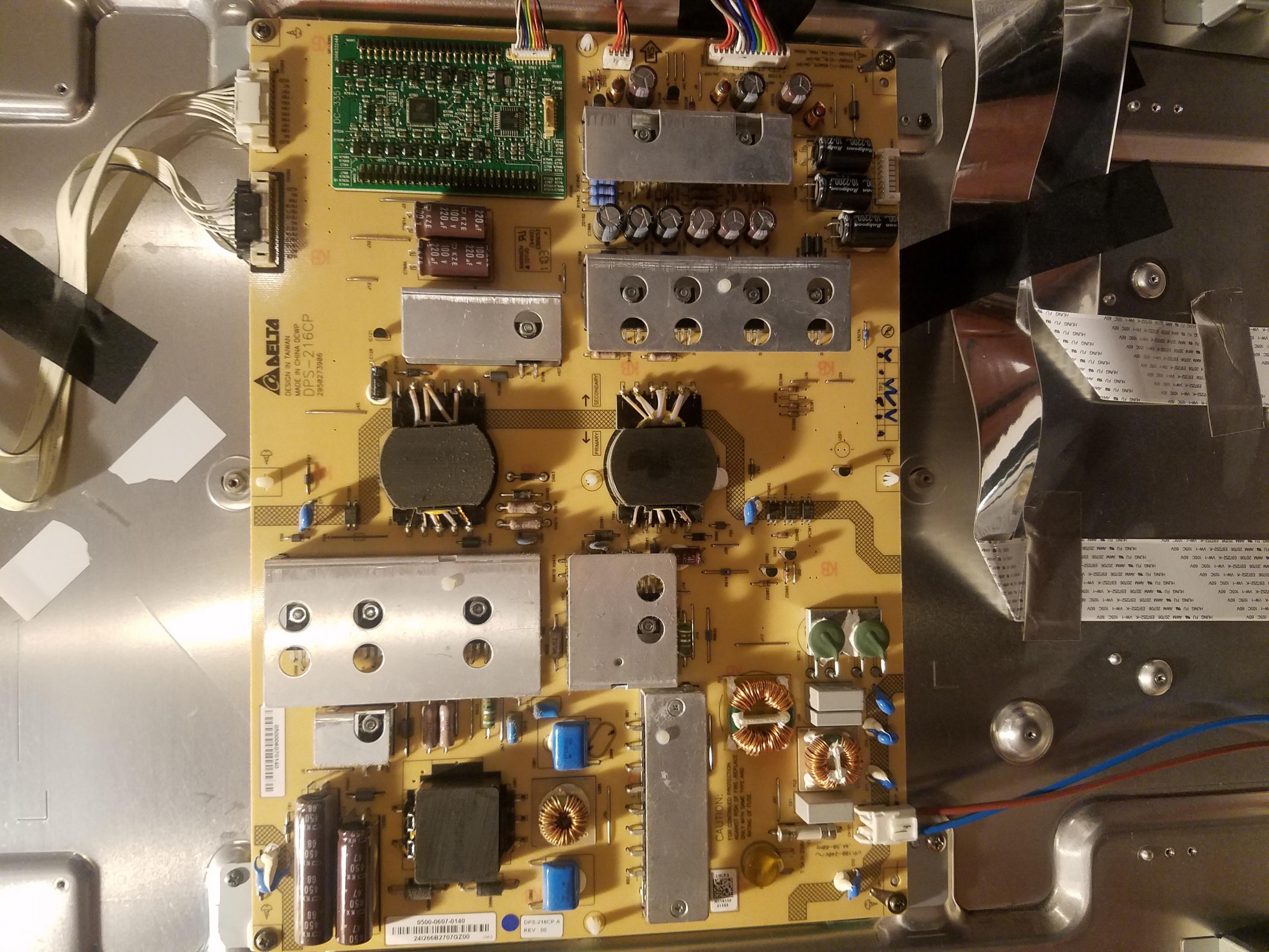

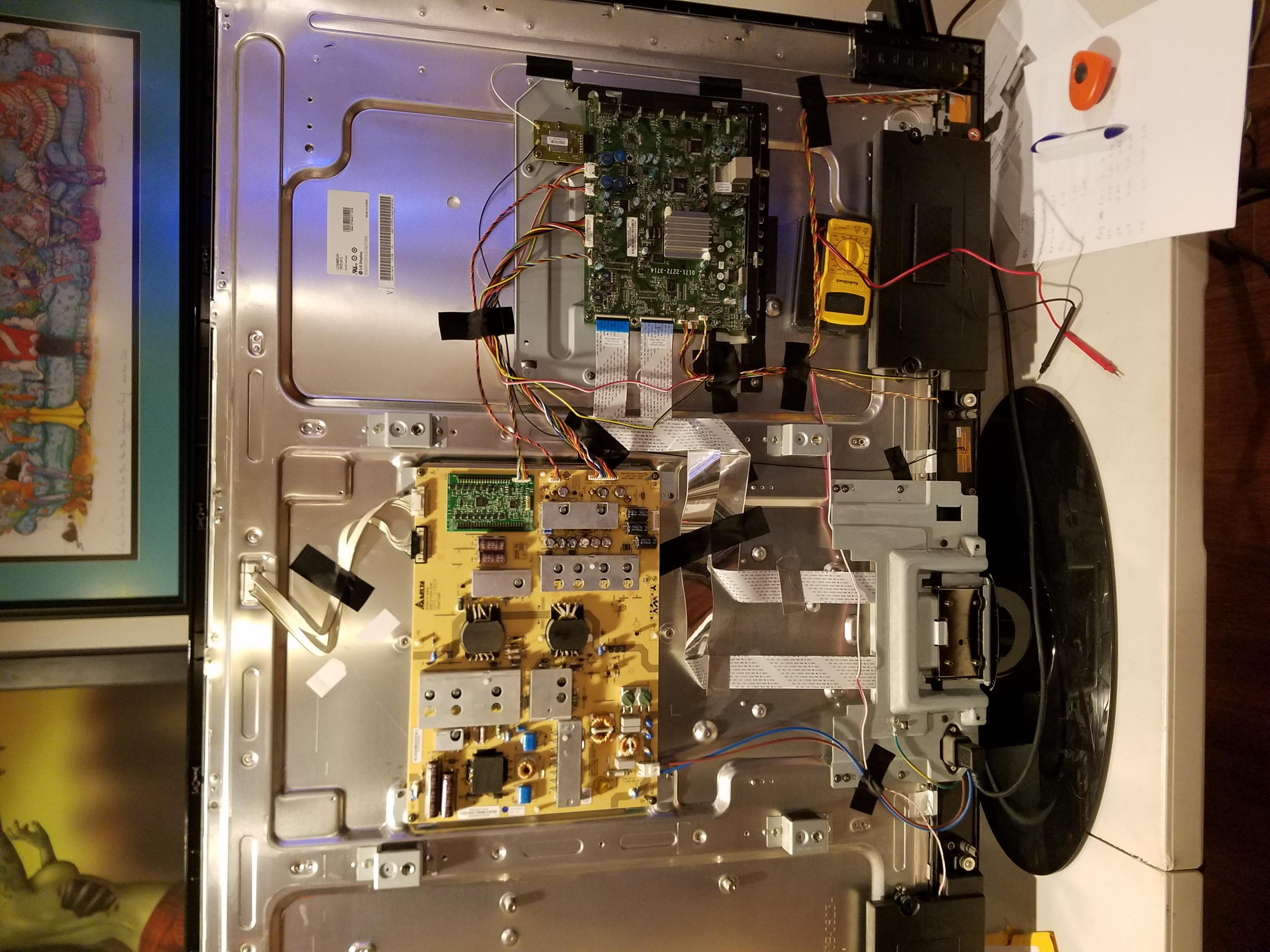

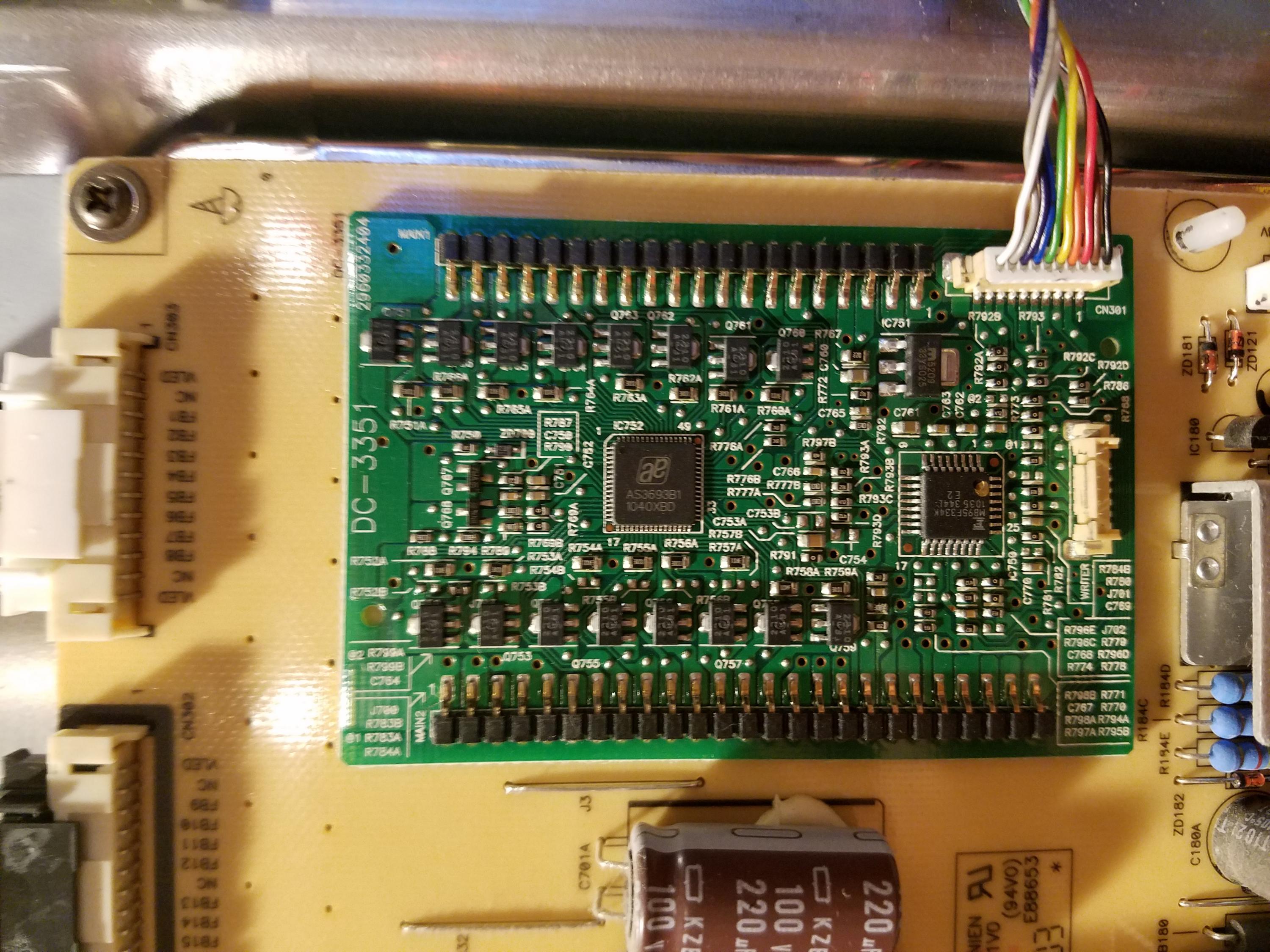

            Need to check the LED driver board (the Green sub board on the power supply) to see what you have on the LED connectors. Need closed up pictures of the LED connector and the whole back side of the TV so we can see how all the boards are connected together.

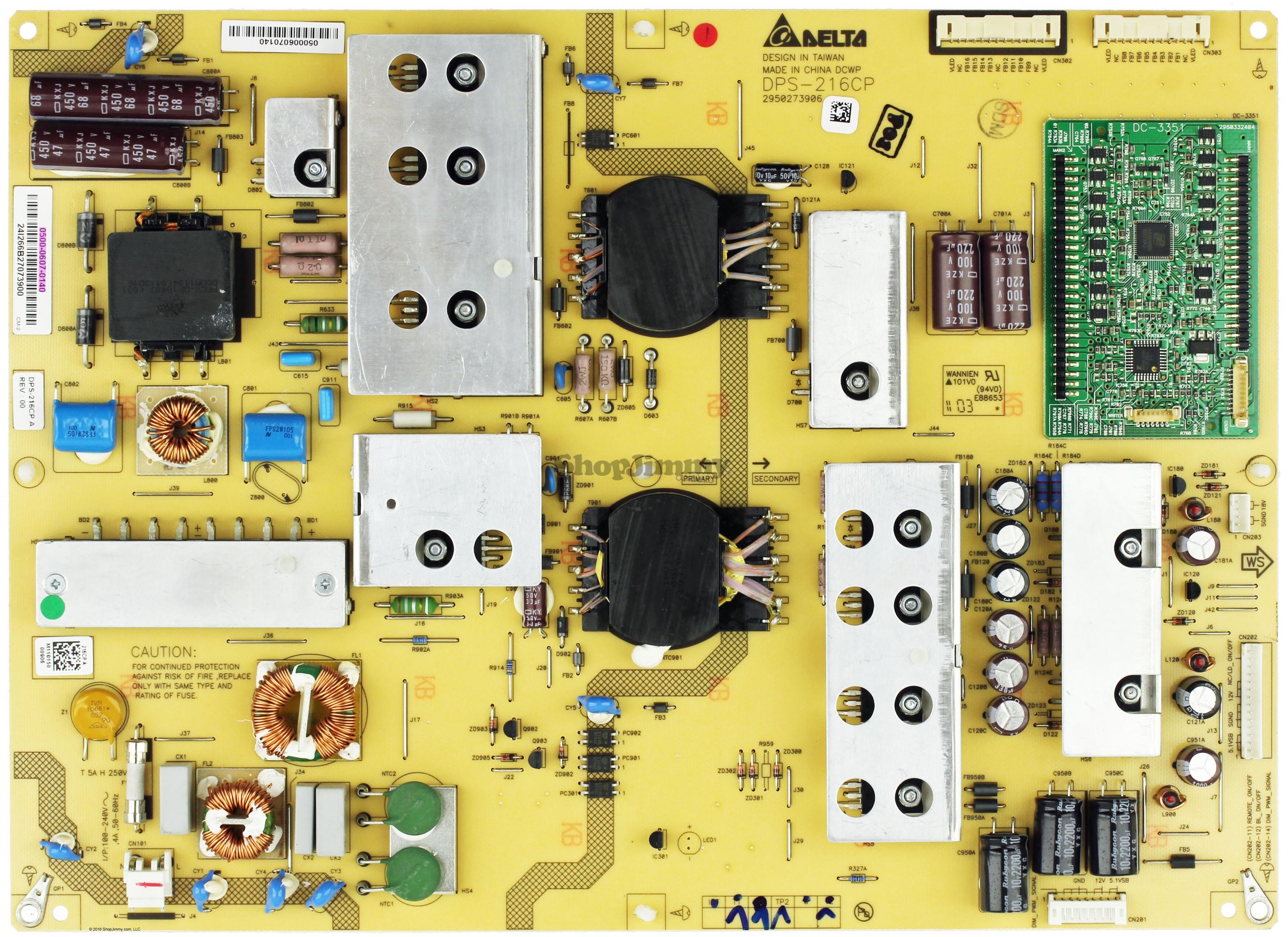

            This board looks like the board you have, please verify.
            http://www.shopjimmy.com/vizio-0500-...-led-board.htm
            Delta DPS-216CP
              Re: Vizio m550sv shutting off after boot up
              That is the correct board. Heres some pics

                  I guess im misunderstood. I posted a picture of the back of the tv and the small green board on the power supply. Do you want the 2 connectors just above that board.?Please excuse my stupidity and i really appreciate anyones help.
                    Sorry, I see all the board now.
                    https://www.badcaps.net/forum/attach...3&d=1478147261
                    So the connector on the LED driver green board that goes to the main board will be where the control signals for the backlights are, then the two white connectors CN302, CN303 with the wires going inside the panel will be where you need to test the LED Voltages (FB1~16 with ref to chassis GND) for each string of the LED, it has 16 strings of LEDs. You will have to turn the TV off, put red probe on FB1 then urn on the TV and take the DCV reading, record that reading, then turn the TV off and then repeat the same procedure for FB 2~16.
                    Pictures provided by shopjimmy.

                      Vled all are 61.3 61.4
                      Fbs are all similar they start between .9 and 1.3 then jump to 10.5 ish then 7.1ish then 7.4ish rhen 2.7 ish and tv shuts off

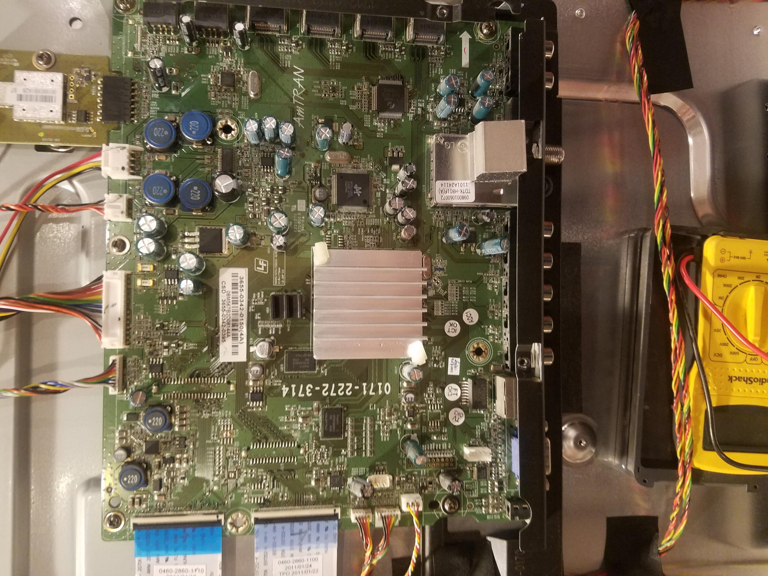

                                    sounds like a mainboard issue whats the part number on the mainboard and from any stickers on the board as it needs to match your lcd panel
                                      3655-0342-0150 (4A)
                                      Csd: 3655-0342-0395
