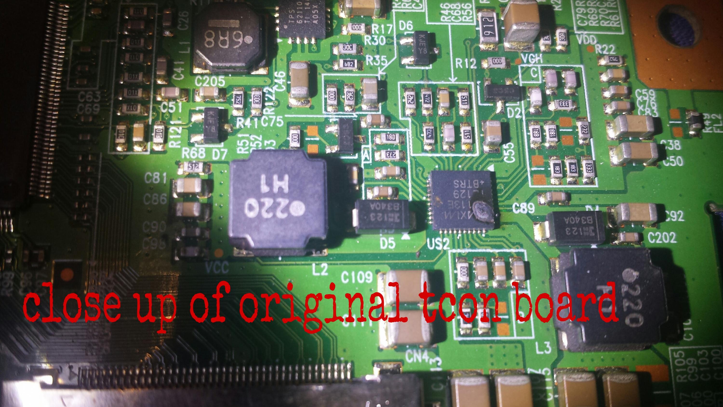

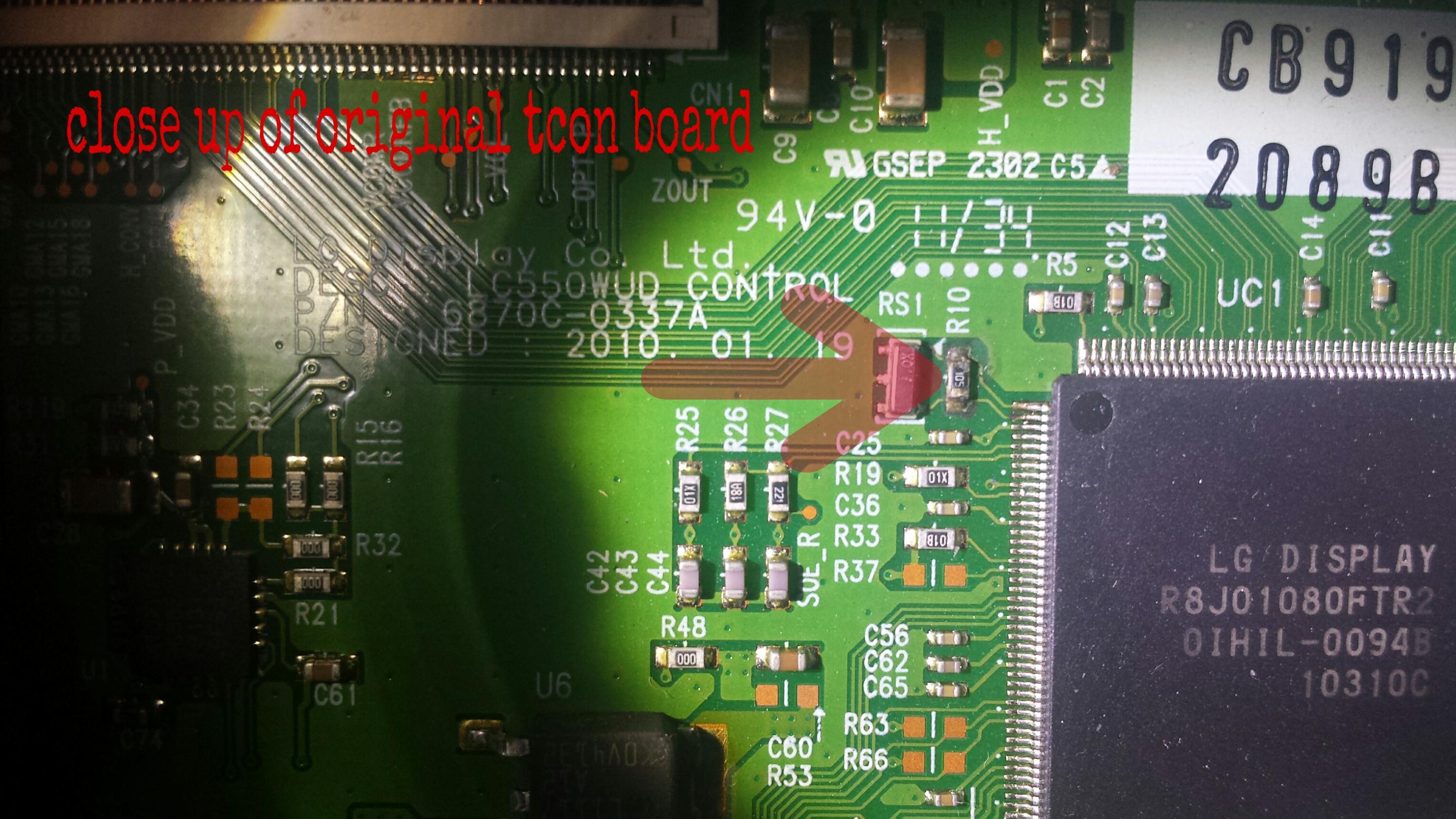

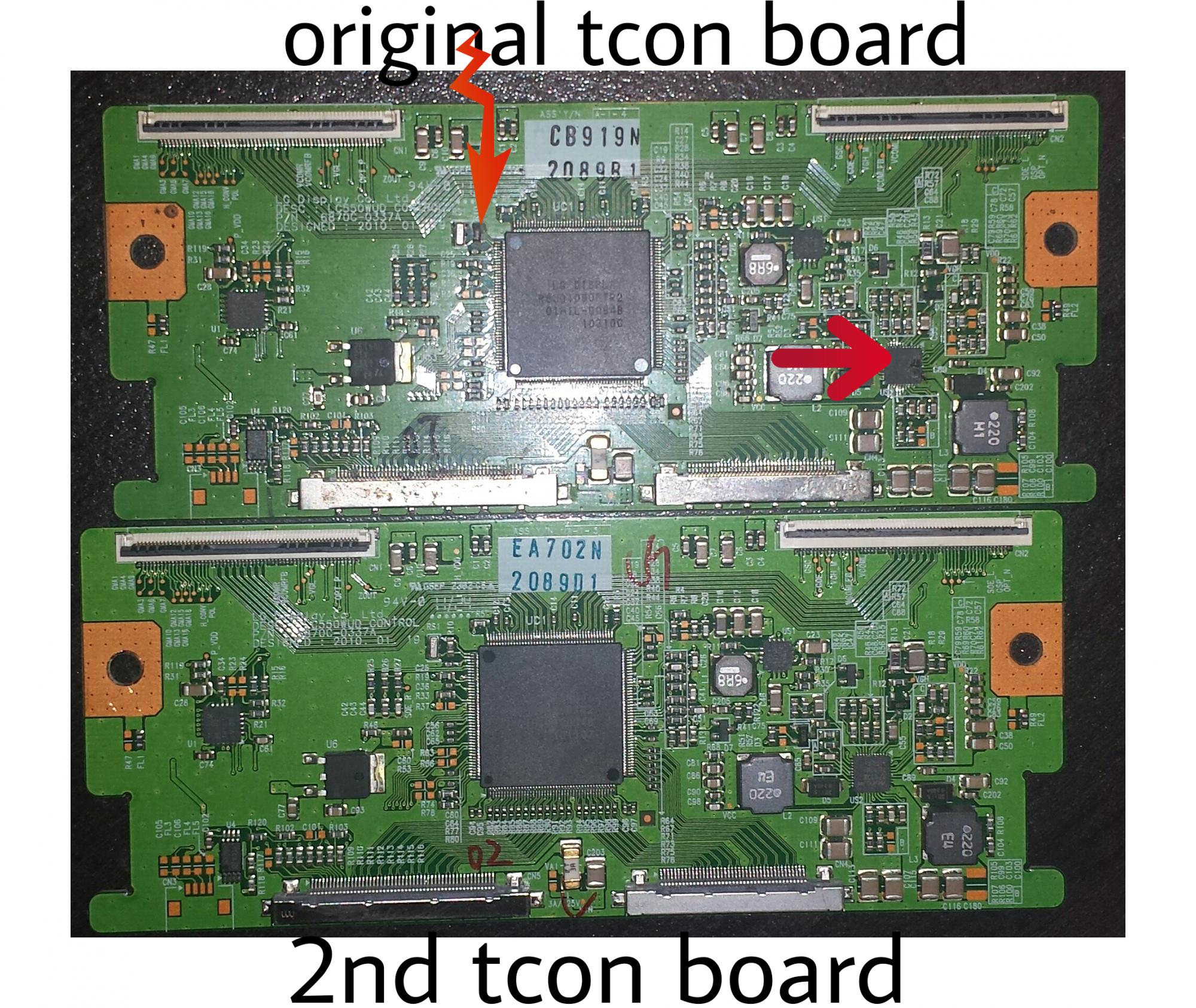

                    Re: Please help!!! Sanyo dp55441 55" lcd distorted picture. Good sound.
                    Here are pictures of the original board that went bad and the board that I replaced it with... Which also went bad.. Revealing the same symptoms. You can easily see the damage to the original board, however, the 2nd board has no visible damage (at least not that I can see) and yet the same symptoms/issues. I hope these pictures, along with the video that I previously provided the link to, will be enough info for someone to be able to tell me how to fix this and prevent it from damaging a new tcon board. Thanks in advance!
                    Also.. When the 2nd tcon board started failing if I disconnected and reconnected the ribbon cables, the picture would be normal again until the t.v got turned off. However with the 3rd board(which is currently still in my t.v) if I turn it off and let the t.v cool down(for maybe an hour or so) then the picture is normal when I turn it back on for 45 minutes to an hour and then it the symptoms start again. (with the 2nd board, turns the TV off and letting it cool did not work.. Which is why I resorted to disconnecting the ribbon cables from the tcon board and then reconnecting them)
                      Tcon boards being killed by faulty panels / COF IC problems have been discussed on these threads so perhaps that is what is happening here.
                        Thanks everyone for all the help.. I was really hoping it was a repairable problem but I guess majority rules.. Glad you guys opened my eyes to the possibility of it being a bad panel before I put any more money into it. Thanks again!!
