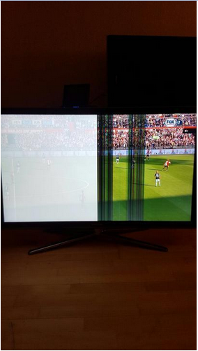

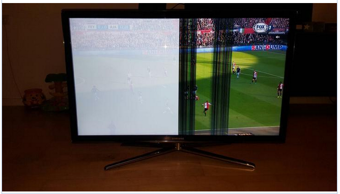

    Hi
    I have a samsung ue46c7700 with a white haze on the left side en dark vertical lines right of the middle
    Before Im going to repair it, I just want to get some hints.
    Is this a panel fault or tcon. It also could be a dirty of broken lvds but I'm not so sure about the last
    My first impression is tcon because of the white haze but I'm not so sure
    With regards
    Anna

    If you did some research you would have a better idea. Seems like tab bonding fault to me, check for tab bond repair on here if that fails I would say the panel is toast sorry.

      Thanks for the quick reply
      Ofcourse i did some research. But the thing that made me doubt was the white haze on the left. I know the dark stripes could be a bonding fault, but how does that relate to the white haze on the left part.
      Could both problems be related to a bonding fault?

        Its ok, also remove the front frame for the screen and inspect the tab bond drivers and push on a few see if it has an effect. This looks like a driver fault or even something like water damage.

          This one was a really bad panel. Thanks for the support
