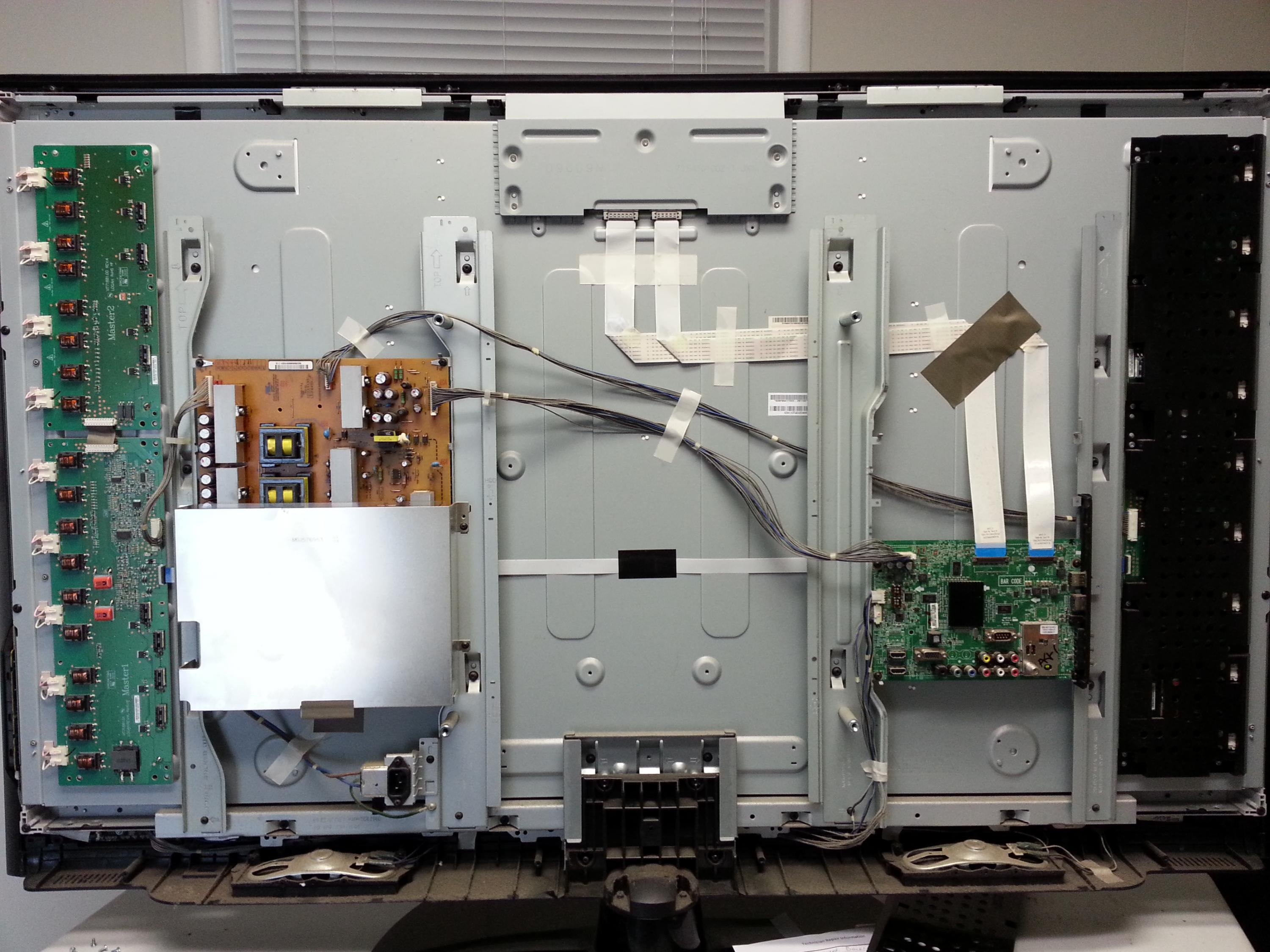

    This one starts up and runs okay, but the backlight cuts off after between 2 and 10 seconds (almost like it fades out; it's not an abrupt thing). I see inverter boards, so this one is a CCFL-backlit model. The question is, what is the easiest way to find out which inverter (if any) is bad or if we have a backlights problem?

              Some Measurements from the power supply
              I took another crack at it and got some measurements on the connection from the power supply to the master inverter. Here's what I came up with:
              ERR - starts at around 3.5, drops to 1.3 after the thing finishes booting up
              PDIM #1 - stays at 2.7
              INV-ON - holds steady at 3.4
              ADIM - 0 volts
              24V - holds steady at around 24.8
              Given that the power supply is giving consistent power to the inverter, is it reasonable to assume that the inverter is where the problem lies? Backlights don't exhibit intermittent failure, right?

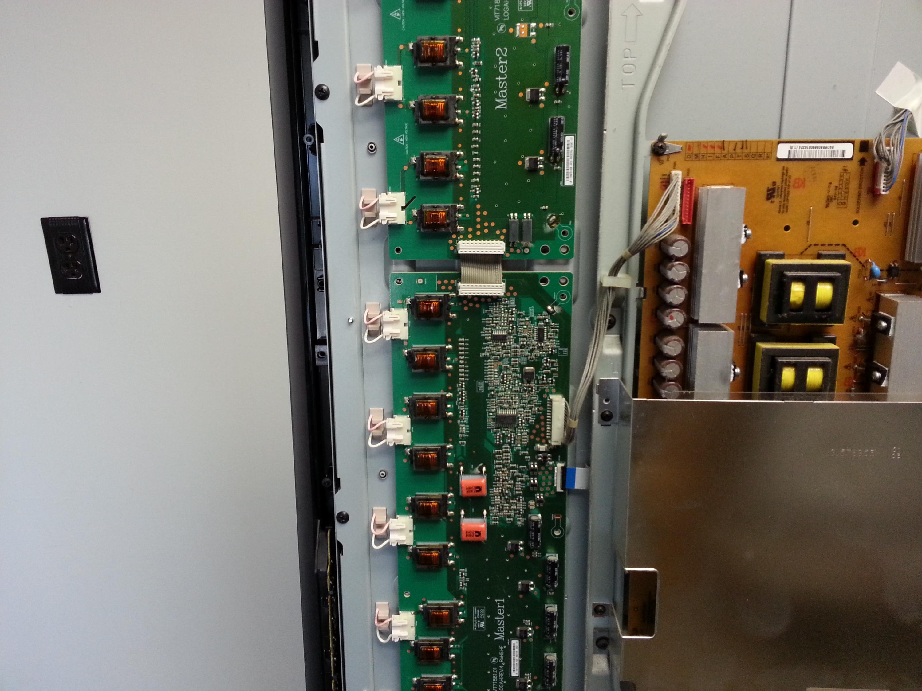

              Now, the question is finding which inverter is giving the problem.

                          possible lead
                          I had a conversation with a parts supplier and he had a hot tip - he thought that a cold solder joint on the mainboard could be causing this problem and recommended a reflow. Has anybody else heard of a backlight cutout issue being caused by a cold solder joint on the mainboard?

                              Diagnostics
                              Originally posted by ReeceyBurger123
                              No point in guessing the fault, we need you to diagnose and test it. Check what Bl on does when it fails and Bl error.
                              INV-ON holds steady at 3.4 and ERR starts at around 3.5, but drops to 1.3 after the set finishes booting up.

                                No news
                                I tried the dryer trick on this one also by individually heating each board for a few minutes with the dryer before powering it up, but had no luck or change of any kind.
                                I did get a better look at the problem though (which manifests almost instantly now, so there is no way to get a test pattern up). The interesting thing is that when it first turns on, it displays at full brightness for a split second before becoming really dim and then ultimately turning off. This might be part of the normal startup routine, (I can't remember for sure anymore) but if it's not, it may provide a valuable troubleshooting clue. Unfortunately, I'm just not very experienced when it comes to electronics repair, so it's tough for me to say.

                                      Subbed out power supply board with one that is allegedly good; still no change. Looking down at it from that angle, the backlighting that does come on (only for less than a second now) appears to be uneven. I'm beginning to wonder if we've got a bad inverter board (let the hunt begin) or backlight (seems difficult to troubleshoot).

                                        Phew, we're just having the worst of luck with this thing. The first inverter board I ordered was the wrong one ("Rev:6" instead of "Rev:4", which are identical boards, but Rev6 has a slightly different connector that connects to the inverter right above it) and the second one was the correct one, but the seller sent me a "Rev:6" anyway, so I arranged for an exchange. Unfortunately, the replacement was also a "Rev:6", so now I'm in the process of getting that one exchanged for the correct one once again.
                                        While we're waiting for that, does anybody have any lamp troubleshooting tips (just in case those are the issue) now that we've ruled out a power supply board?
