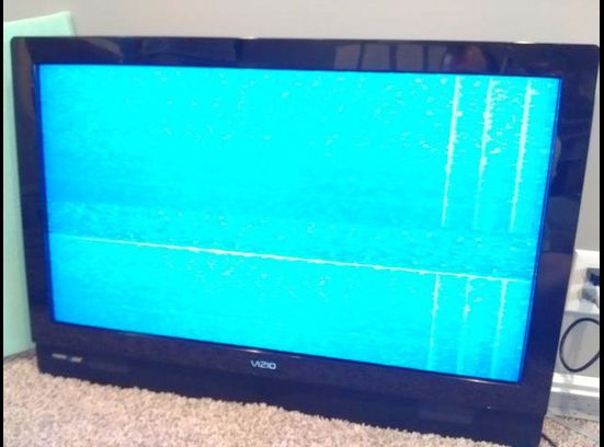

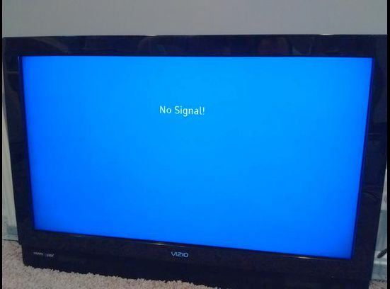

    So I acquired the eponymous TV knowing the panel was still good but that it really didn't work. The TV will apparently start fine to a blue screen with the message "no signal" but if you connect a source (see attached), it goes black and then doesn't respond to inputs. Sometimes the blue image will fuzz out (see attached) before going black. It does this best when started cold. After running for a few minutes it fails to even go to a blue screen.

      I replaced U21 with a AZ1117EH-ADJTRG1. It lives!
