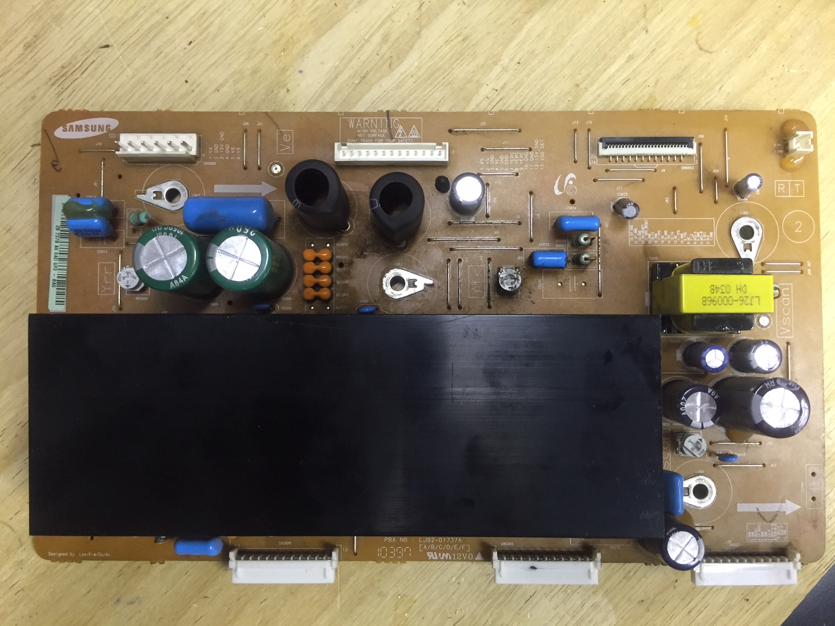

    I have had this up and running on test for a little while, Found x-sus board shorted, replaced two fets on Xsus which seemed to solve the problem. anyways lost picture, on start up I am getting three blinks from the power led and a very brief glow from the screen. from there the set continues to start up IE I get sound and controls.
    VA and VS test as per panel spec, but obviously drop down rapidly when the protection circuit shuts them down, I have found nothing of note (shorted components) on either the X sus or Y sus boards
    regards

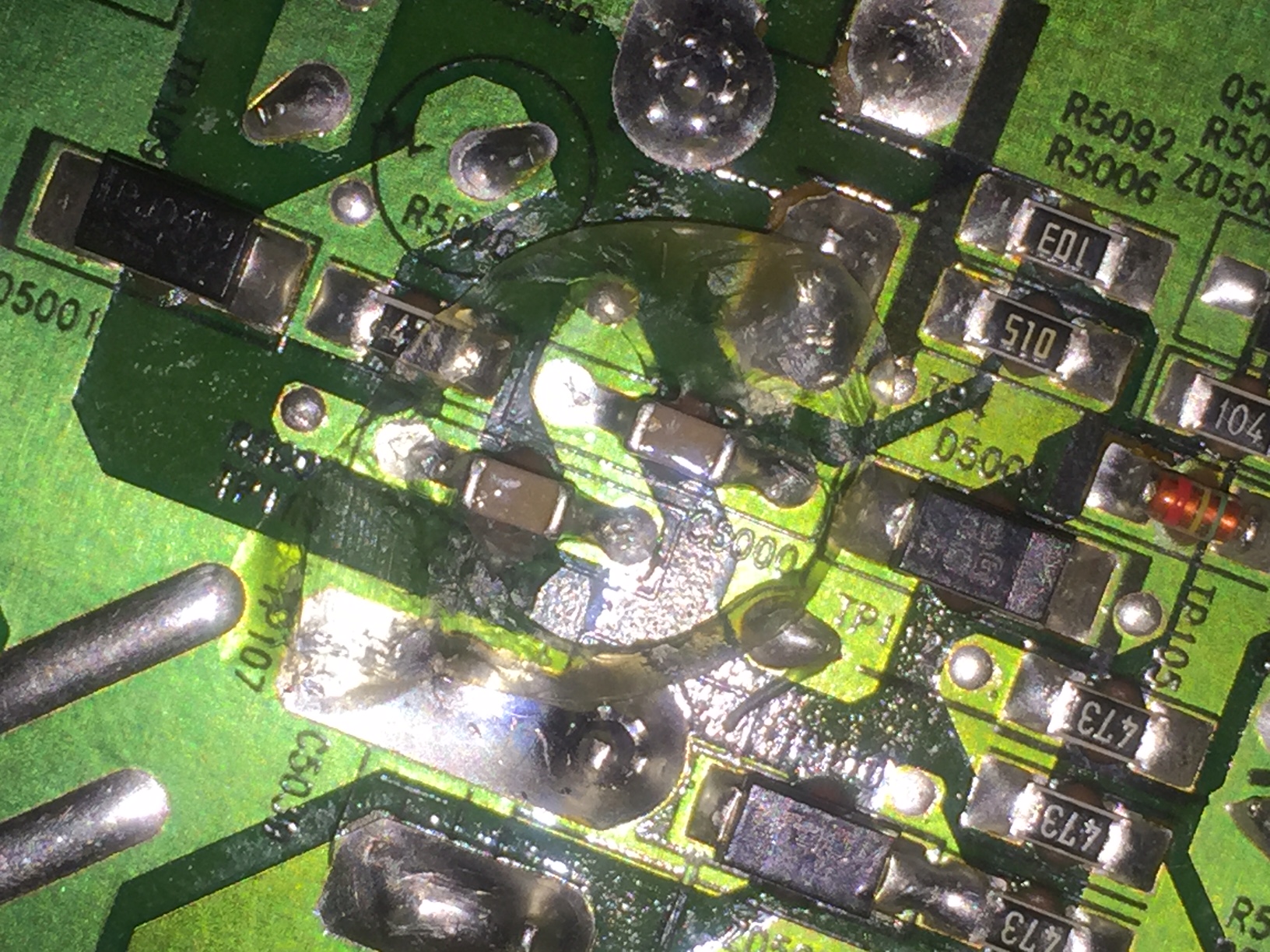

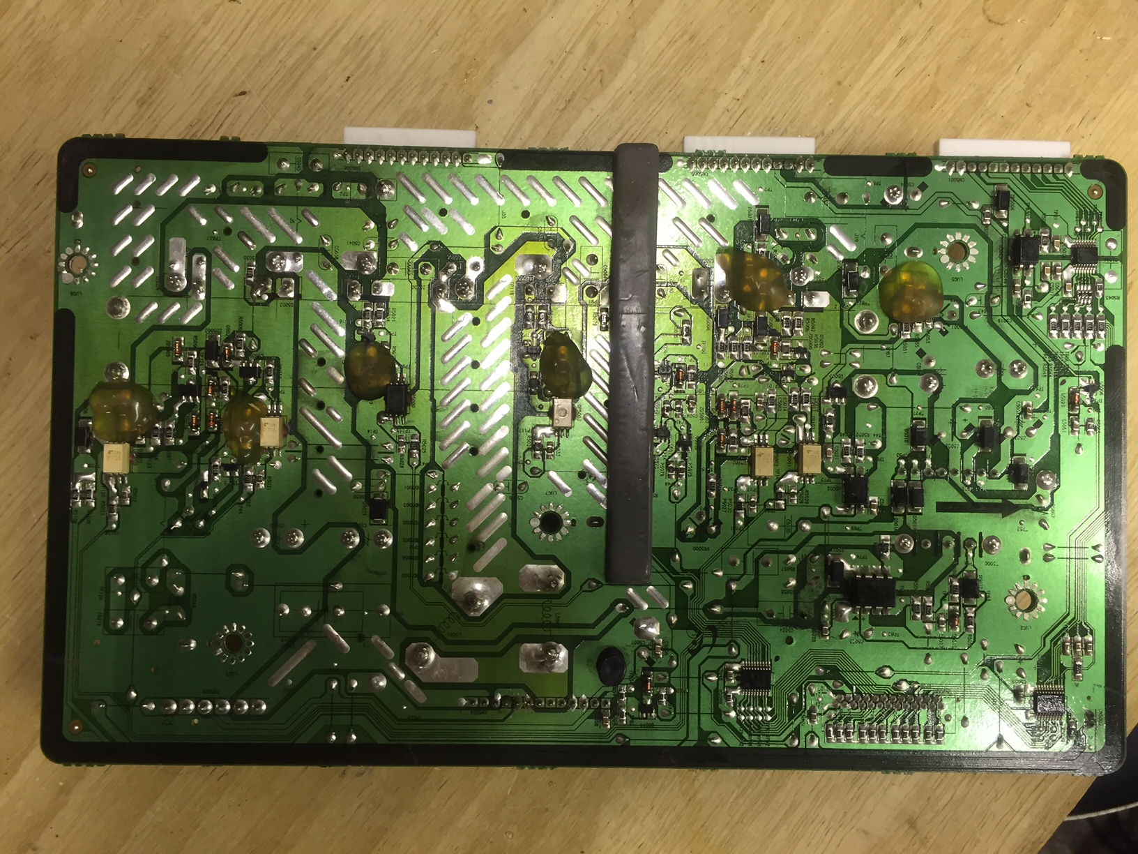

            Well I have been through the both boards and still find no shorted devices
              Re: Samsung PS42C450B1W sound no picture
              See attached pictures
                So you've also tested all the surface mounted devices ? Also what should the voltages be for the panel for Vsc etc ?

                        Well I have been through the y sus and x main boards, I may have found several open cct smd caps on the ysus board but without a cct I am not able to find what value they should be but I am not getting any reliable measurement from them. Then again I don't have a capacitor / esr meter that will read values this small. Also suspected are several RJP30EZ devices that may be open on one of the junctions.

                          you mean RJP30E2?
                          RJP30E2 and RJP63F3 are IGBTs. Normally IGBTs fail short from what i've seen.
                          I have not successfully repaired one of these boards but i did a quick attempt to replace just the failed IGBTs in one xmain resulting in them failing again and both the ymain and xmain boards shorting out.
                          There's a good chance there's be failed SMD components on the underside like driver ICs, transistors, diodes maybe even resistors.

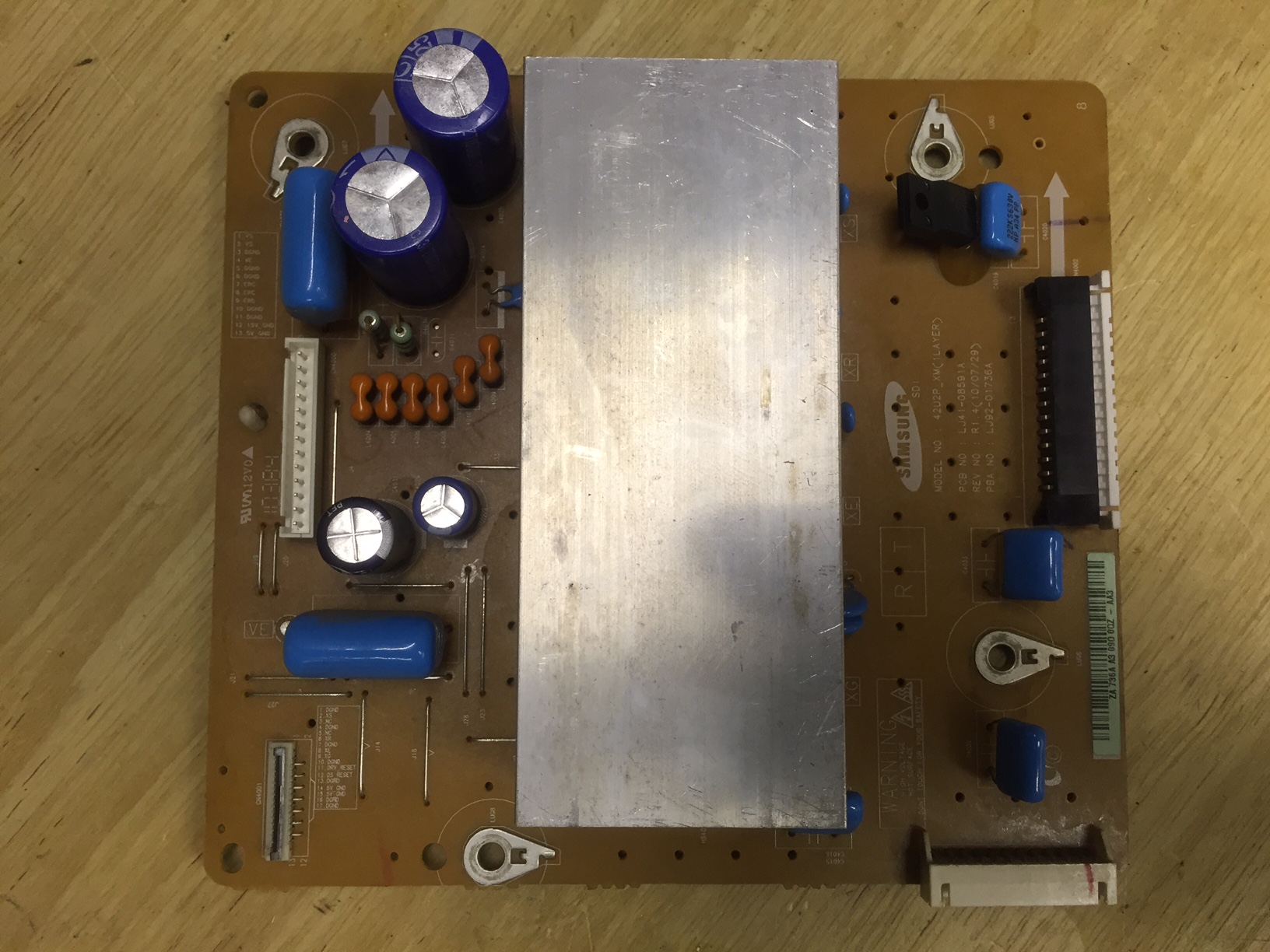

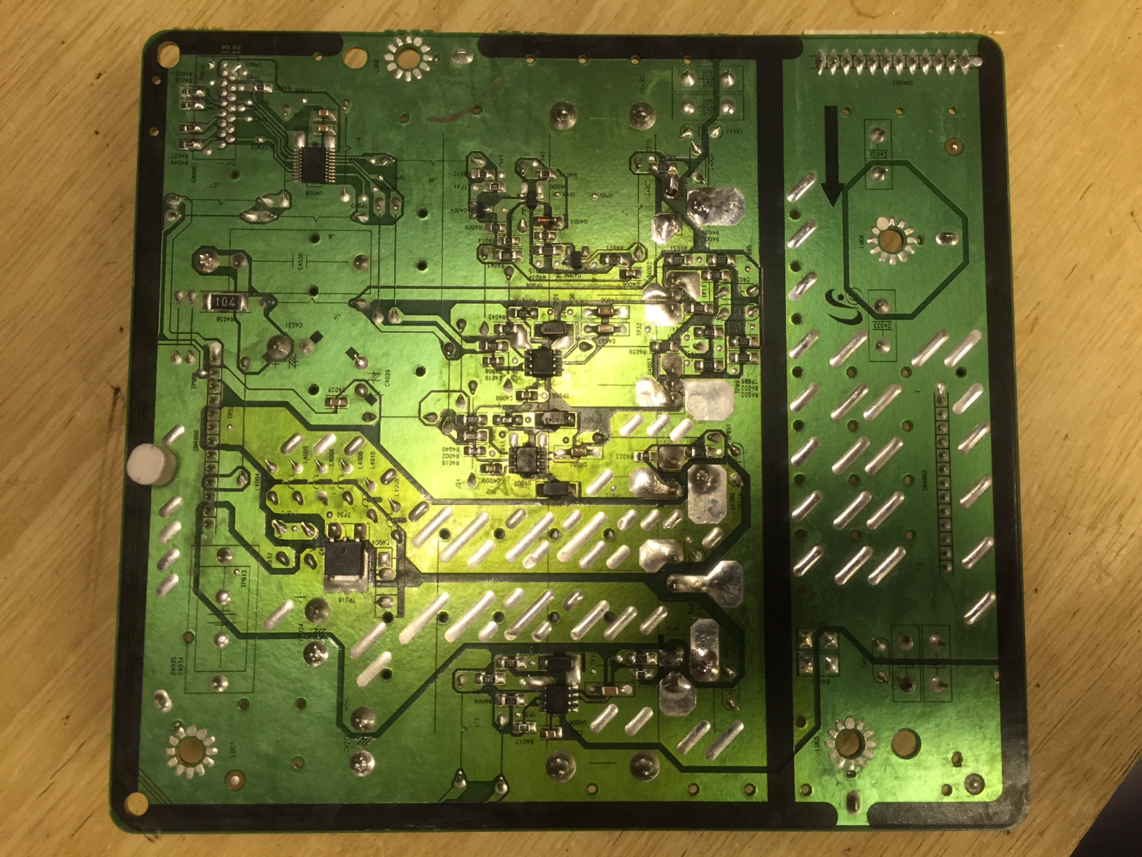

                            Many thanks for the information, I have tested what I can of the SMD components on the Ysus board, I am having problems testing the IGBT's, I don't think the fluke is providing enough voltage to turn them on. But can confirm they are not shorted, whether they are open is another matter. Looking at the cost to me to obtain these devices I decided to order replacement boards.
                            Just as well I checked the replacement boards as I find the Xsus is bad, it has shorted vs to ground, and the IGBT's are shorted. The Ysus looks ok, just as well I checked first now waiting to hear back from the seller.

                                Its been a while, but I am loosing the will to live on this set, sent back one clearly defective X-sus board and just taken delivery of replacement so have fitted what I am told are tested and functional X-sus and Y-sus boards. Both 'appear' ok in as far as I can test the devices. I have checked the y buffer for shorts and find am not finding any. So assembled and tested the set and it is with no real suprise I still get three blinks from the led. the plasma panel appears to flash very briefly, then no further display. I get the Samsung chime and the set is responding normally to the side controls. Vs and Va collapse when the Psu goes into protection mode and Ve still looks unstable.
