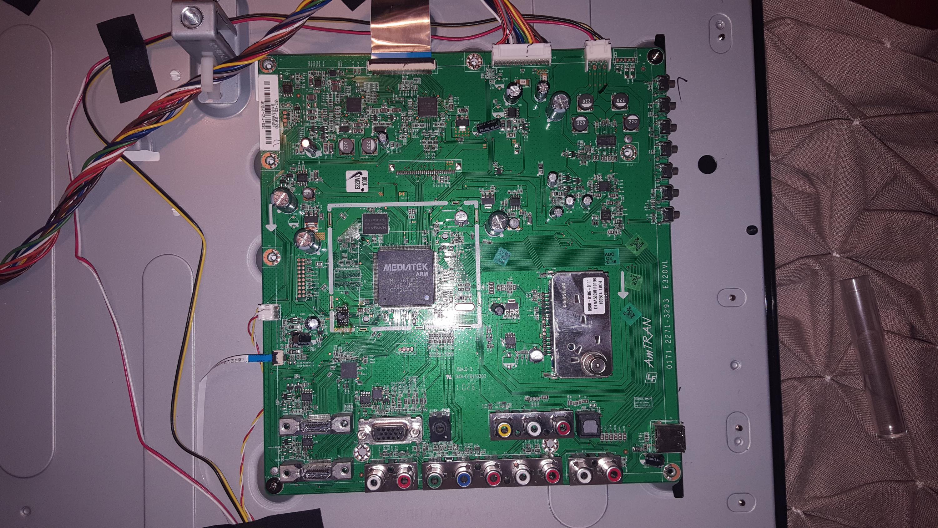

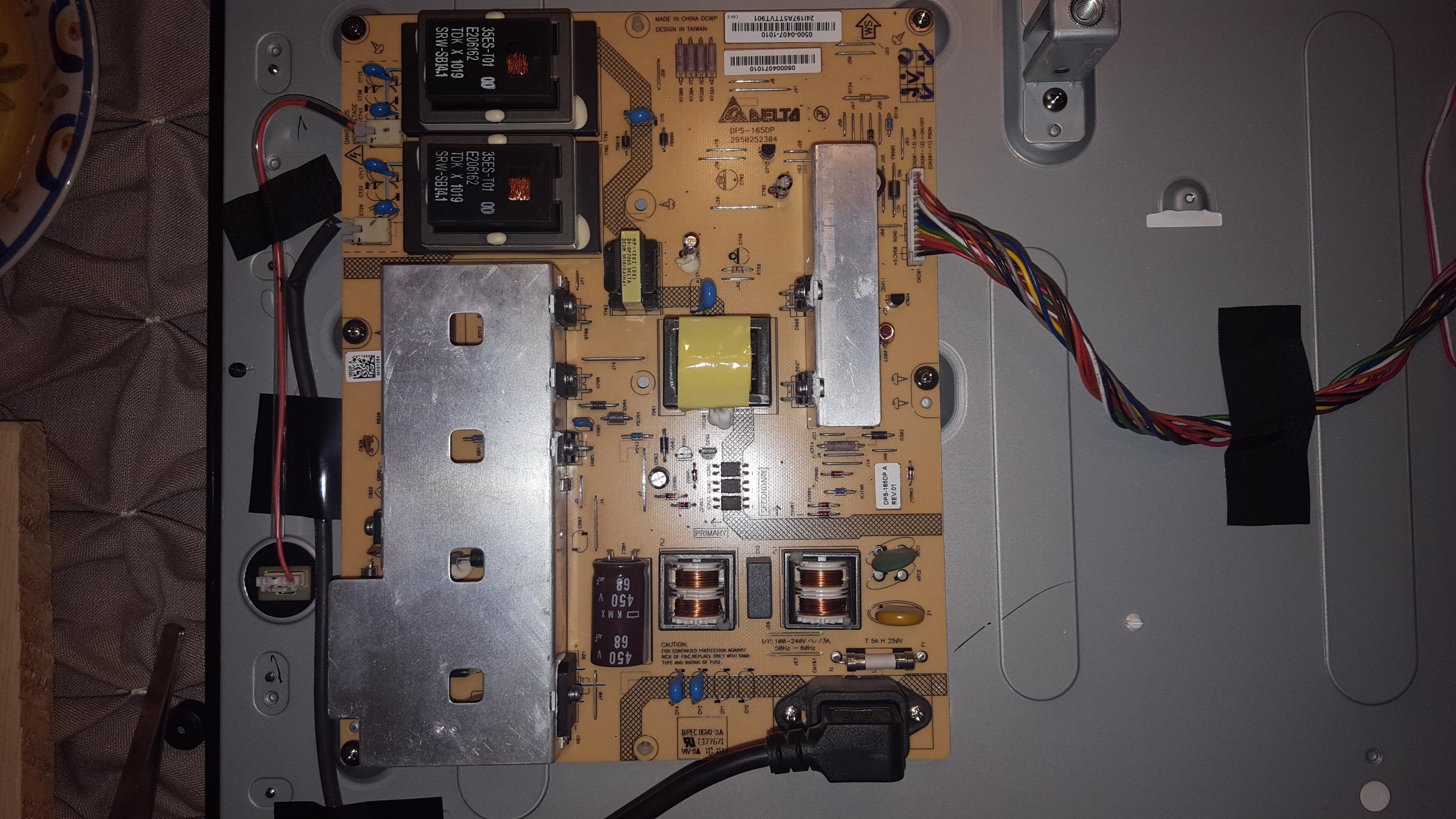

    I have a Vizio e320vl lcd tv and I get an amber light but when you push power button it does nothing. My guess is power supply is good but main board is bad. I need some help with power on circuit. I do show 6.28v on standby but no 12v even when you press power button. Thank you in advance!

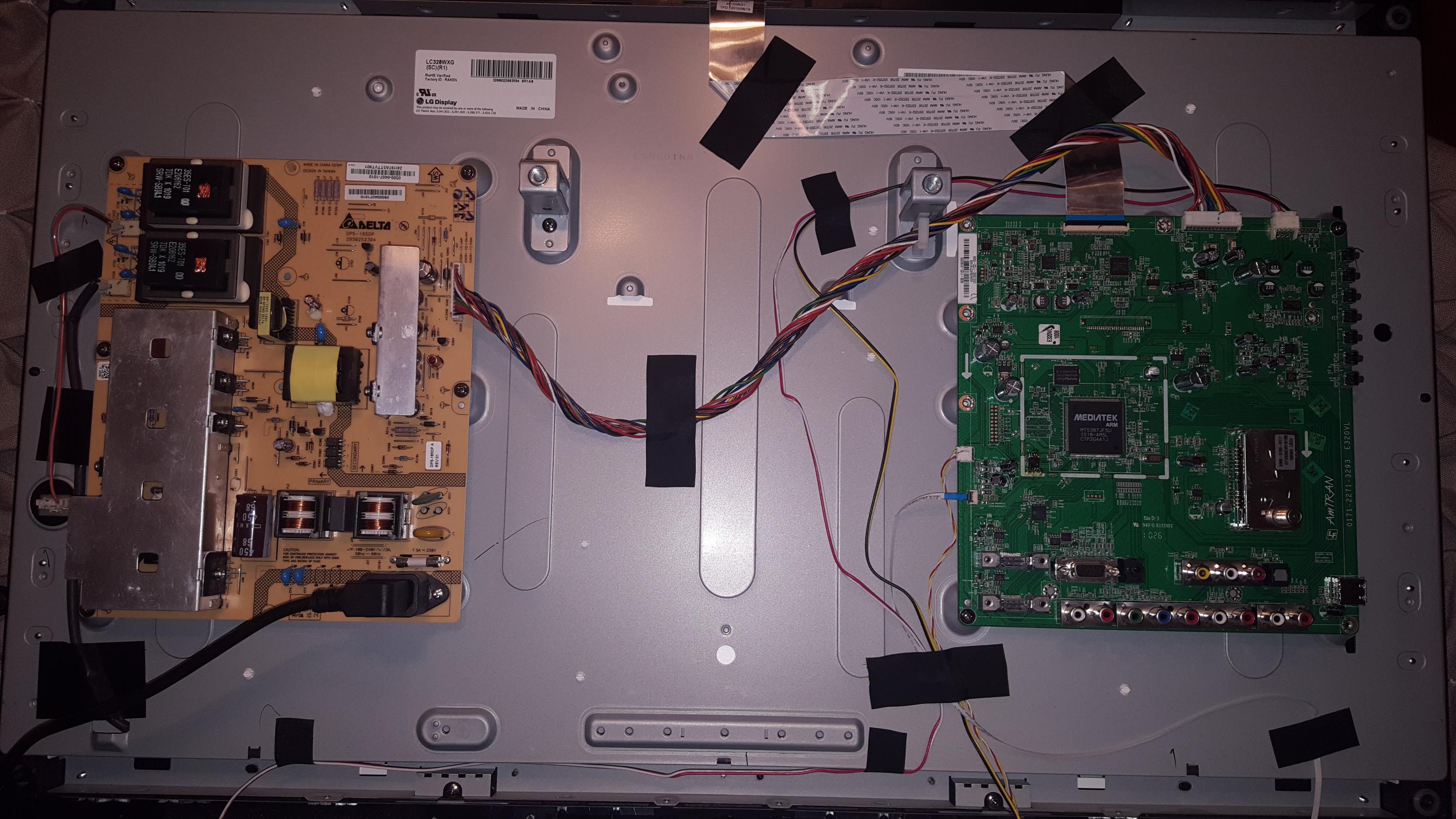

    Second, we need the pictures of the whole backside of the TV showing all the board.

      Re: Vizio e320vl standby voltage 6.28v no 12v supply
      Here are the pics
        Ok, so did you check batteries of the meter?
        We have to make sure the batteries are OK first, then we need to check the DCV of all the pins of the connector of the power supply board that goes to the main board to find out what are missing.
          I assume you are referring to batteries of my digital multi meter. I was going to replace but I realized I don't have another 9 volt handy. The voltage readings are
          Pin1 6.28v
          Pin2 6.28v
          Pin3 6.28v
          Pin4 0v
          Pin5 0v
          Pin6 0v
          Pin7 0v
          Pin8 0v
          Pin9 0v
          Pin10 0v
          Pin11 0v pson
          Pin12 0v 1--on/off
          Pin13 0v lamp
          Pin14 0v Dim
