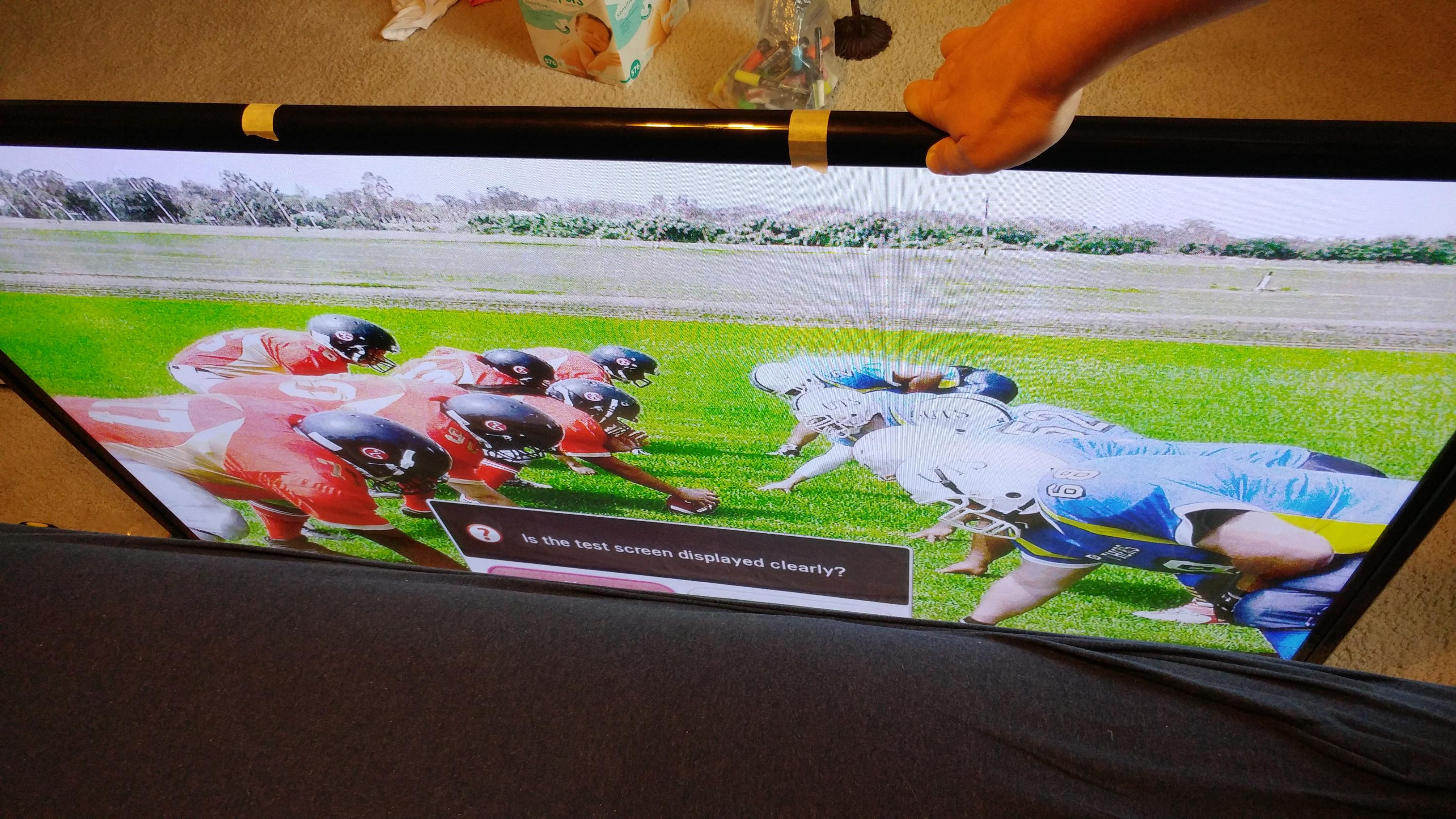

    My wife was watching TV and it made a loud pop and the screen went black. Sound but no display.
    Had a shop repair the YSUS board, and I bought new buffer boards and replaced both YSUS/buffers. Now the TV has a display but the colors are off, almost looks inverted and I see small colored dots on the screen.. almost like static in color. (See attached photo)
    So I jumped the control board for a test pattern, all the colors look good but the large white vertical and horizontal wipes aren't solid and have some lines static in them. (See attached video link)
    Video of the test pattern with Control board jumpered.
    https://drive.google.com/file/d/0ByK...ew?usp=sharing
    1. ZSUS Board replaced
    2. LG 60PB6650 Y-sus repaired
    3. Both Buffer boards replaced
    I'm wondering if the ZSUS board replacement I purchased is also bad and I'm checking all the solder joints now to repair them on the ZSUS board.
    Any ideas? Thank you

      I know, it is late answer. I suspect that is Y-sus adjustment issue. Thank you.
        Re: LG 60PB6650-UA Plasma Issues
        Zsus issue, take it back to the and tell them to sort it properly they should of tested it. Also Zsus erc coils with bad solder joints cause this but they are what kills the Ysus from the start.
