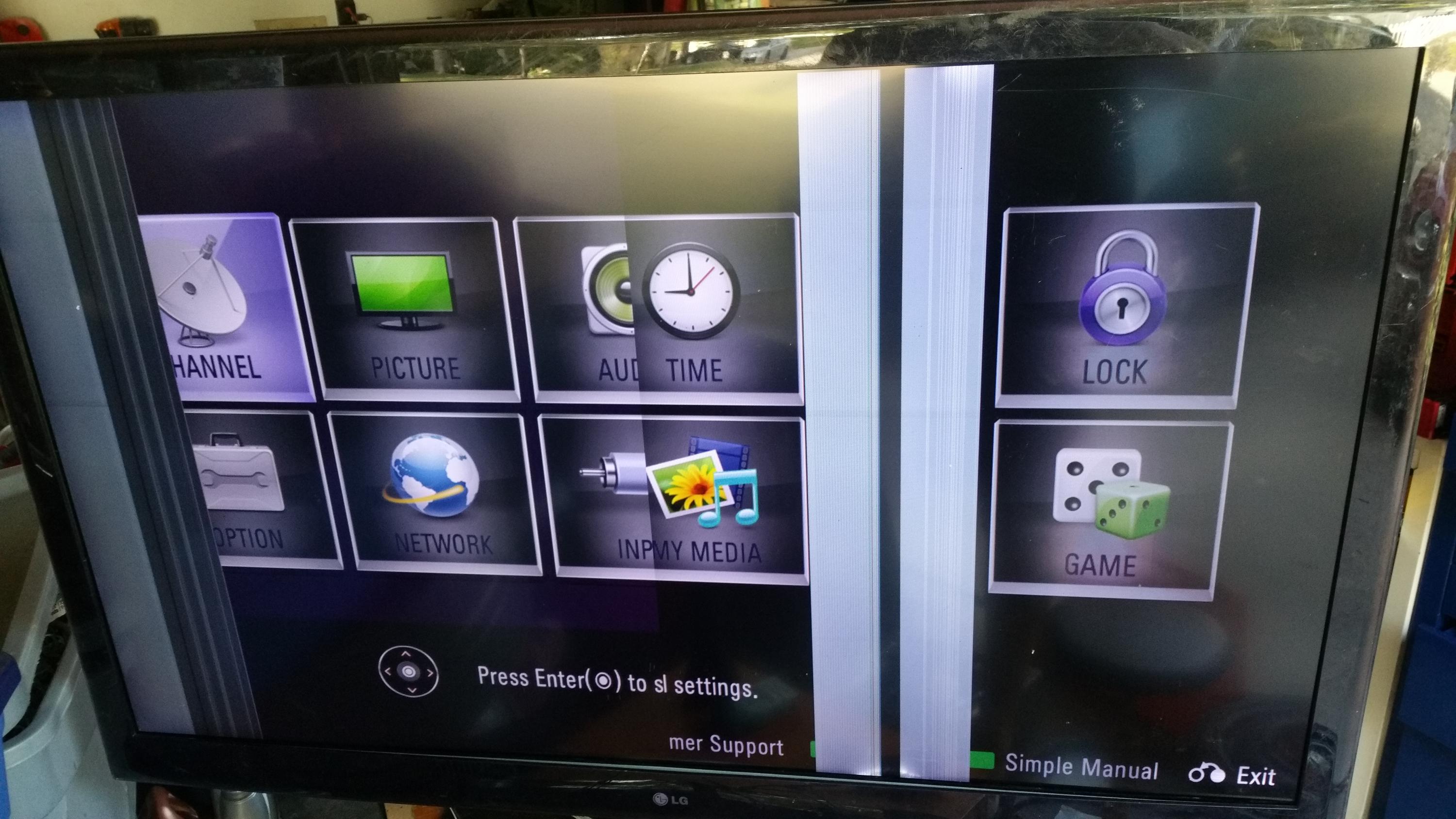

    Trying to resurrection an LG 55LX6500. Got it to power up, but I've got a vertical bar issue.
    I pulled and cleaned the 2 ribbon cables, with no change.
    I made some foam rubber spacers and put them between the frame support and both sides of the ribbon cables between the screen itself and the long boards that distribute the video signal (the actual name escapes me) along the panel. Put everything back together and got no change.
    Does that mean it's a bad tab bond on the display panel and ultimately a very expensive paper weight?
    This model retails for $3K, so if there's a way to fix it, that would be great.
    Thanks for the help.

    Panel failure.

      Is the tab bonding on the top edge or on the bottom edge of the TV?

        Along the bottom.

          glass cleaner damage.
          see this often on bottom fed panels.
