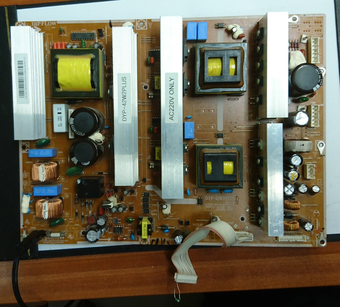

PS-42Q97HD, not starting every time :( HELP !!!!
  • jczarniak
    • Oct 2015
    • 179
    After switching OFF and ON from the power socket (sometimes a few times) TV is starting fine.
    Checked a few voltages:
    When TV struggle to switch on I've got:
    instead of 18V - 11.3V
    instead of 12V - 11.4V
    Va=33.5V
    After switching OFF and ON from the power socket (sometimes a few times) TV is starting fine and:
    18V test point - 18.5V
    12V - 12.4
    Va - 63.5V etc...
    TV works fine, stays on as long I want.
    Help, please.

                      A few new observations:
                      when TV is cold (has been switched off for 10 hrs) is switching ON straight away, works fine, stays ON etc...
                      When switched OFF after about 15 minutes of work, blue light which should be ON all the time (setup in menu) is like dimmed and comes back on after 10-15 minutes.
                      No chance to switch the TV ON, need to wait for good 10-15 minutes.

                        Please make yourself clear, when you say the set is off do you mean unplugged from wall socket, or in standby.Replaceing the small caps (50v) on hot side of the supply would be a good place to start from

                          You need to isolate the Psu first, heat it and follow what I said.

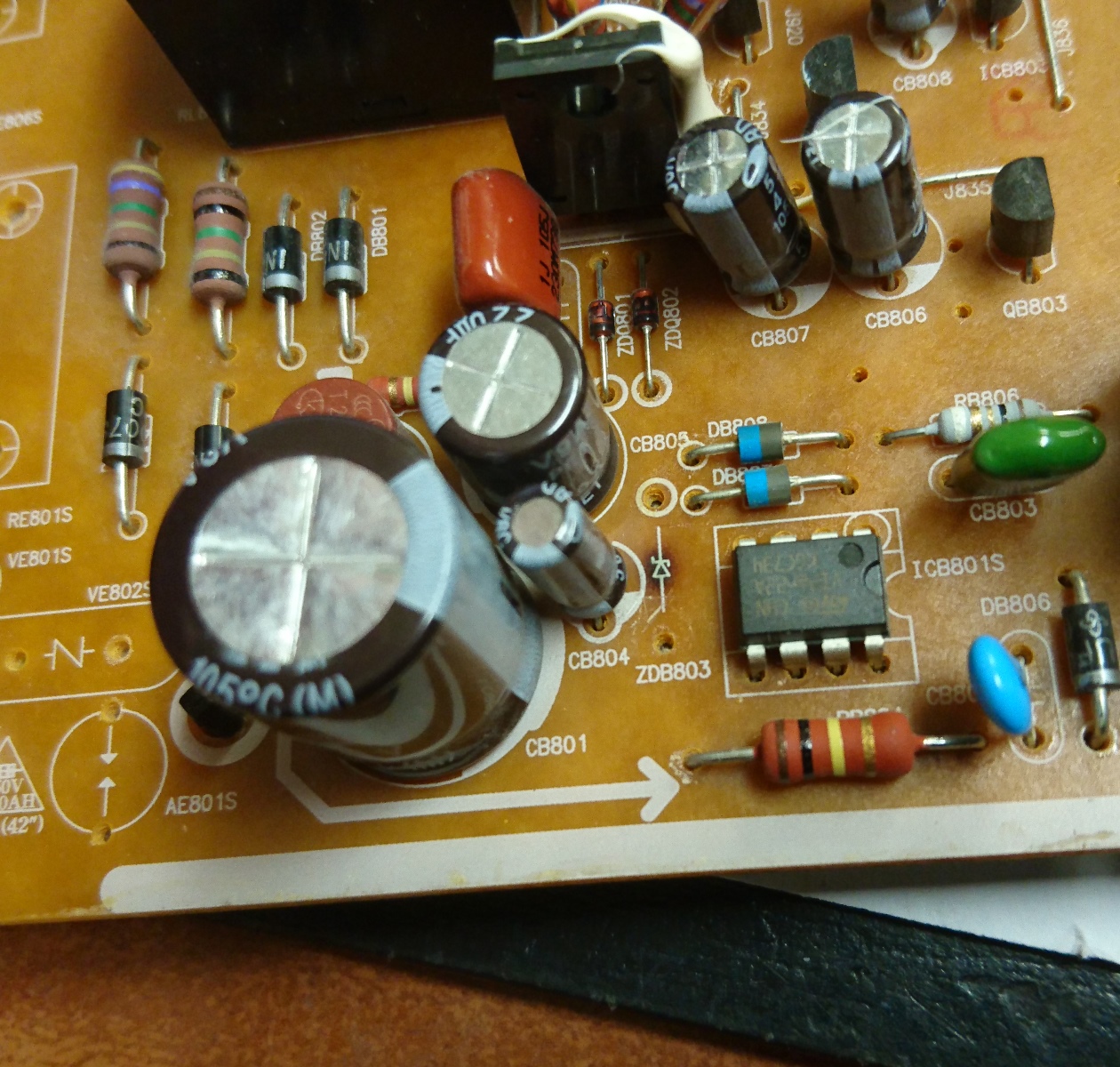

                            Just found the burn mark under zener diode ZDB803 (already removed on the picture)
                            Could it be a reason of all my problems with that power supply?
                            Can't find replacement anywhere - MTZJ30C
                            Can I use any equivalent, please?
                            Thank you.

                              Zener Diodes Zener 500mW 2,5% 30V
                              Data sheet available from:
                              http://eu.mouser.com/ProductDetail/T...8wxQLQMw%3d%3d
                              CPC, RS or Farnell will probably supply them or its equivalent.
                              • jczarniak
                                • Oct 2015
                                • 179
                                Re: PS-42Q97HD, not starting every time HELP !!!!
                                Thanks a lot.
                                What you thing about this one, please:
                                http://uk.rs-online.com/web/p/zener-diodes/0812572/
                                Thank you.
                                  The tolerance is twice the value but same working voltage and higher power dissipation so worth a try. May be worth your while checking around that circuit to see if anything else has failed and caused the zener to overheat.
                                  Have you got a Maplins near you?
                                      Originally posted by jczarniak
                                      Yes, 5 minutes drive
                                      Something like that?
                                      http://www.maplin.co.uk/p/bzx85c-30v...er-diode-qf64u
                                        Have u tested the diode ?
                                        and i would certainly do what flocko said start testing the caps etc
