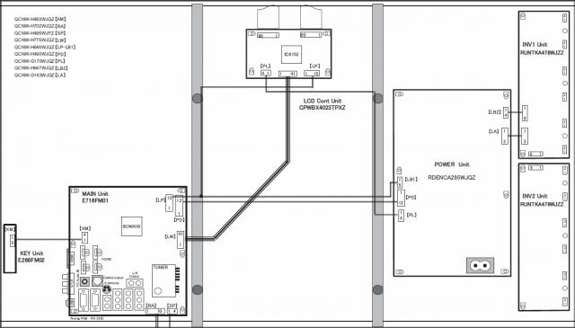

                  Update I did some experiments seeing if the temperature was causing my problem but so far I have not been able to confirm that it was...The TV still shuts down after an hour and I have no faults ... I have however found out that I'm loosing a 3v Error wire when the TV is fail mode. I have also attached a schematic of my TV...I know people like to see picture...let me know what else I must do to get some help. I really need it on this TV.

                    I notice my Error 3 volt wire coming from the TCOM or at least the ground is going to 0 volts when my screen goes blank. So I disconnected the connection to the panel and left the TV on over night...taking the panel out of the equation I manage to get the TV to fail, sound still worked so I know my main board is good leaving only the TCOM board ..will change it next will keep my thread going until I find the problem.
