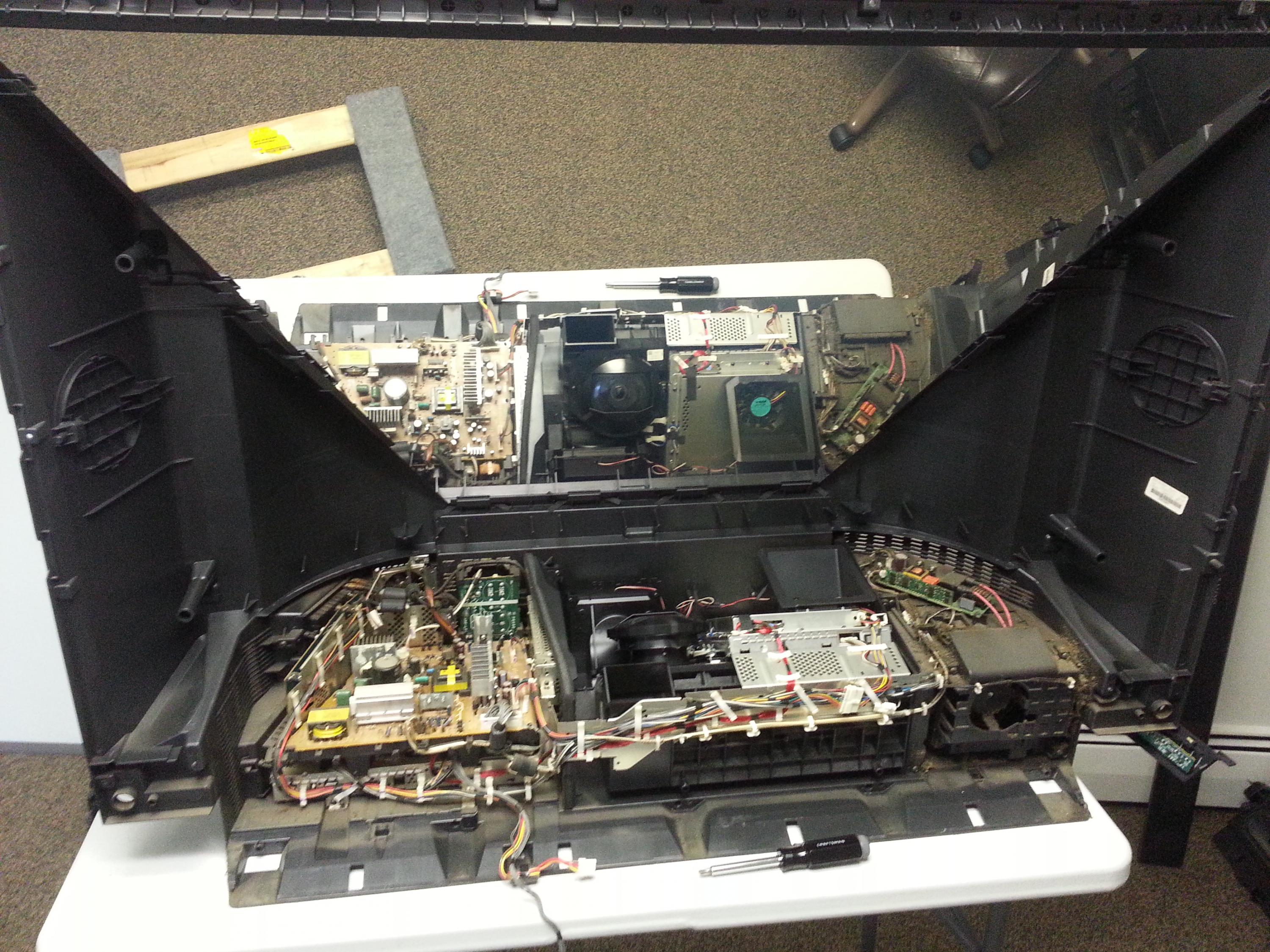

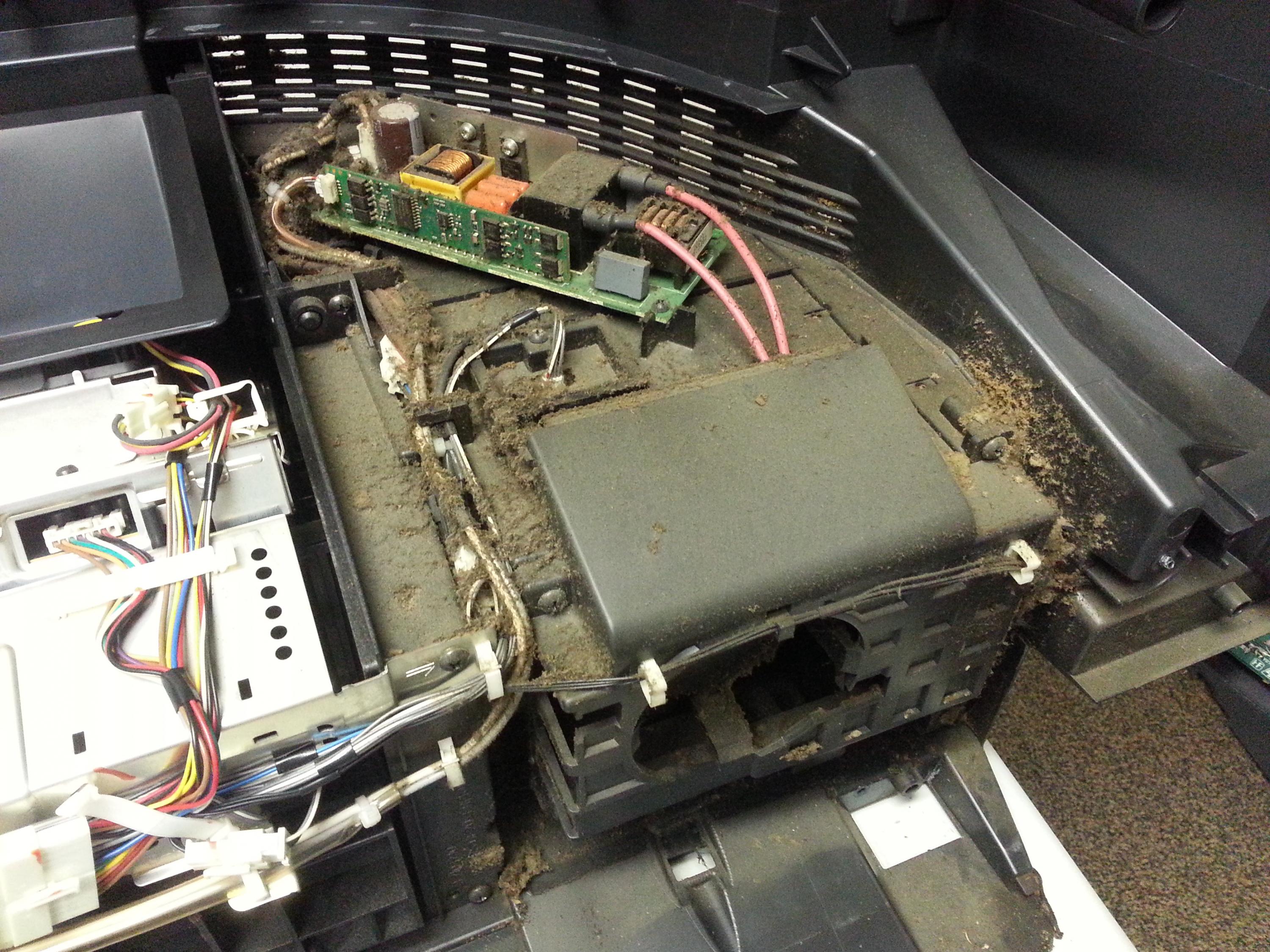

    I'm working on one of the newer (2008) Sony Bravia rear projection sets and am having an issue where it will power down almost immediately after lighting the lamp and blink the power light 9 times, indicating a "fan error" according to the service guide. The amount of time that it stays on before this error occurs varies between 1 and 10 seconds or so.
    I dug into the set and found that the exhaust fan for the lamp was a bit on the stiff side, so I replaced it and tried again, but it's doing the exact same thing. With the screen off, I can visually confirm that 3 fans are running fine. Using an external power supply, I was also able to verify that a fourth (hidden) fan deep in the light engine works as well.
    Is there another (fifth) cooling fan in this thing somewhere or could there be some other deficiency causing this problem? All the cabling looks solid and it doesn't appear that anyone has been poking around in this thing before, but it was (and still kind of is) extremely dirty thanks to negligence of the previous owner. Also, this is one of those unusual (pesky) models where everything has to be worked on from the front.

    hopefully those are pictures BEFORE you did a thorough cleaning... wow!.
    don't know much about this type versus something like a samsung dlp led based unit but perhaps there is some air flow sensor somewhere that is clogged.
    If you start the thing with all the air flow fans disconnected, do you get a different reaction / error?
    Perhaps you need to reset the error code some way.
    PS. Quick read of the service manual would suggest a thermal issue.... as "suggested", a thorough cleaning might solve your problems. Also, there are only 4 fans.
    PPS. have you entered the service menu and looked at the error counters? have you tried to clear them?
    PPPS... sheesh :-) my read, if you don't go into the service menu, then the set will always display the "first error" that caused the original / first problem... subsequent errors elsewhere will NOT be displayed / flashed.
      The second picture, yes.
      And the best part is that it was so dirty, even the mirror has this wonderful fog over it. Trouble is, they say that you shouldn't attempt to clean it because it is made out of a material that will scratch and lose its finish if you try.
