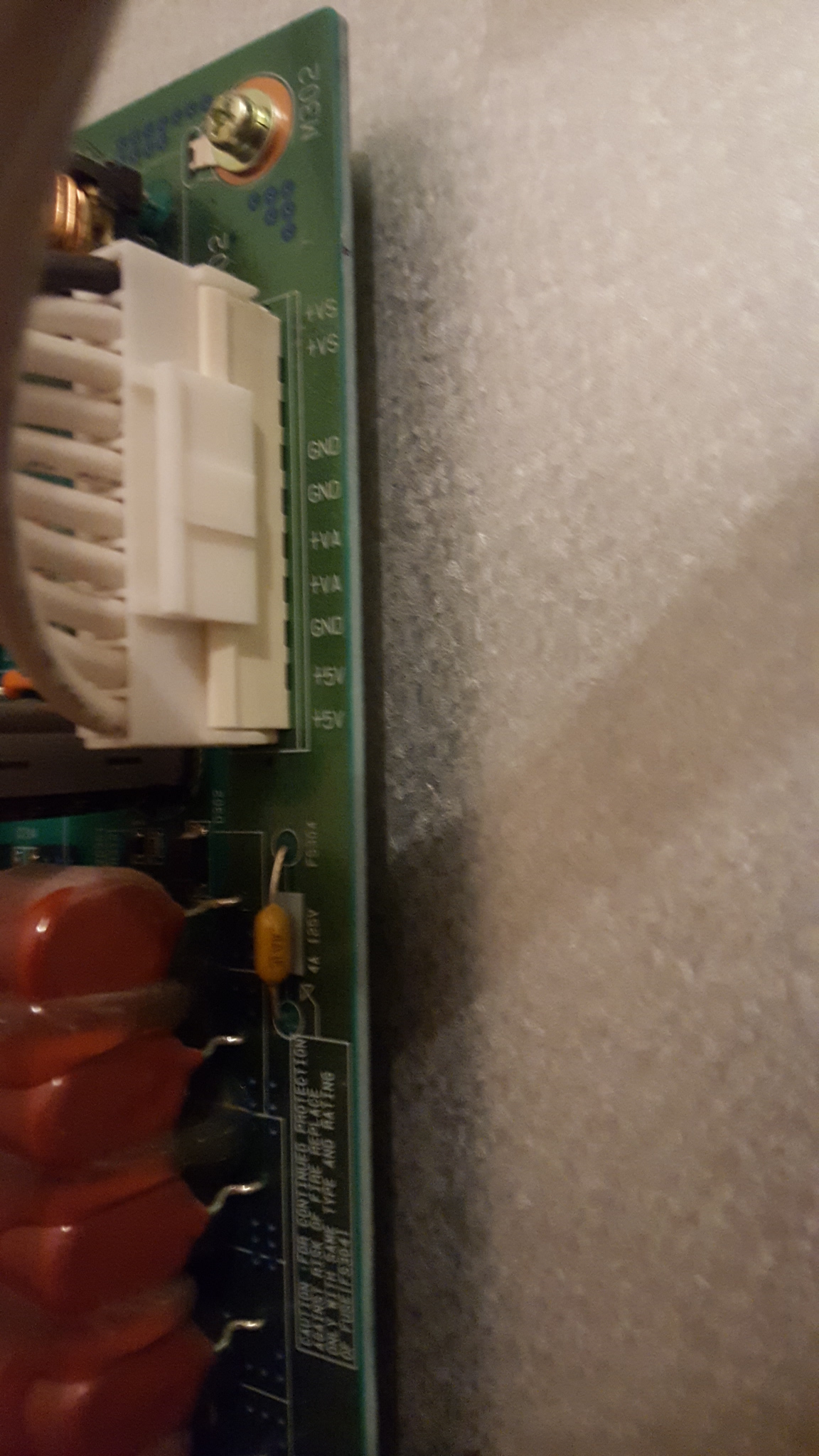

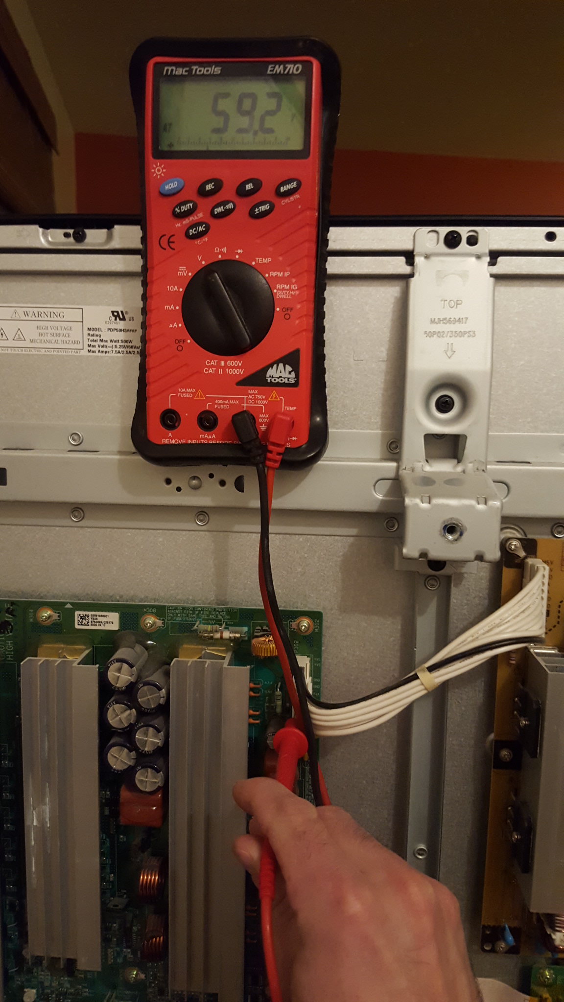

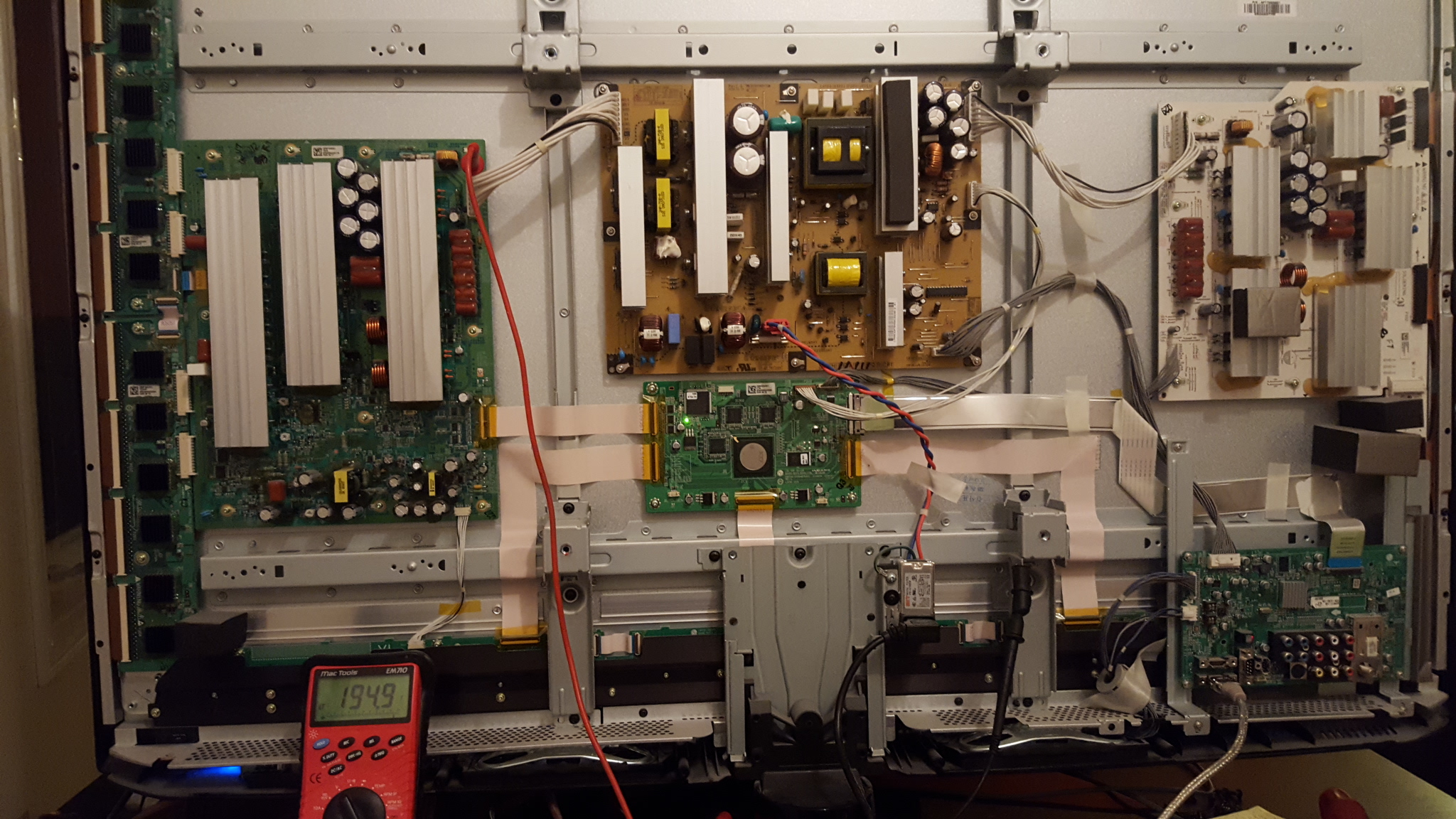

    Just looking for some diagnostic advice for my 50" LG plasma, since i'm too cheap to buy a new TV.
    TV has a lot of hours on it, recently the picture stopped working but the sound still works. I have browsed these forums and some youtube channels and started some diagnostics.
    So far I have tried running the board with the Y-Sustain disconnected, upper Y drive disconnected, lower Y drive disconnected and the z sustain board disconnected.
    There was no picture in any of these cases and I have power on both sides of the fuse on the Y-Sustain and Z-sustain boards.
    Any suggestions on what I should check or measure next to isolate the problem?

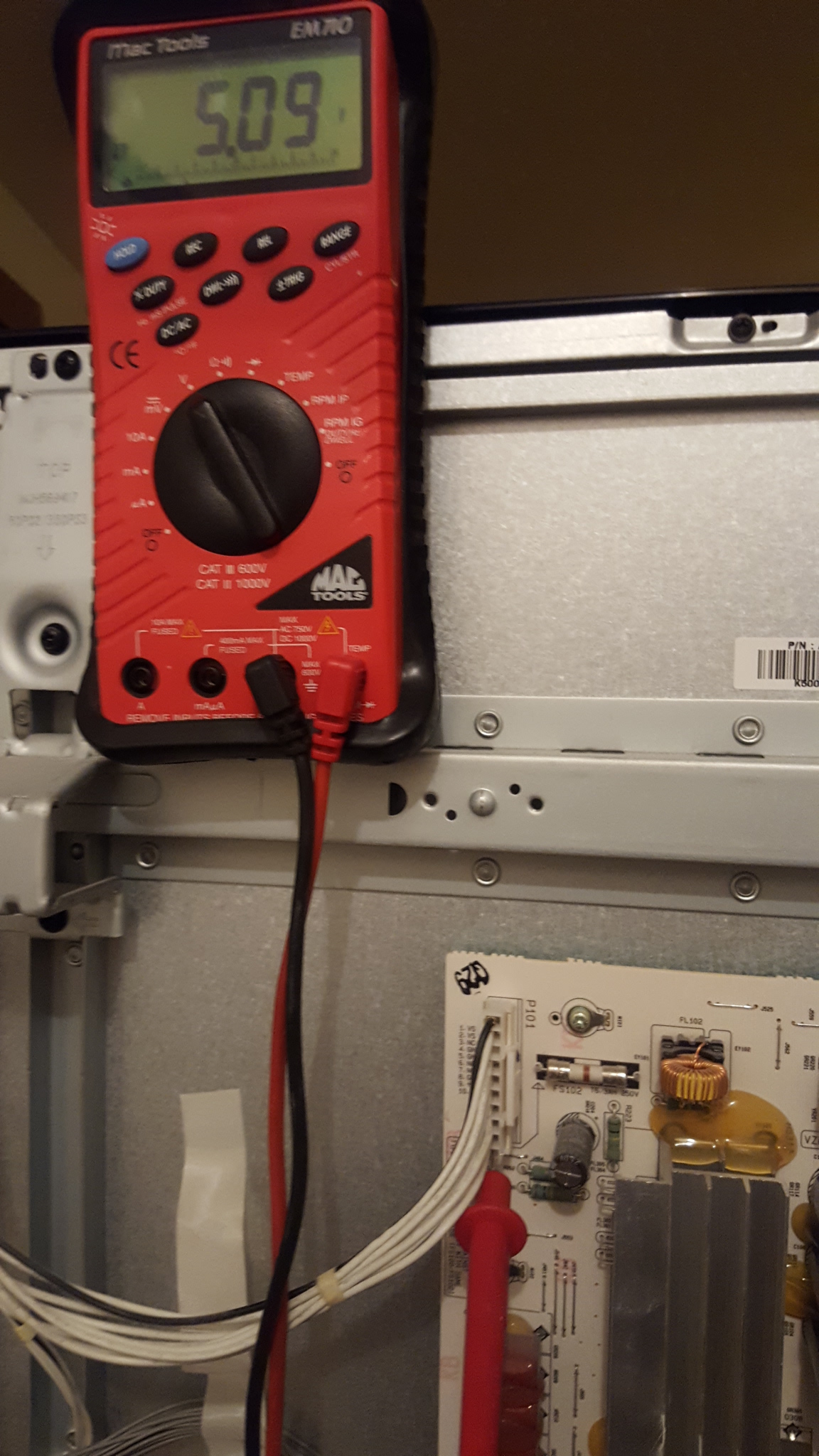

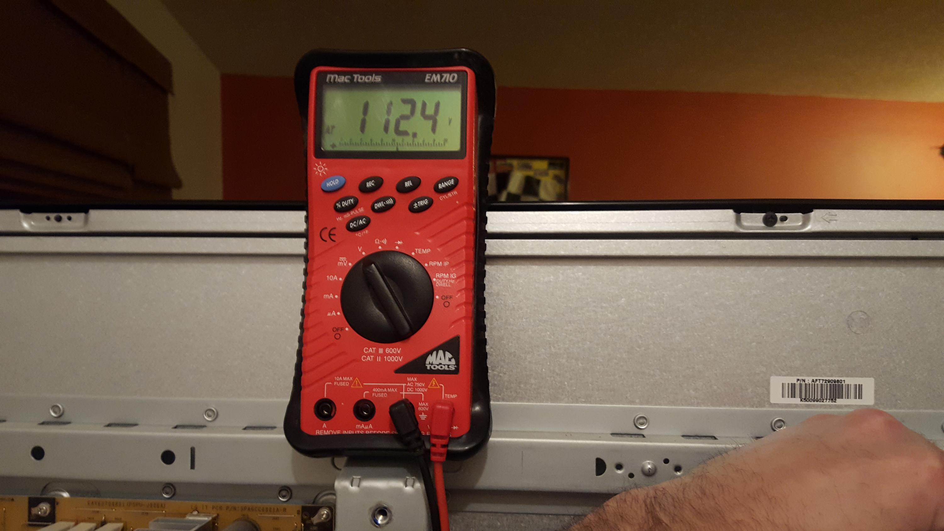

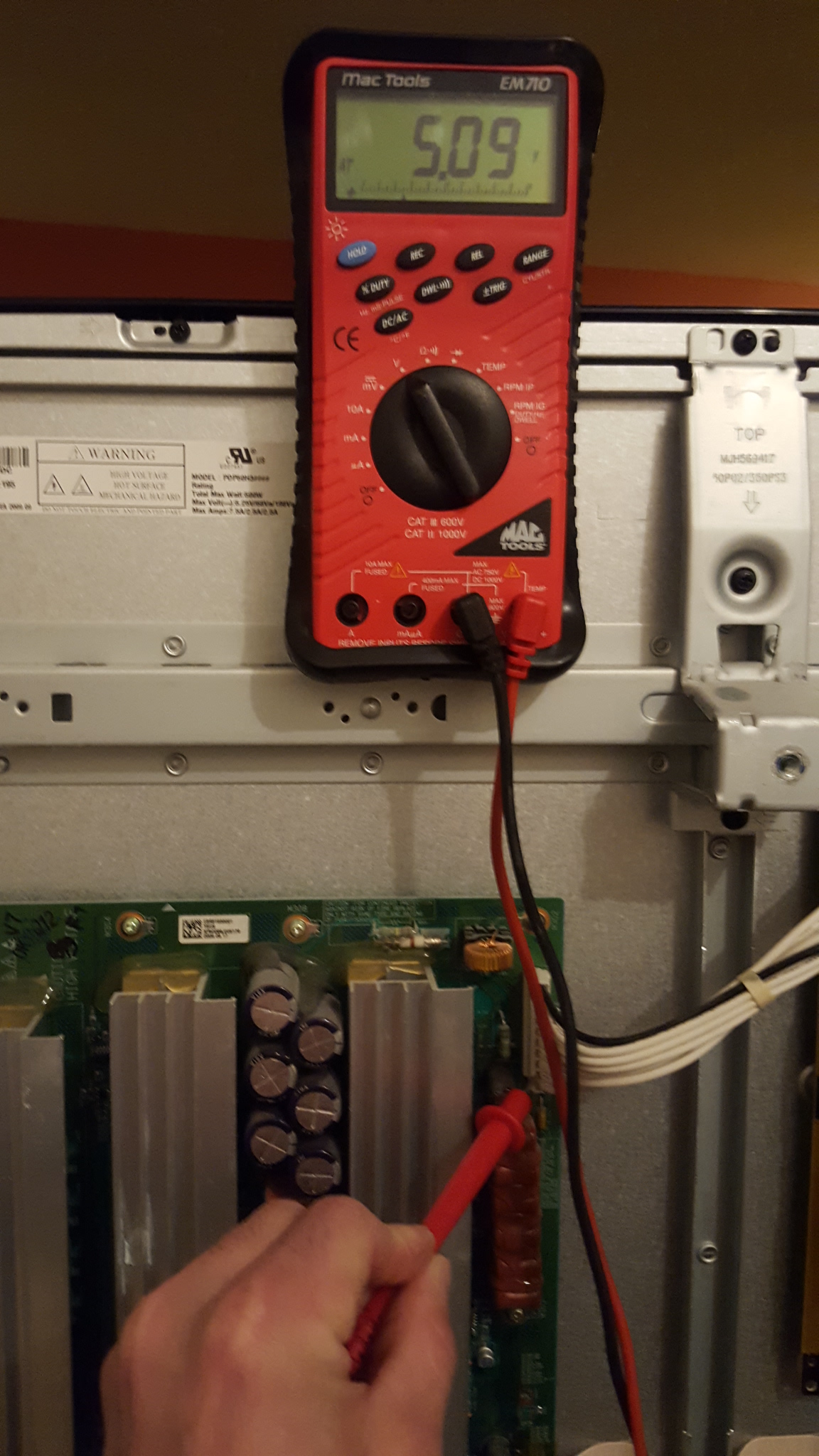

      Re: LG Plasma 50PS11, No picture but still has sound
      See attached pics.

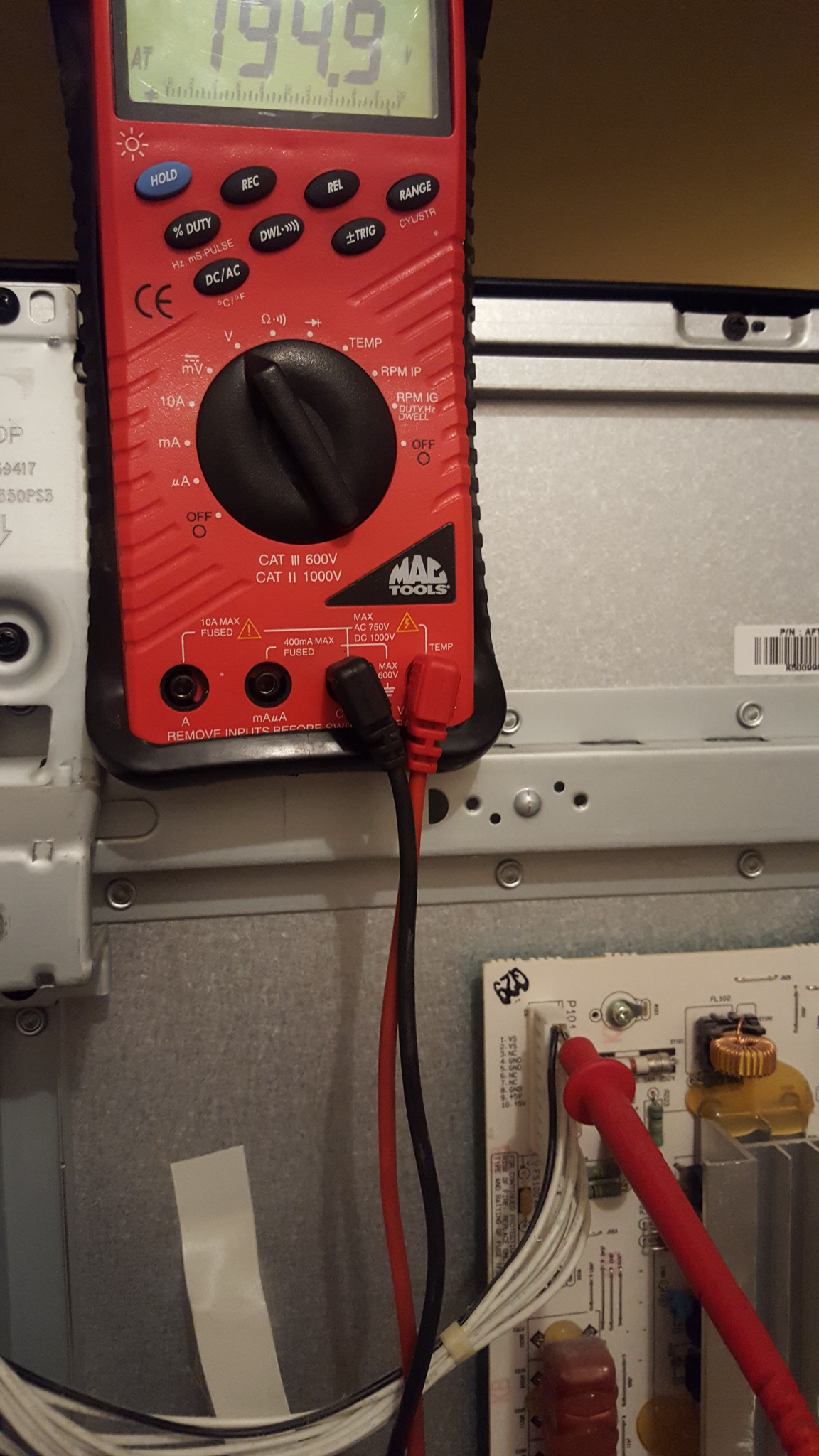

      1st pic is Ysus VS+
      2nd pic is Ysus VA+
      3rd pic is a closeup of Y sus power input?
      4th pic is Ysus +5V

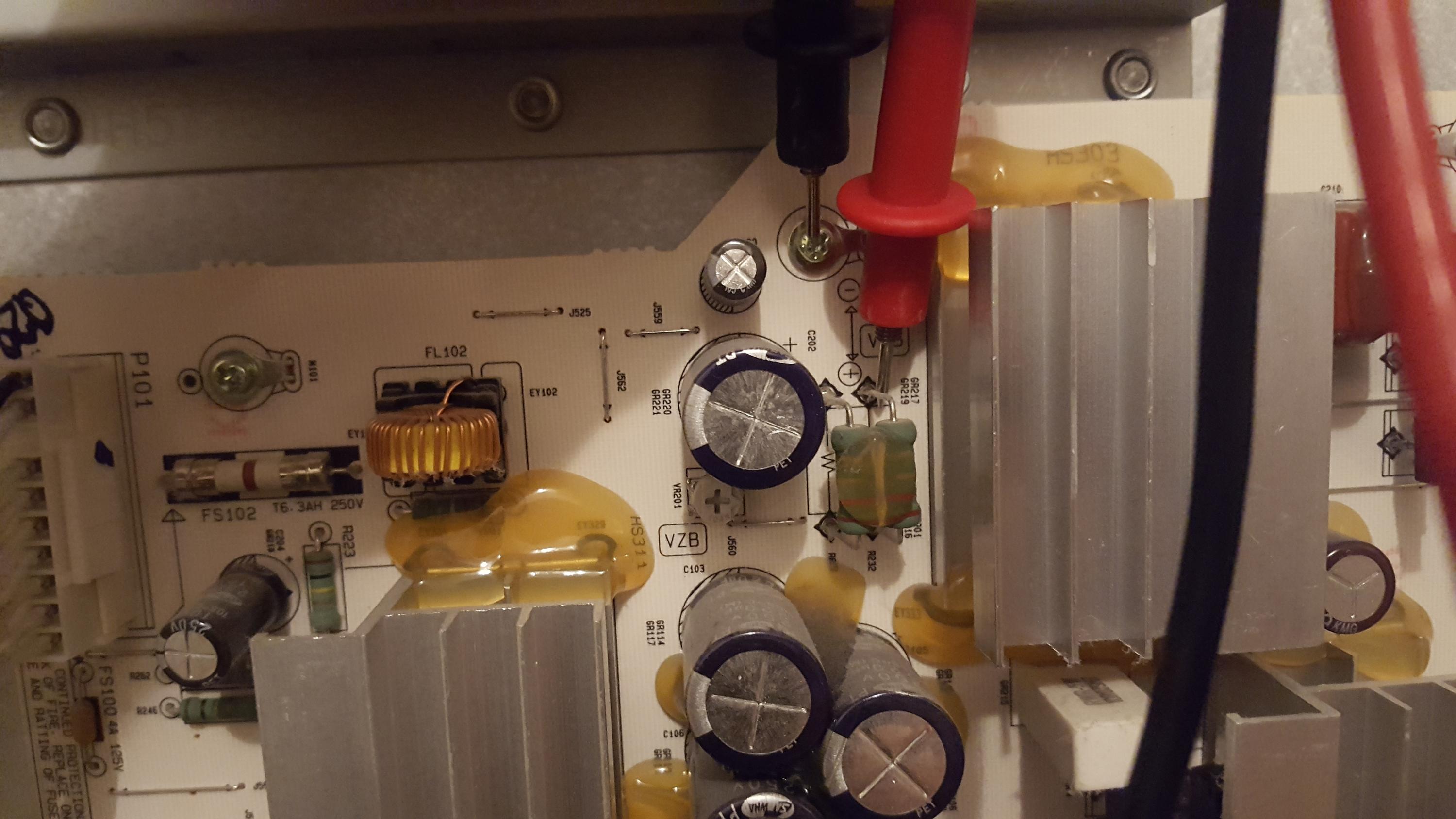

      5th pic is Zsus VS
      6th pic is Zsus +5V
      Any ideas what I should check to help isolate the issue?
      Thanks for the help.

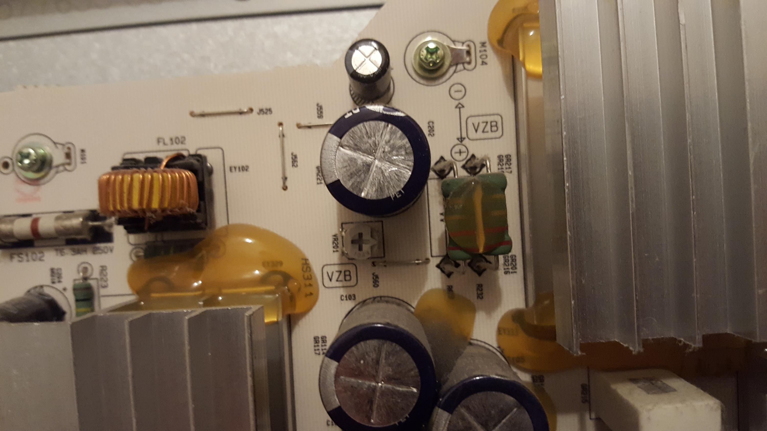

        I measured VZB (tough to tell where to measure) on the zsus board at 112 V. This doesn't match any voltages on the pan sticker.
        Would this point to a bad zsus board?

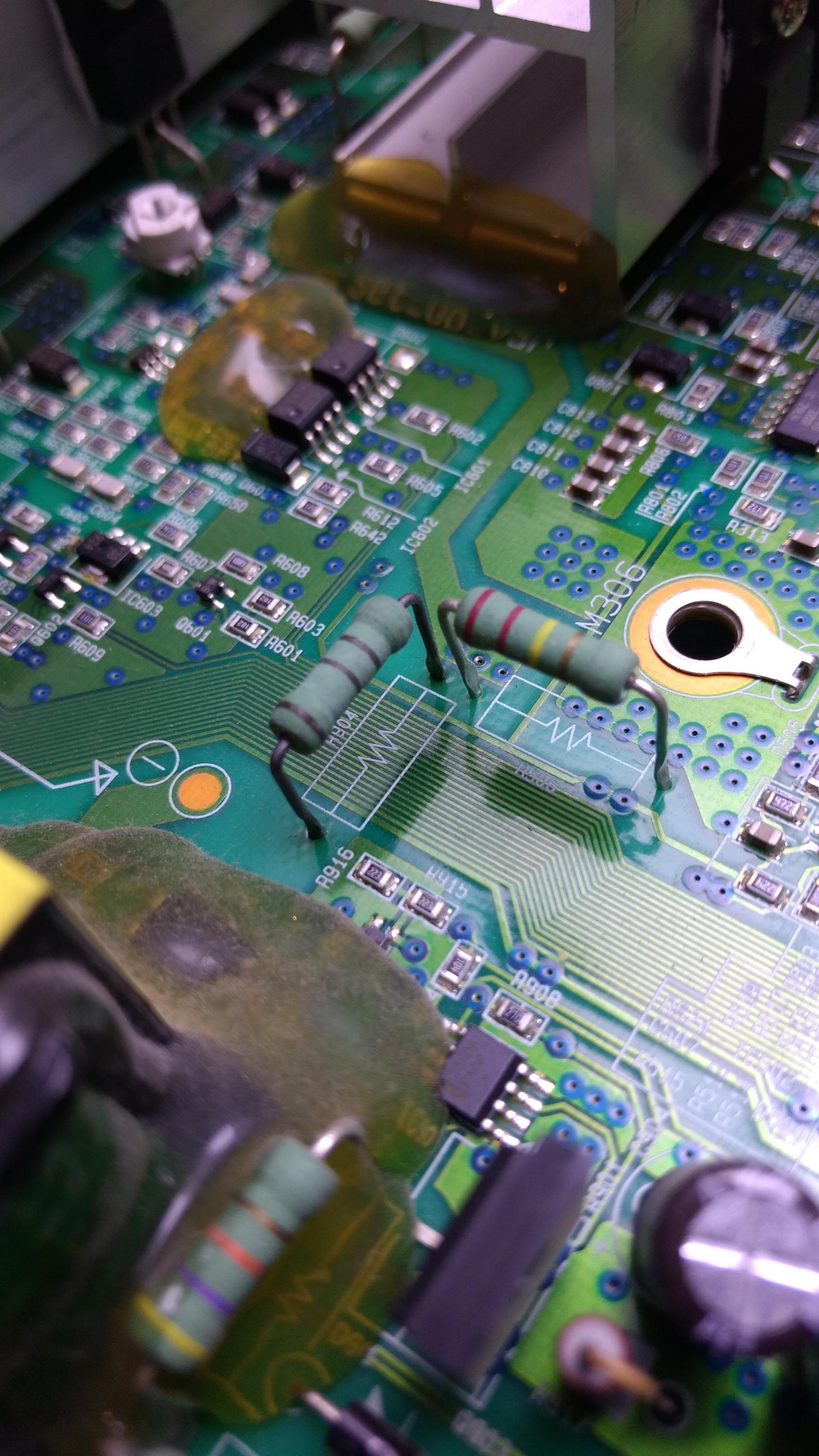

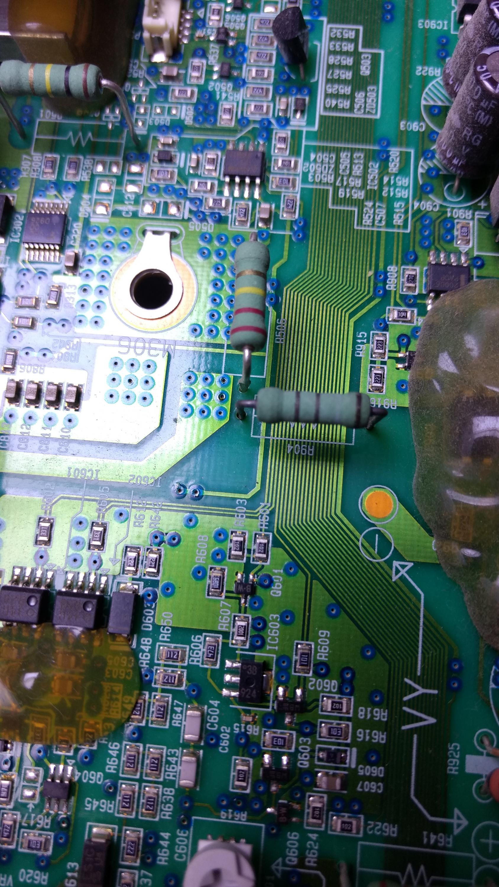

          I have fixed 2 of these at this time this week but one give me headhashes now im about to post a thead about it

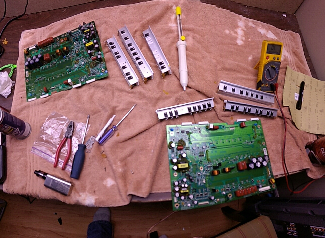

          If you are lucky this resistor transformed himself into a powerfull toaster and opened (check attached pictures ) it look like a very common failure i got it on 2 of 3 y sustain . To prevent that this one blow again i replaced it by a 5watts ceramic resistor , the value is 2.2 ohms
          • Jeff Pepin
            • Jun 2014
            • 103
            • CANADA
            The second one that give me headhashes the resisstor was fine , but i have found 2 fets labeled "45F122" dead but not shorted located on the center heatsink of the y sustain
            Is a lot of work but you need to remove entire heatsink with fets on it , after that you can test each one by put your dmm in diode mode and placing your red probe on left pin , black probe on center pin to charge the gate, then immediately put the red probe on the center pin and the black on the right pin you should have a reading that prove that it switched on
            Then , leave the red probe on center pin and go toutch the left pin with your black probe to switch it off , now put again your black probe on the right pin and you should read O.L , replace it if it show no signs of life
