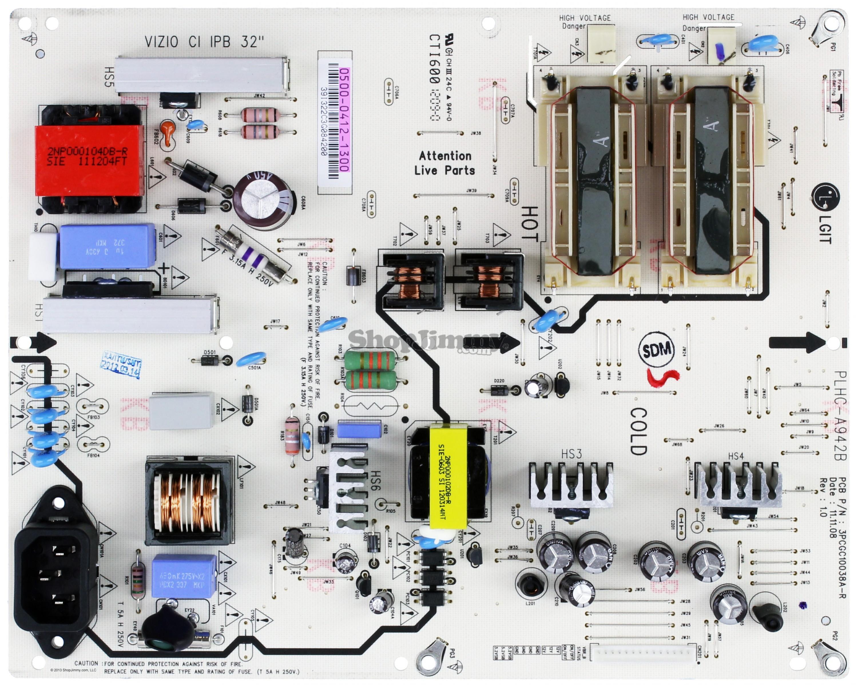

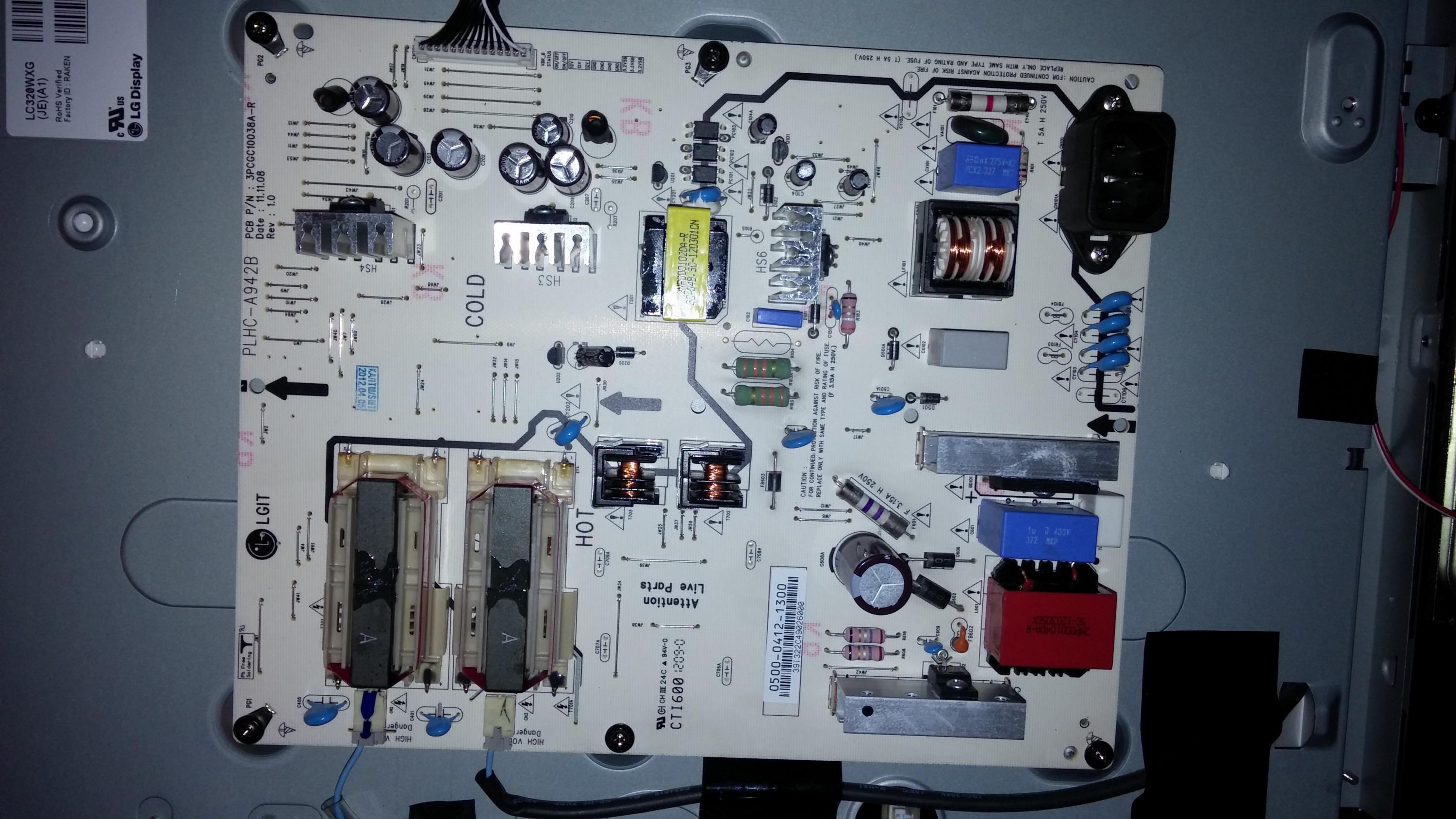

    A friend of mine gave me a vizio tv e321vl and said they had a lightning strike and now the tv does not power on anymore.
    Iv been doing a bit of reading on here and found a few things to test.
    One thing is that the cable that joins the ps board to the main board, it does have the 5.2v standby, but it does not have the 12v. Being that its on the cold side, i grounded to the tv chasis.
    As far as plugging in the tv, i notice that the vizio logo on the bottom front of the tv blinks amber momentarly, and then its off.
    Is there anything on the ps board to test/measure?
    Pic os ps board attached.

    5.2VSB is always there, with the TV on or with it off. The 12V rail comes alive when the TV is on (PSon). The backlights come on when the BLon is present.
    Have a look if the main board sends the two on/off signals or not.
    Right now we need to know how you tested that TV exactly.
    Other than that, you can disconnect the main board, take two 1k resistors and jump between 5.2vsb and the two on/off pins. When you plug the PSU in, all the rails should be up and the backlight on.

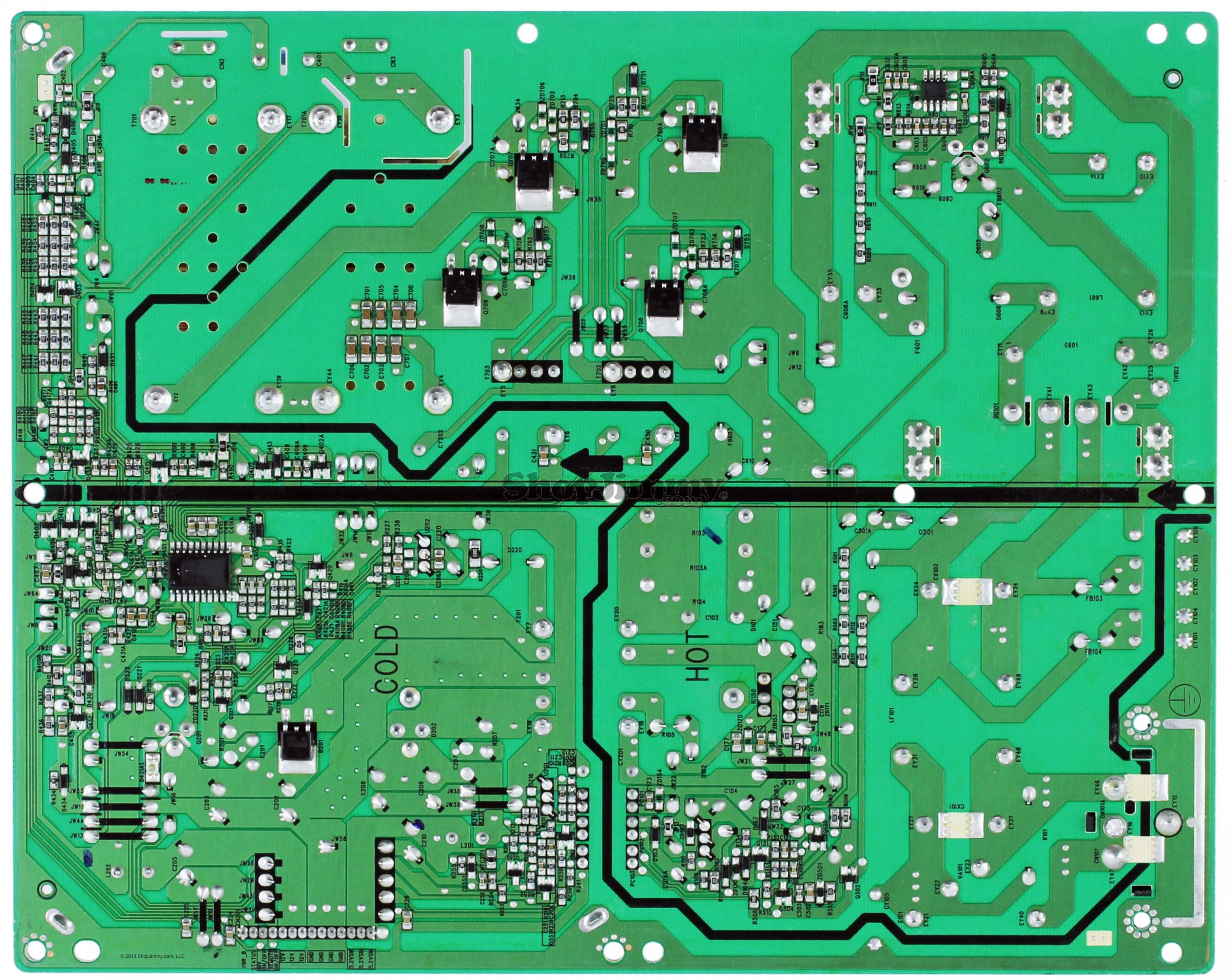

        Re: vizio e321vl no 12v
        With all the boards connected, what DCV do you have on that ON/OFF pin right next to the 12V pin?
        The other ON/OFF pin is the BL-ON.
        The 12V is generated from the same transformer of the STBY 5V.
        Pictures provided by shopjimy.
        Vizio/JVC 0500-0412-1300 Power Supply / Backlight Inverter E321VL JLC32BC3002
        http://www.shopjimmy.com/vizio-0500-...-inverter.htm#

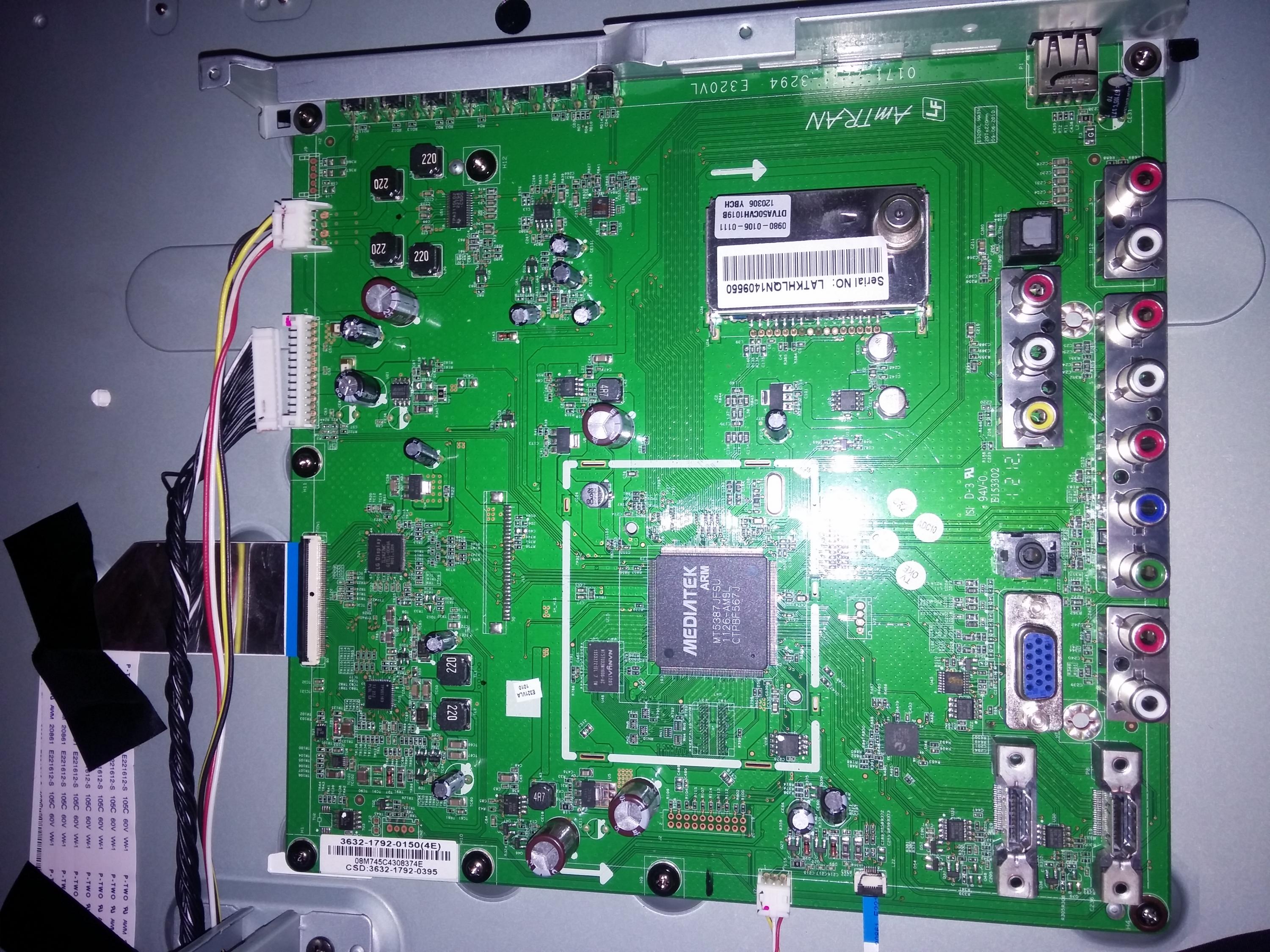

                              I would suspect that is a problem. Can you post some photo's nice and sharp of the main board.
                              • kevin.st56
                                • Sep 2016
                                • 22
                                • United states
                                Sure. Lighting is somewhat poor, and camera flash overpowers the camera and makes glare
                                Ill post my several attempts lol
                                Taken at 13mp

                                    Thinking about it if the P_ON signal comes directly from the main processor then the main board may well be trashed.
                                    However there is a possibility that the processor switches one of the 3 legged devices (transistors/mosfets) to provide the P_On voltage which may have gone short circuit.
                                    Without a schematic it is hard to tell what is going on but may be worth your while doing an ohms check on all the 3 legged devices looking for a short circuit.
                                    I think they are marked Q..
