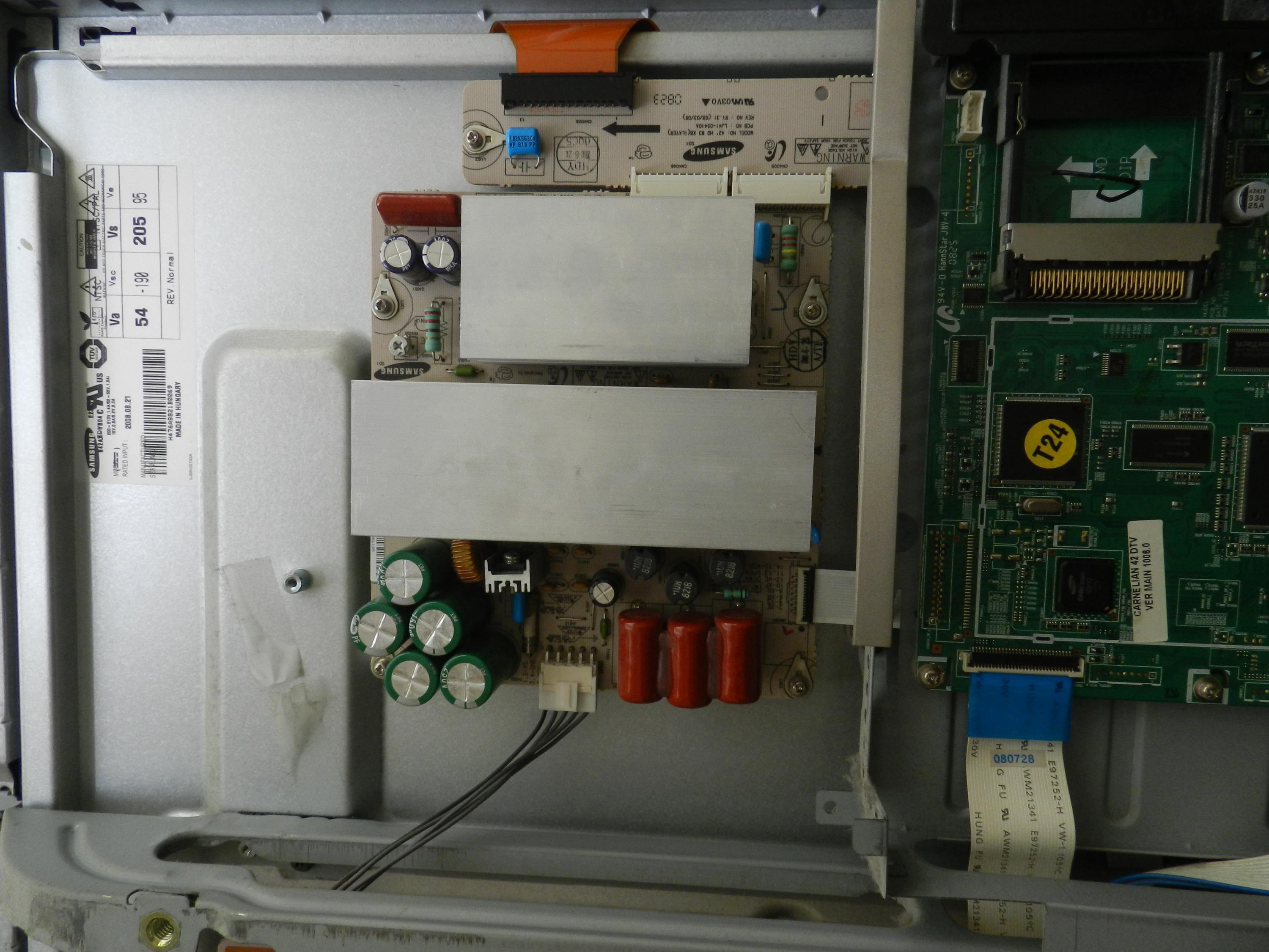

    I can see the potentiometer for adjusting Ve on the X-Main board but not the test point. Also is Vscan = Vsc.

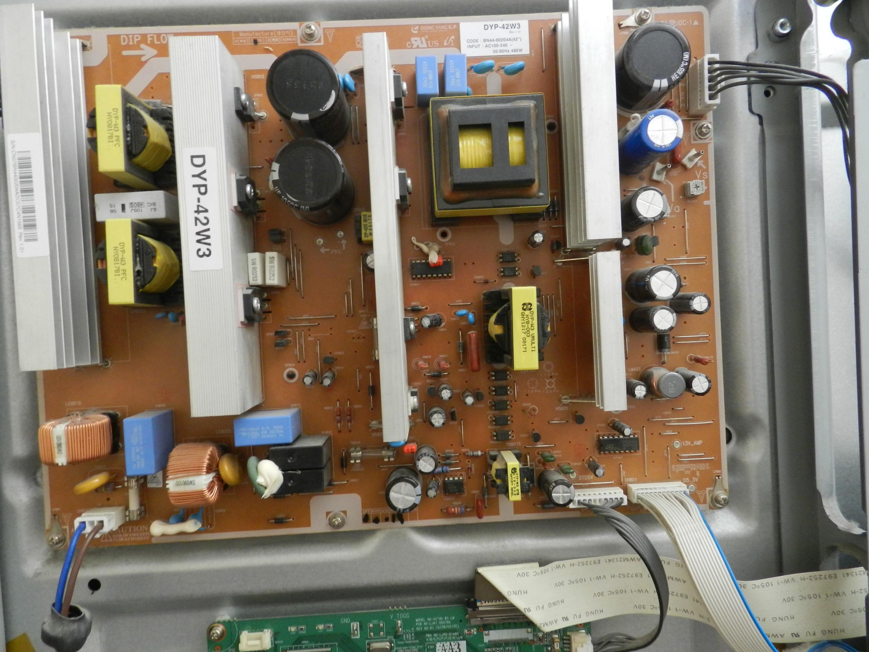

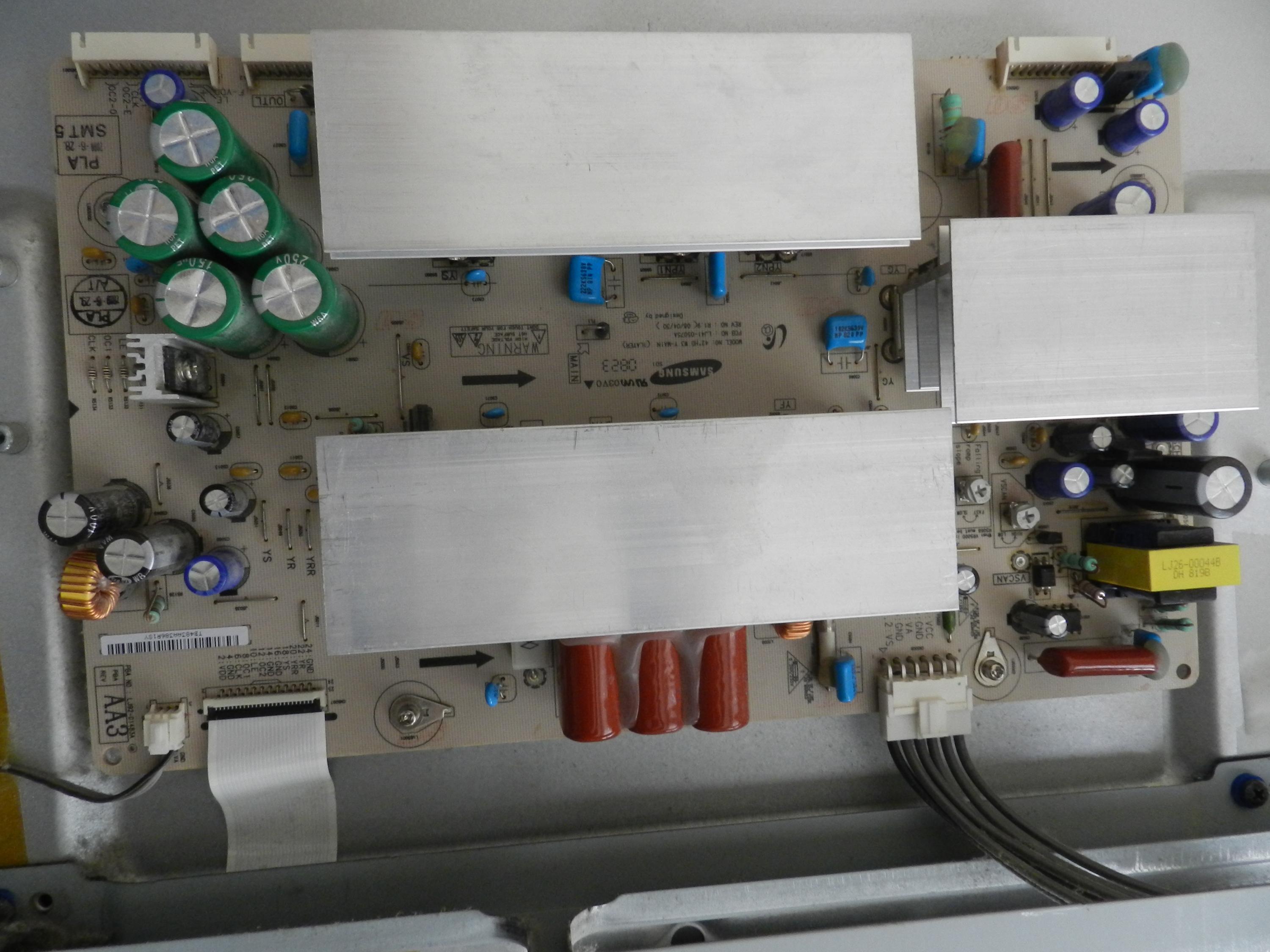

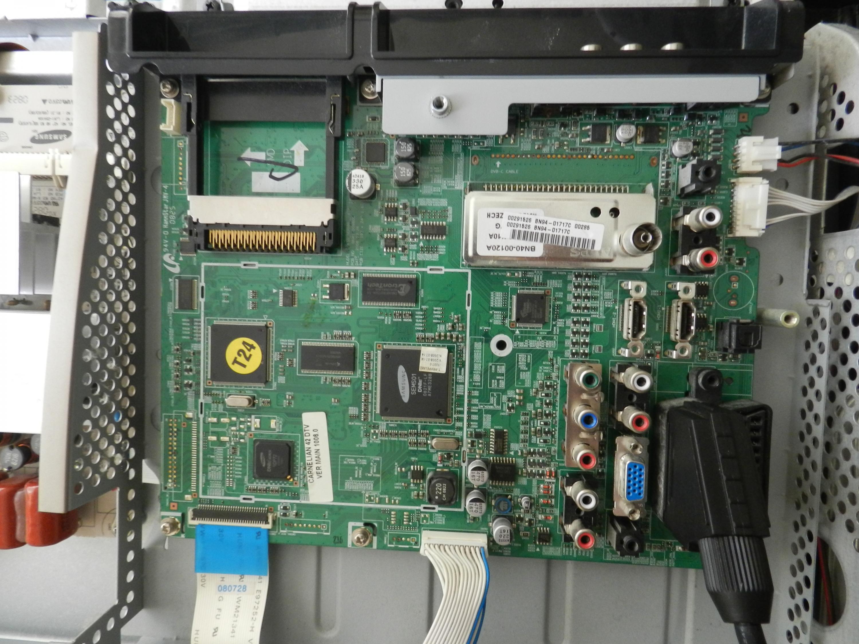

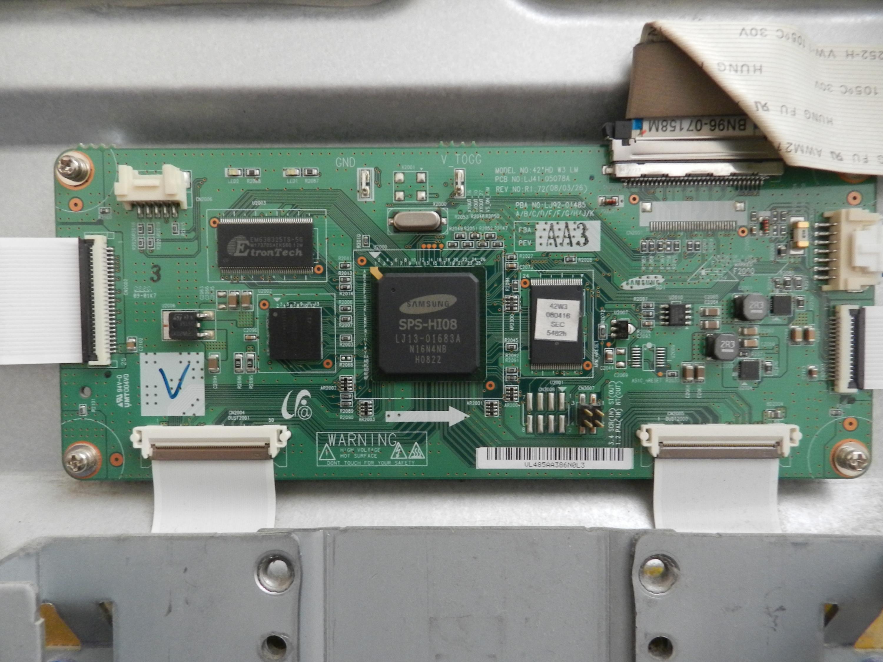

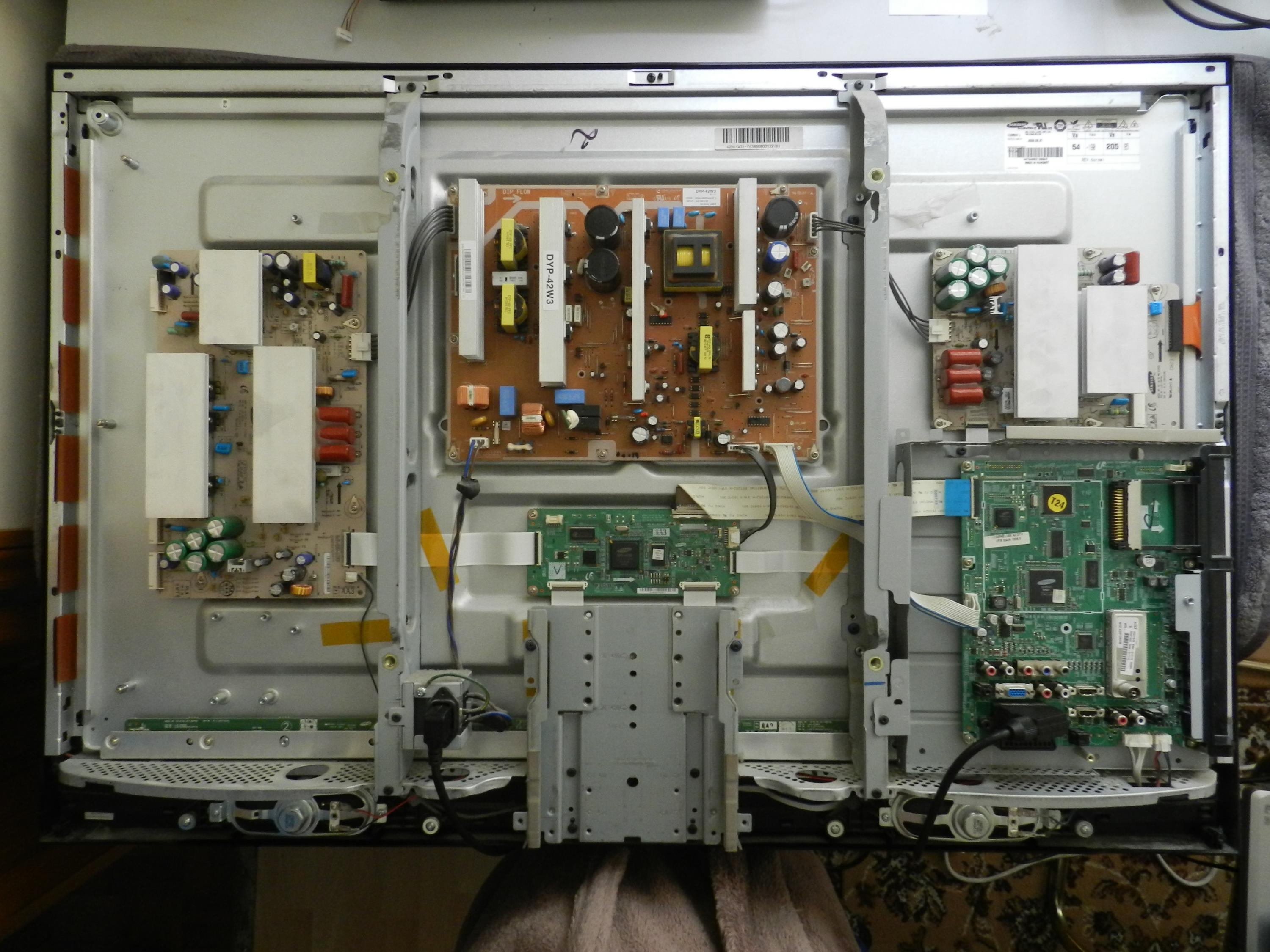

                  Pictures of set for future reference. Fault finding needs to be done on the Y-Main,. The Y buffer board has not been reconnected since last test.

                    DB after you have diagnosed the Ymain you need to also recap the powersupply. The Samwha Wl and Wb caps on that supply have a habit of failing and if they do the set wont switch on again. So my advise is replace all the known bad caps on the Psu after the Ymain repair

                      Re: Samsung PS42A416C1D No Picture
                      From my little black book of Samsung repairs. I list R5032/C5030/D5014 + U5015 as suspect faulty components for the LJ92-01483A Y Sus. not seen one in years.hope this is of help.could have one kicking about in my old stock
                      • dick_barton
                        • Aug 2015
                        • 6643
                        • Wales
                        Hello Flocko, ReeceyBurger123,
                        Thanks for your useful tips which may well have identified the problem. D5014 (UF4007) is short circuit so I'll test the other components you mention. None of the Fets appear to have blown or are short circuit so hopefully not a major build.
                        Will replace the caps in the power supply as suggested.
